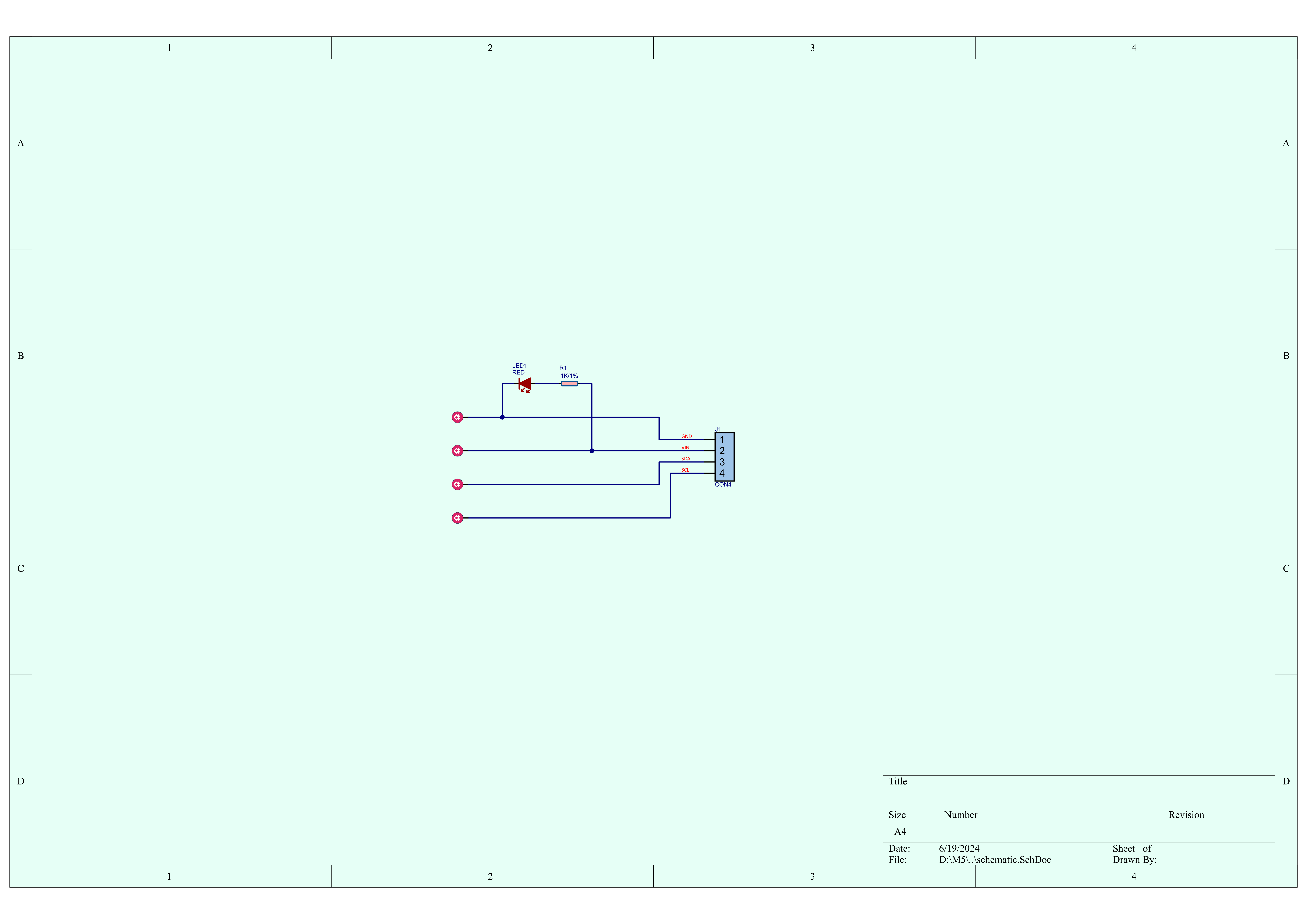

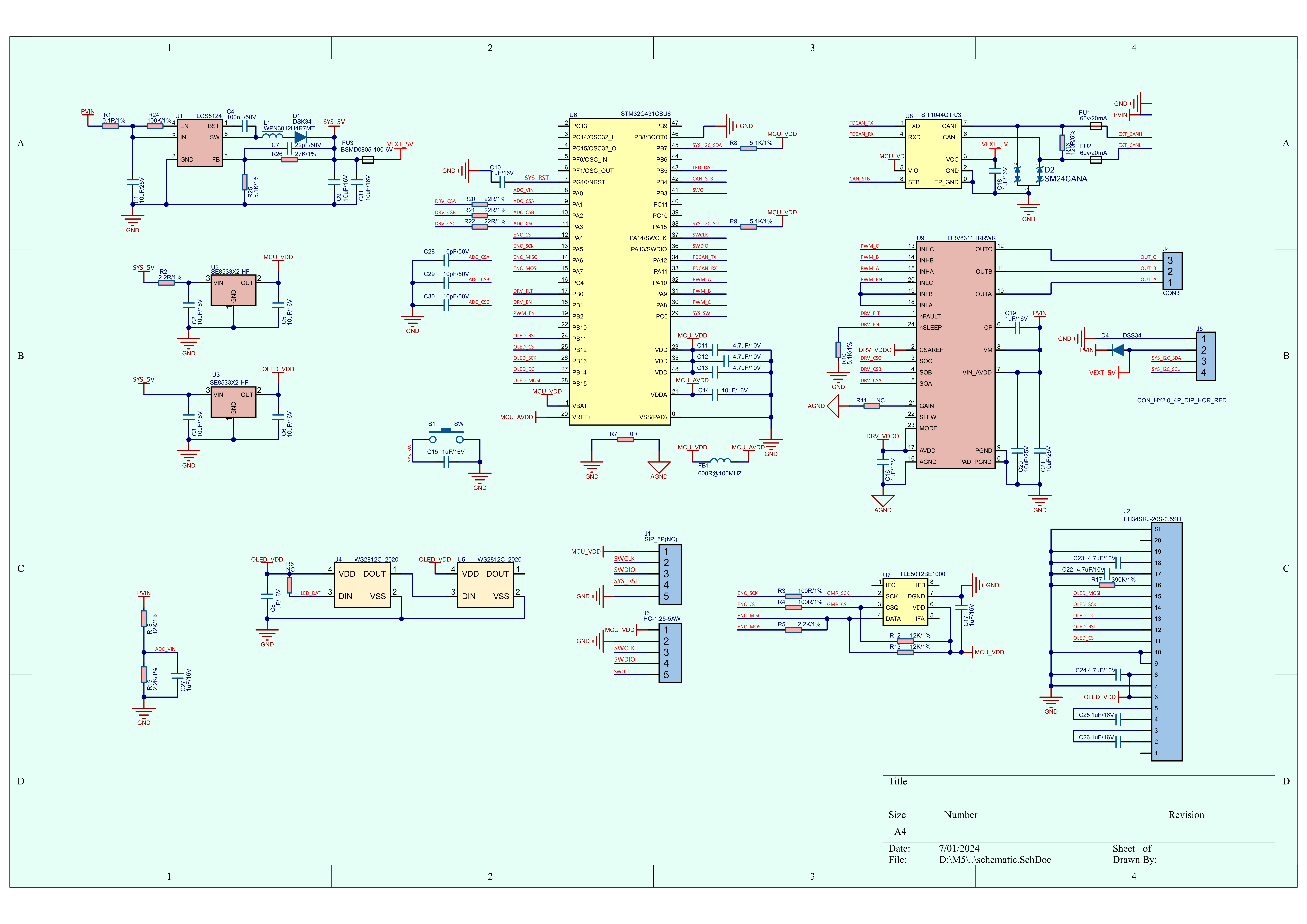

PORT.A GND 5V SDA SCL
I2C, CAN, RGB, Button
STM32G431CBU6 PA15 PB7 PA11 PA12 PB4 PB5 PC6
I2C SYS_I2C_SCL SYS_I2C_SDA
CAN FDCAN_RX FDCAN_TX CAN_STB
WS2812C LED_DAT
Button A SYS_SW
OLED
STM32G431CBU6 PB15 PB13 PB14 PB11 PB12
OLED OLED_MOSI OLED_SCK OLED_DC OLED_RST OLED_CS
