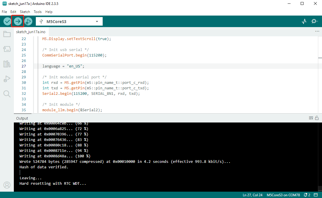

  1. Upload the code to CoreS3

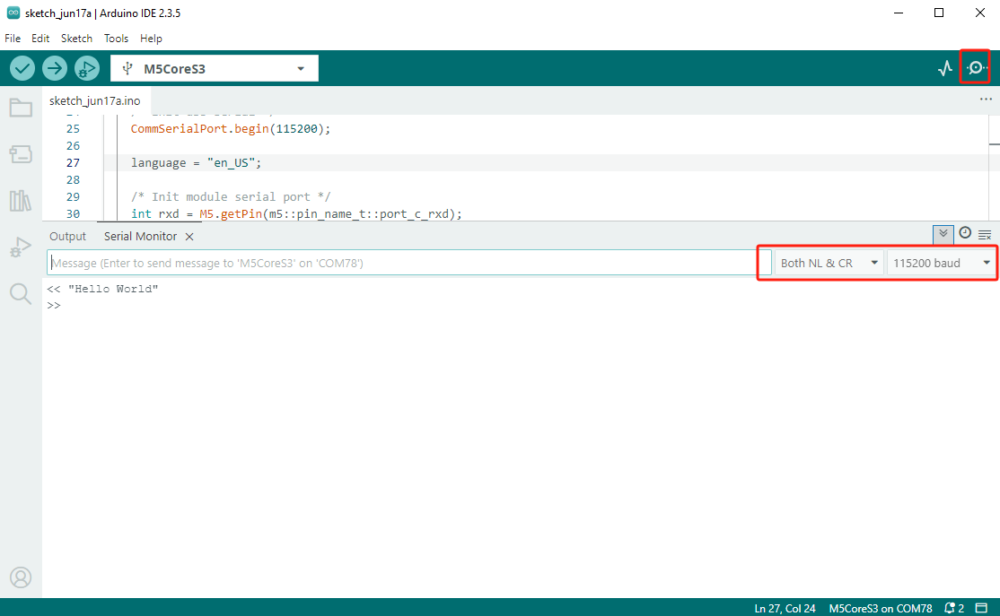

  1. Open the Serial Monitor in Arduino IDE and set the baud rate to 115200. Enter text and press Enter to send.

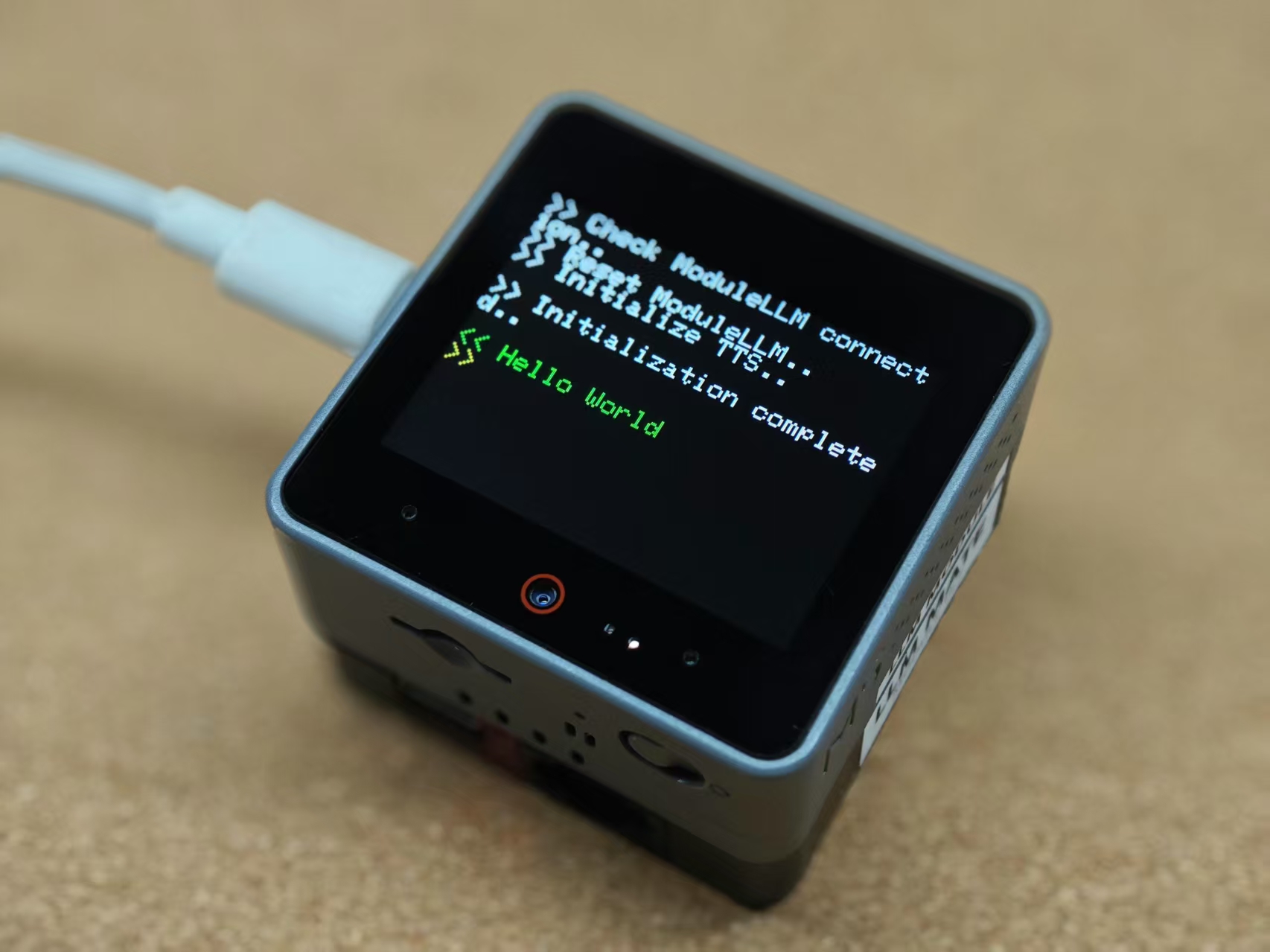

  1. Module LLM will synthesize and play the audio.
