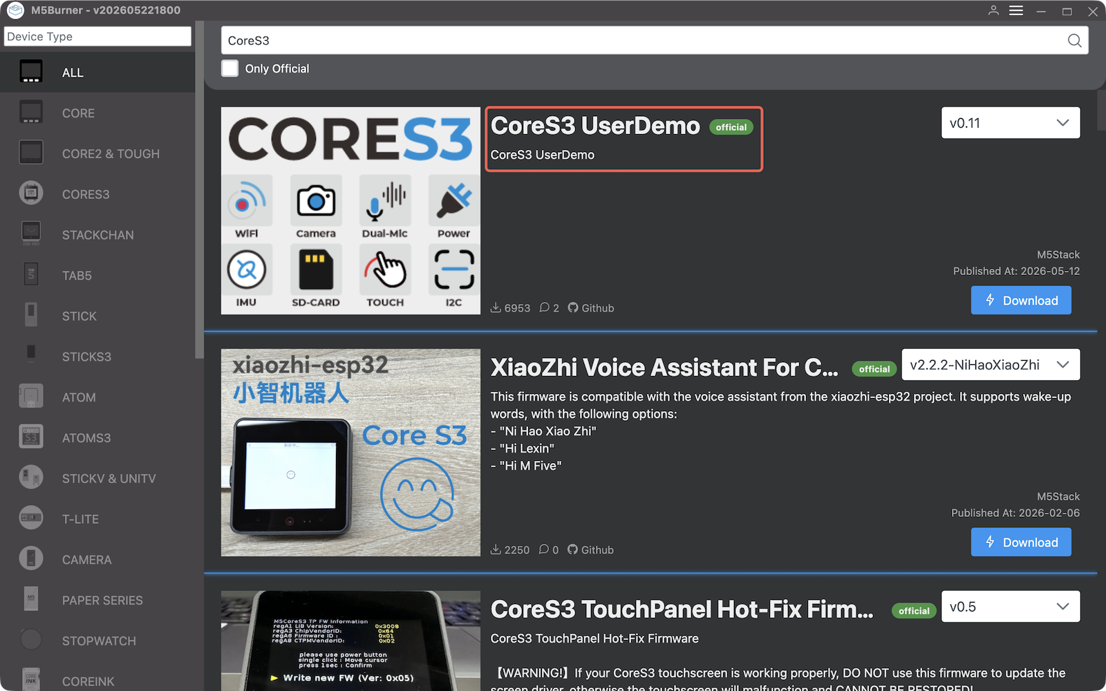

  • In the Settings menu on the StackChan device, run the Microphone Test, RGB LED Test, and Servo Test. Check whether the microphone responds to sound, whether the RGB LED displays the correct colors, and whether the servo can move from its current position back to the home position after tapping "Move To Home".
  • Use M5Burner to flash the latest version of CoreS3 UserDemo, then run the built-in tests for CoreS3 hardware functions, such as checking battery voltage, USB voltage, and other information in the Power Test section.
  • If StackChan cannot power on, try supplying power through each of the two USB-C ports separately. If you are comfortable with hardware disassembly, you may also follow the instructional video to separate the CoreS3 controller from the body and test the controller independently.
After completing the relevant tests, please send the test procedure, photos, and videos to official customer support for further assistance.
