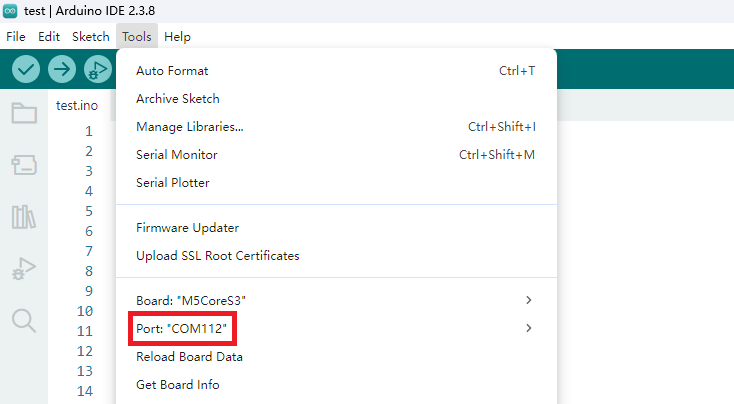

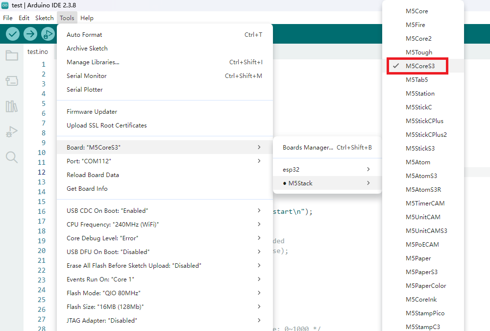

3. Port Selection
Connect the device to your computer via a USB cable, then select the corresponding device port in the Arduino IDE.

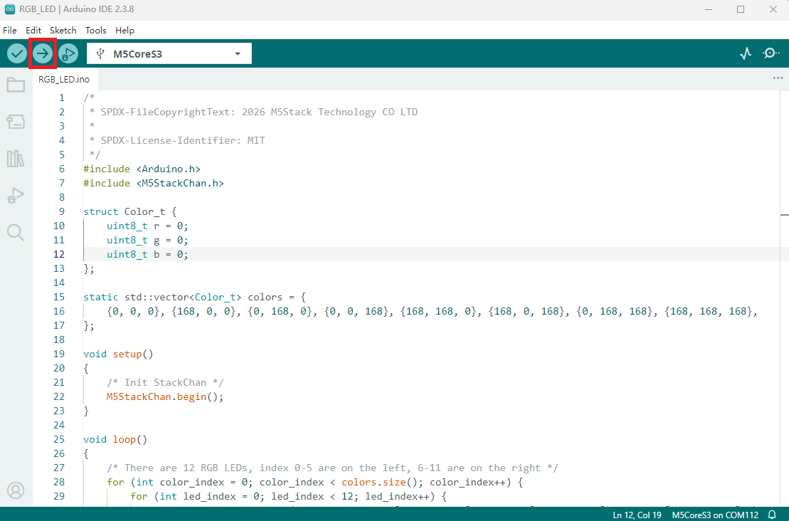

4. Program Compilation & Flashing

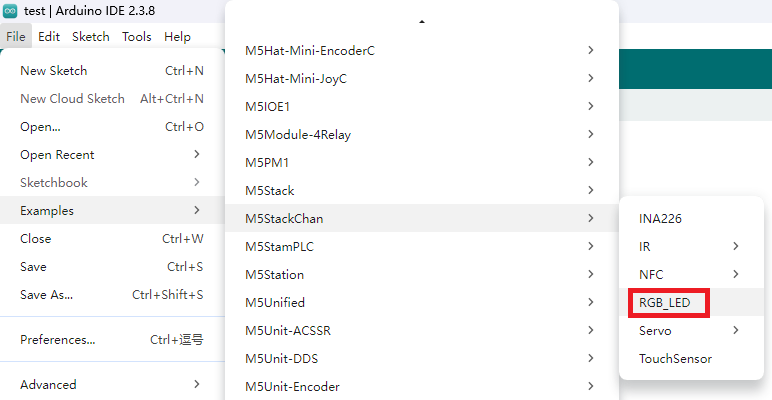

Open the example program "RGB LED" from the driver library and click the upload button. The program will be compiled and flashed to the device automatically.

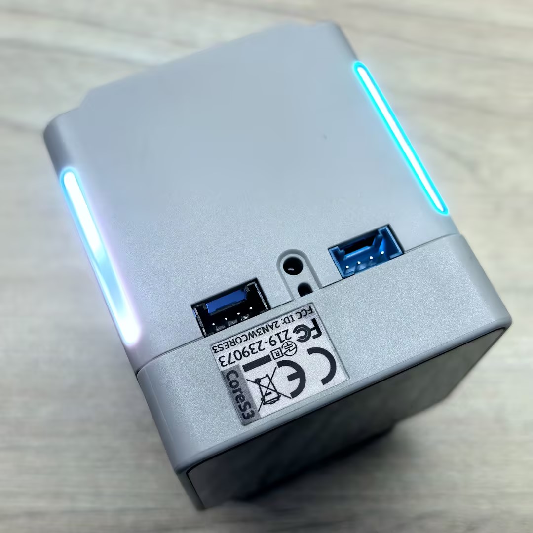

The example output is shown below:
