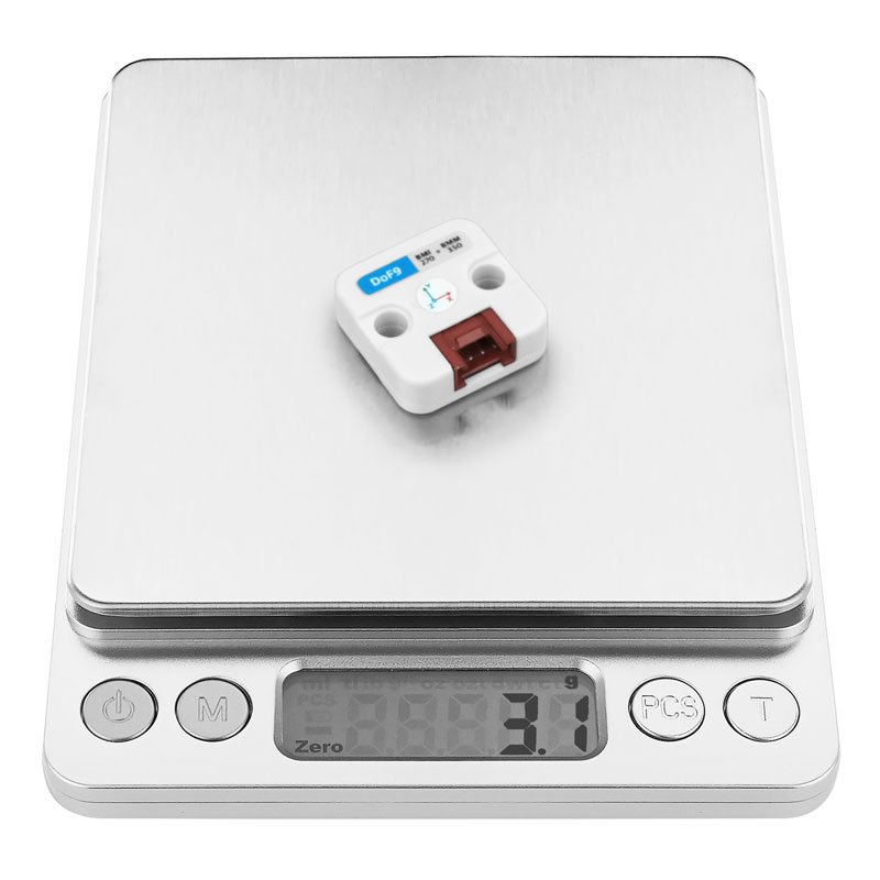

Product Weight 3.1g
Gross Weight 6.6g

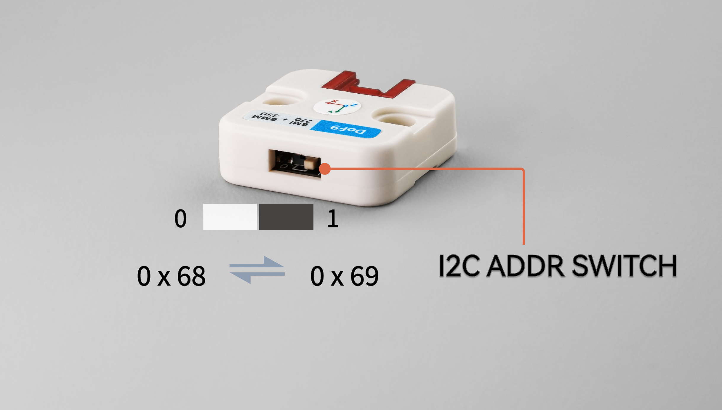

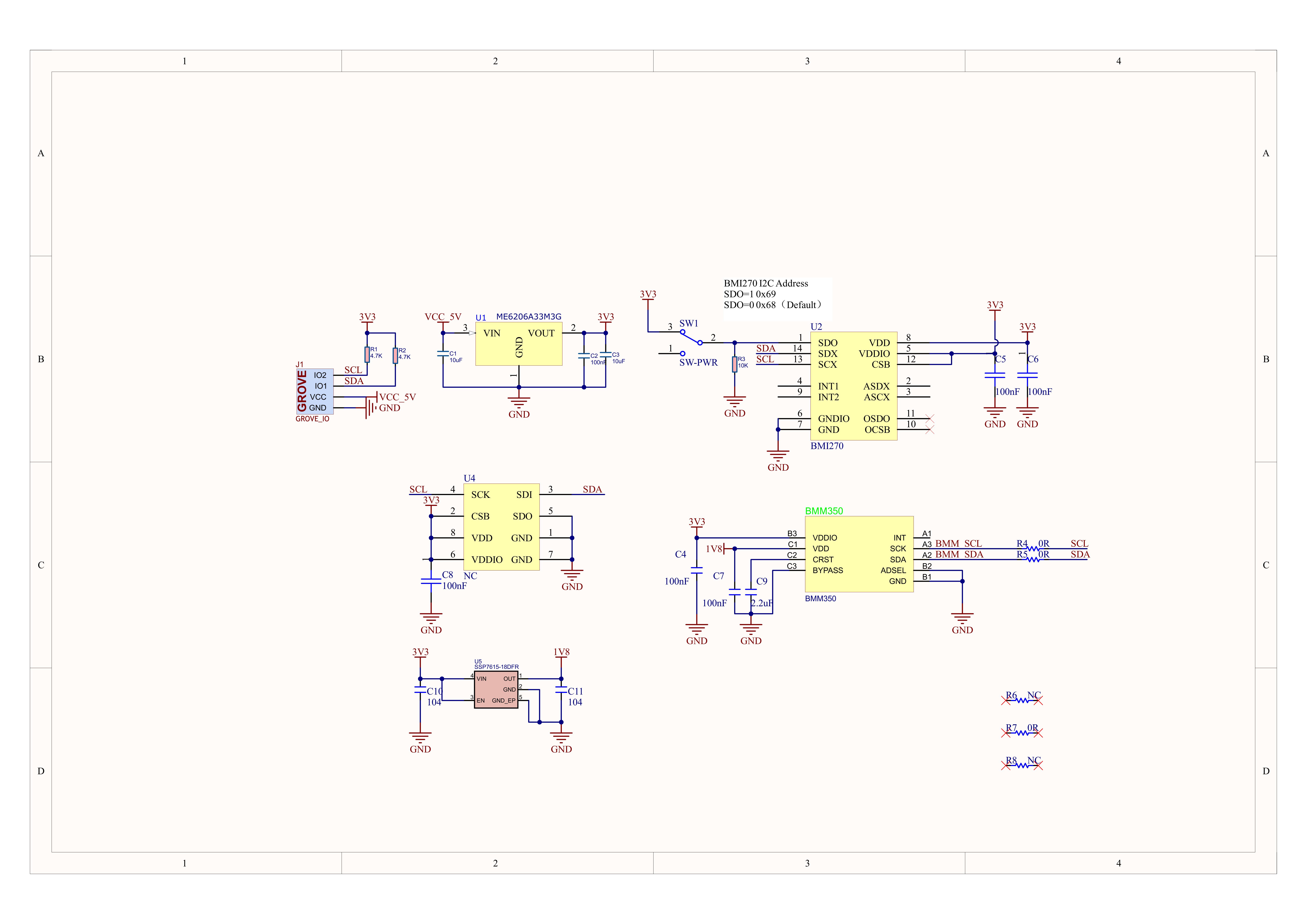

I2C Address Switching
The BMI270 I2C address can be switched with the onboard switch. Set the switch to 0 for address 0x68, or to 1 for address 0x69, to avoid address conflicts on the I2C bus.
Unit DoF9

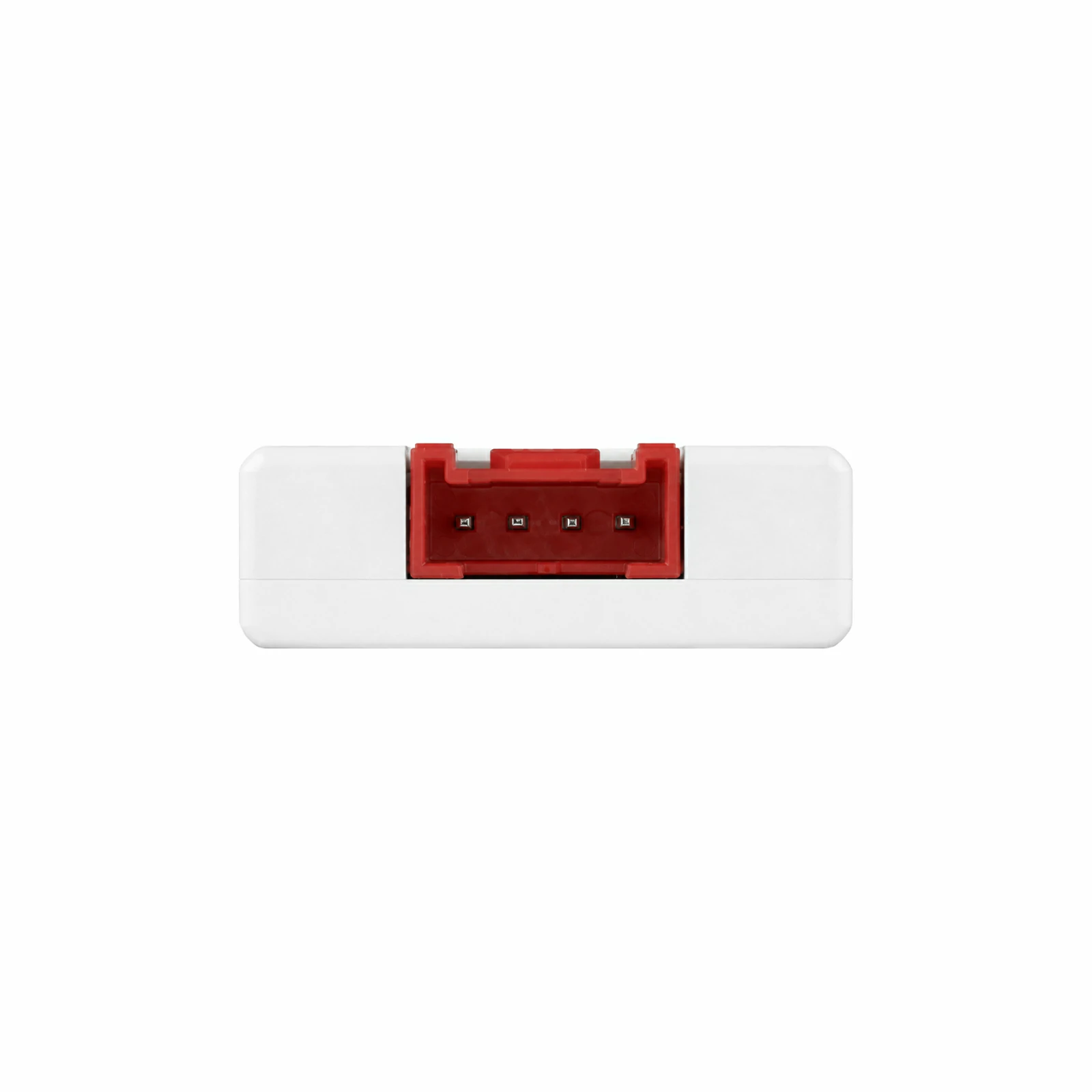

PORT.A GND 5V SDA SCL
BMM350: 0x14
BMM350: 0x14
SPA06-003: 0x76
0x14
