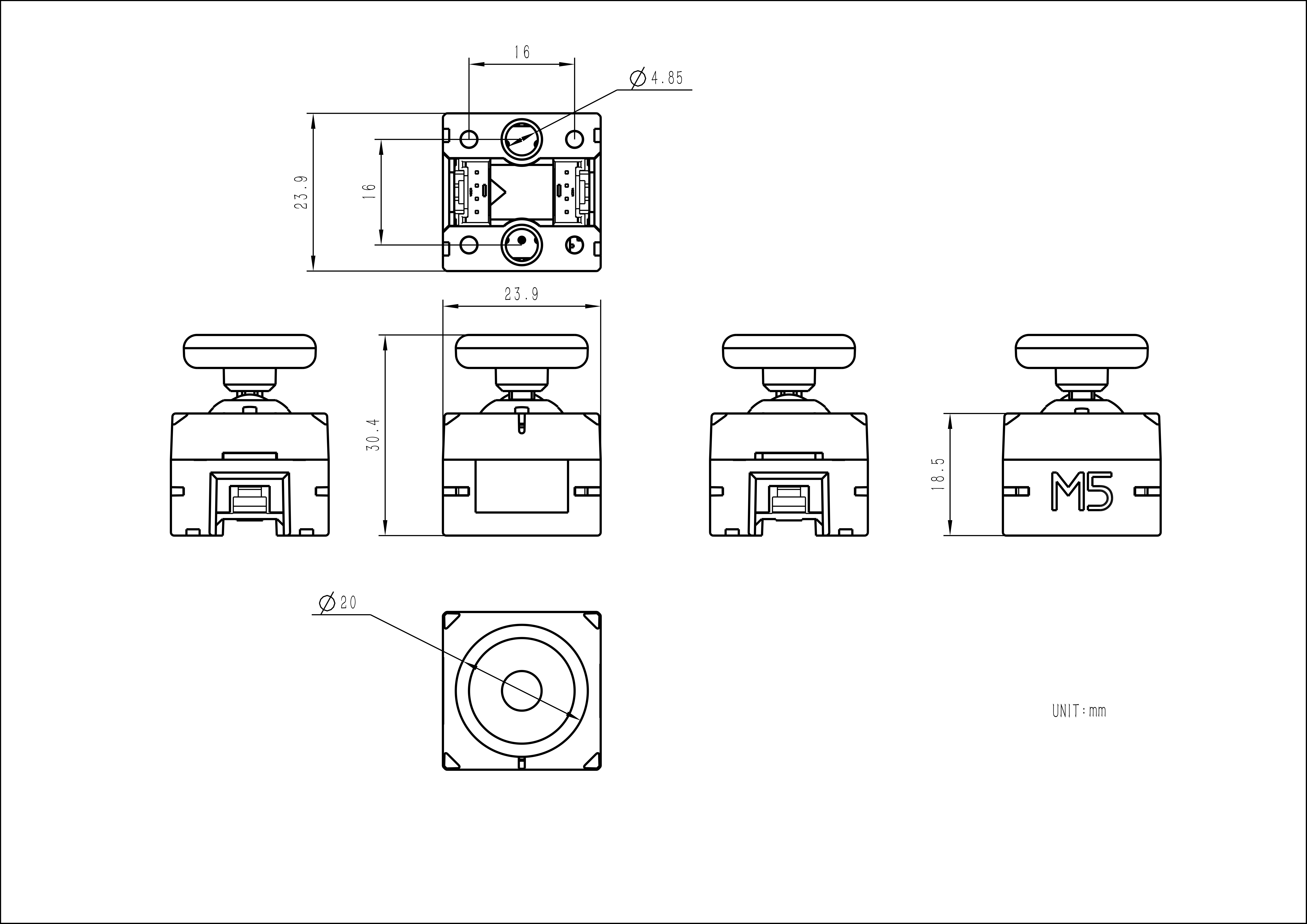

Product Size 23.9 x 23.9 x 30.4mm

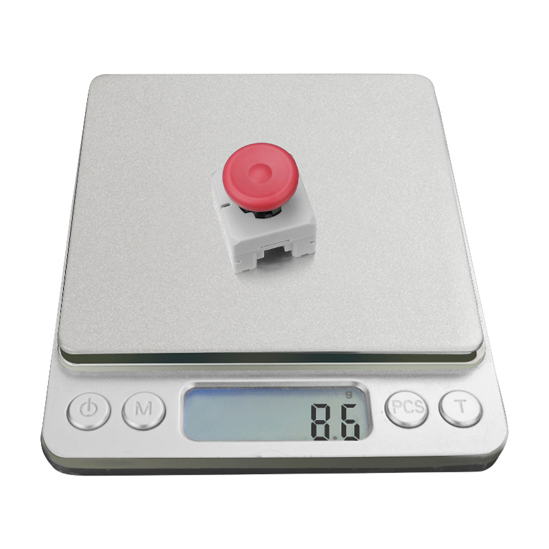

Product Weight 8.6g
Package Size 138.0 x 93.0 x 25.0mm
Gross Weight 12.0g

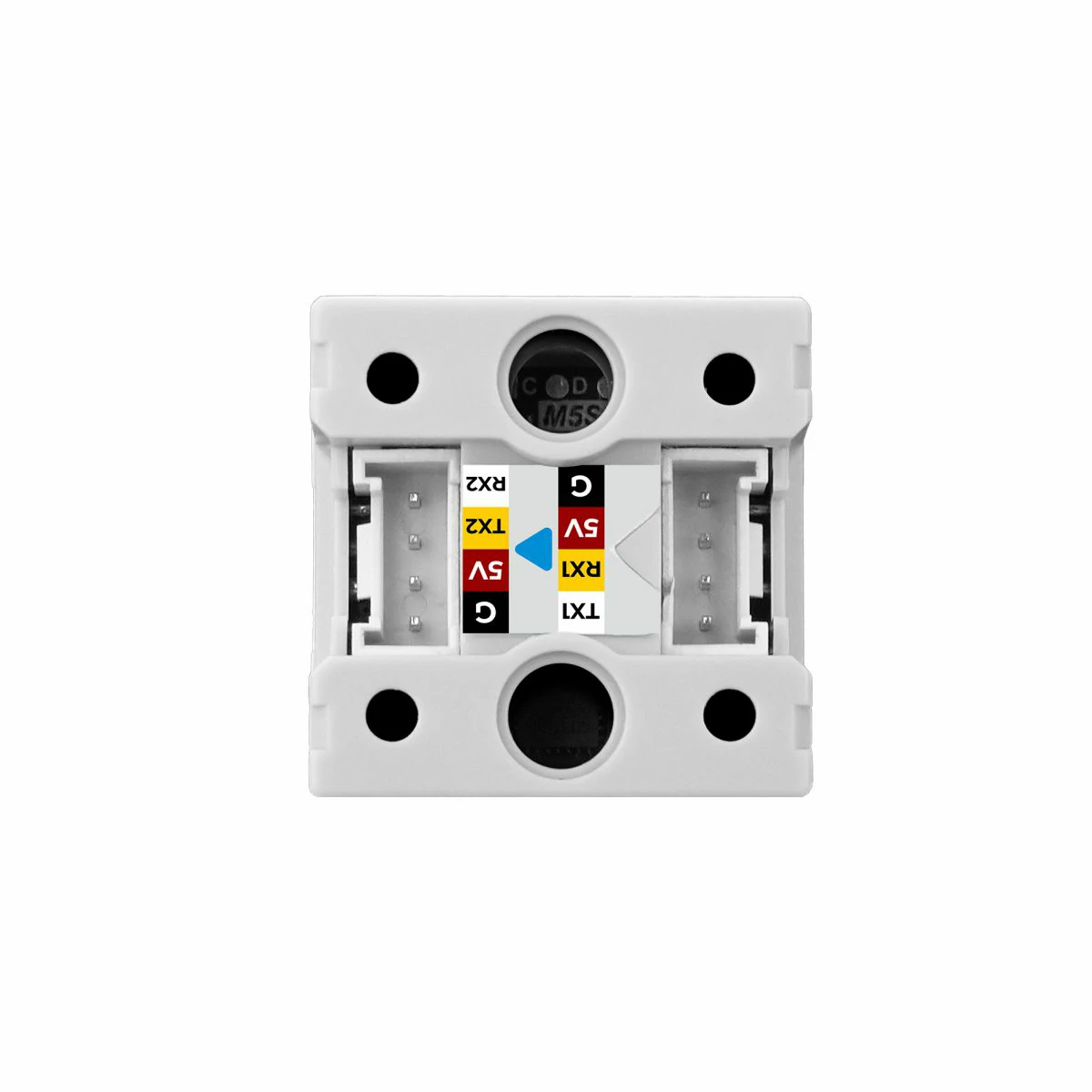

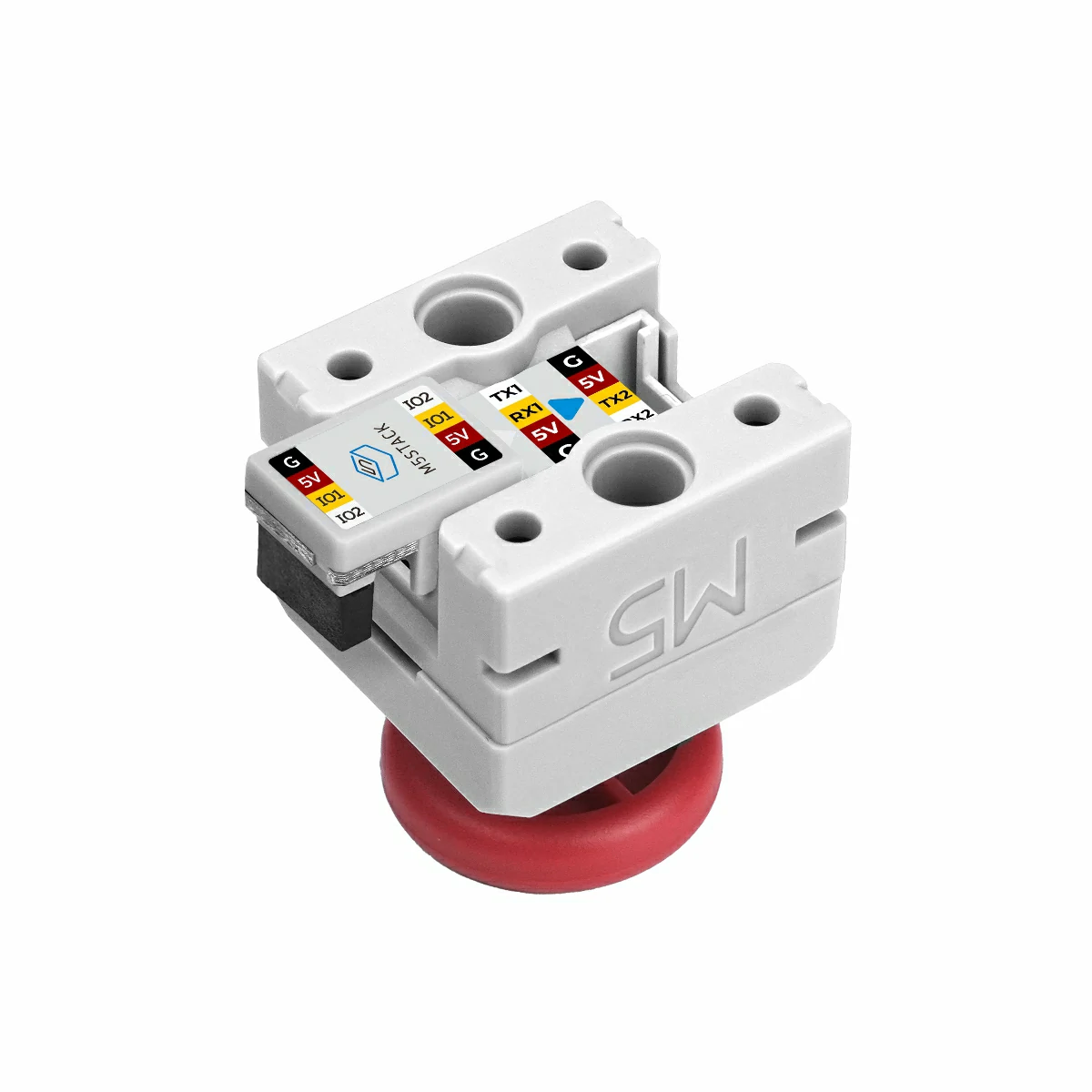

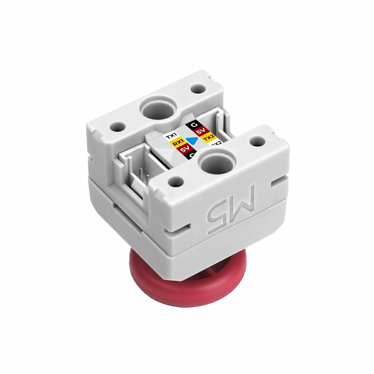

Use the Chain Bridge connector to connect the Chain main controller (such as Chain DualKey / Chain Captain) and various Chain series input devices. Pay attention to the direction when connecting; the triangular arrow should point outward from the main controller, as shown below:
