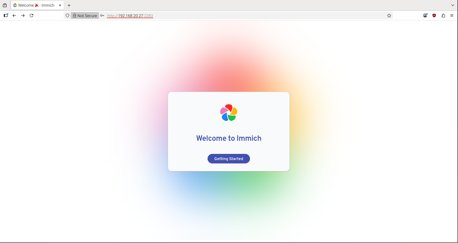

In your browser, enter the Raspberry Pi IP address and port 3003, for example: 192.168.20.27:3003
Note: The first visit requires registering an administrator account; the account and password are saved locally.

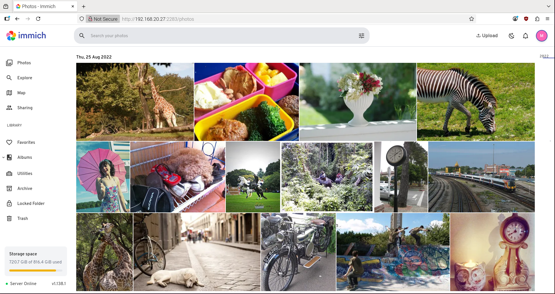

Once configured, you can upload images.

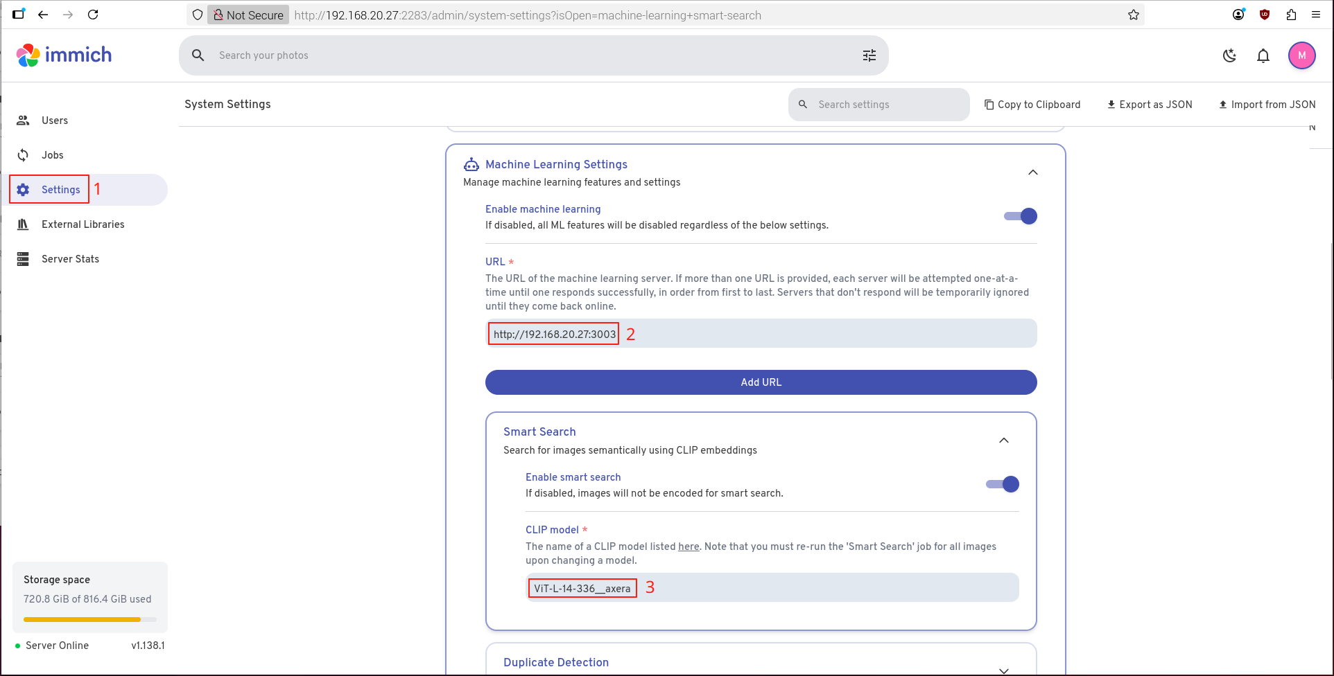

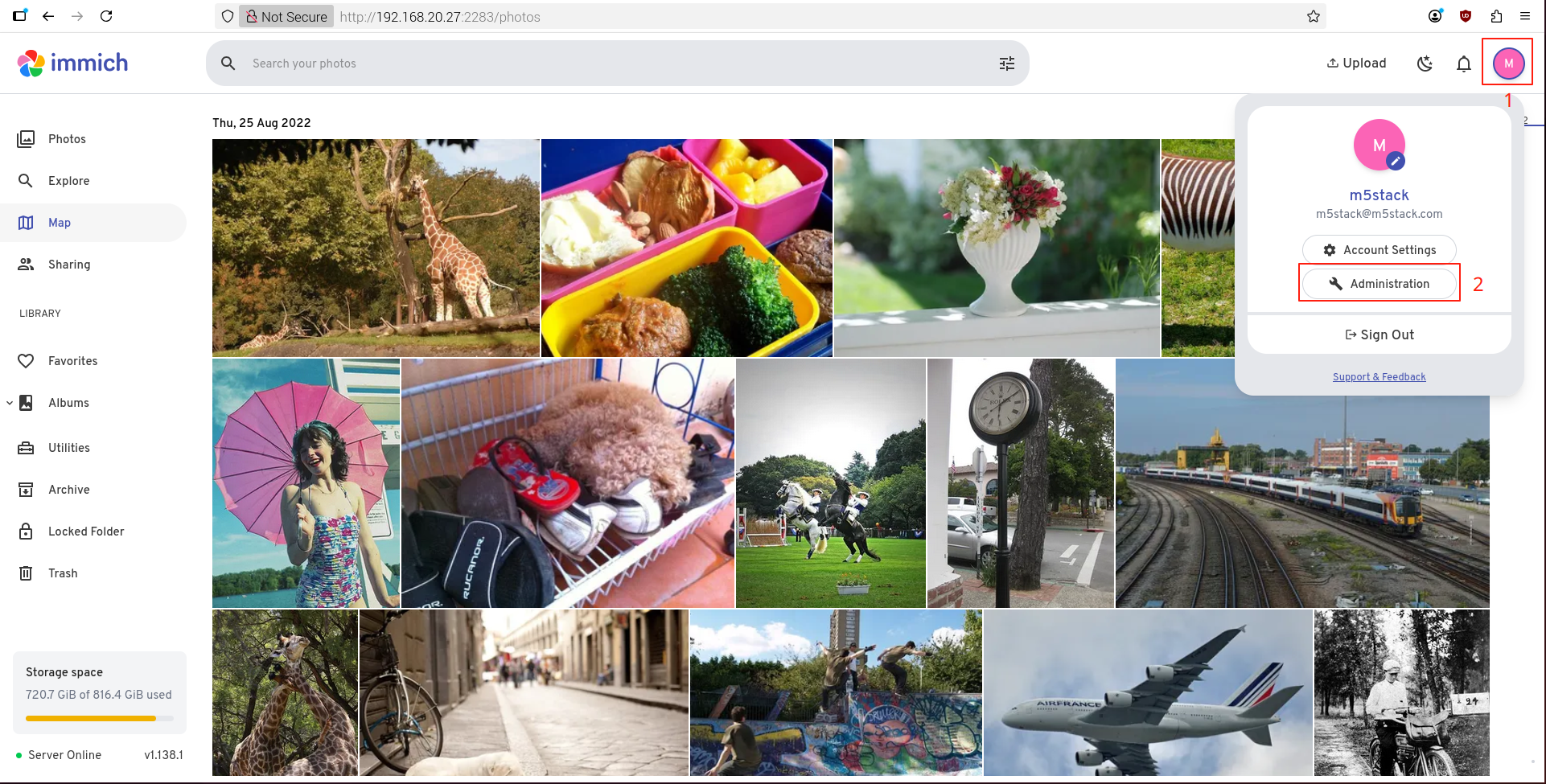

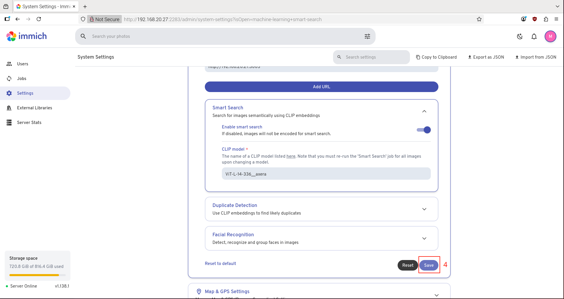

The first time, you need to configure the machine learning server. Refer to the diagram below to enter the configuration.
Set the URL to the Raspberry Pi IP address and port 3003, e.g., 192.168.20.27:3003.
If using Chinese search for the CLIP model, set it to ViT-L-14-336-CN__axera; for English search, set it to ViT-L-14-336__axera.
After setup, save the configuration.

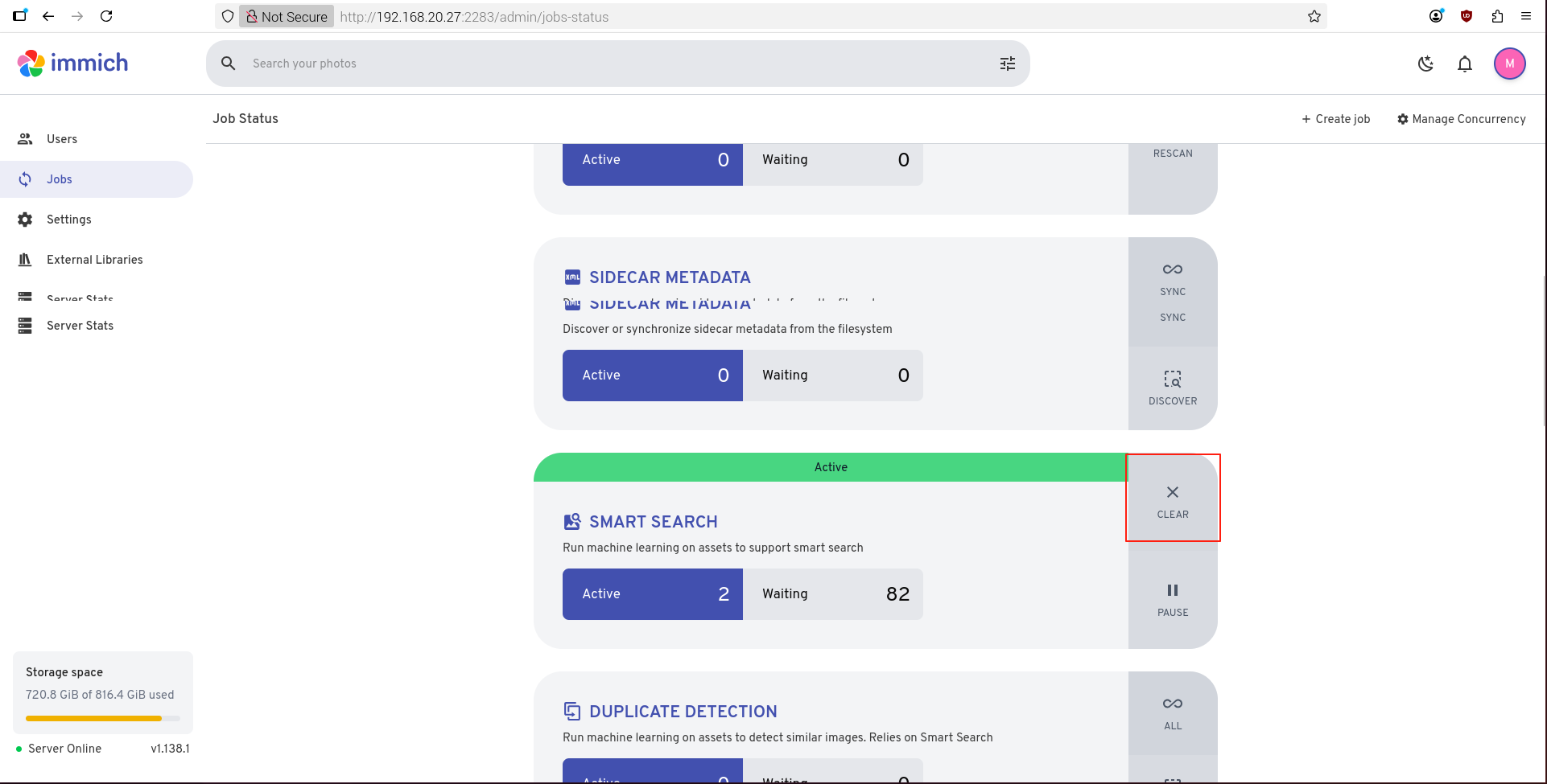

The first time, you need to manually go to the Jobs tab and trigger SMART SEARCH.

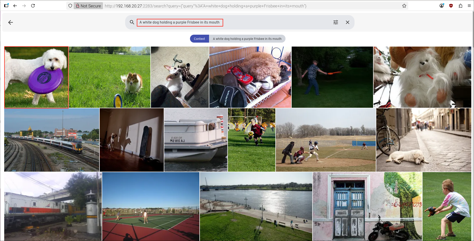

Enter the description of the image in the search bar to retrieve relevant images.
