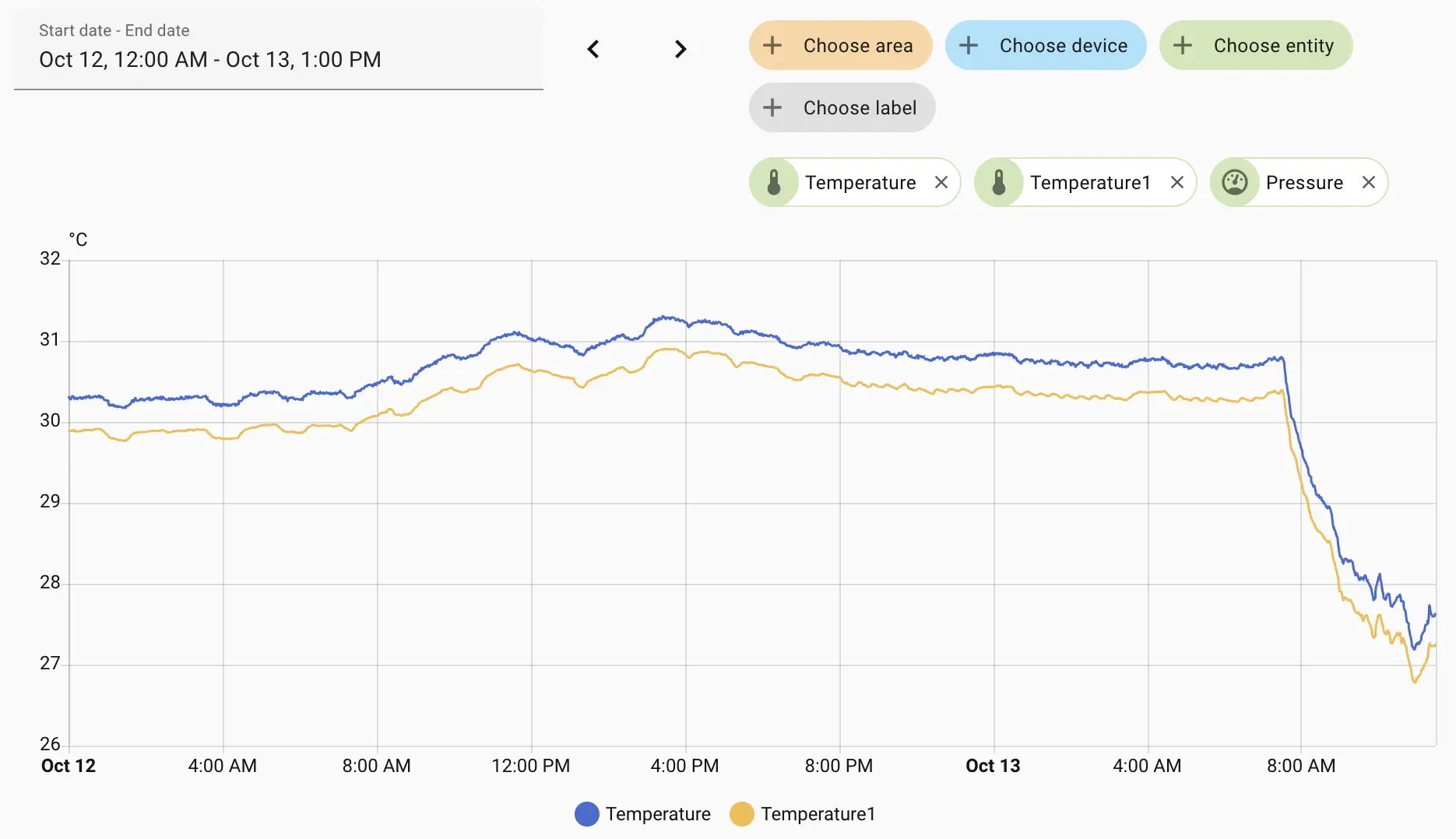

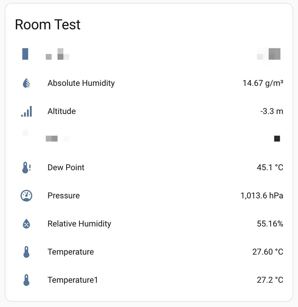

Add Sensor to Home Assistant
After adding the device to the dashboard
Monitoring the temperature
Info
There are two temperature lines since BMP280 also has a temperature sensor.

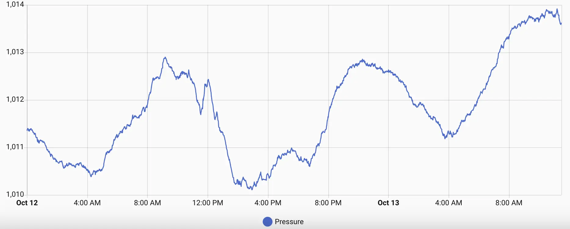

Monitor changes in atmospheric pressure
