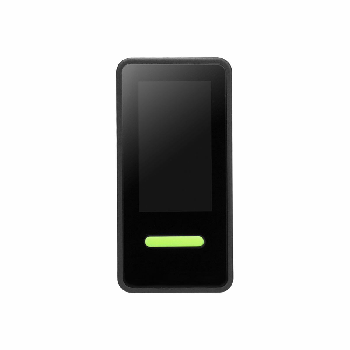

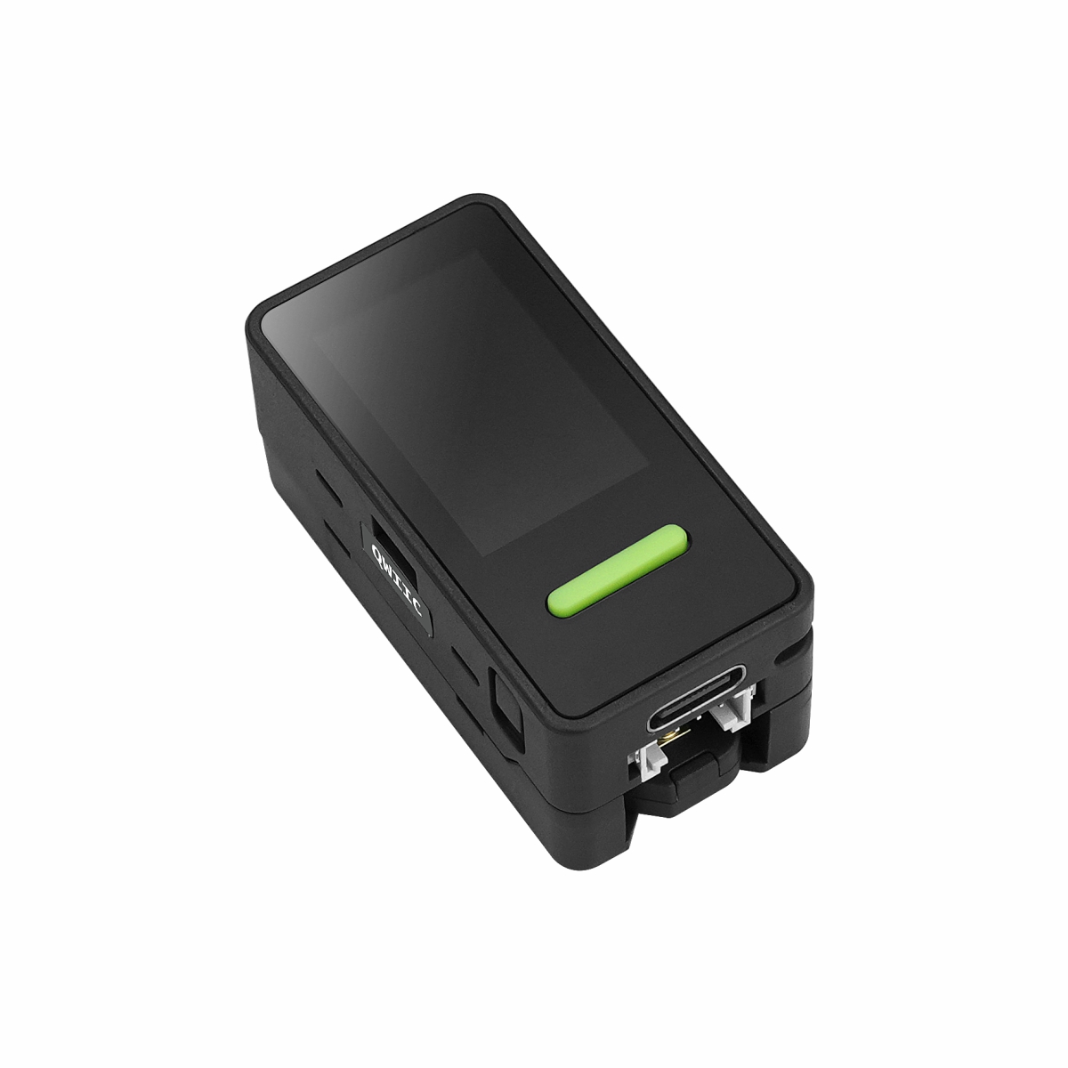

Arduino Nesso N1 is a high-performance all-in-one development board jointly developed by M5Stack and Arduino, designed for remote monitoring and automation control. The device uses ESP32-C6 SoC, supporting 2.4 GHz Wi-Fi 6, Thread, Zigbee, and Matter communication protocols. It also integrates an SX1262 LoRa transceiver, supporting 850 ~ 960 MHz frequency bands. Equipped with a 1.14" LCD touch screen, built-in 6-axis IMU sensor, programmable button, and rechargeable battery, it is an ideal tool for developing complex IoT solutions.

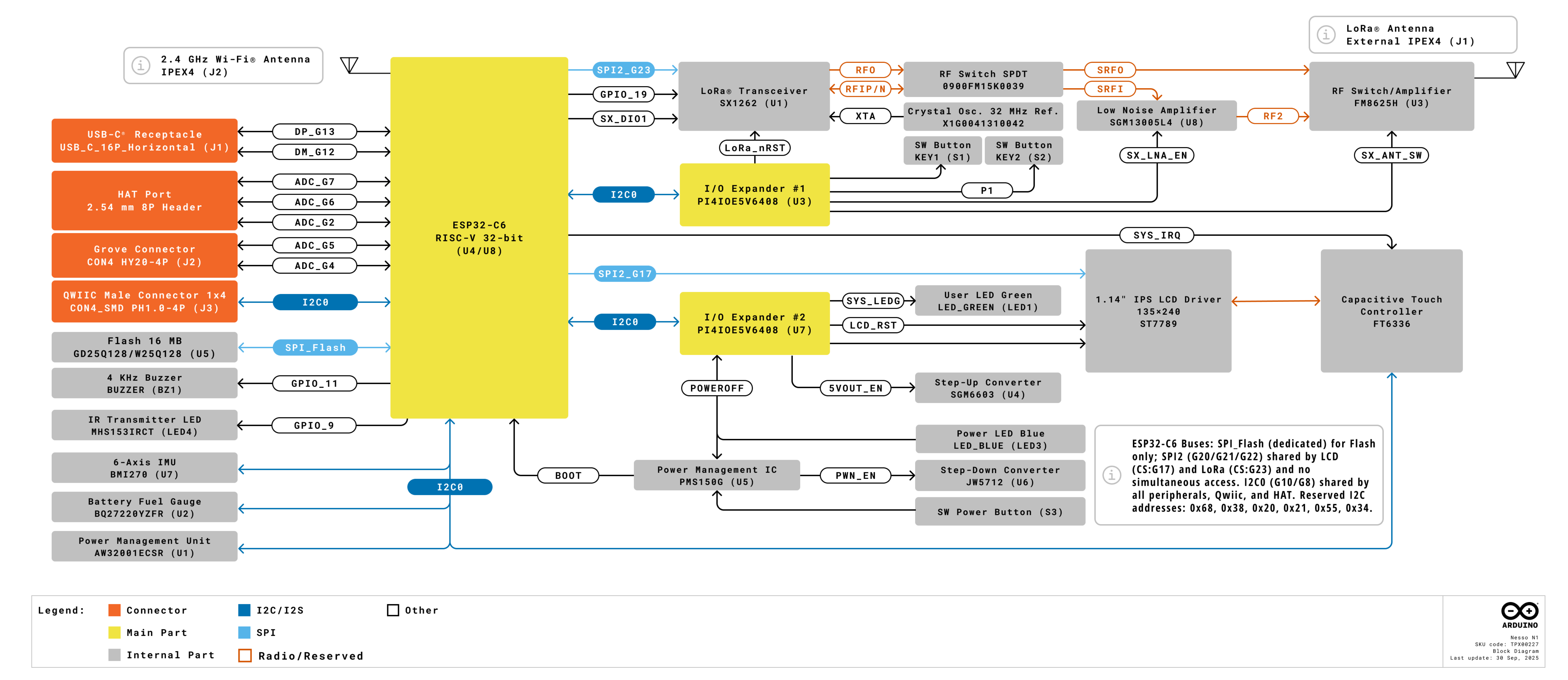

ESP32-C6 G21 G20 G17 G16
ST7789 MOSI SCK CS RS
Touch & IMU
ESP32-C6 G10 G8 G3
FT6336 (0x38) SDA SCL INT
BMI270 (0x68) SDA SCL INT
Power Management
ESP32-C6 G10 G8
BQ27220YZFR (0x55) SDA SCL
AW32001ECSR (0x49) SDA SCL
LoRa
ESP32-C6 G21 G22 G20 G23 G19 G15
SX1262 MOSI MISO SCK CS BUSY IRQ
PI4IOE5V6408
ESP32-C6 G10 G8 ESP_RST
PI4IOE5V6408-0 (0x43) SDA SCL RST
PI4IOE5V6408-1 (0x44) SDA SCL RST
PI4IOE5V6408-0 (0x43) E0.P0 E0.P1 E0.P5 E0.P6 E0.P7
KEY1 INPUT
KEY2 INPUT
SX1262 SX_LNA_EN SX_ANT_SW SX_NRST
The following steps are required for LoRa module initialization:
  • Reset the LoRa module: Set SX_NRST low, hold for 100 ms, then set high.
  • Enable the RF antenna switch: Set SX_ANT_SW high.
  • Enable the LNA chip: Set SX_LNA_EN high.
PI4IOE5V6408-1 (0x44) E1.P0 E1.P1 E1.P2 E1.P5 E1.P6 E1.P7
Device Power PWR_OFF_PULSE
LCD LCD_RESET LCD_BACKLIGHT
GROVE GROVE_POWER_EN
USB USB_VIN_DETECT
LED LED_EN
Buzzer & IR
ESP32-C6 G11 G9
Buzzer BEEP
IR IR_TX

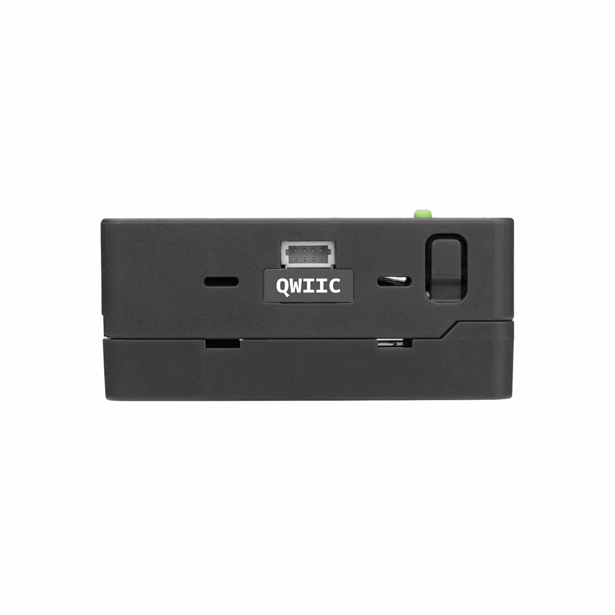

QWIIC Connector
ESP32-C6 GND 3V3 G10 G8
QWIIC GND 3V3 SDA SCL
PORT.A GND 5V G5 G4
USB
ESP32-C6 G13 G12
USB USB_D+ USB_D-
Hat Bus
Hat Bus Arduino Nesso N1
1 5V_IN
2 3V3
3 BAT
4 G6
5 G2
6 G7
7 5V_OUT
8 GND
