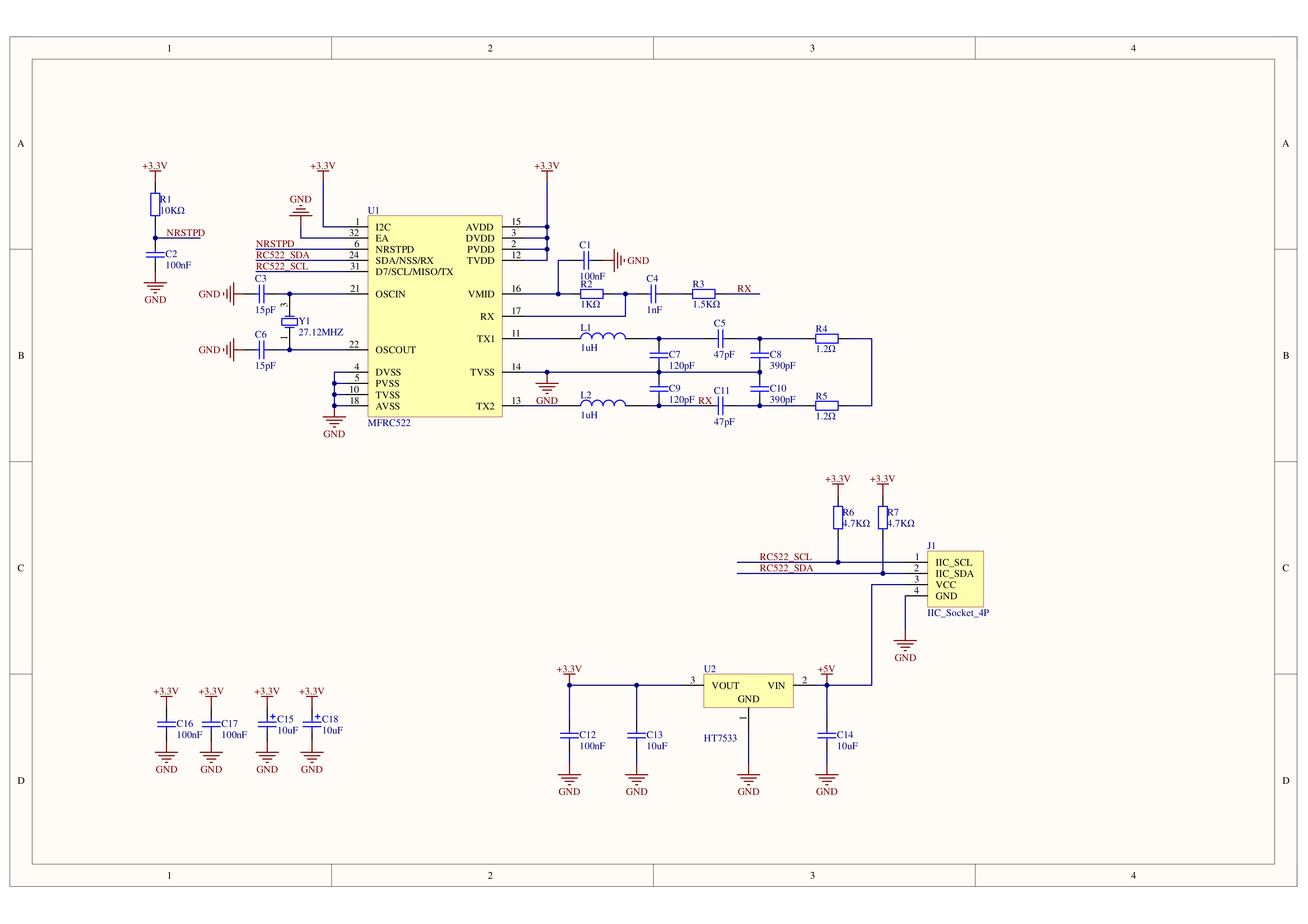

Unit RFID2 is a radio frequency identification (RFID) read/write unit based on the 13.56MHz frequency band. It integrates the WS1850S chip and complies with the ISO/IEC 14443 Type A/B standard, supporting data read/write operations for RFID cards such as MIFARE and NTAG series. The unit communicates via the I2C interface, has a read/write distance of less than 20mm, and features a LEGO-compatible mounting hole design, making it easy to integrate into creative structures or secure with screws. It is suitable for access control systems, identity authentication, data logging, and other application scenarios that require information verification.
Compared to the previous-generation Unit RFID, Unit RFID2 only replaces the read/write IC (RC522 -> WS1850S), with no functional differences.

Read/Write IC WS1850S
Operating Freq 13.56MHz
Communication Interface I2C @0x28
Supported Prot ISO/IEC 14443 Type A/Type B

PORT.A GND 5V SDA SCL
