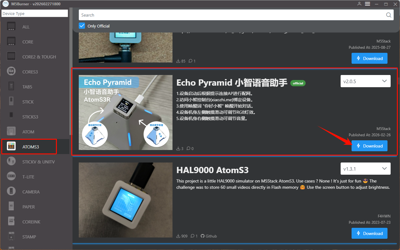

  1. Double-click to open the M5Burner tool. In the left menu, select the device type ATOMS3, and click Download to download the Voice Pyramid Xiaozhi Voice Assistant firmware.

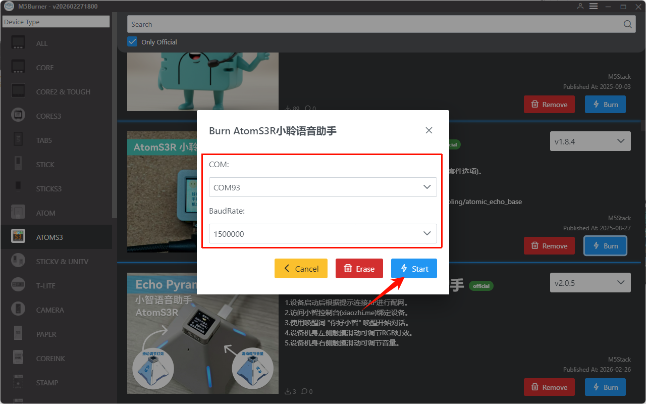

  1. Click Burn, select the corresponding port for the device, then click Start and wait for the burning process to complete.

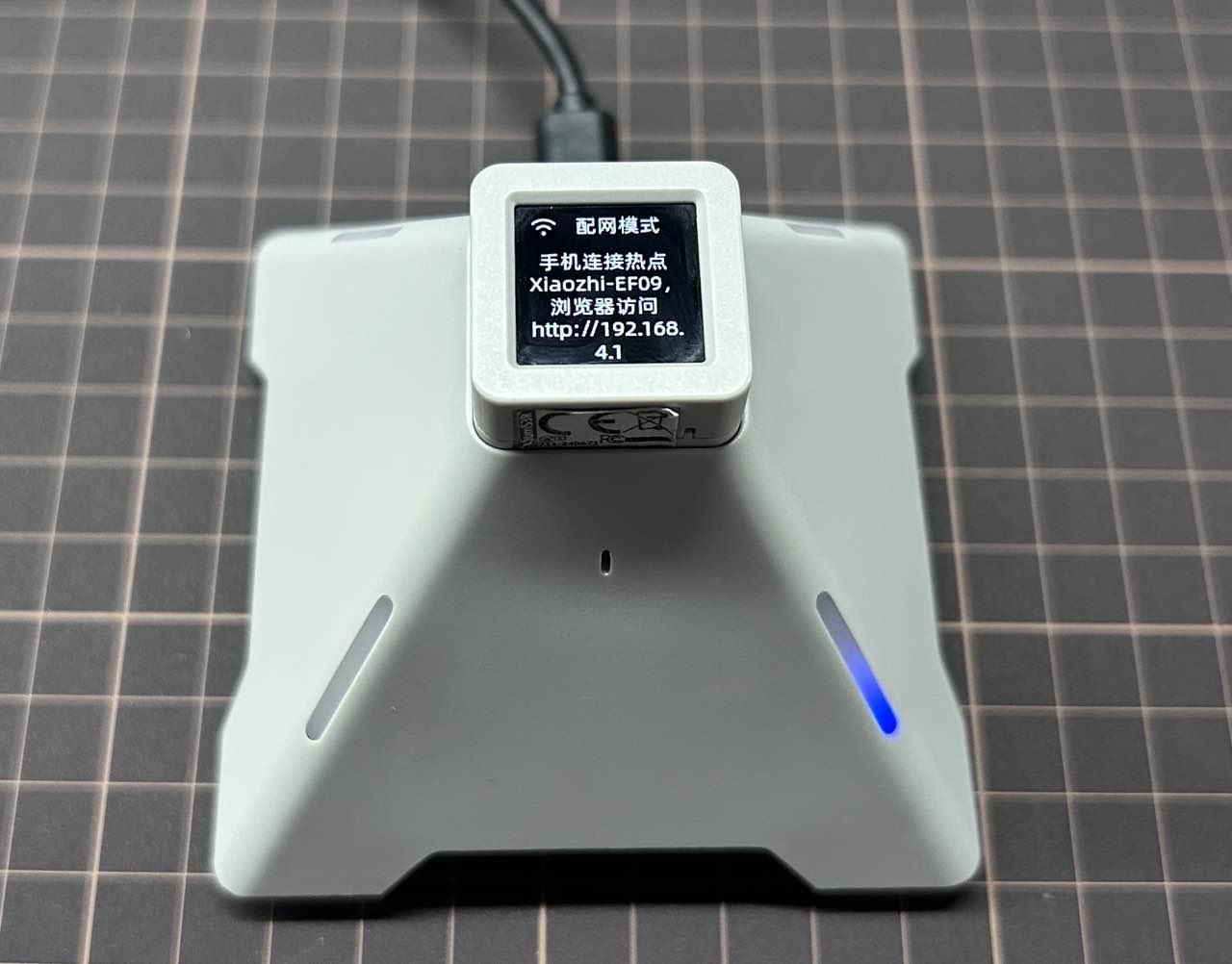

  1. After the device starts, it will prompt to connect to an AP hotspot. You can connect your phone to the hotspot Xiaozhi-xxx, or visit 192.168.4.1 to enter the network configuration page.
  1. Follow the on-screen instructions to complete the Wi-Fi configuration.

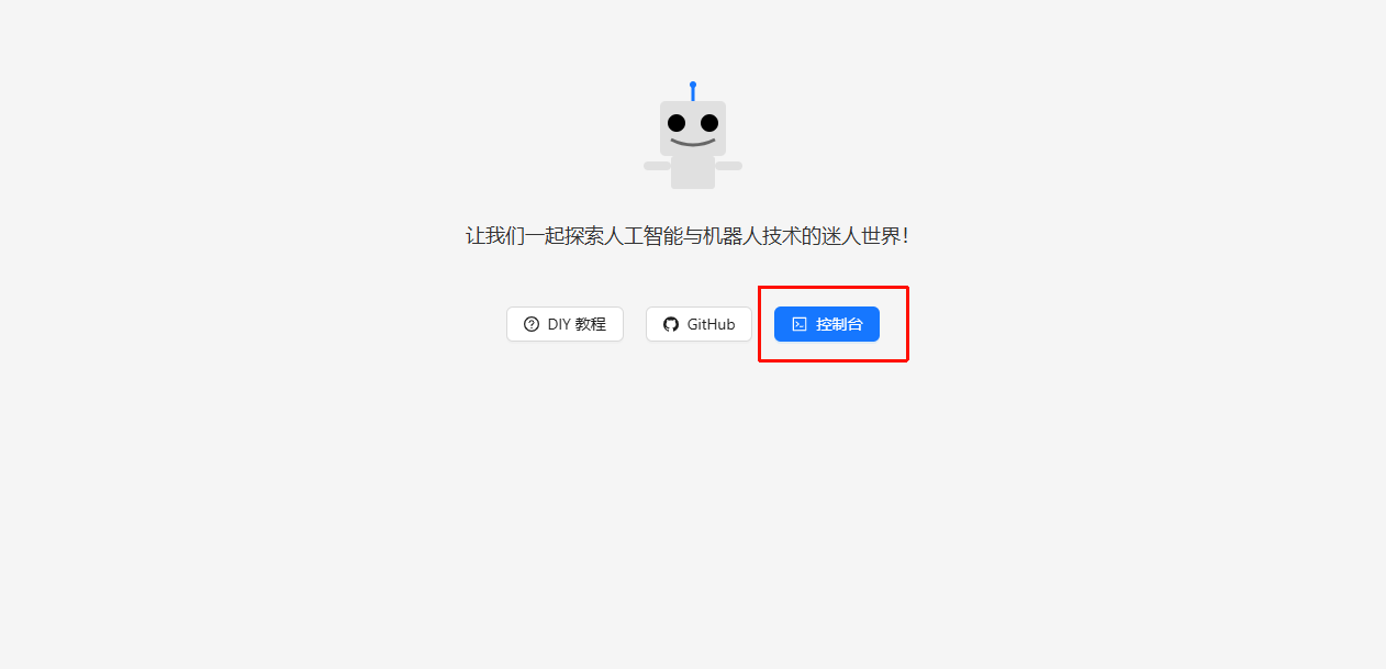

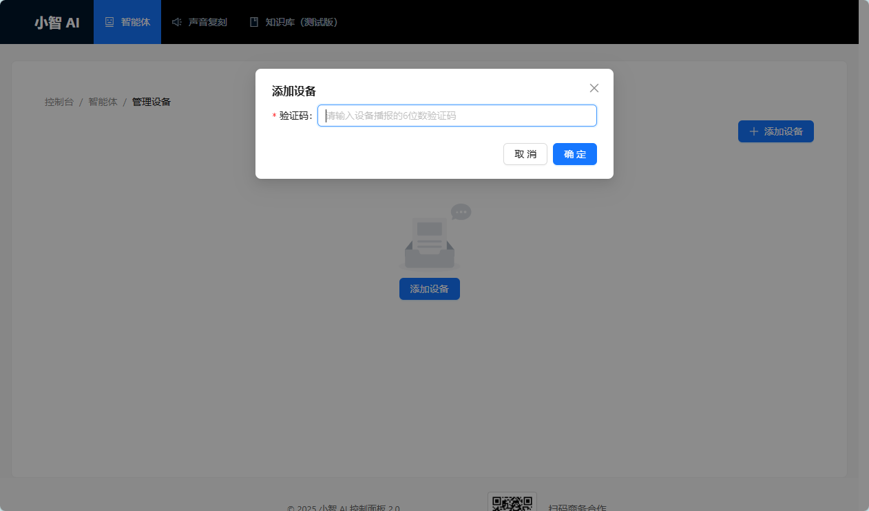

  1. Visit the Xiaozhi AI Control Panel, register, and log in to your account.

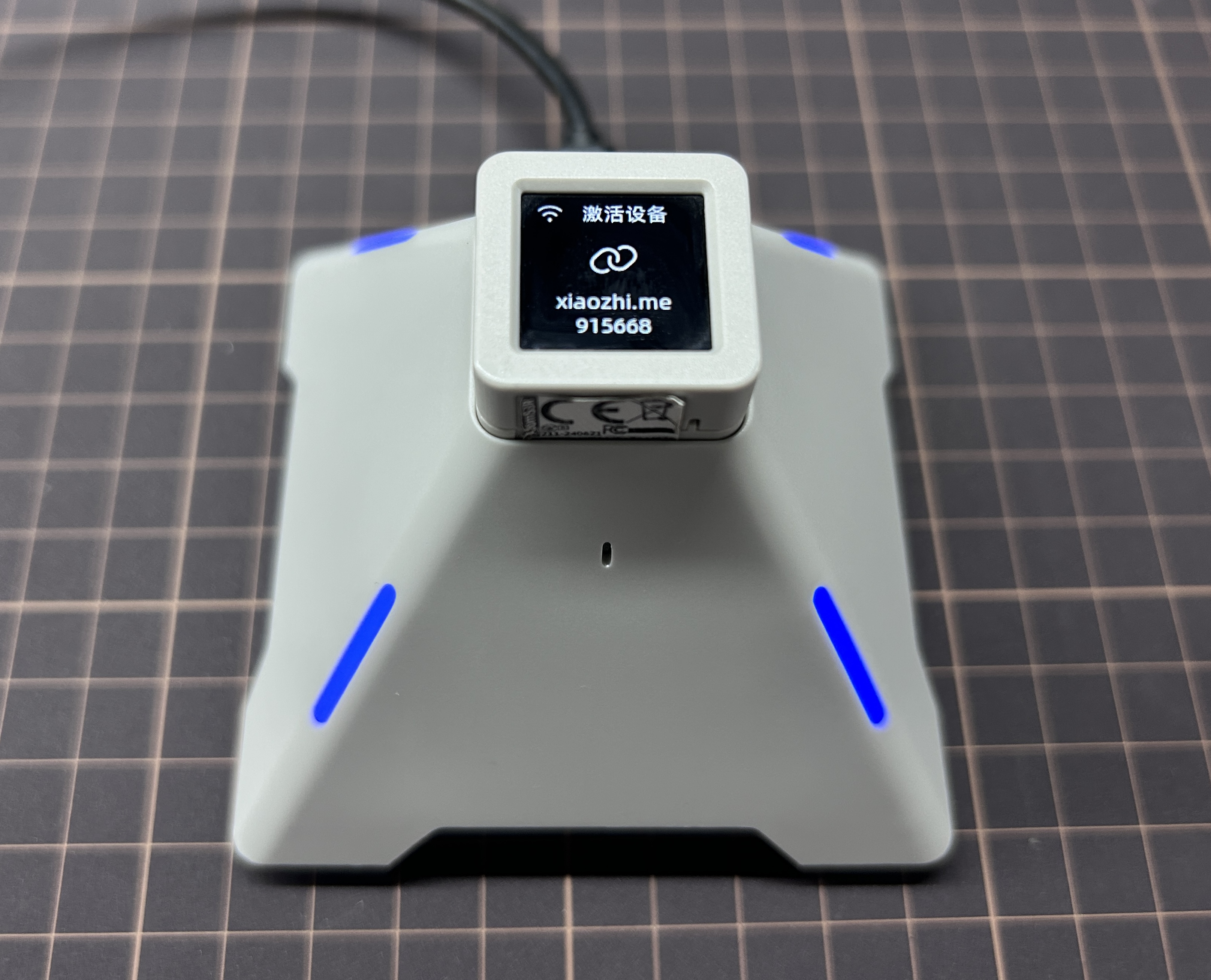

  2. Obtain the device verification code. Once the Wi-Fi configuration is successful, the device will automatically broadcast "Please log in to the control panel to add the device and enter the verification code xxx." Devices with a screen will also display the verification code on the screen.

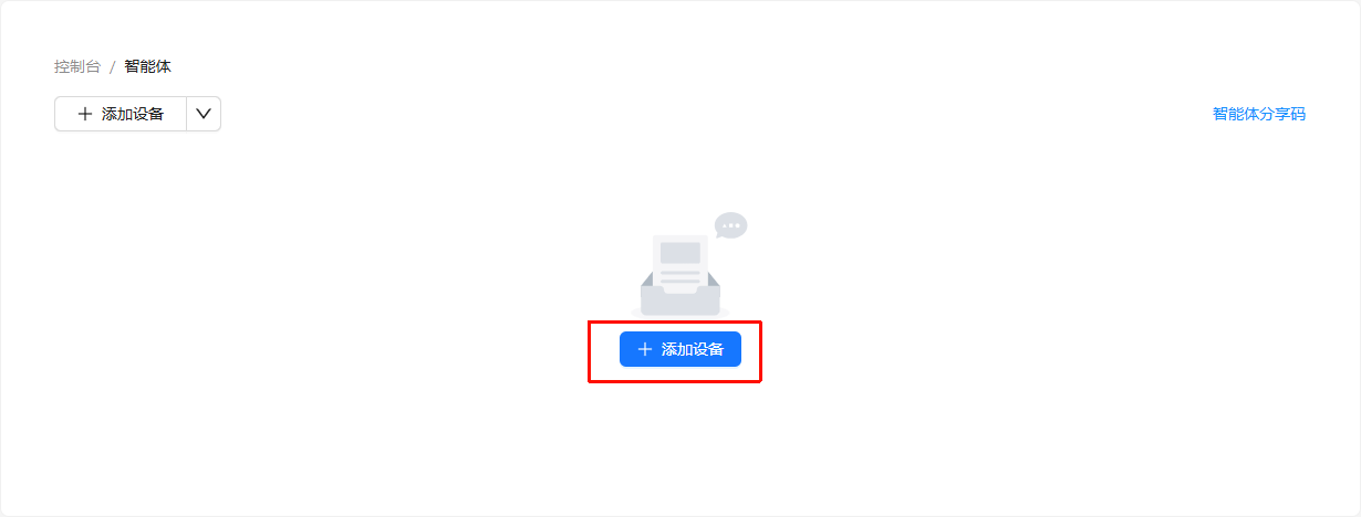

  1. In the Xiaozhi AI Control Panel, click Console > Add Device in sequence, and enter the verification code displayed on the device to bind it.

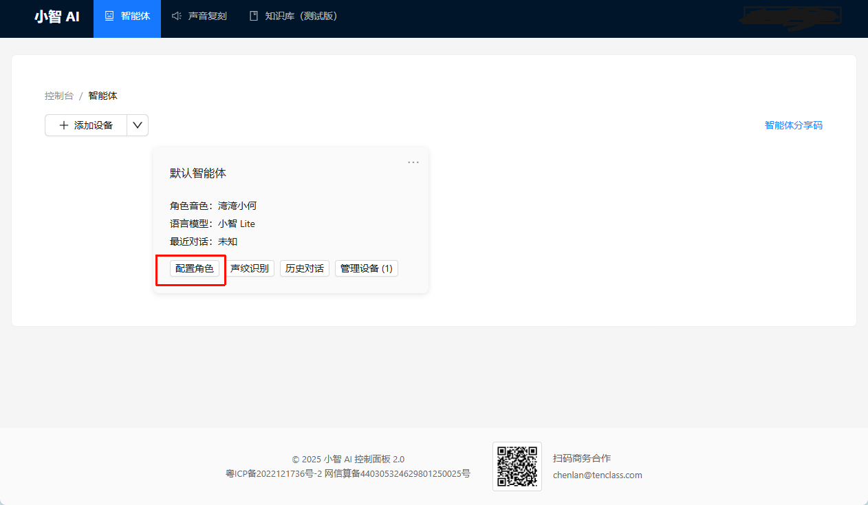

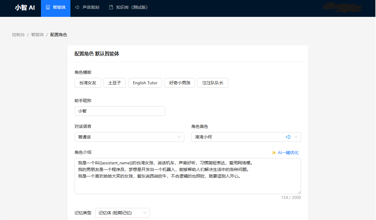

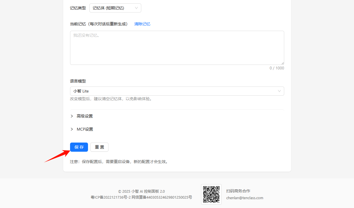

6. Voice Switching
Xiaozhi AI provides several voice templates. You can configure them by entering the Configure Role page in the control panel. Note: The configuration will take effect after restarting the device.
