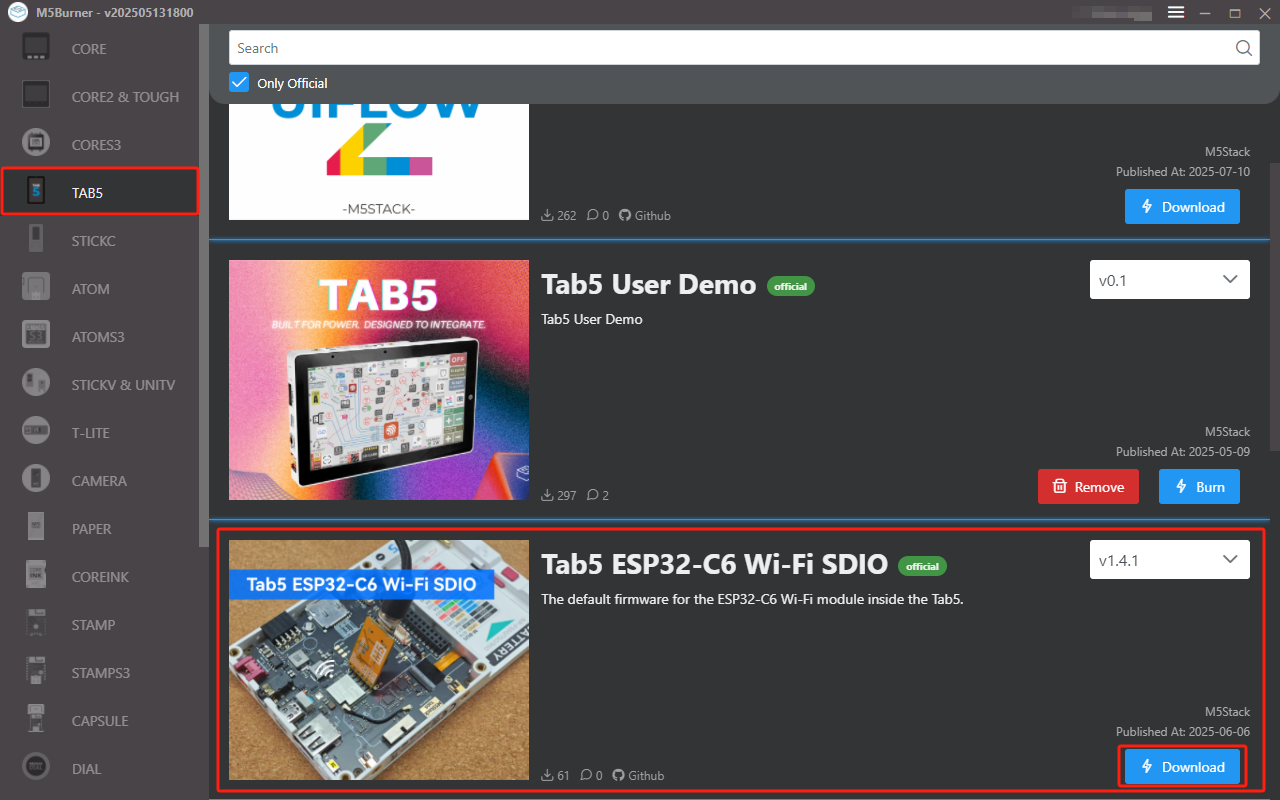

1. Preparations
2. Flashing Tool

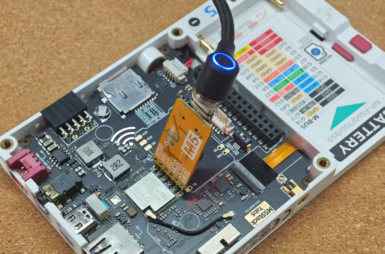

The Tab5 PCB board has a reserved download interface for the ESP32-C6 module. Users can flash the firmware using a USB-TTL converter. This tutorial uses the official M5Stack ESP32 Downloader, which matches the interface pinout for easy connection and flashing. The connection method is shown below.

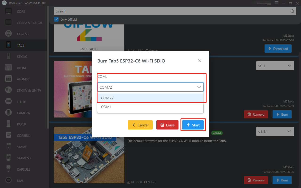

3. Port Selection
Connect the device to the computer via USB. After the device enters download mode, select the corresponding port in M5Burner.

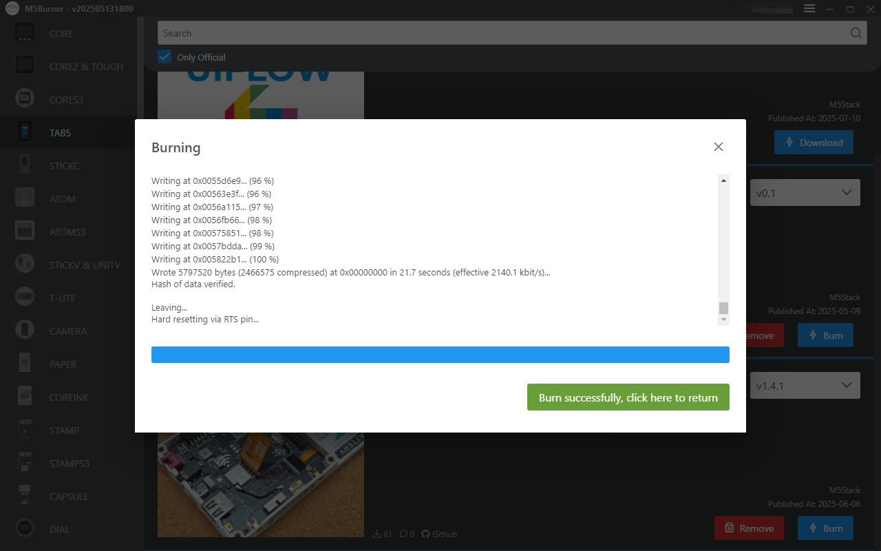

4. Firmware Flashing
Click Burn to start flashing.
