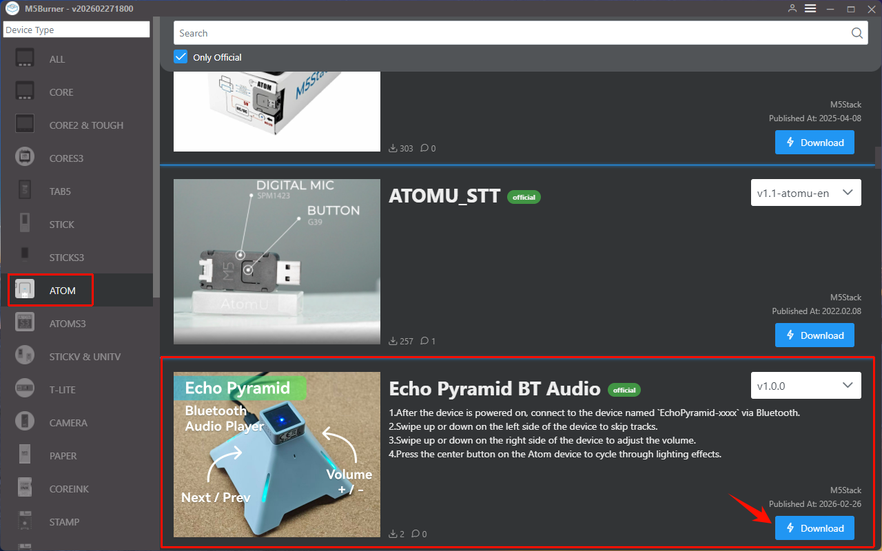

2. Download Firmware
  1. Double-click to open the Burner tool, select the device type ATOM in the left menu, and click Download to download the Voice Pyramid Bluetooth Speaker firmware.

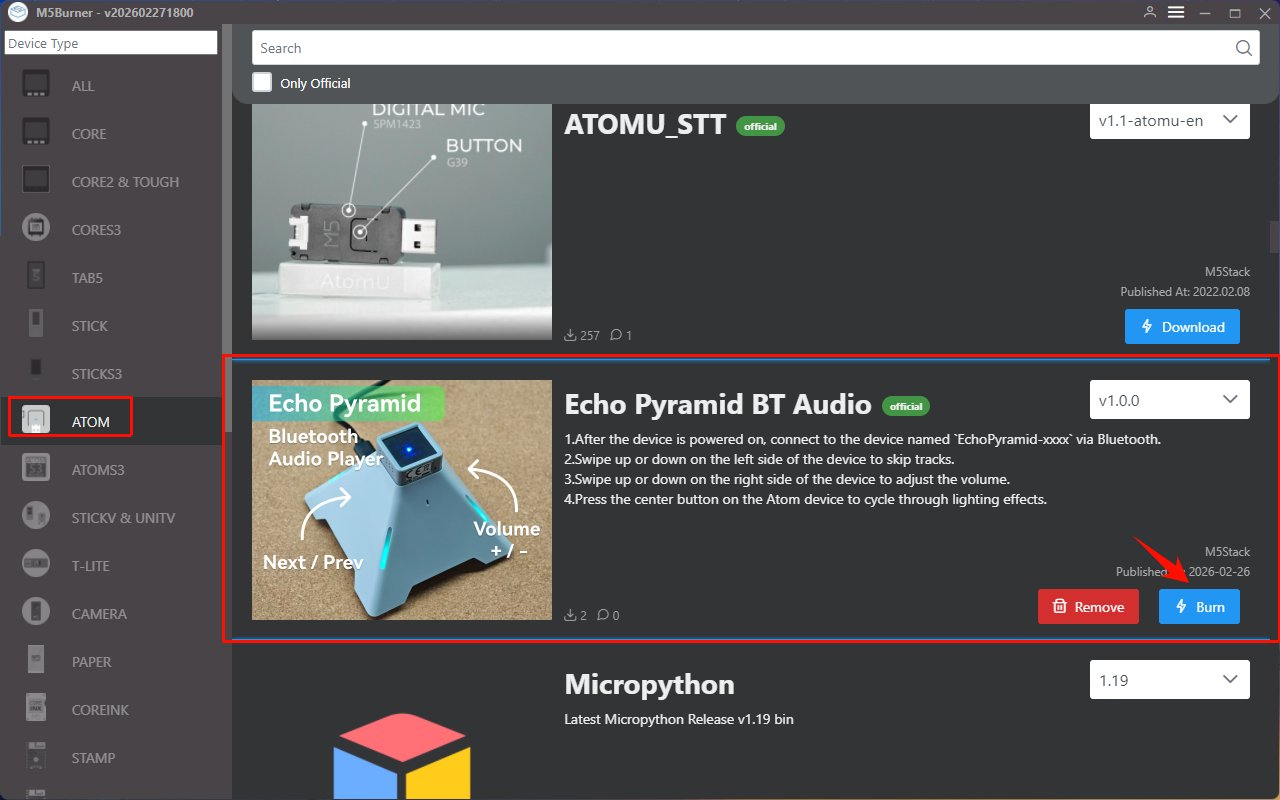

  1. Connect the Atom-Matrix to the computer via a USB cable. Once connected, the software will pop up Found New Device to indicate a successful connection. The screen will not display content as it enters programming mode.

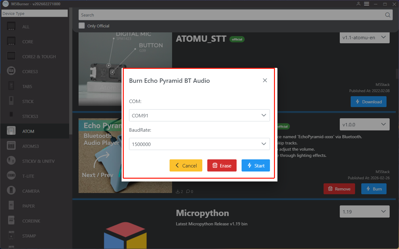

  2. Click the Burn button for the Voice Pyramid Bluetooth Speaker firmware, select the corresponding device port, and click Start to begin burning the firmware.
Baud Rate Limit
When downloading the device program, it is recommended to select from the following serial baud rate options. Using other speeds may result in the program failing to download properly.
1500000 bps / 750000 bps / 500000 bps / 250000 bps / 115200 bps
When "Burn successful, click here to return" appears, the burning process is complete.
