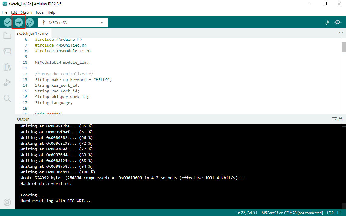

  1. Upload the code to CoreS3.

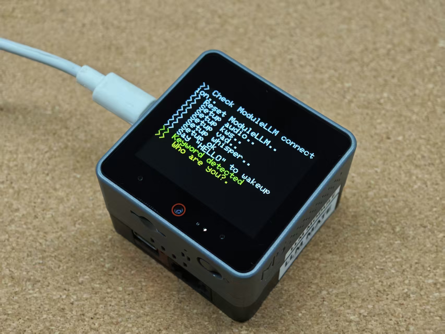

  1. After initialization, use the wake word hello to wake up the module. When successful, “Keyword detected” will be shown. After that, continue speaking, and after a short pause, the audio will be automatically transcribed and the ASR result will be displayed.
