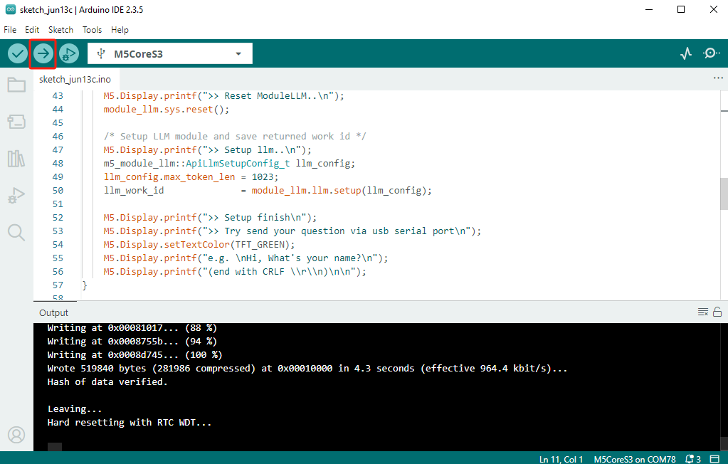

  1. Upload the code to CoreS3.

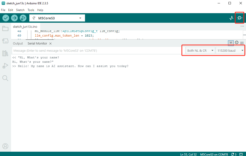

  2. Open the Serial Monitor in Arduino IDE, set the baud rate to 115200, and configure "Line Ending \r\n". Enter text in the Serial Monitor and press Enter to send. Module LLM will process the input and return a response.
