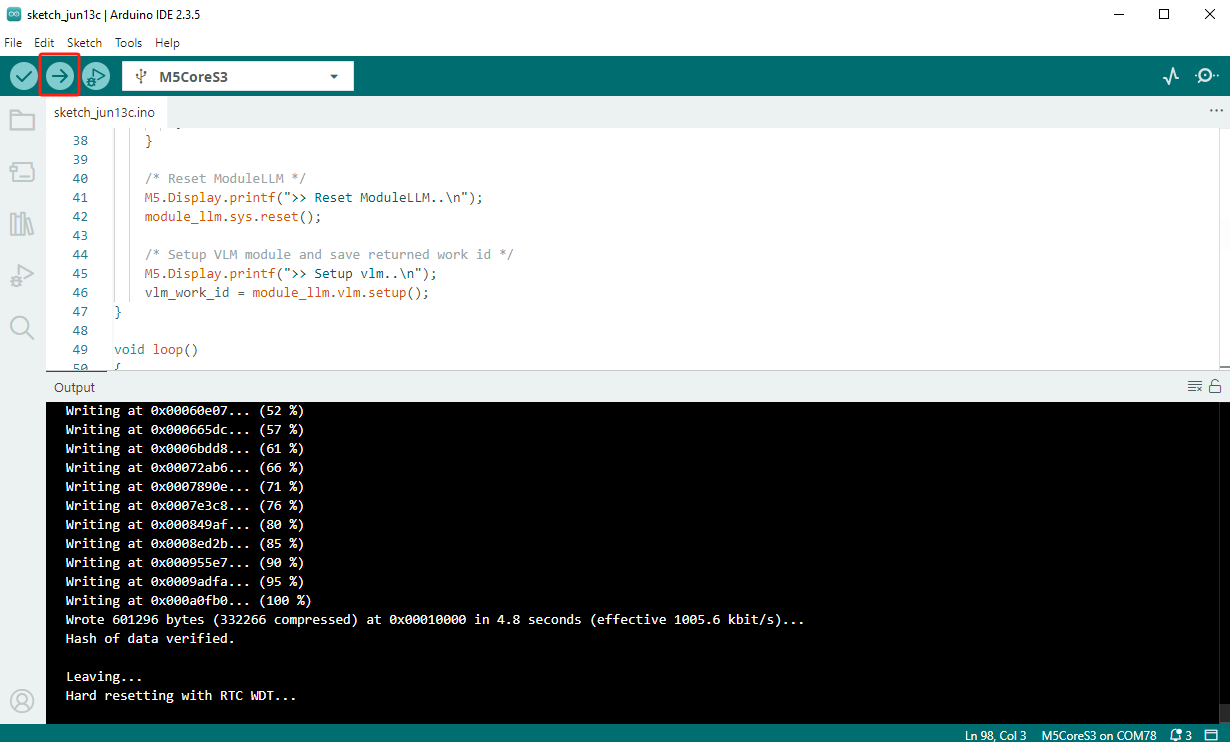

  1. Upload the code to CoreS3.

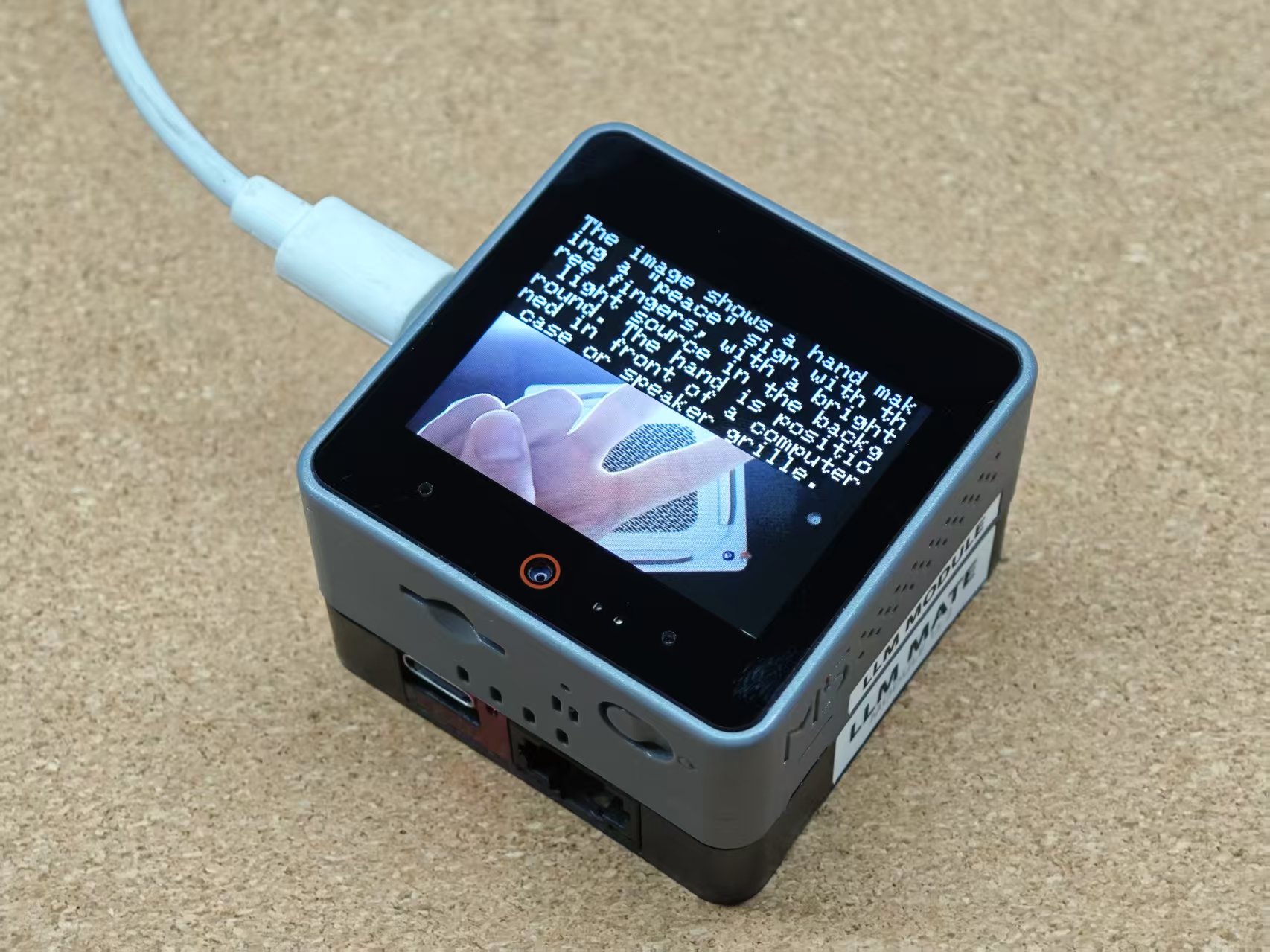

  1. Wait for initialization to complete, and the camera view will be displayed. Double-tap the screen to take a photo and wait for the model to return the result.
  1. Swipe the screen to clear the displayed text.
