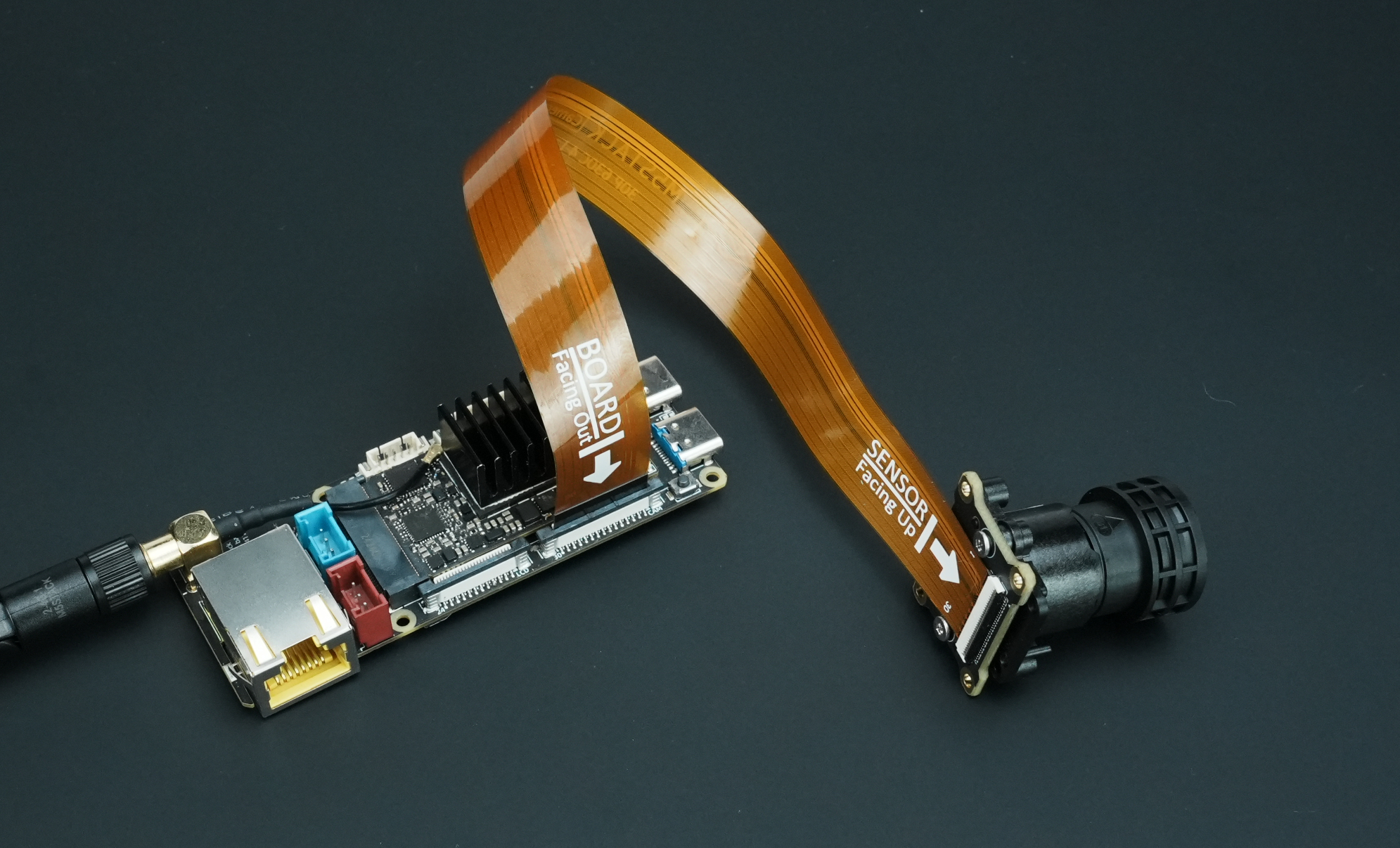

  1. Before powering on the device, connect the CamModule SC850SL camera to the LLM630 Compute Kit using an FPC cable as shown below:

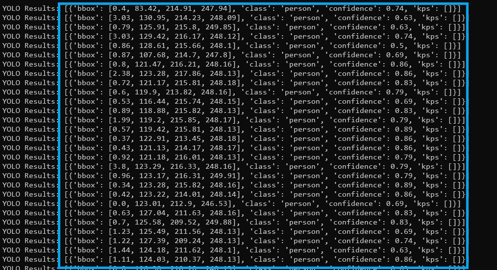

3. Start Interaction
The terminal will print YOLO detection results.
