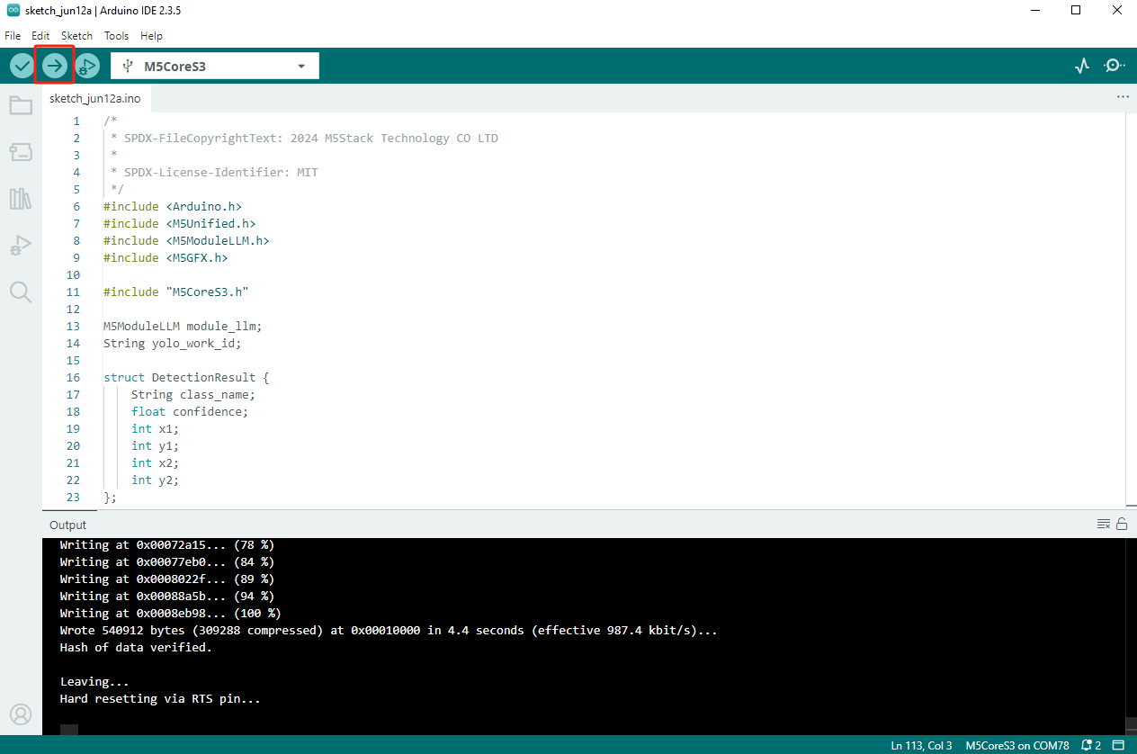

  1. Upload the code to CoreS3.

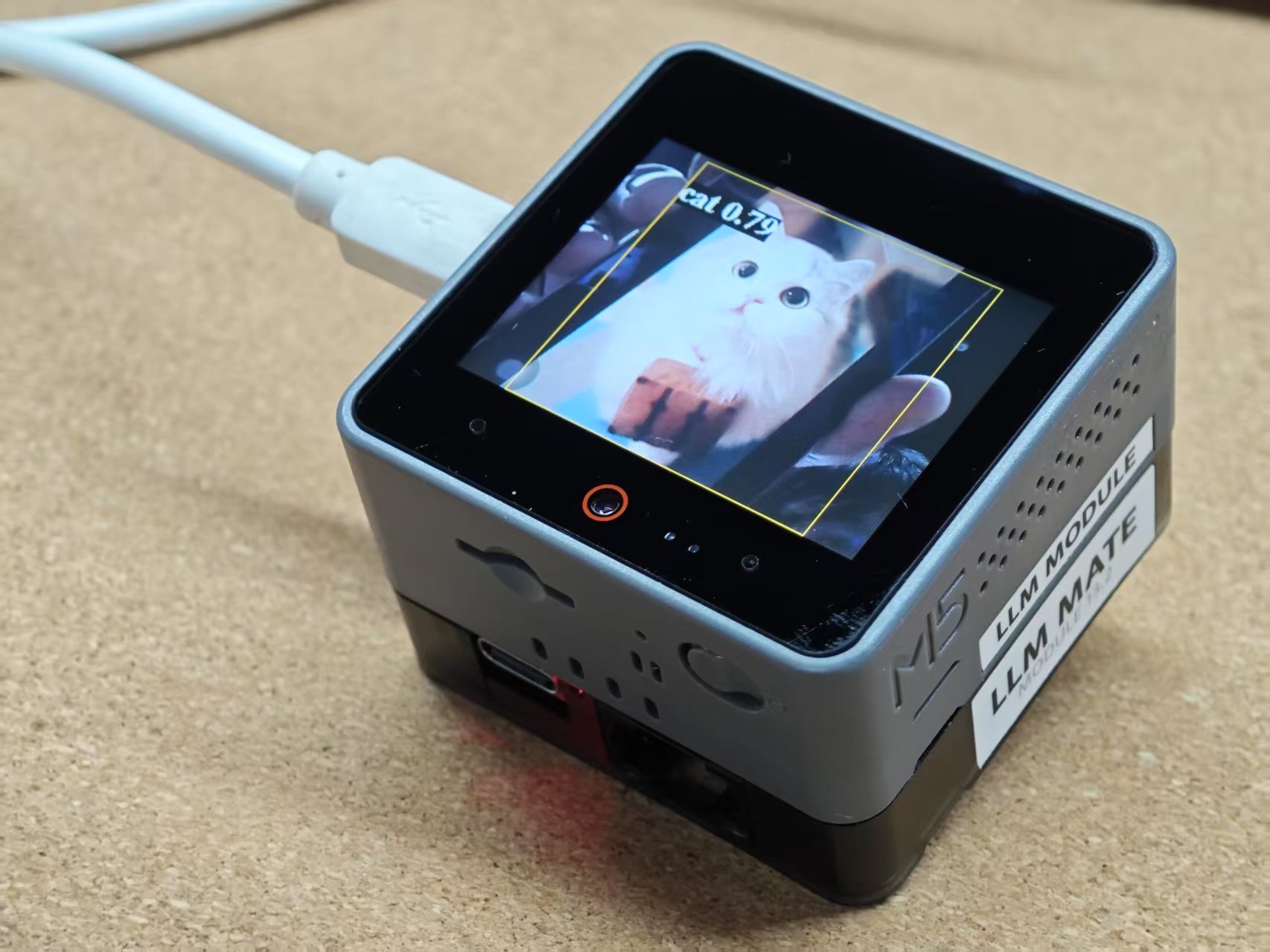

  1. Wait for initialization to complete and enter detection mode. The detection results will be displayed on the screen.

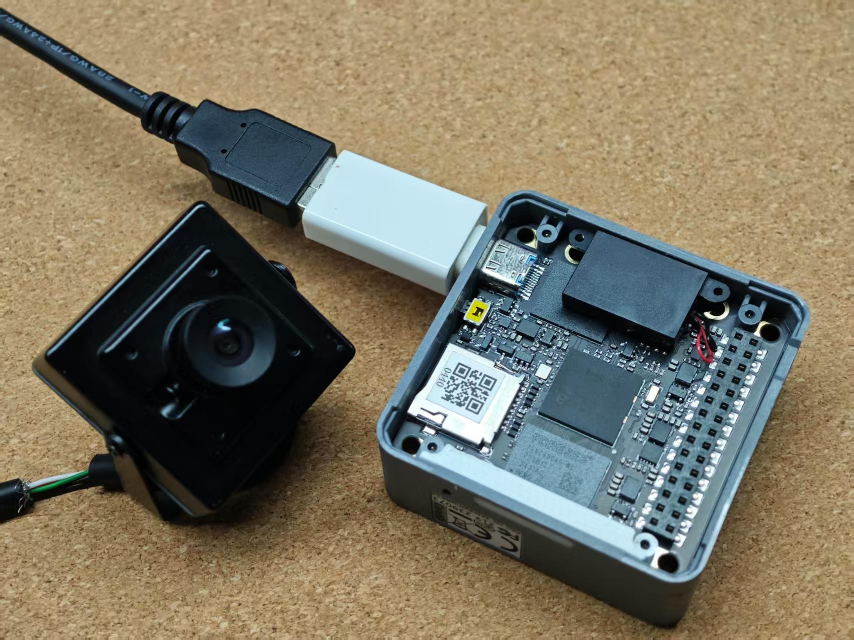

  1. Connect the USB camera to the Module LLM. Since the Module LLM does not have a USB-A port, a USB-A to USB-C adapter is required.

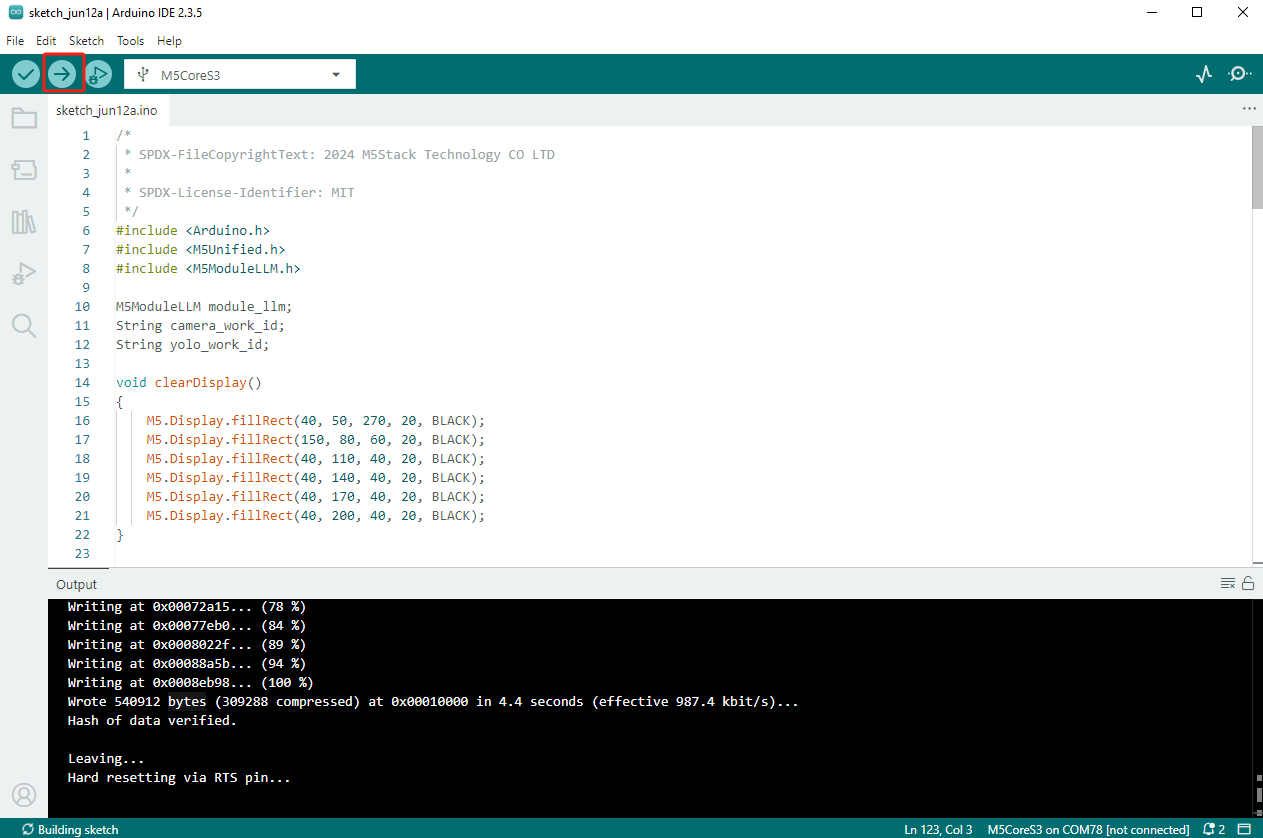

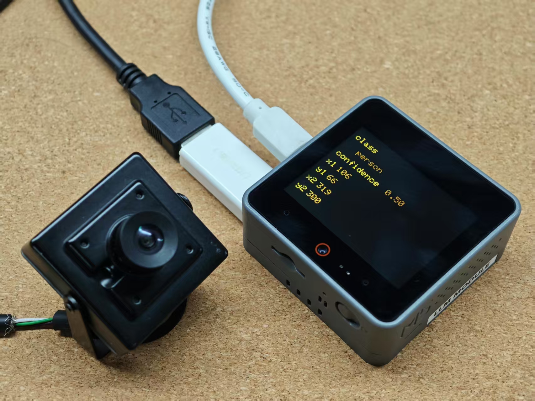

  1. Wait for initialization to complete, and enter detection mode. The detection results will be displayed on the screen in text format.
