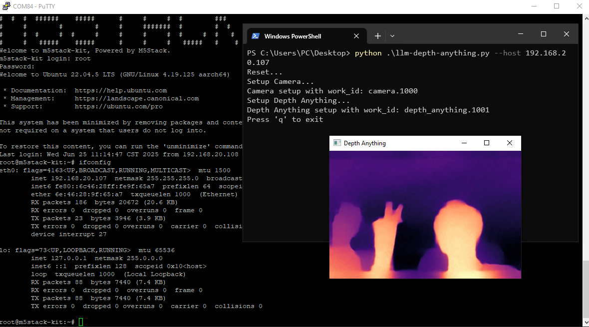

2. Client Script
Download the test client script and ensure your PC is on the same subnet as the LLM630 Compute Kit. On the PC, install opencv-python using pip:
pip install opencv-python
pip install opencv-python -i https://mirrors.aliyun.com/pypi/simple # For Chinese users
Copy and save the following script. Run it with the actual device IP address:
python llm-depth-anything.py --host 192.168.20.24

3. Start Interaction
The camera view and depth detection result will be shown on the PC screen, as illustrated below. Press the "q" key to exit.
