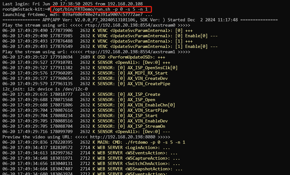

  1. After accessing the terminal, run the following command to start the IPC camera service:
/opt/bin/FRTDemo/run.sh -p 0 -s 5 -n 1

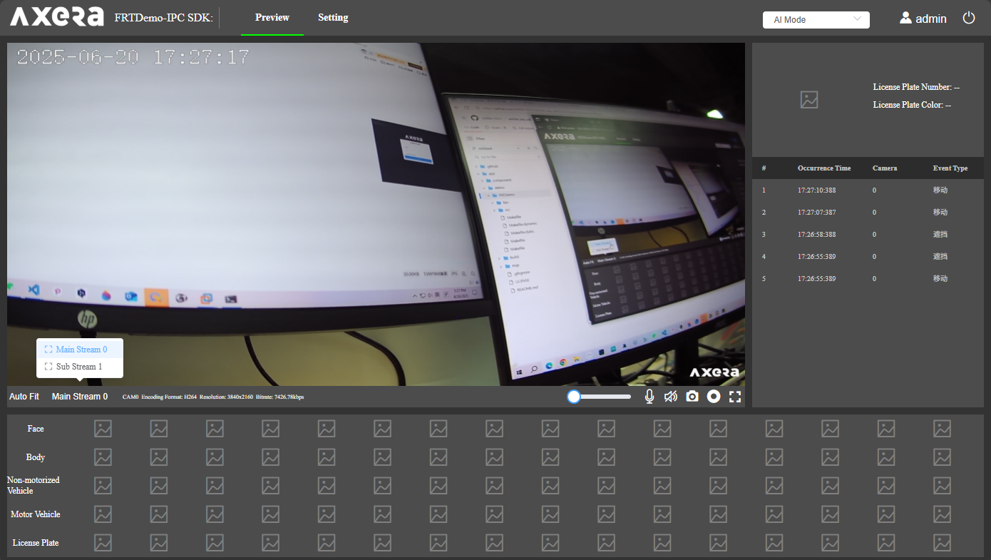

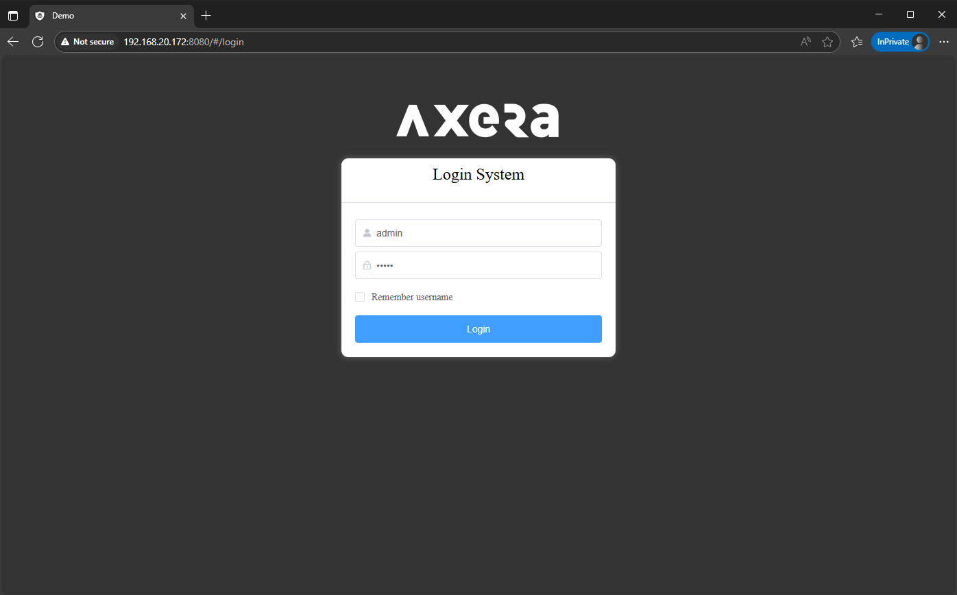

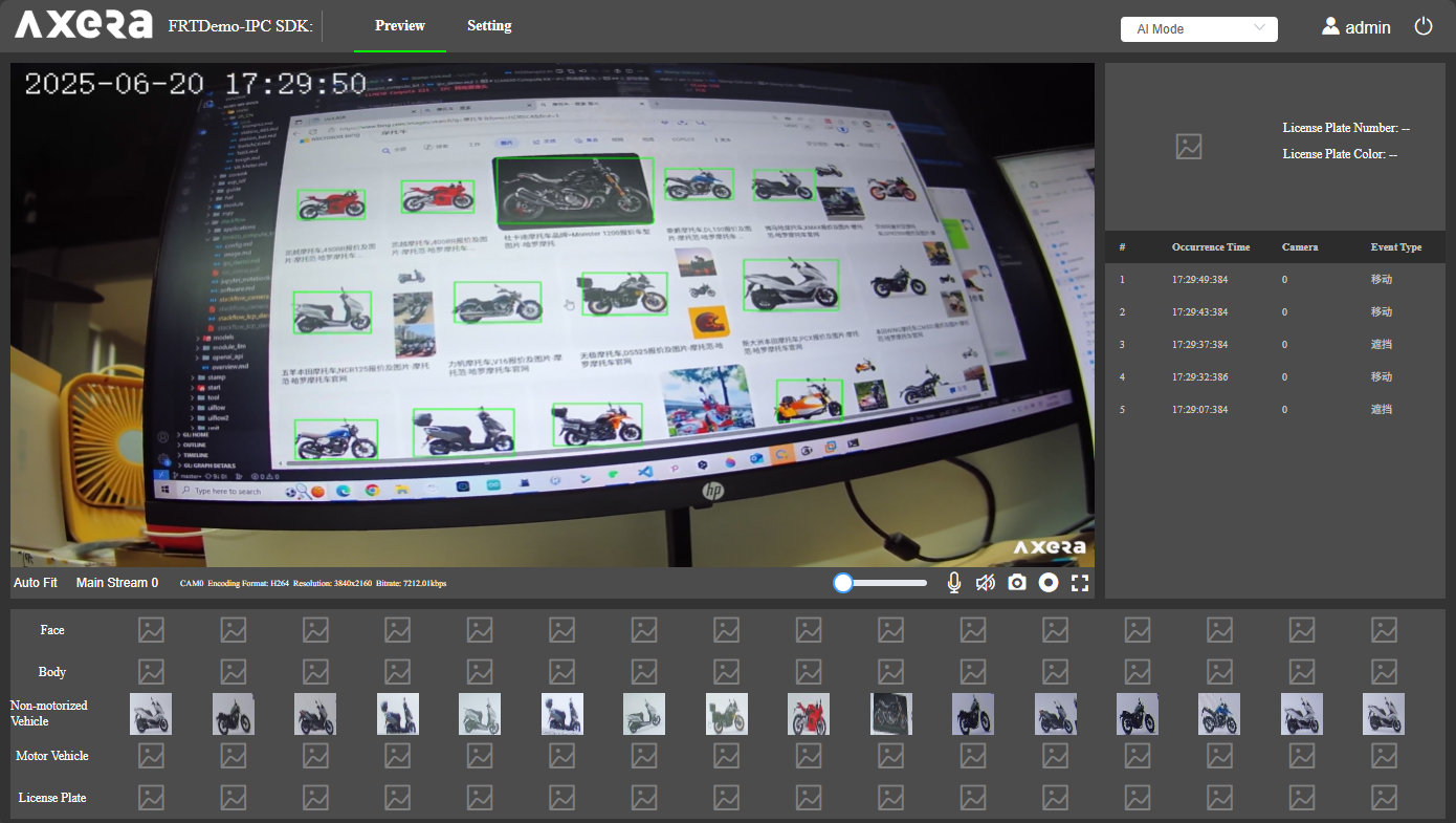

  1. On the same LAN, open a browser on your PC and visit: IP:8080. The default username and password are admin. Once logged in, you can preview the live video.
  1. Two RTSP streams are provided: Main Stream 0 (3840 x 2160) and Sub Stream 1 (720 x 576). You can switch between them via the lower left of the page.
  1. The demo supports detection of people, non-motor vehicles, and motor vehicles. Detected targets will be recorded below.

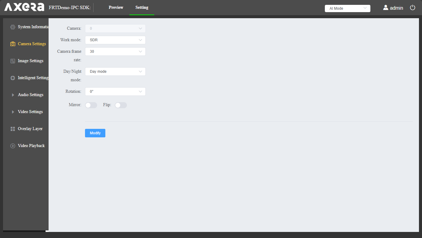

  1. Click the config tab in the top navigation bar to adjust camera settings such as image rotation, mirror, and flip.

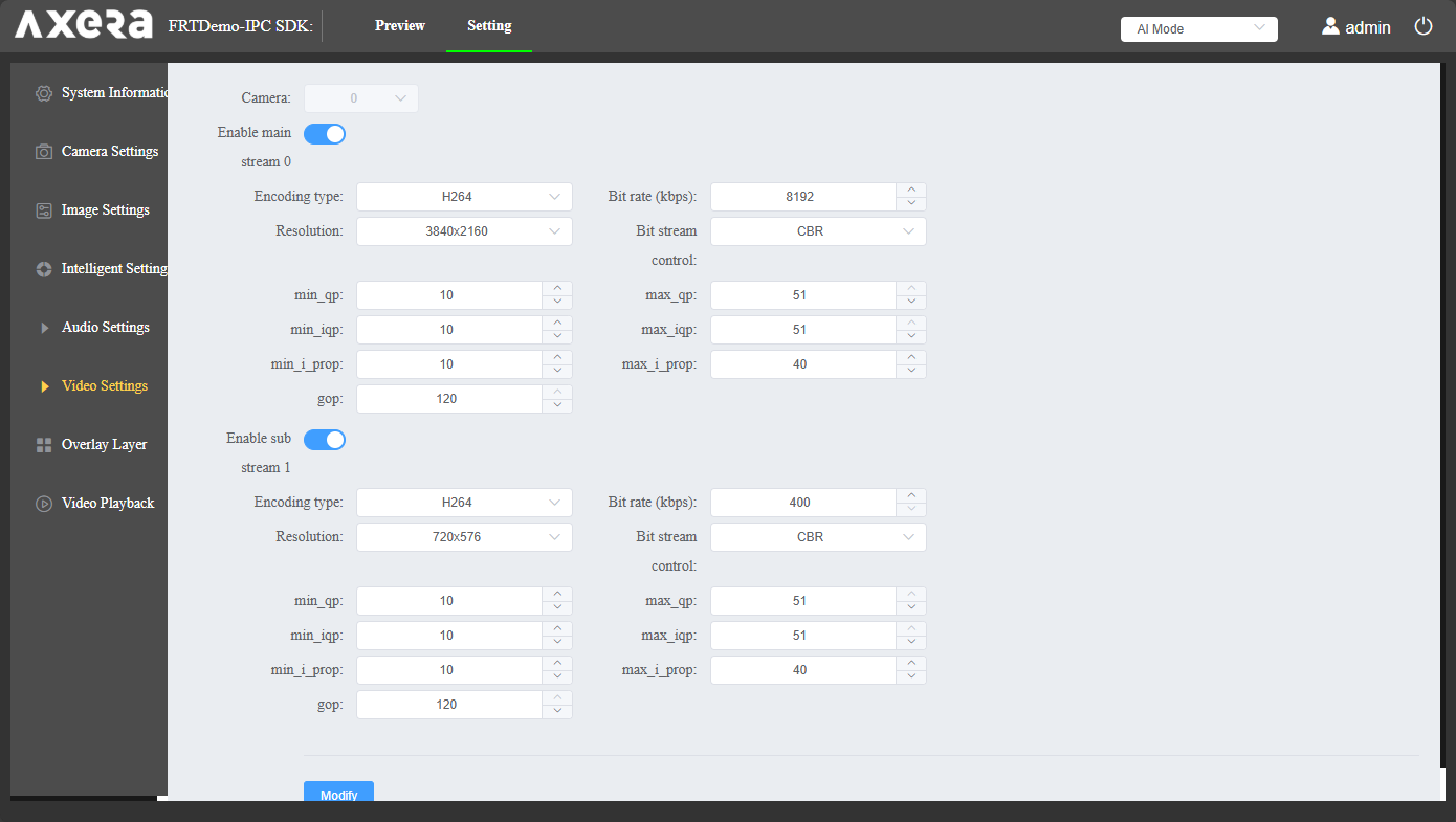

  1. In the video settings tab, you can adjust stream parameters including stream selection, encoding format, and resolution.

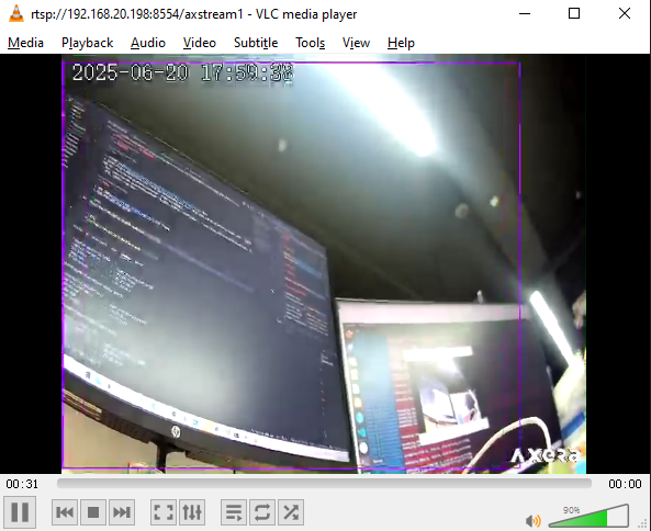

3. Accessing RTSP Streams
Once the IPC service is started, you can pull real-time streams using the following RTSP URLs. The following shows how to display streams using VLC and ffmpeg.
  • Main Stream (3840 x 2160):
rtsp://192.168.20.49:8554/axstream0
  • Sub Stream (720 x 576):
rtsp://192.168.20.49:8554/axstream1

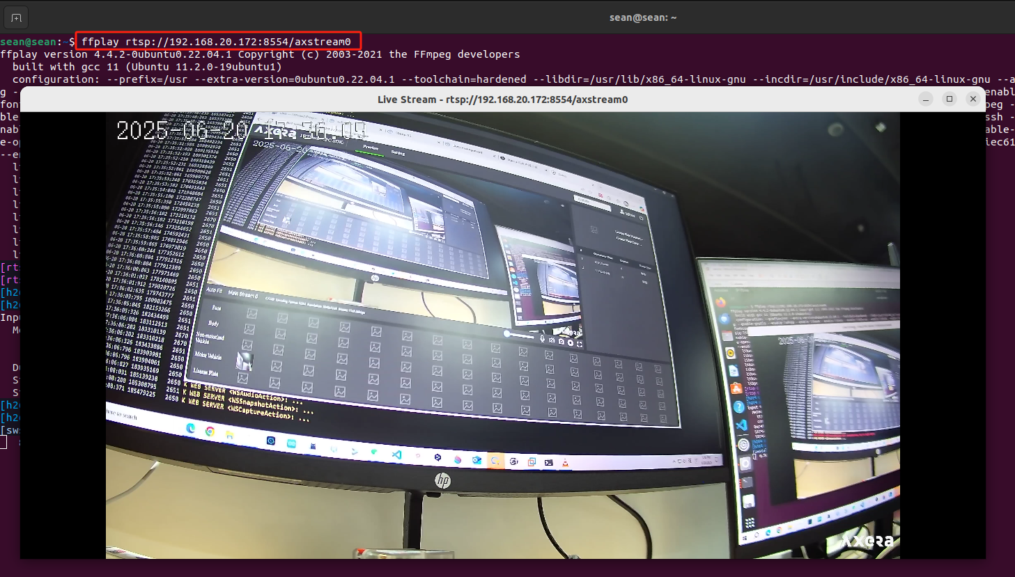

ffmpeg
  1. Visit ffmpeg official site to download the tool.
  2. Use ffplay in the command line to pull the RTSP stream:
