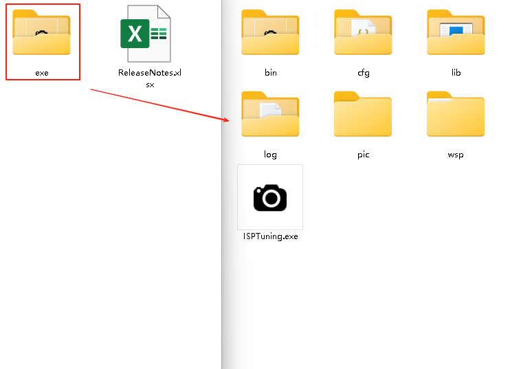

The software currently supports only Windows 10/11. Click the link below to download the ISPTuning package and extract it.
After extraction, the following folders are included:
  • bin/lib: Dependency files required for tool execution.
  • cfg: Configuration files for tool execution.
  • wsp: Sample images and parameter files.

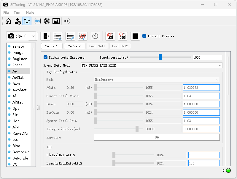

2.3 Tool Interface

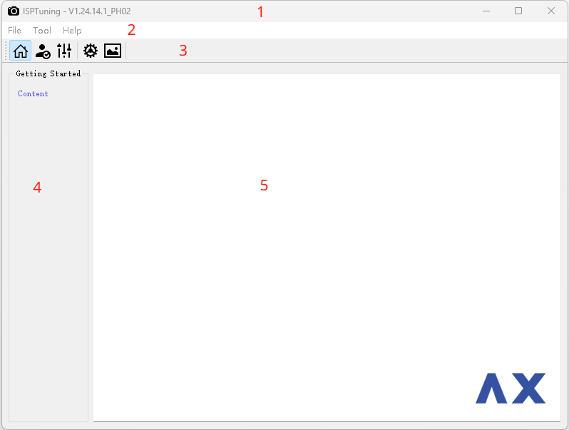

Open ISPTuning.exe.\
  • 1: Title bar—shows the tool version.
  • 2: Menu bar—provides advanced operations.
  • 3: Toolbar—offers common operations.
  • 4: Module panel area—displays the modules that can be tuned.
  • 5: Parameter tuning area—shows adjustable parameters for the current module and provides tuning methods.

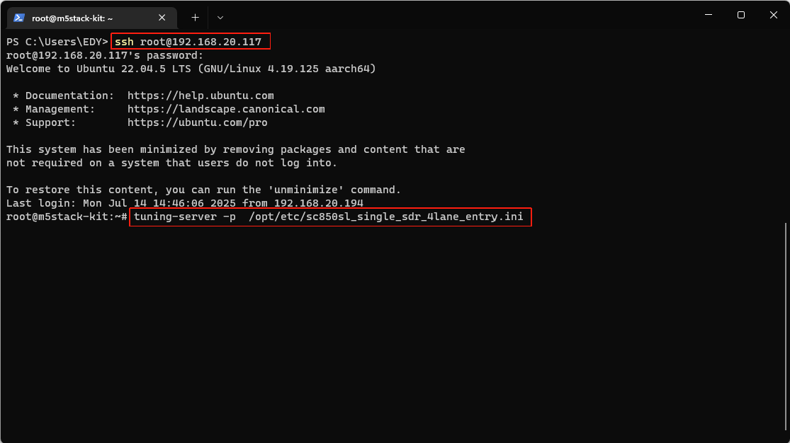

  1. Log in to the LLM630 Compute Kit terminal and run the following command to start the tuning-server. ISP Tuning will connect to the development board’s tuning-server for subsequent debugging.
To use ISP Tuning with the tuning-server, the development board and PC must be on the same LAN and be able to communicate with each other.
tuning-server -p /opt/etc/sc850sl_single_sdr_4lane_entry.ini
  1. Wait until the listening port is displayed.

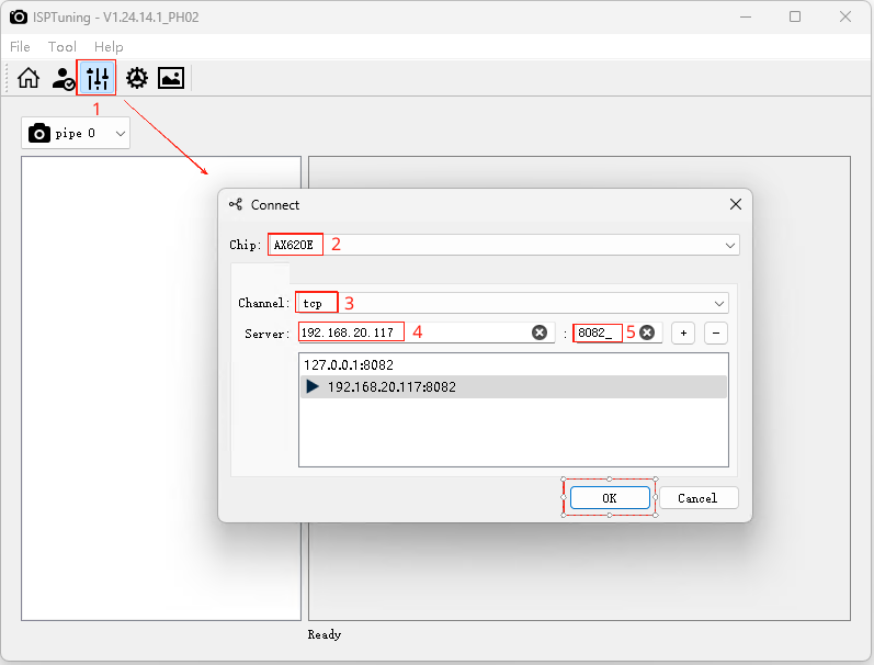

  2. Click the toolbar icon, select AX620E in the Chip drop-down, tcp in the Channel drop-down, enter the board’s IP address in Server, and keep the default port.

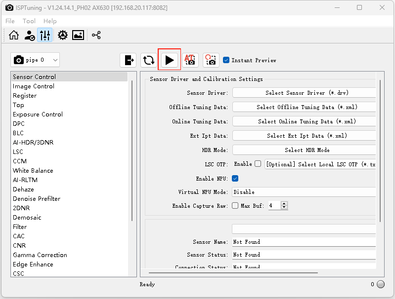

  3. After the connection is established, click Start Preview to open the preview window.

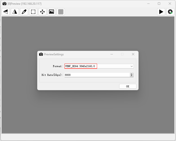

  4. Select the format VENC_H264:3840x2160, 0.

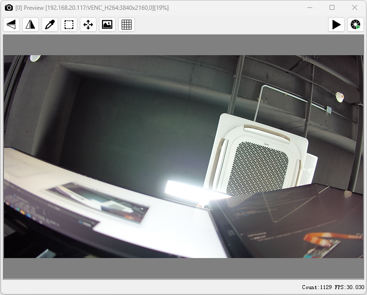

  5. You can now preview the camera image in real time.
