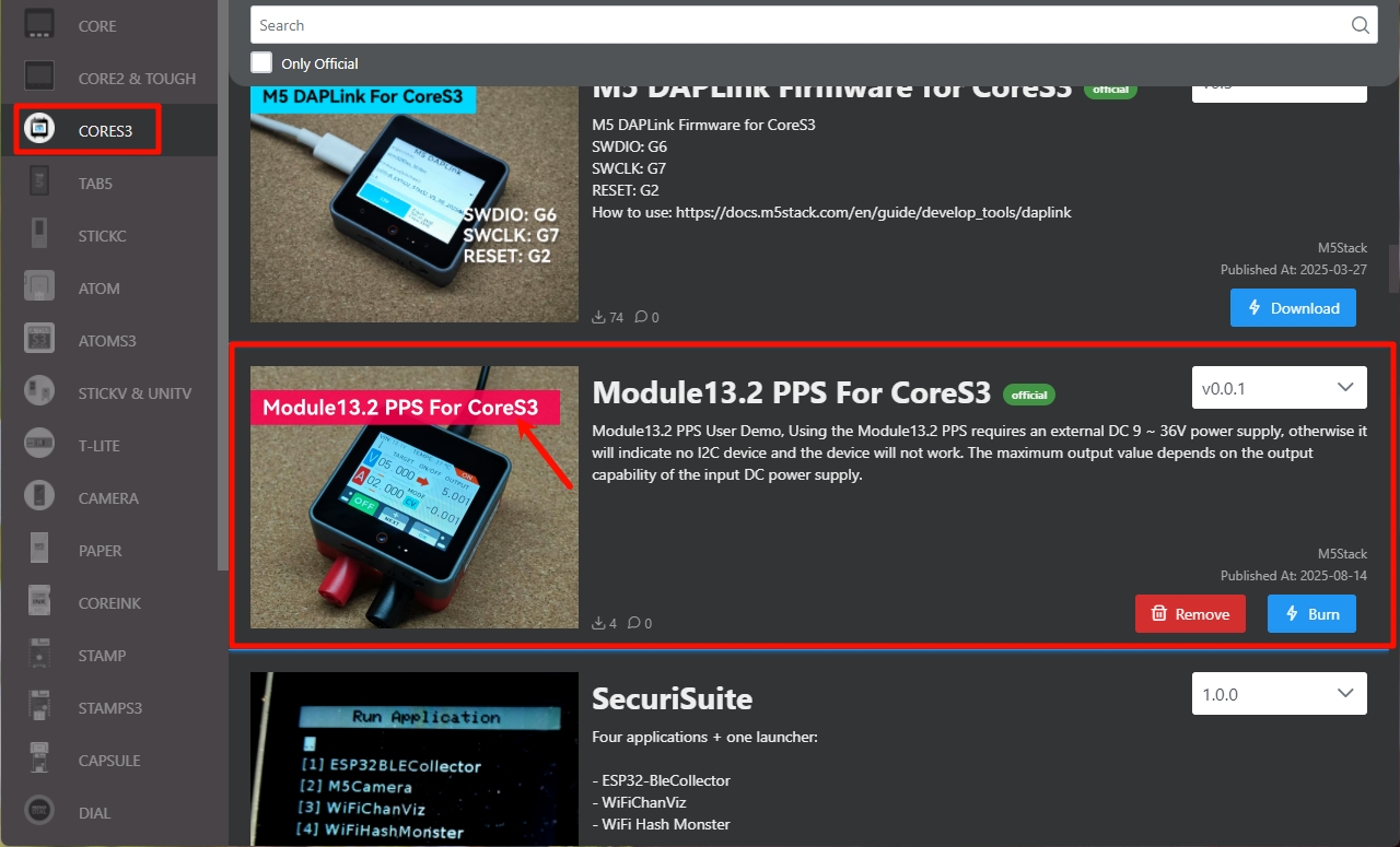

  1. According to your operating system, click the button below to download the corresponding M5Burner firmware burning tool. Extract and open the application.
Software Version Download Link
M5Burner_Windows Download
M5Burner_MacOS Download
M5Burner_Linux Download

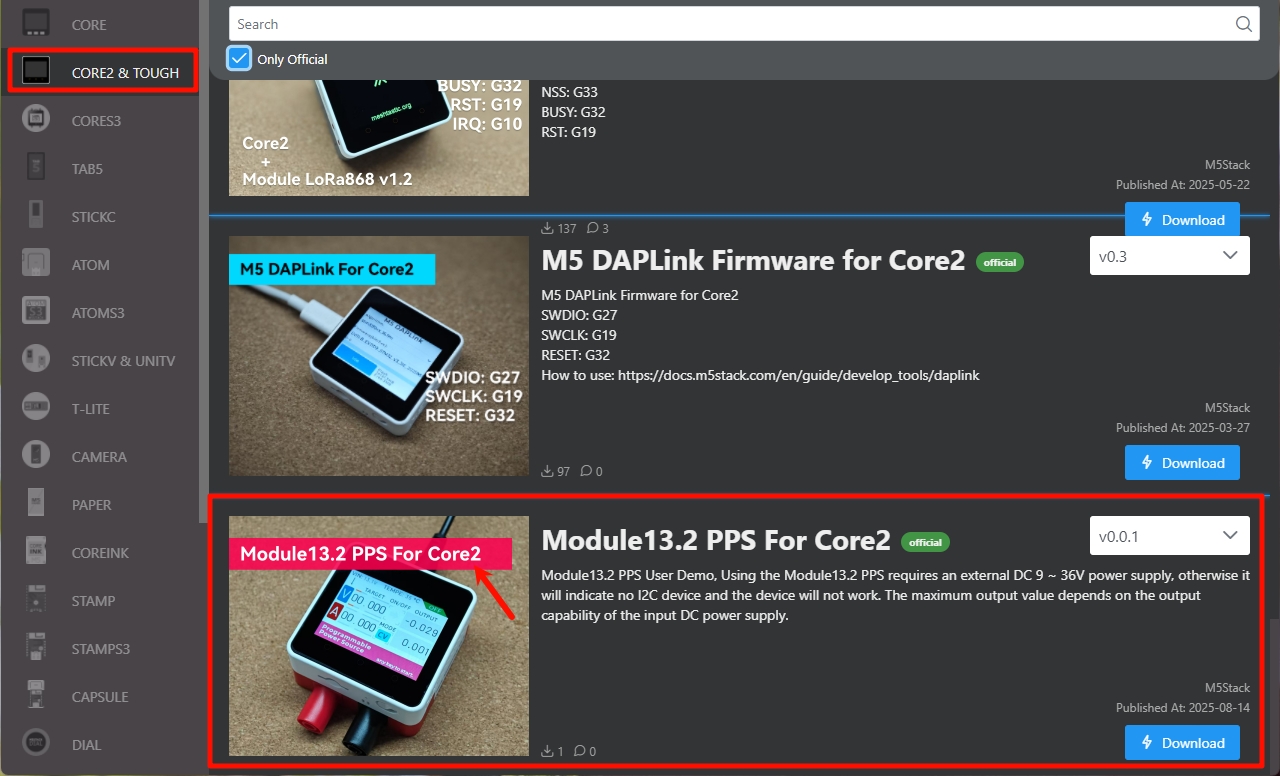

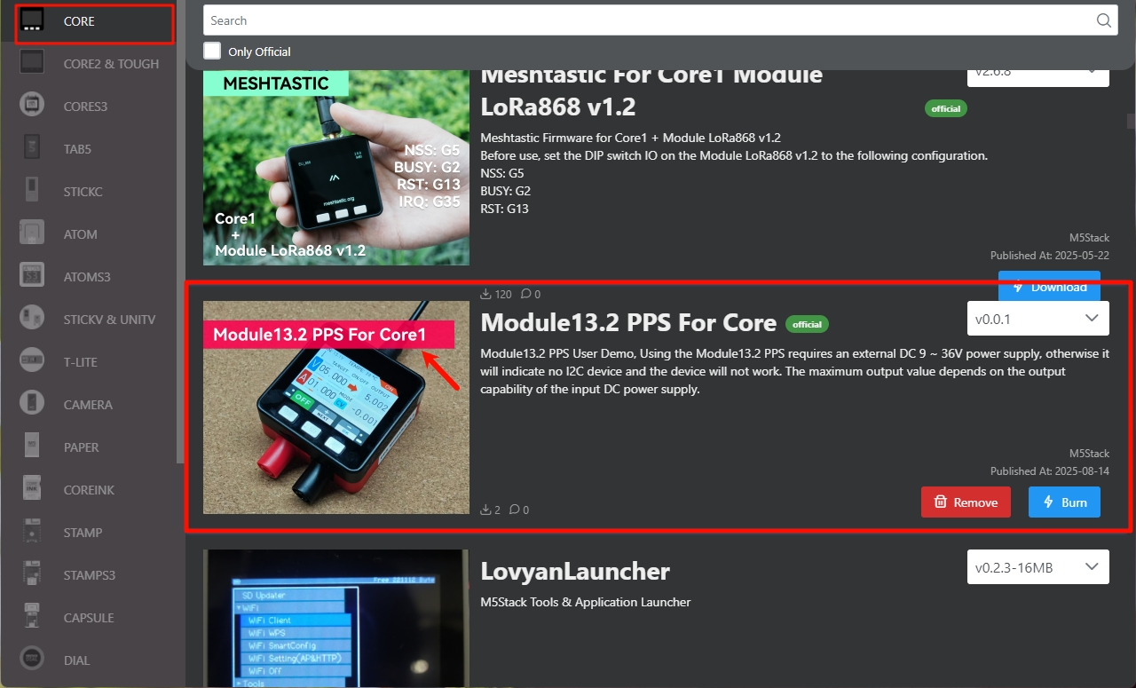

  1. Double-click to open the Burner burning tool, and find the Demo of Module13.2 PPS corresponding to your host. The Demos for Core/Core2/CoreS3 are as follows:
  • Demo for Core:
  • Demo for Core2:
  • Demo for CoreS3:

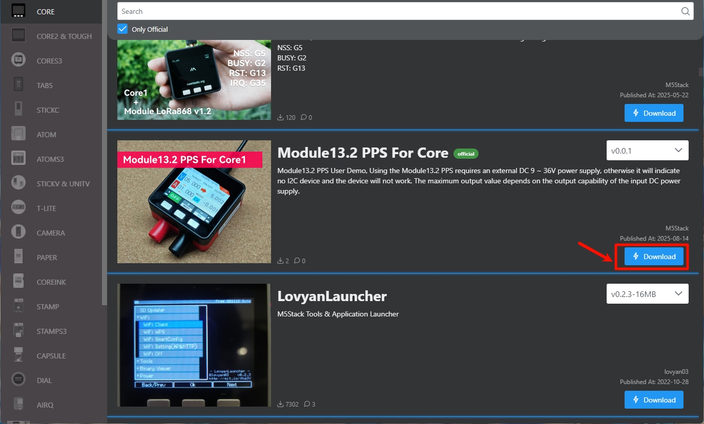

  1. Click Download to download the Demo compatible with your host.

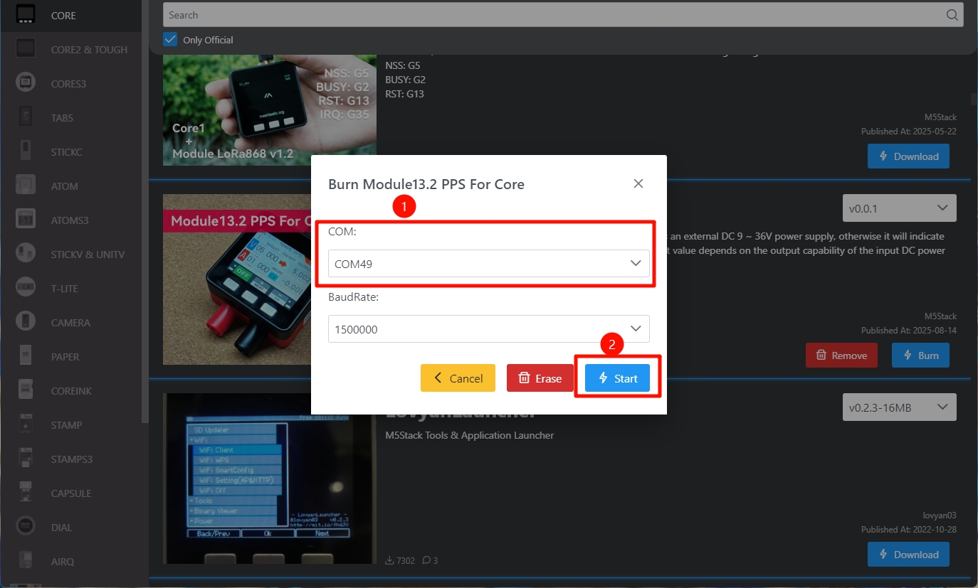

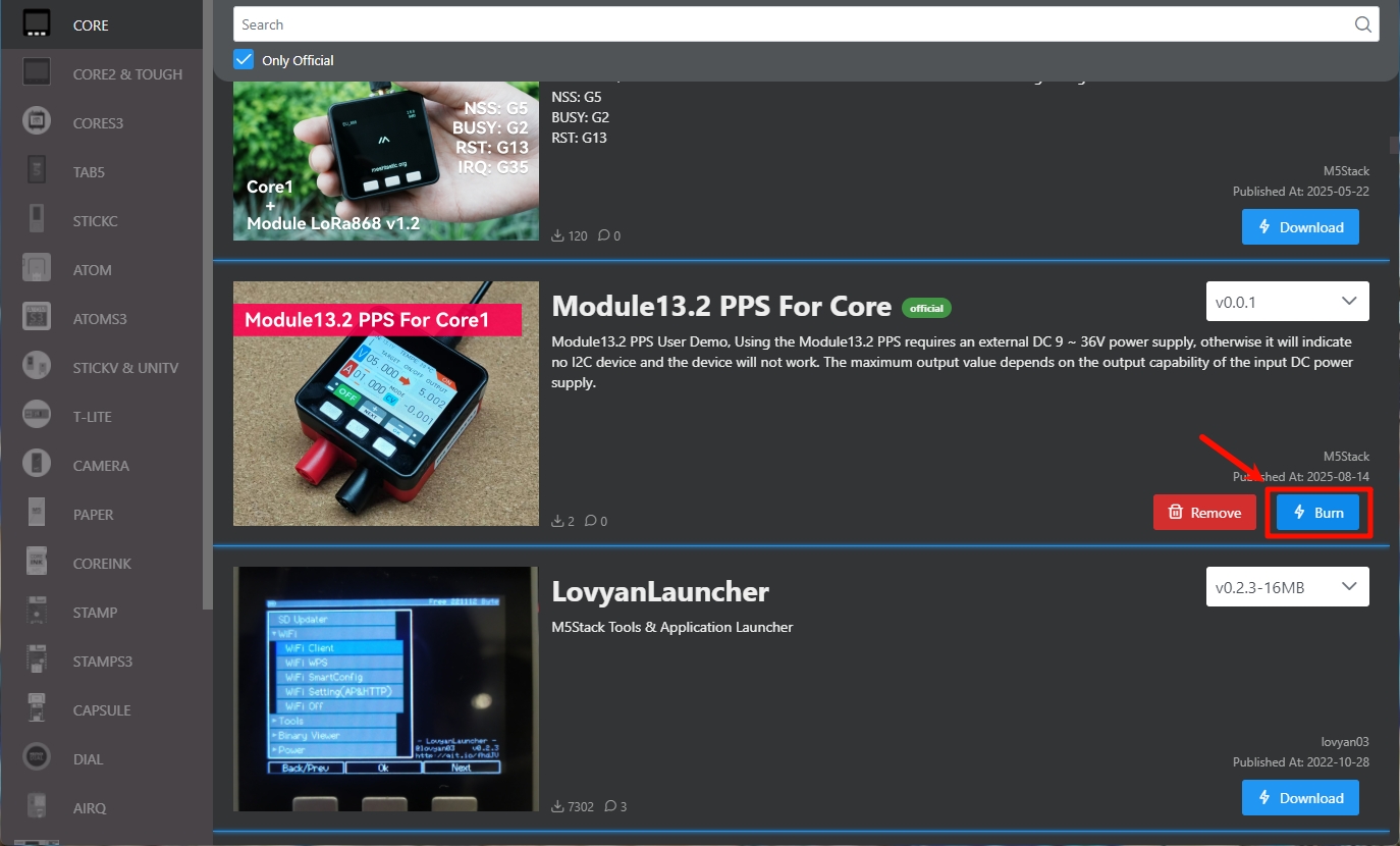

  1. Connect the device to the computer via USB cable, and click the Burn button for the corresponding Demo.
  1. In the pop-up window, select the port corresponding to your device, and click Start to begin burning.

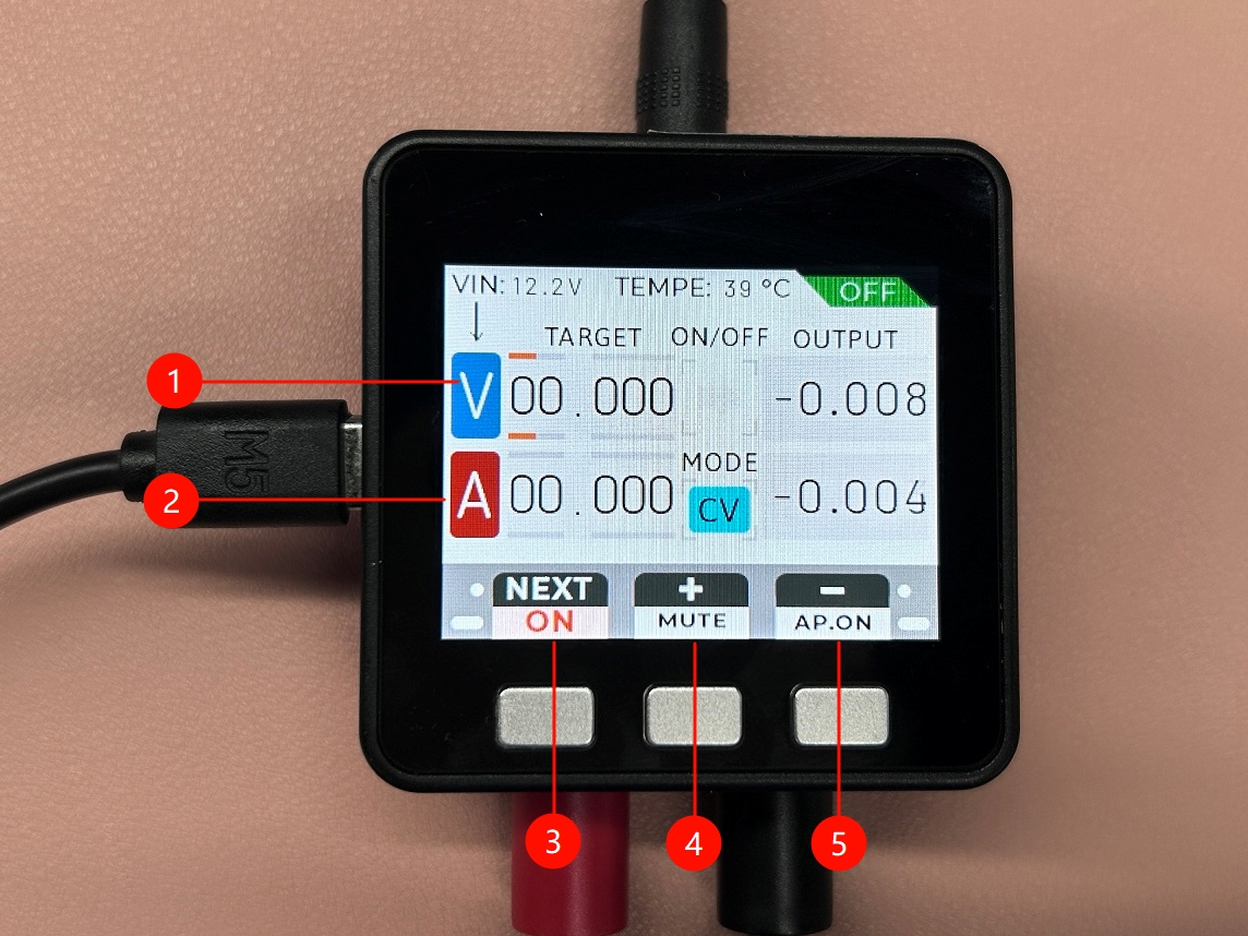

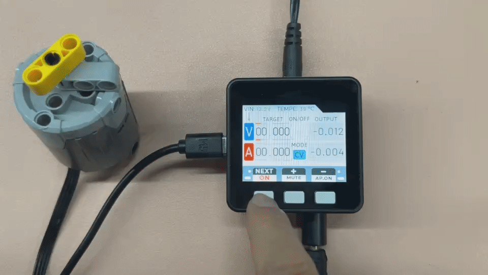

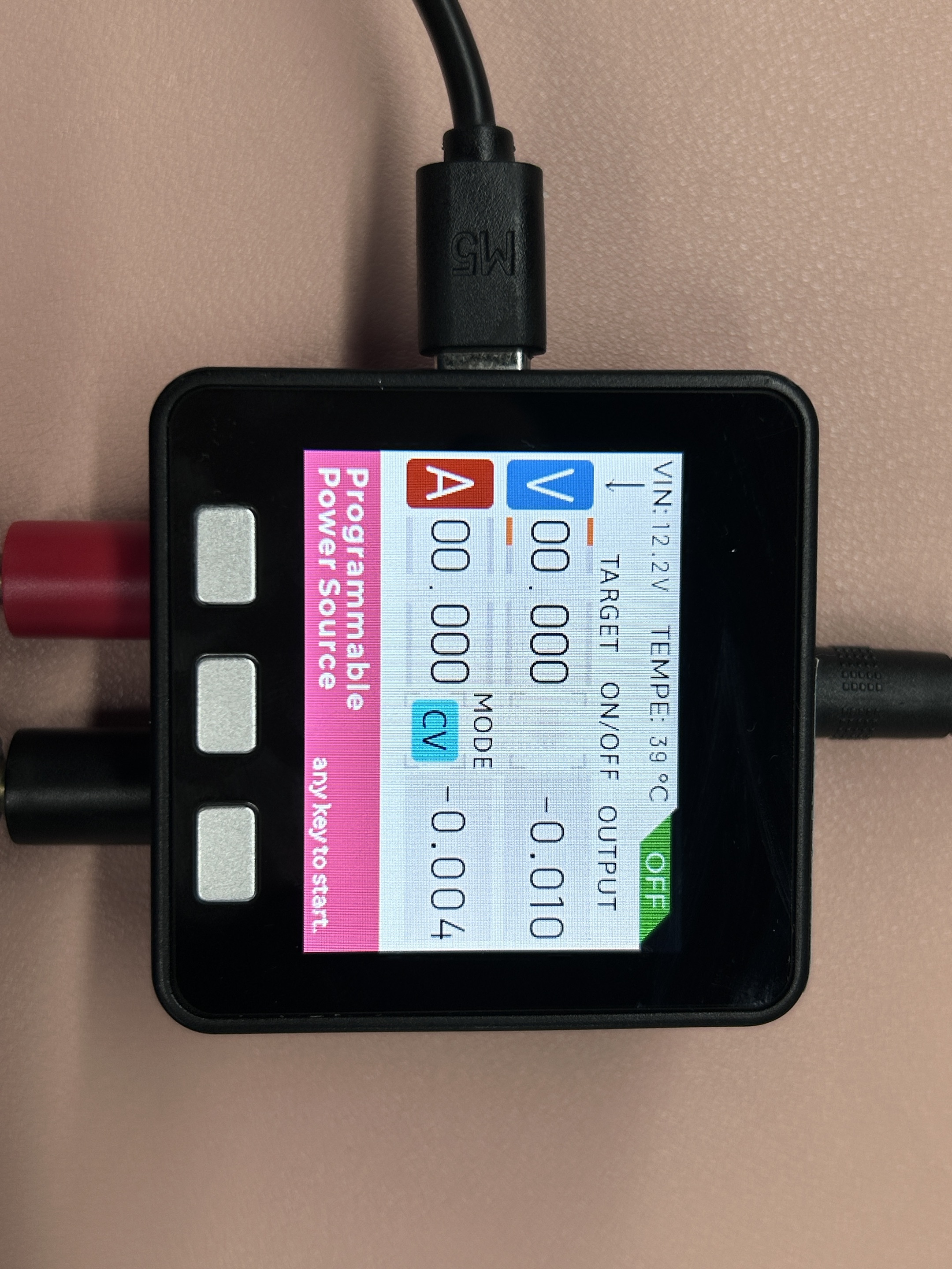

After the firmware burning is completed, the device will automatically enter the current and voltage setting page, as shown below. Press any key to enter the setting mode.
Learn
The current/voltage setting interface is introduced as follows. Core operates via the buttons on the device, while Core2/CoreS3 operates via the touchscreen buttons. The operational effects are the same.
  • 1: Set Voltage
  • 2: Set Current
  • 3: Switch option / Long press to confirm
  • 4: Increase value
  • 5: Decrease value
For example, the diagram below demonstrates setting a rated output voltage of 5V and output current of 5A. The left side of the interface shows the rated values set. After adjusting using the increase/decrease buttons, long-press ON to confirm and start output. The OUTPUT values on the right indicate the device’s actual current output voltage/current.
