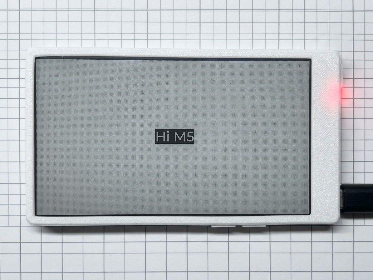

  1. Connect the device to a computer via a USB Type-C data cable, long-press the power button (about 2 seconds) until the red LED blinks, then release the button. The device enters download mode.

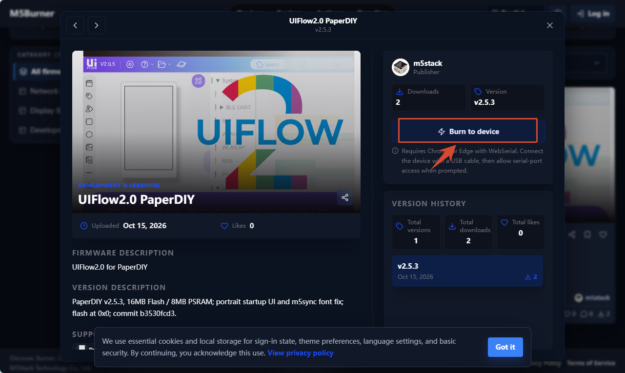

  2. Open the PaperDIY UiFlow2 firmware page on the M5Burner website, and click Burn to device in the interface to start flashing the UiFlow2 firmware.

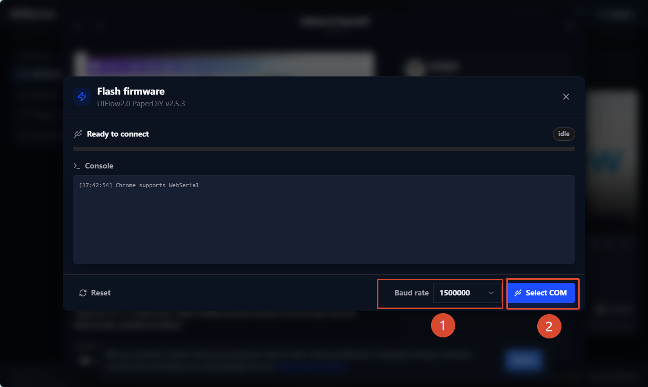

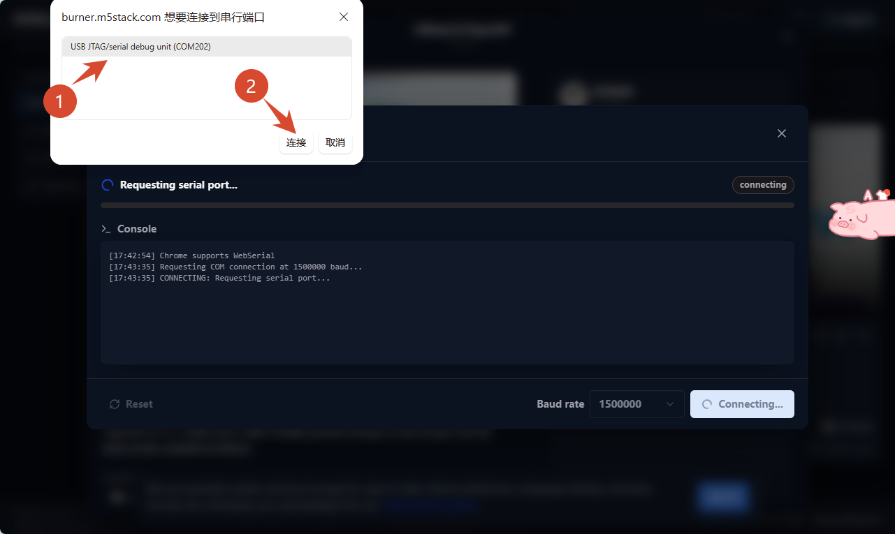

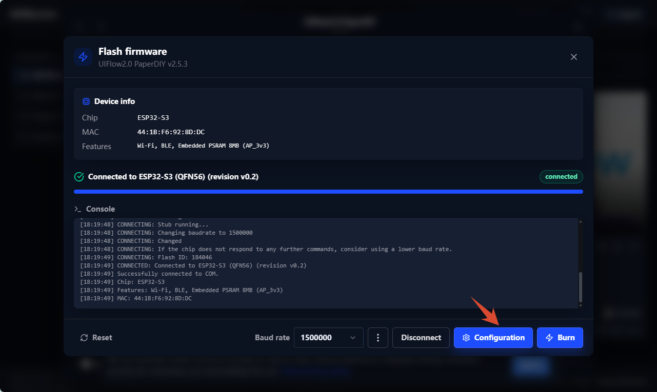

  1. In the pop-up window, select the baud rate for serial communication, then click Select COM.

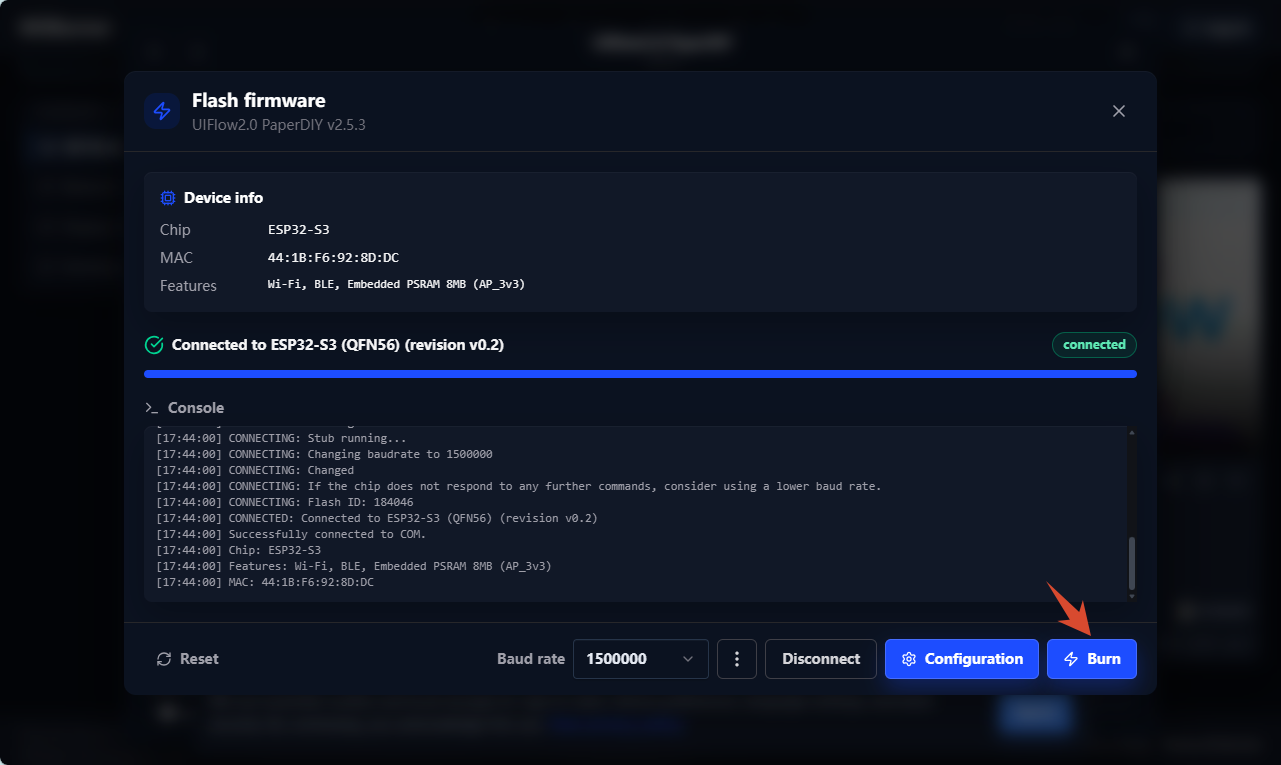

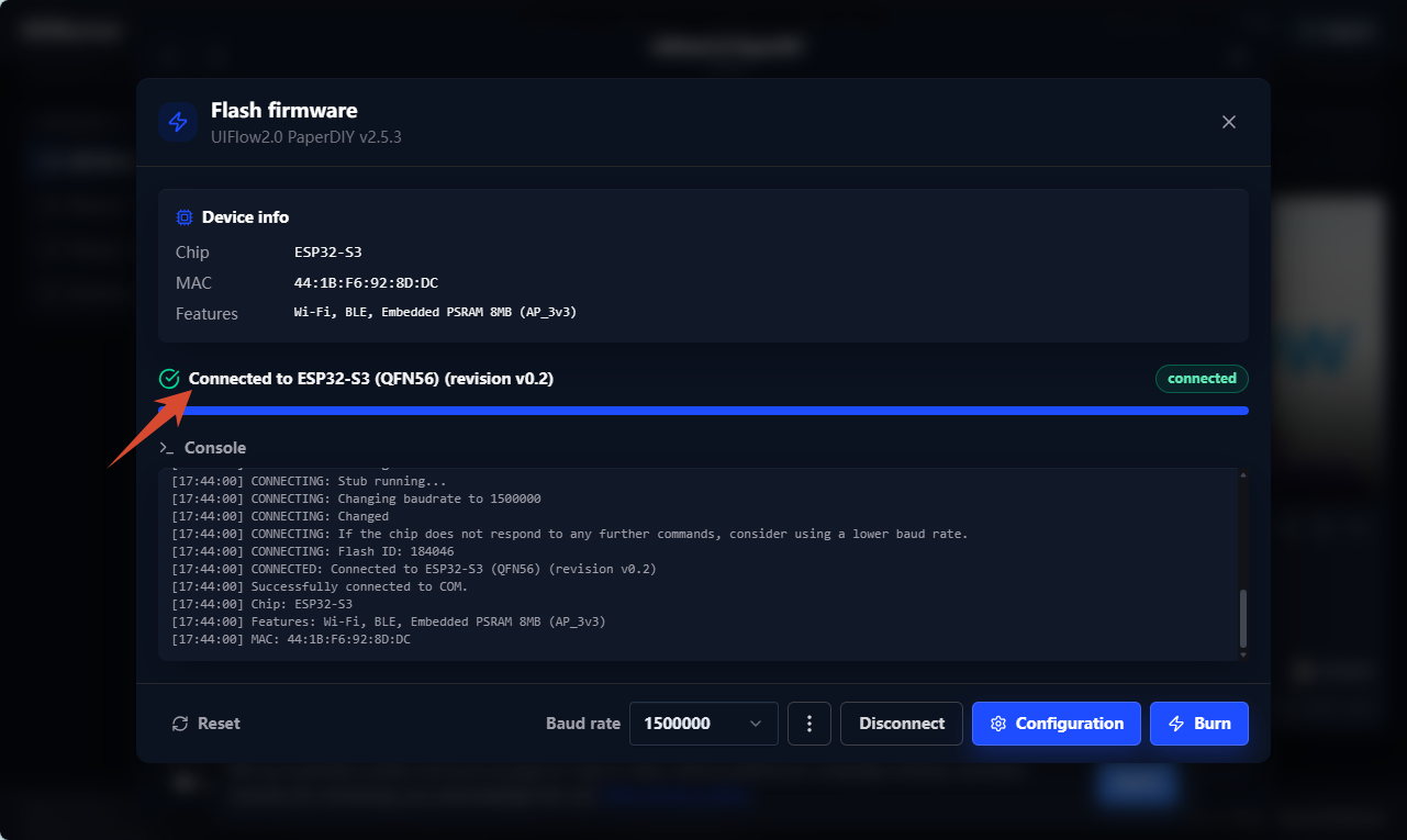

  1. Select the port corresponding to the device, then click Connect.
When the interface displays Connected to xxx, the port is connected successfully.

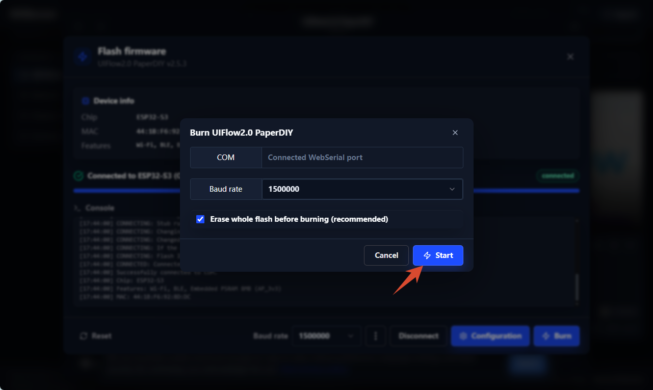

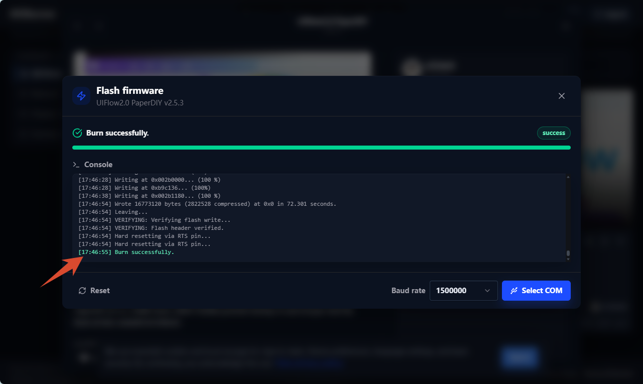

  1. Click Burn, and click Start in the pop-up window.

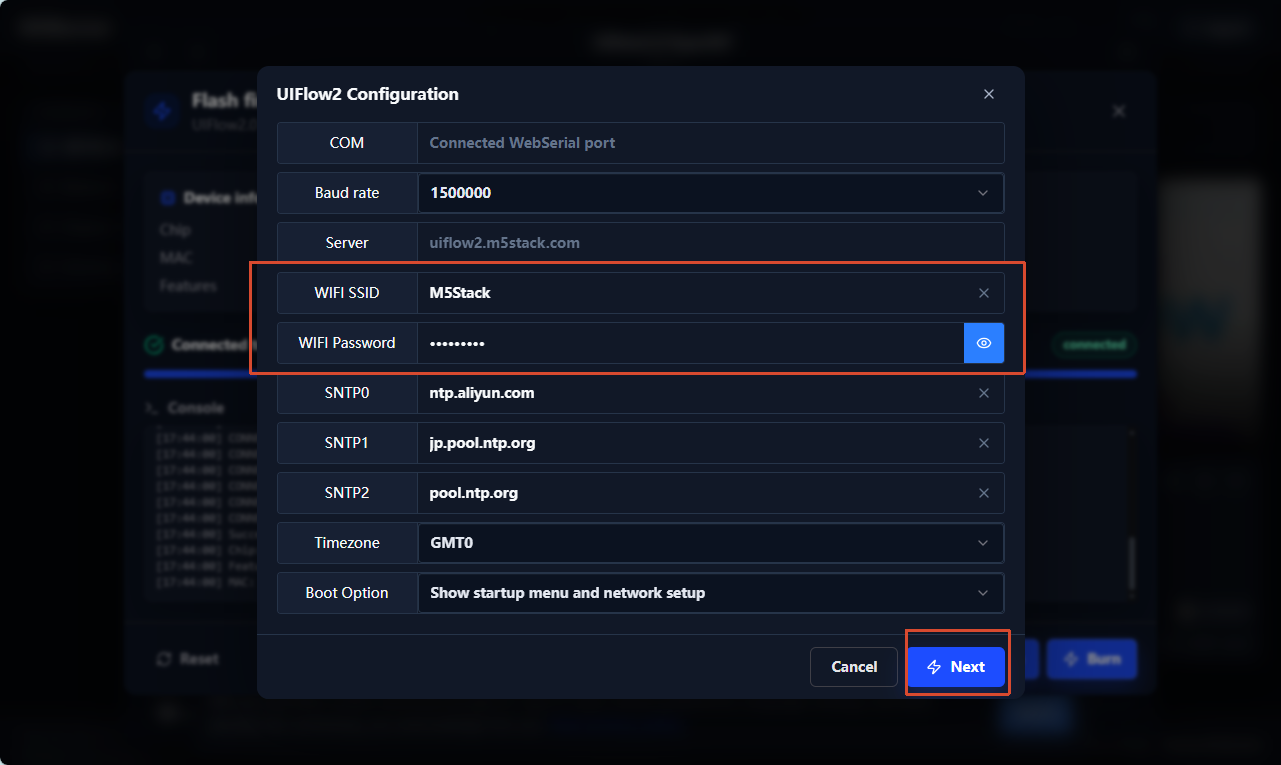

  1. Fill in the Wi-Fi configuration that the device needs to connect to, including Wi-Fi SSID and Wi-Fi Password, as well as any other device configuration that needs to be added or modified, then click Next.
When Burn successfully is displayed, flashing is successful. Please reset the device at this point.

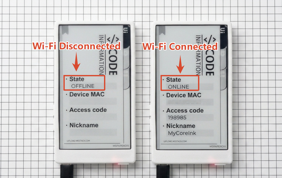

  1. Before connecting, check the Wi-Fi icon on the device screen to confirm that the device is connected to the network. If the network connection fails, check whether the Wi-Fi name and password entered during firmware flashing are correct, then modify them through the Configuration option on the WebBurner and flash again.

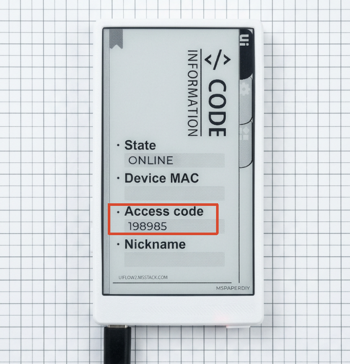

  1. Check the currently generated valid Access Code on the device's UiFlow2 startup screen.

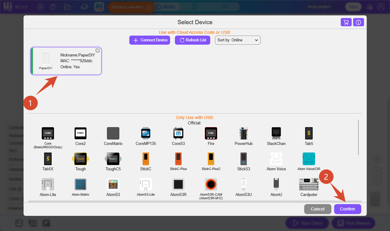

  1. Click Connect Device, enter the access code and a custom device name, then click Confirm to connect PaperDIY to UiFlow2.
Access Code Description
1. Changing browsers, using private / incognito mode, or clearing the UiFlow2 website cache will invalidate the original pairing state.
2. Closing only the tab, restarting the browser, logging in, or logging out will not affect an established pairing relationship.
3. Once the device is paired by another browser, the original browser's pairing relationship becomes invalid immediately.
  1. On the Select Device page, select the connected PaperDIY device and click Confirm to enter the UiFlow2 programming interface.

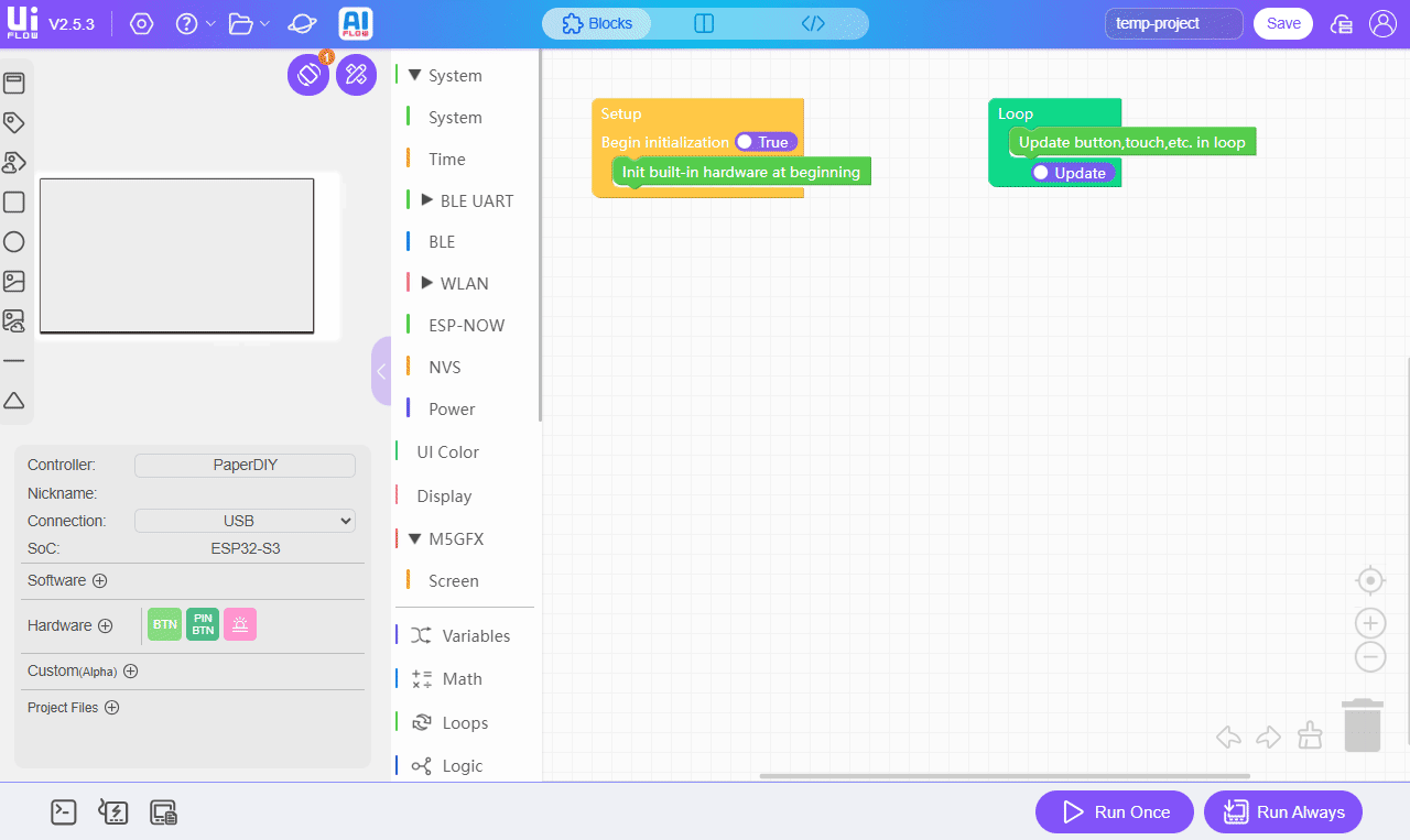

  1. Visit uiflow2.m5stack.com to open the UiFlow2 Web IDE, and connect PaperDIY to the computer's USB port.

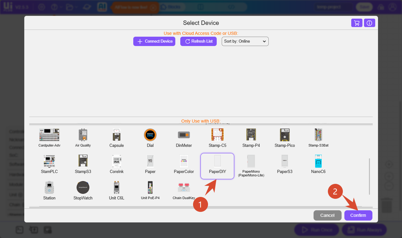

  2. Click Select Your Controller (shown on first visit) or the Controller button on the page to enter the Select Device page.
  1. Select the PaperDIY device in the device list, then click Confirm.

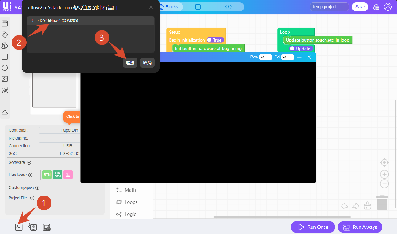

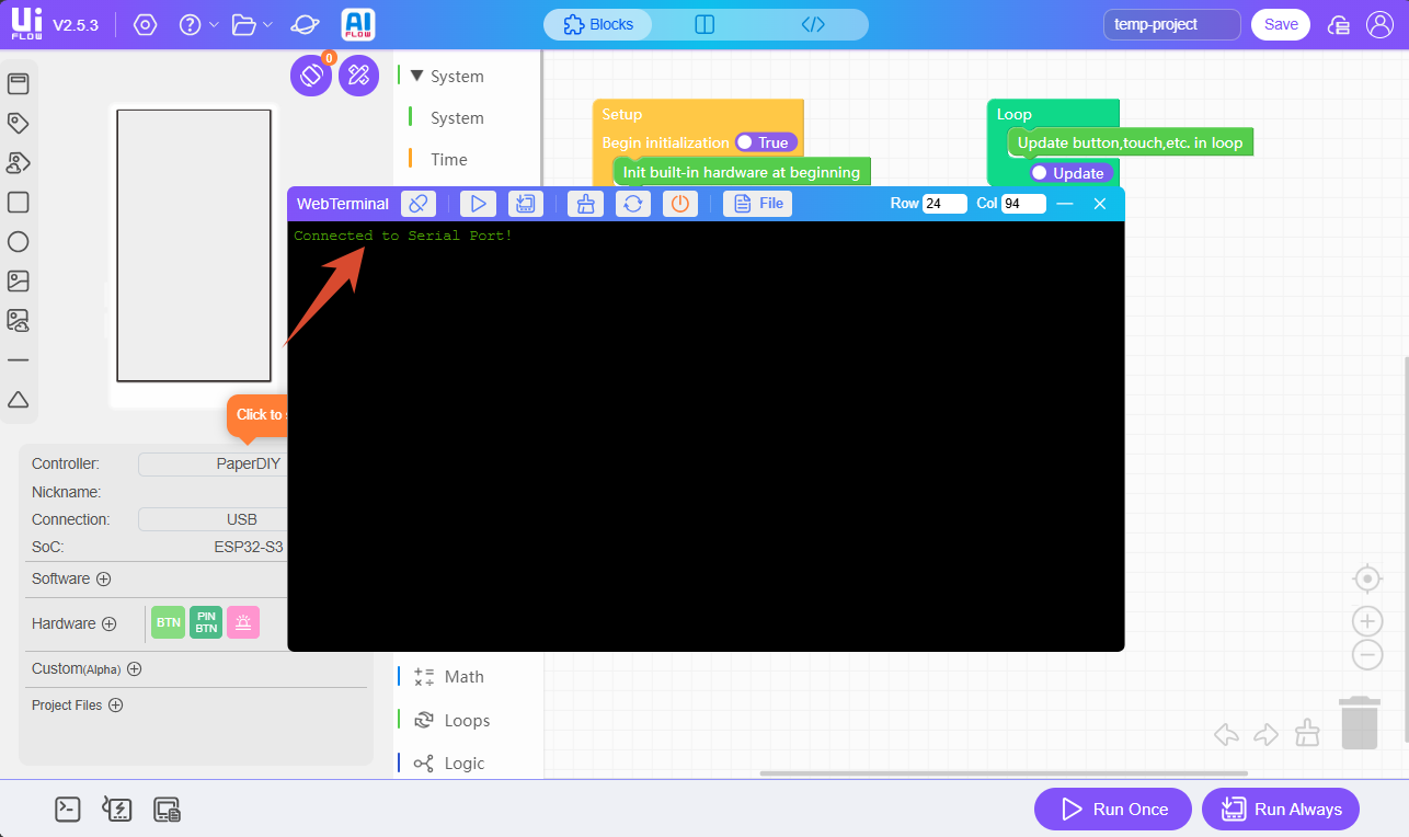

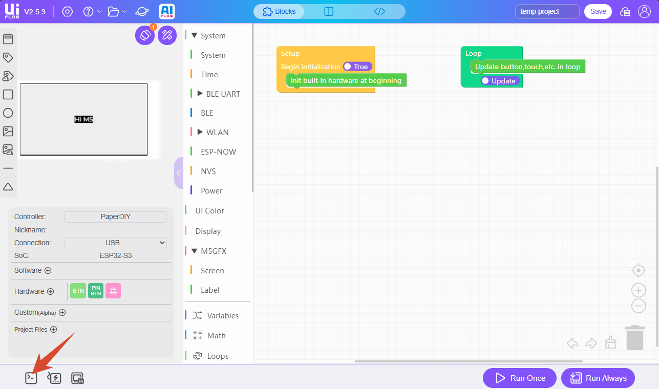

  1. Click the WebTerminal button, select the serial port for PaperDIY in the dialog, and click Connect.
When the WebTerminal screen displays Connected to Serial Port!, the USB connection is successful.
3. Program Run and Download

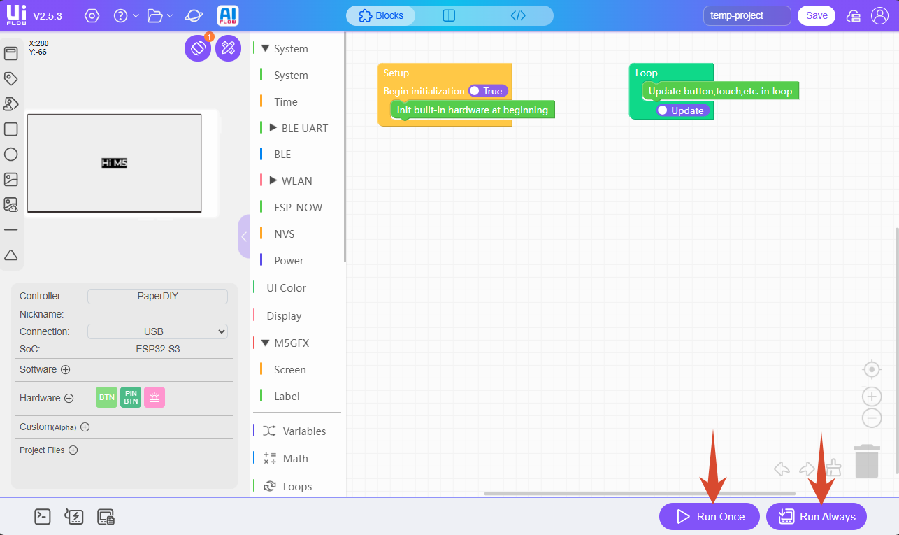

After the device is connected to UiFlow2, you can drag Blockly blocks to edit programs.

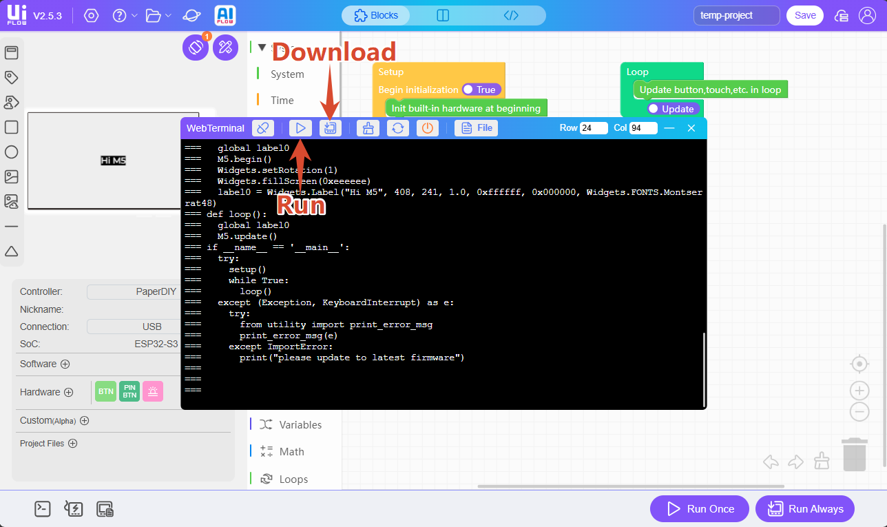

After editing the program, click the Run Once button in the lower-right corner to run the program once for testing. Click Run Always to download the program to the device.
You can also run once or download the program in the WebTerminal window.
