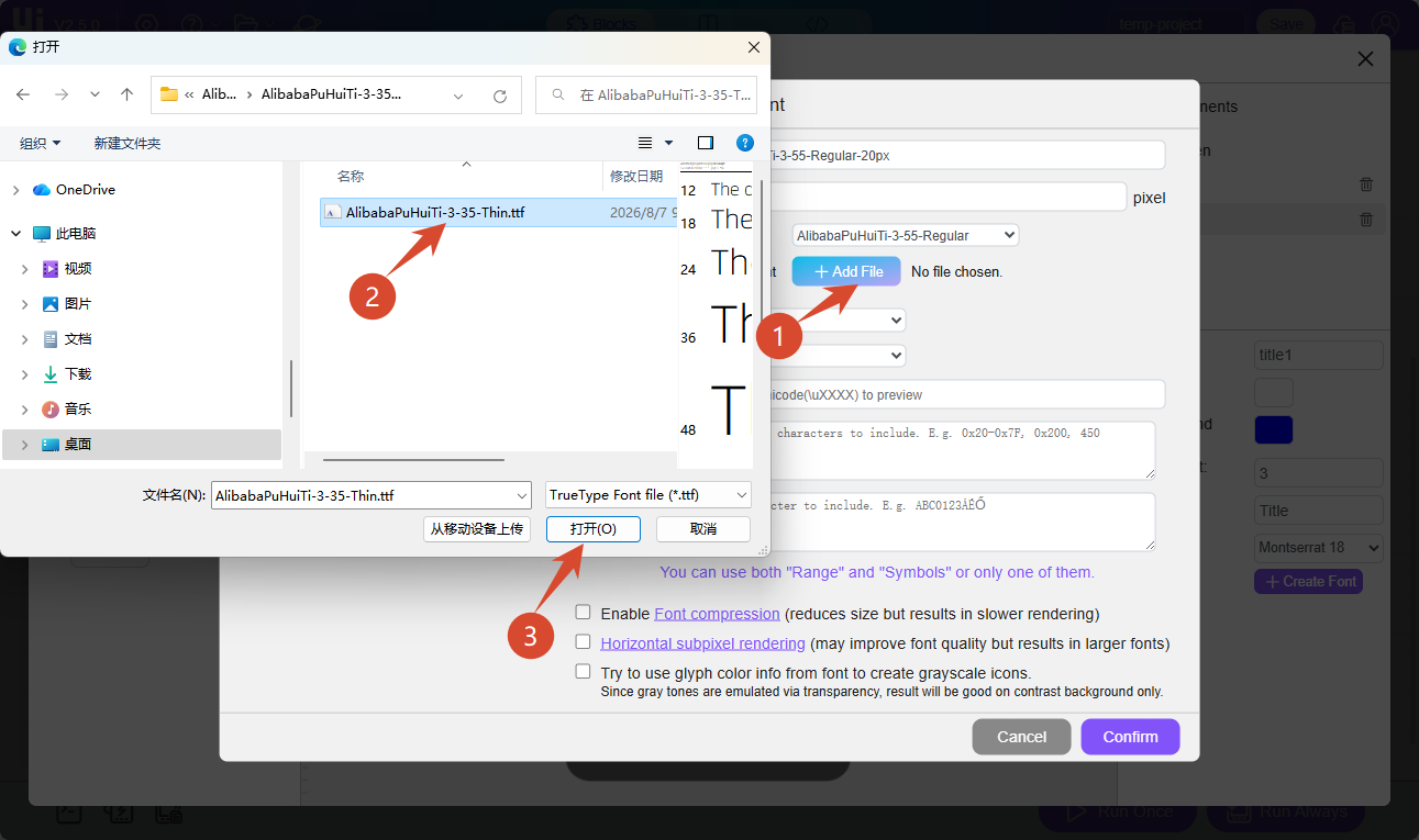

2.Font Integration Steps

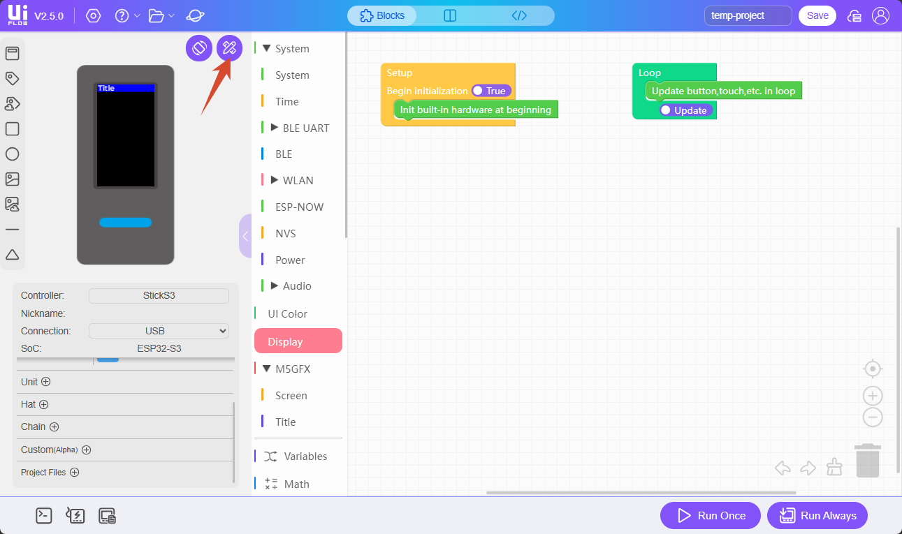

  • 1.Access UiFlow2 Web IDE

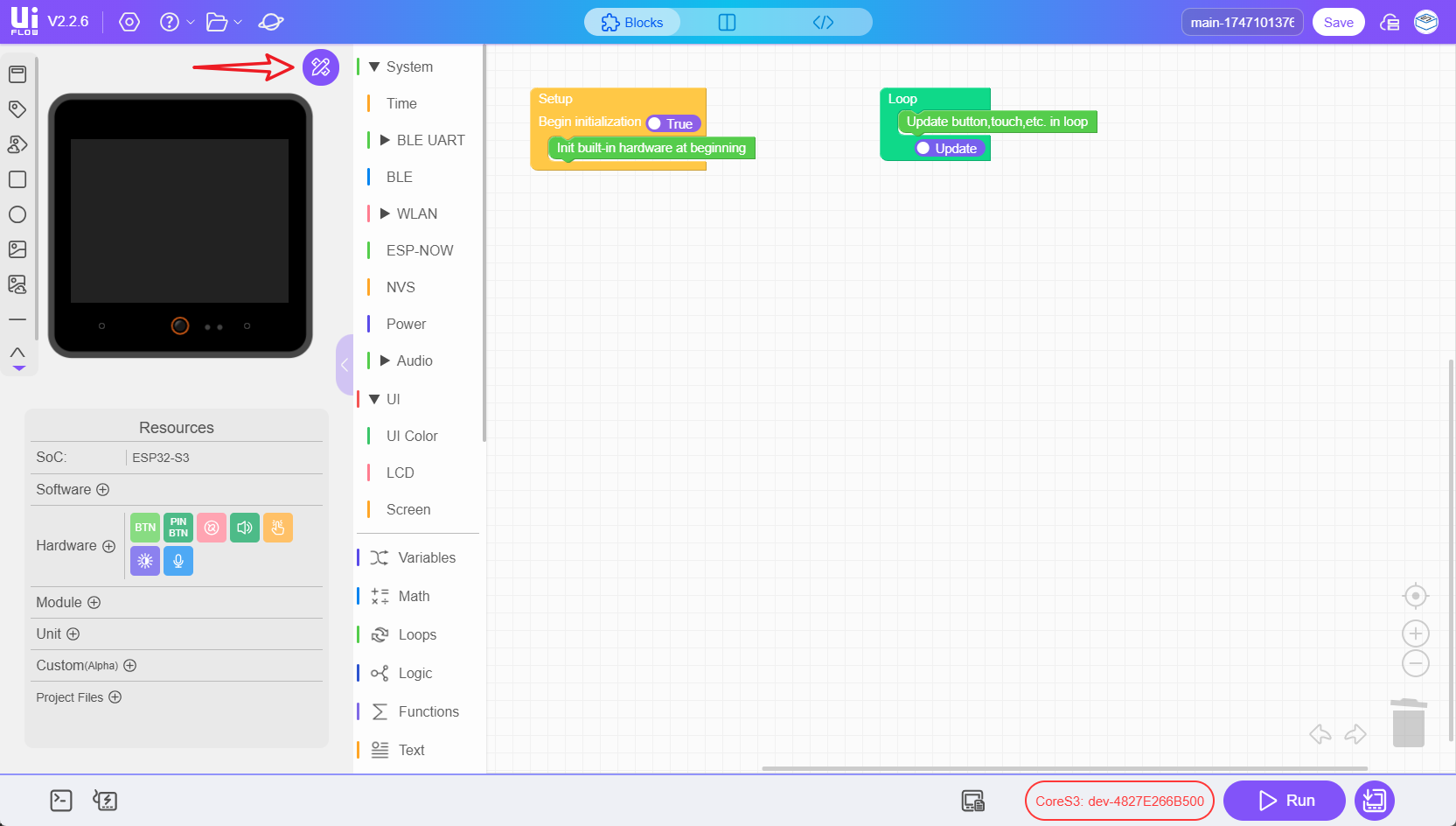

  • 2.Open UI simulator and enter design interface

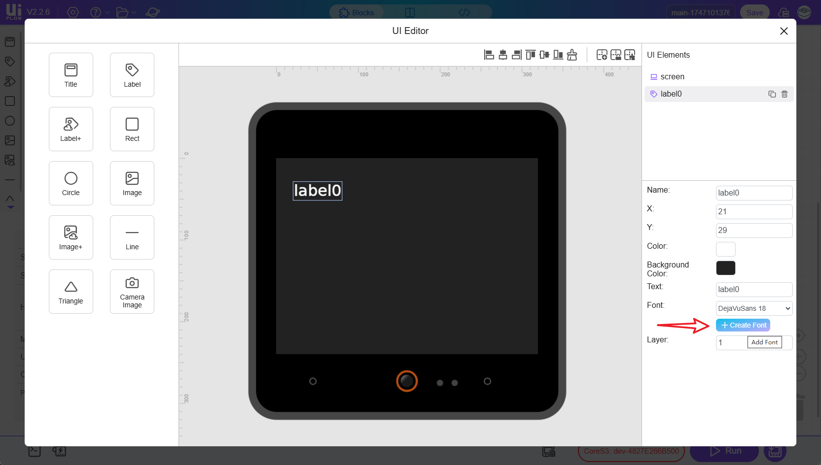

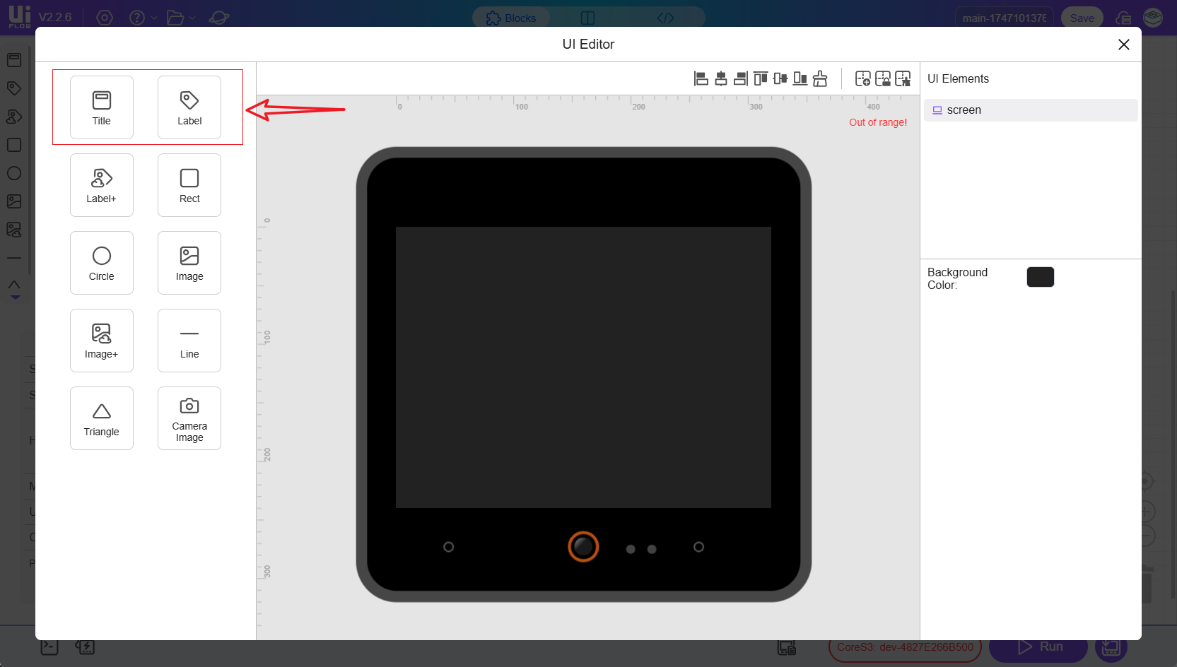

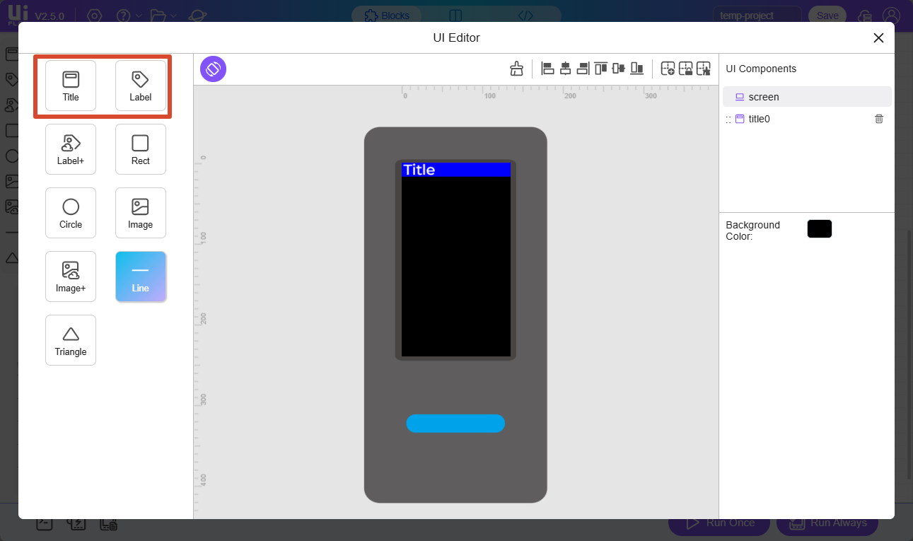

  • 3.Drag any TitleorLabelcomponent to canvas

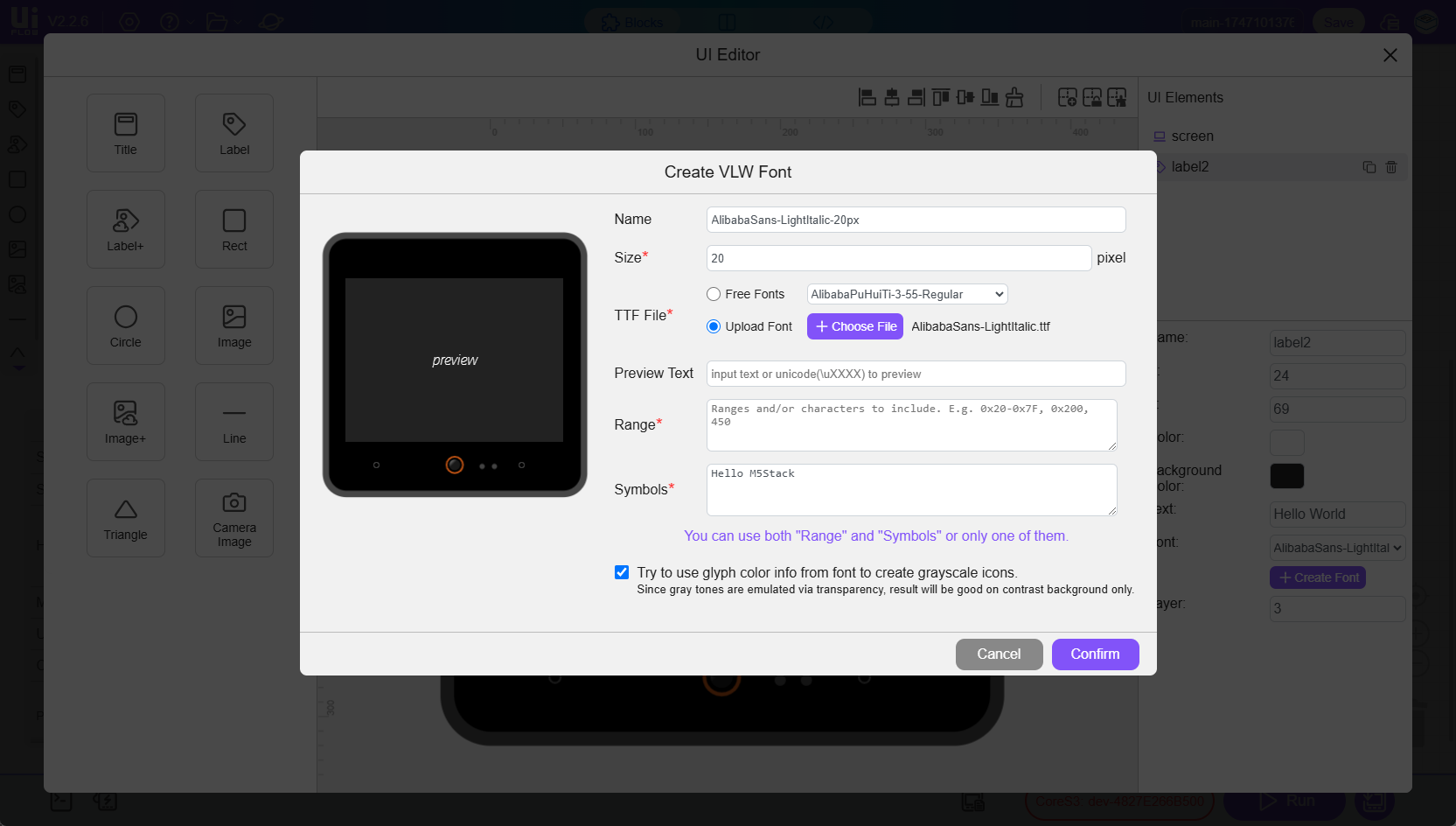

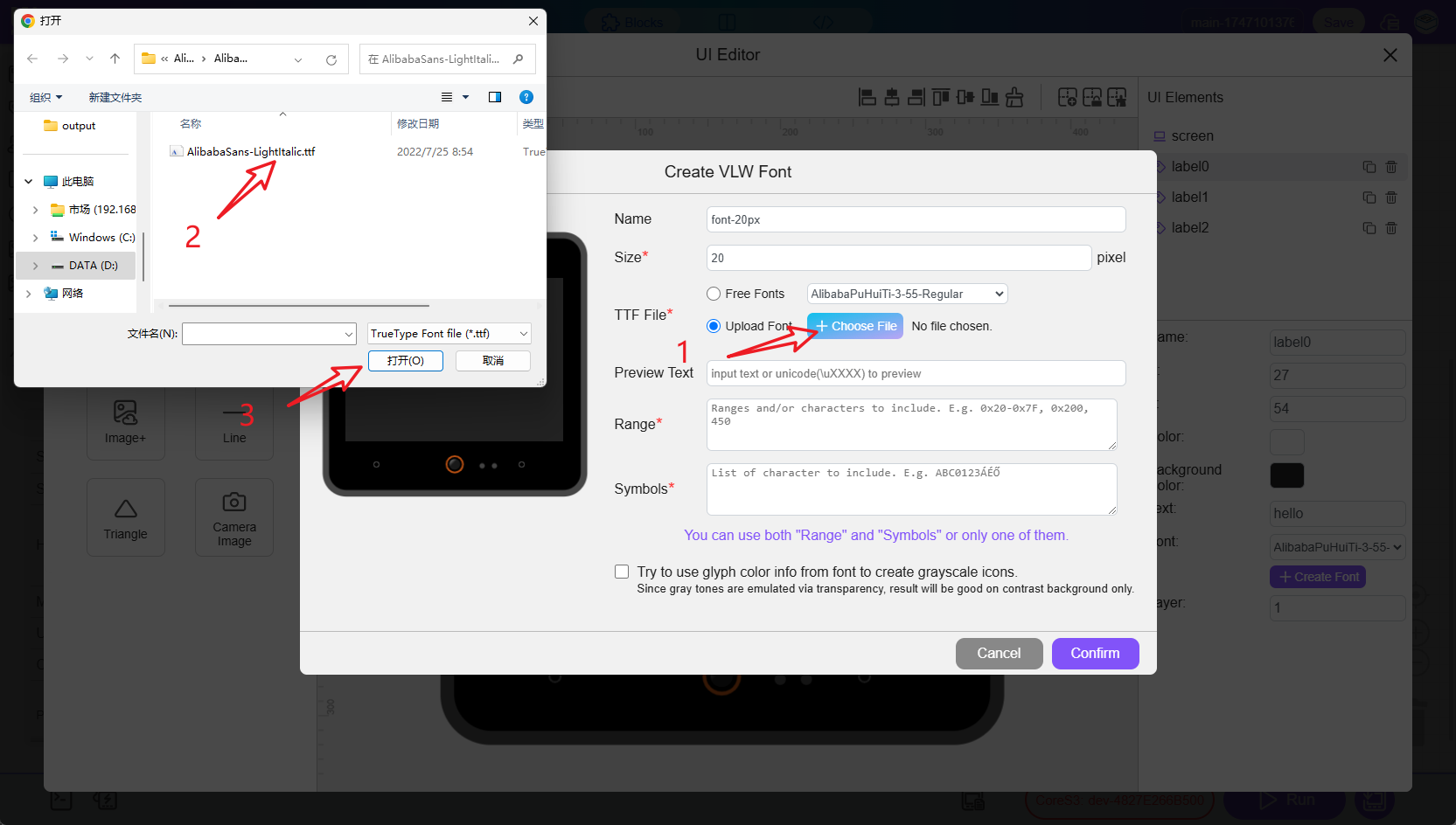

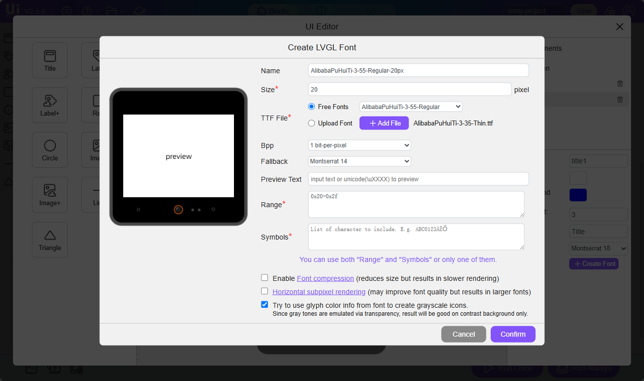

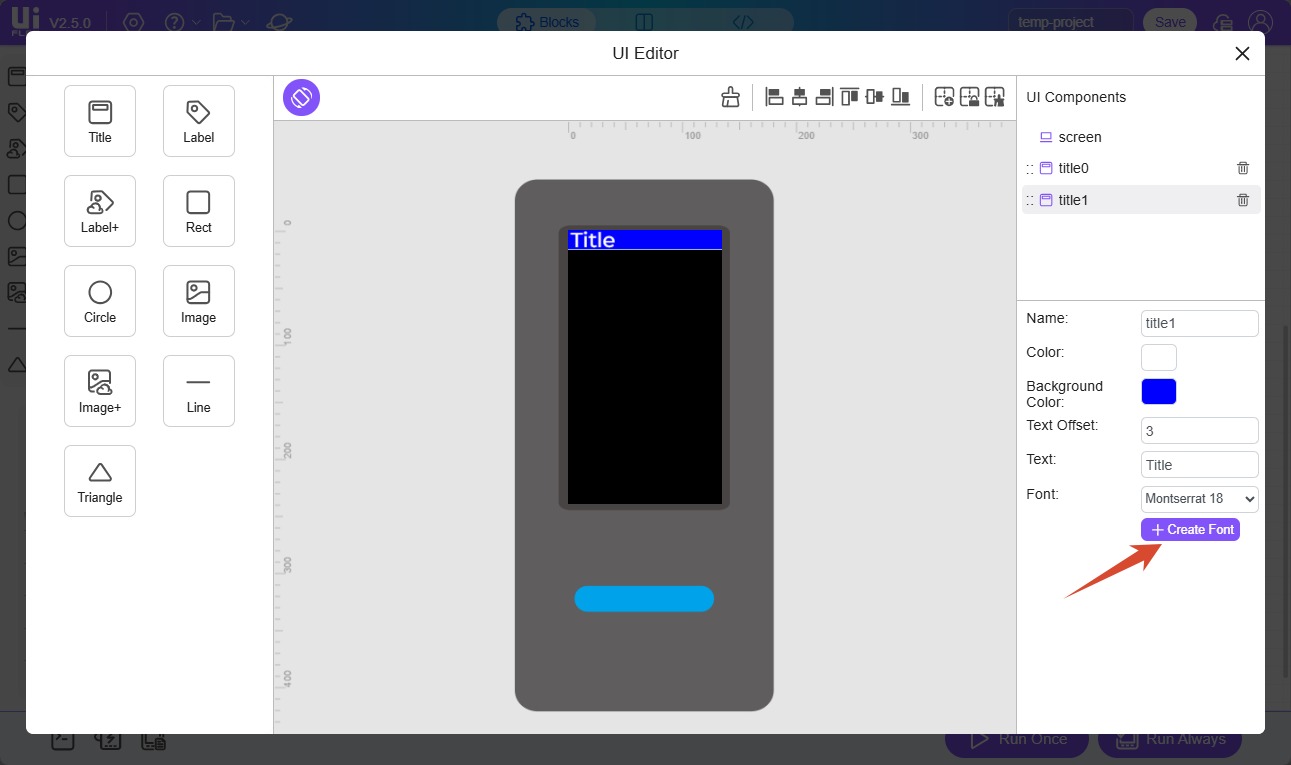

  • 4.In property panel's font configuration section, clickCreate Fontbutton and upload your TTF file
3.Font Optimization Settings (Required)

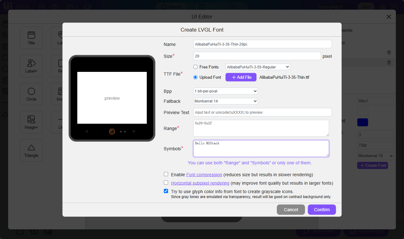

Two loading methods available: Symbol loading and Range loading. Can be combined. At least one method must be selected due to device storage limitations.
Range Loading
Import specific character sets via Unicode ranges. Examples: ASCII (0x20-0x7F), Common Chinese (0x4E00-0x9FA5)
Advantage: Suitable for continuously encoded character sets. Note: Check font encoding table in advance, avoid excessive ranges
Symbol Loading
Directly input required characters. Example: Enter "Hello M5Stack" to make only these characters available
Advantage: Precise control, saves space. Note: Must include all potentially needed characters

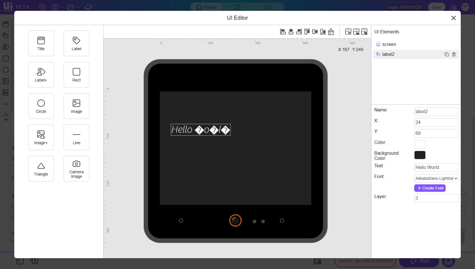

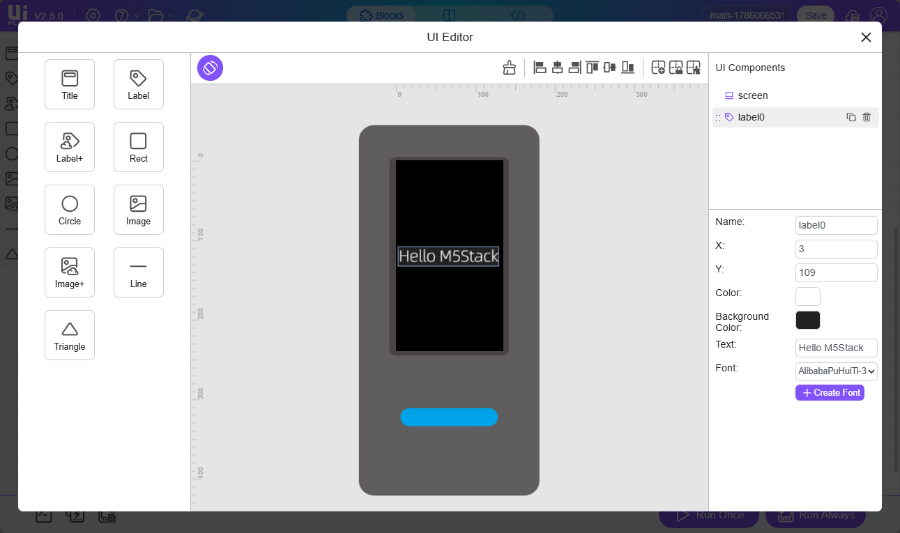

  • Testing: Verify display effects after font integration
