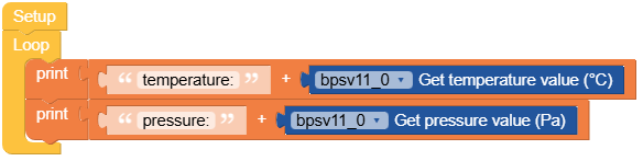

The program obtains atmospheric pressure and temperature
from m5stack import *
from m5ui import *
from uiflow import *
import unit
setScreenColor(0x222222)
bpsv11_0 = unit.get(unit.BPS_QMP, unit.PORTA)
while True:
  print((str('temperature:') + str((bpsv11_0.temperature))))
  print((str('pressure:') + str((bpsv11_0.pressure))))
  wait_ms(2)
API
  • Get Pressure value (Pa)
  • Obtain the temperature sensed by the device (° C)
