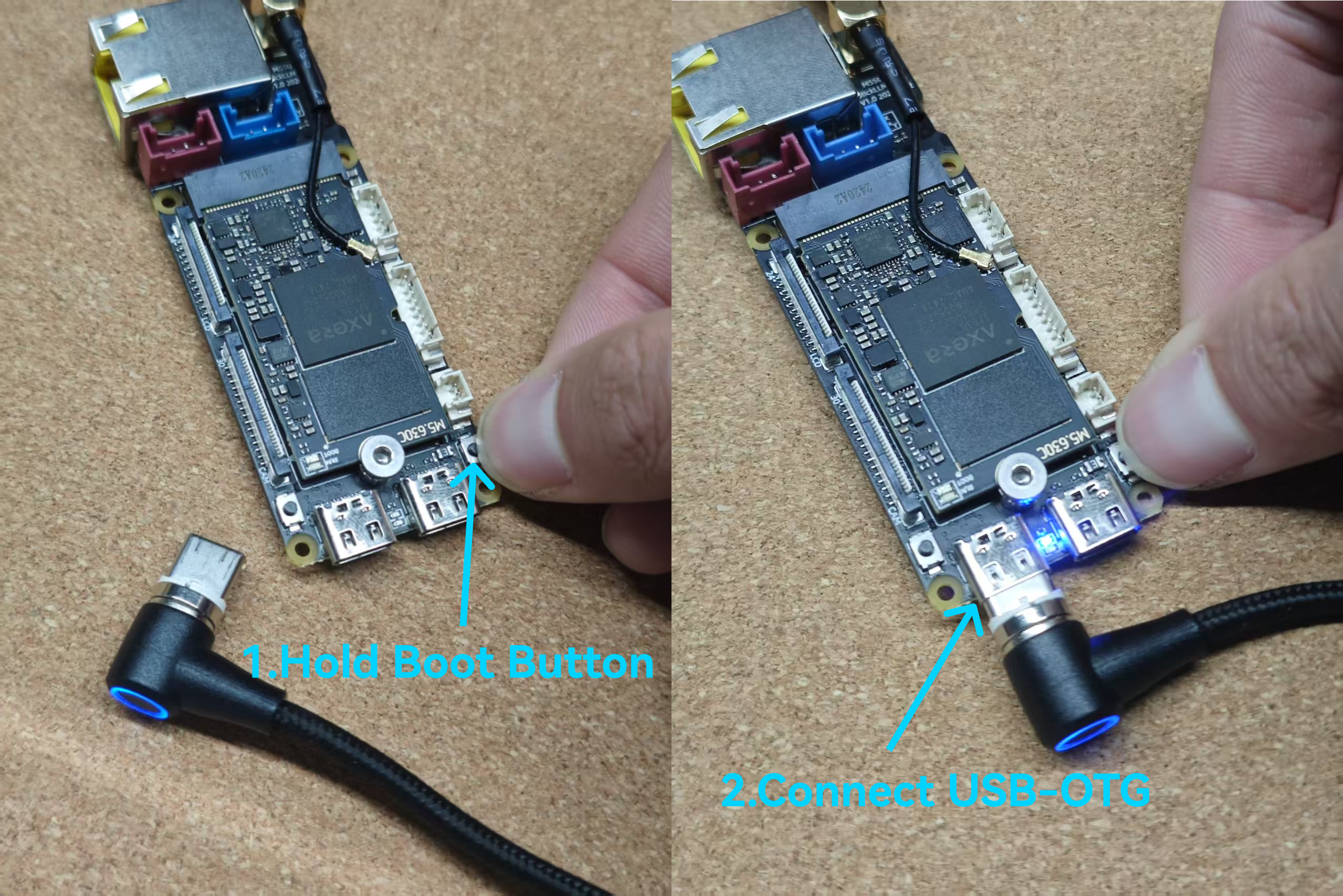

  • 1.Before powering the module, keep the download button pressed.
  • 2.Connect the module’s USB-OTG port to the computer.
  • 3.The device will enter download mode, and the flashing software will automatically begin flashing the firmware.
