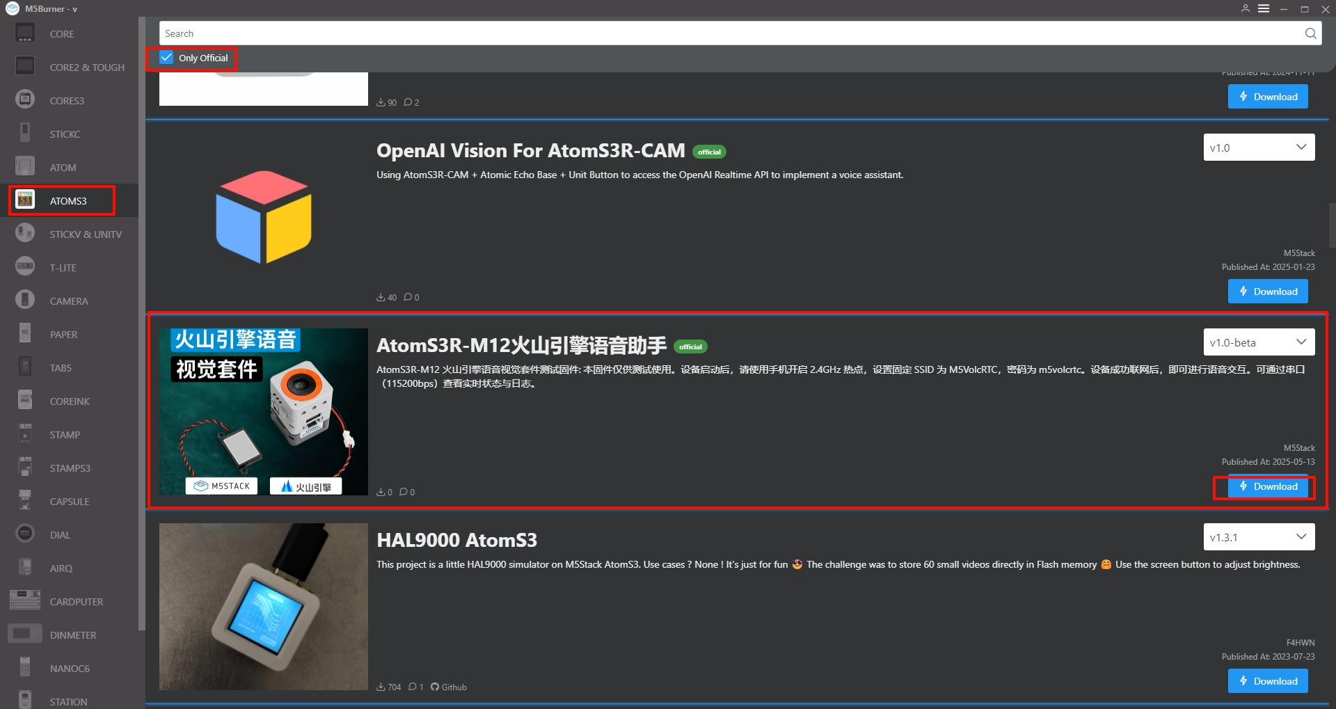

  1. Double-click to open the Burner tool. In the left menu, select the device type AtomS3, then check the Only Official option at the top of the interface, and find the AtomS3R-M12 Volcengine Voice Assistant firmware to download.

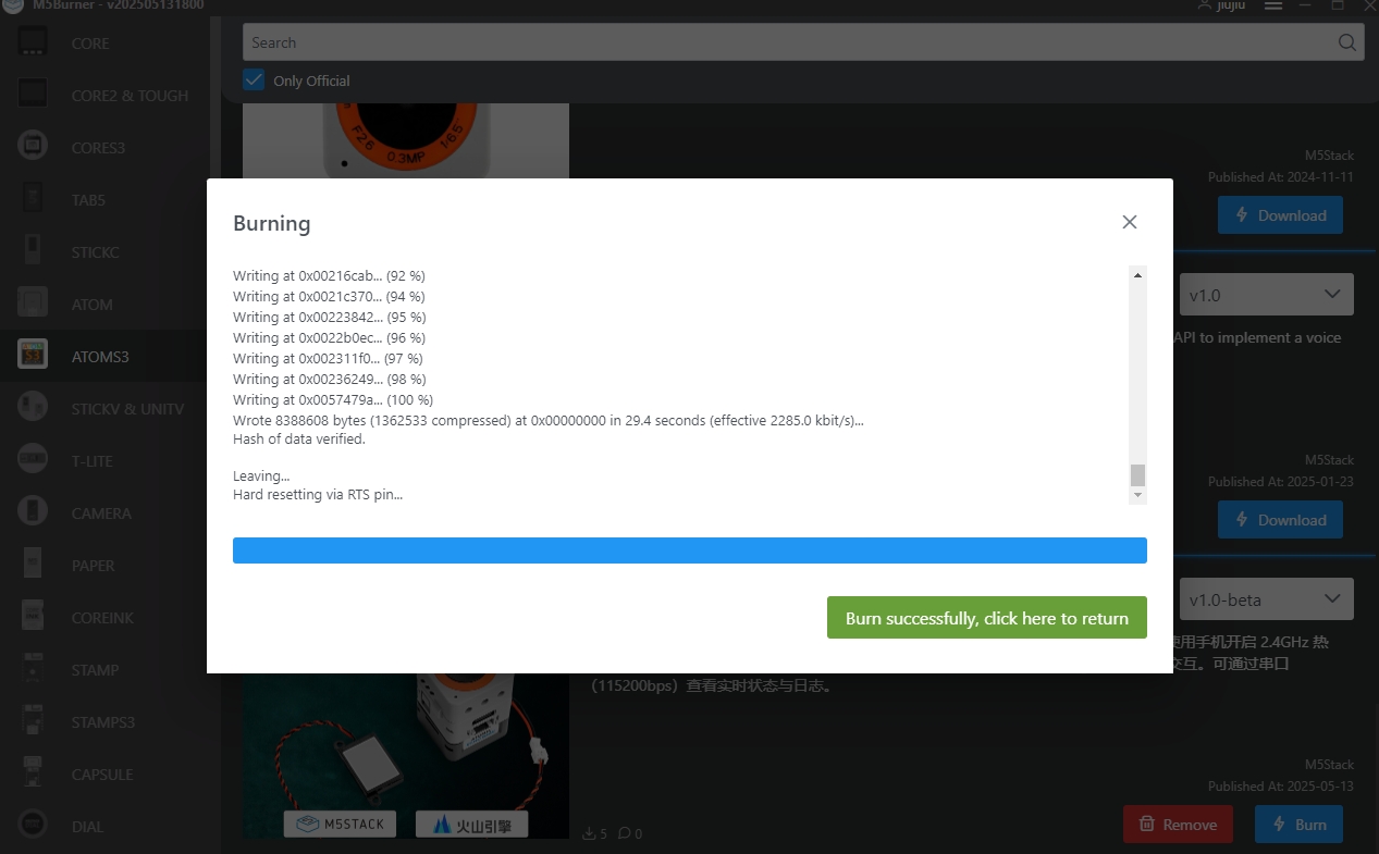

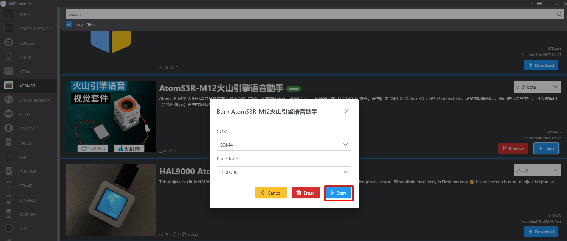

  1. In the Burner tool interface, click Burn. In the popup window, select the corresponding port for your device. Click Start, and wait for the burning to complete.

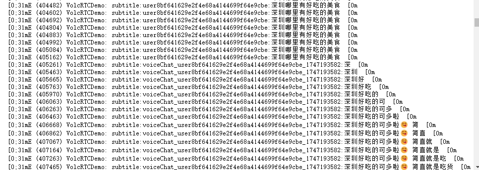

After completing the above configuration, you can start the conversation. You can view real-time status and logs via the serial port (115200 bps).
