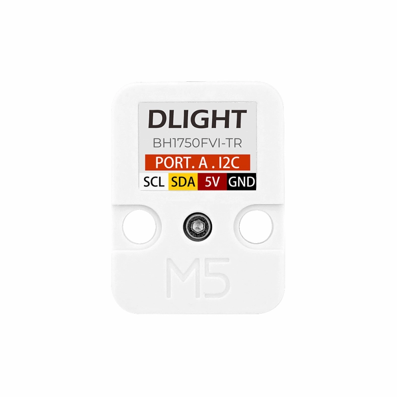

Hardware Products
  • Unit DLight
  • A compatible controller (such as an Atom, Stamp, Stick, Core, or Basic series device)
Note
Unit DLight requires a compatible controller to integrate with Home Assistant. Select the controller model and interface pins according to your project.

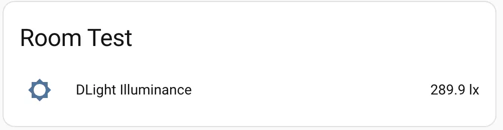

3. Getting Started
Once successfully added to Home Assistant:
