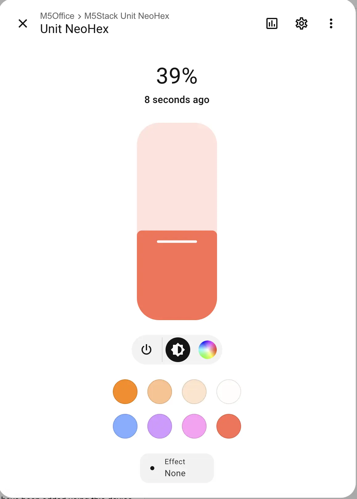

3. Getting Started
After completing the configuration and successfully flashing the firmware, locate the light entity for Unit NeoHEX in Home Assistant to control the light.
