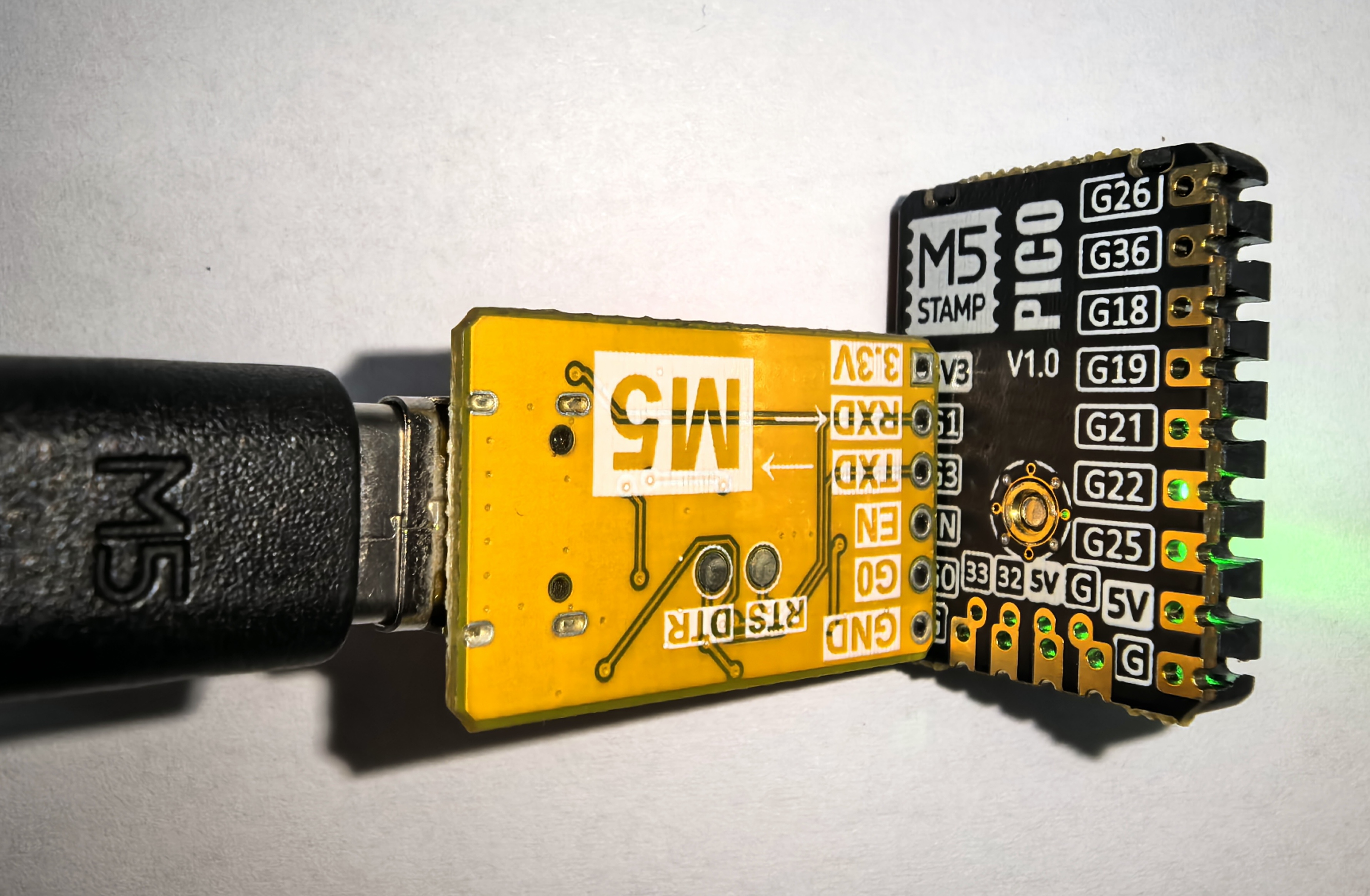

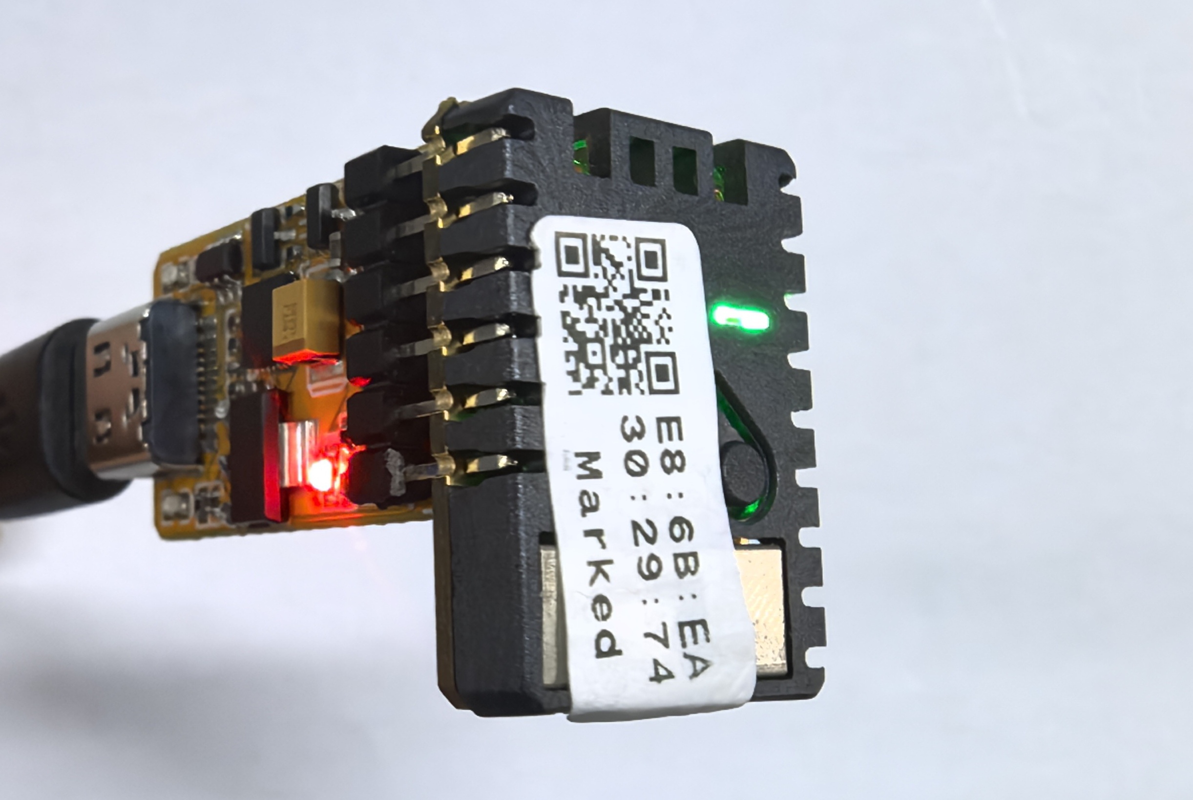

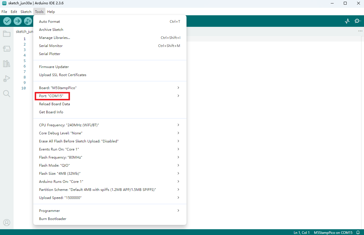

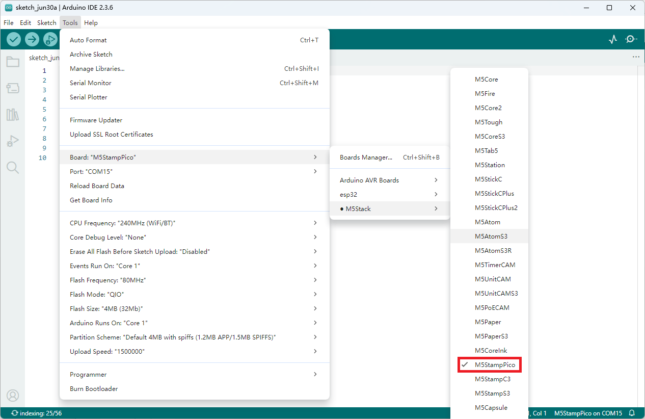

2.Port Selection
Connect the device to the computer via a USB cable and a USB-TTL adapter board, and the corresponding device's port can be selected in Arduino IDE.

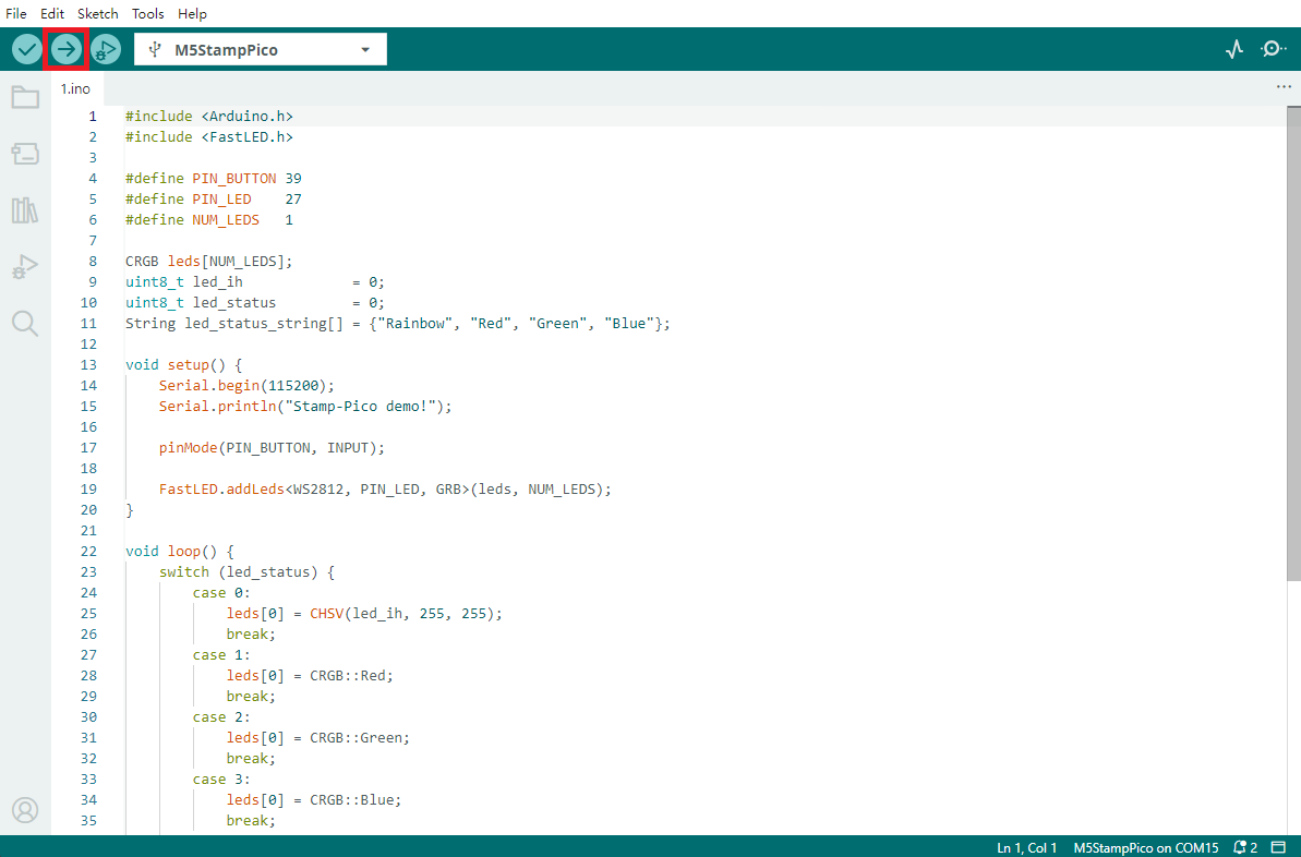

3.Program Compilation & Upload
Enter the following code in the Arduino IDE workspace, and click the upload button. The program will be automatically compiled and uploaded.
Note:
This example is realized based on FastLEDlibrary, please install FastLEDdependency library through the library manager before use.
1 2 3 4 5 6 7 8 9 10 11 12 13 14 15 16 17 18 19 20 21 22 23 24 25 26 27 28 29 30 31 32 33 34 35 36 37 38 39 40 41 42 43 44 45 46 47 48 49 50 51 52 53 54
#include <Arduino.h>
#include <FastLED.h>
#define PIN_BUTTON 39
#define PIN_LED    27
#define NUM_LEDS   1
CRGB leds[NUM_LEDS];
uint8_t led_ih             = 0;
uint8_t led_status         = 0;
String led_status_string[] = {"Rainbow", "Red", "Green", "Blue"};
    Serial.println("Stamp-Pico demo!");
    pinMode(PIN_BUTTON, INPUT);
    FastLED.addLeds<WS2812, PIN_LED, GRB>(leds, NUM_LEDS);
    switch (led_status) {
        case 0:
            leds[0] = CHSV(led_ih, 255, 255);
            break;
        case 1:
            leds[0] = CRGB::Red;
            break;
        case 2:
            leds[0] = CRGB::Green;
            break;
        case 3:
            leds[0] = CRGB::Blue;
            break;
        default:
            break;
    FastLED.show();
    led_ih++;
    delay(15);
    if (!digitalRead(PIN_BUTTON)) {
        delay(5);
            led_status++;
            if (led_status > 3) led_status = 0;
            while (!digitalRead(PIN_BUTTON))
            Serial.print("LED status updated: ");
            Serial.println(led_status_string[led_status]);
After uploading the code, the RGB LED on the Stamp-Pico device will light up automatically. Pressing the button allows you to cycle through the display colors of the LED. At the same time, the device will output the current light status information (such as color values or modes) through the serial port, facilitating debugging and interactive feedback.
