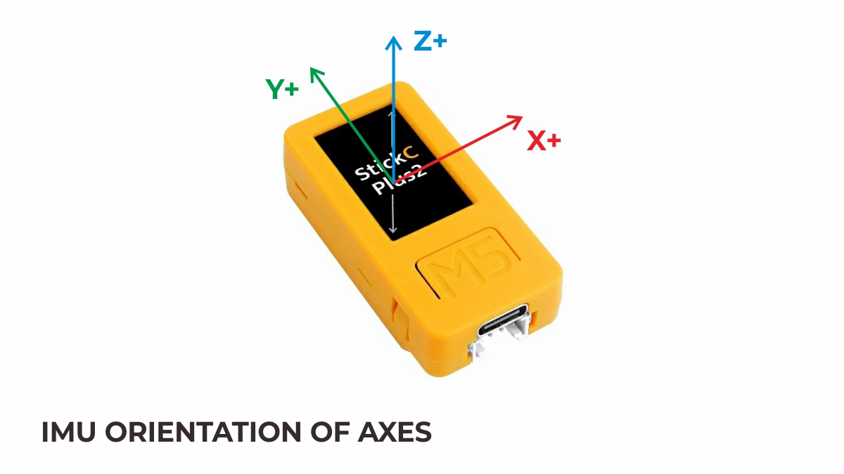

IMU Triaxial Direction Schematic Diagram
