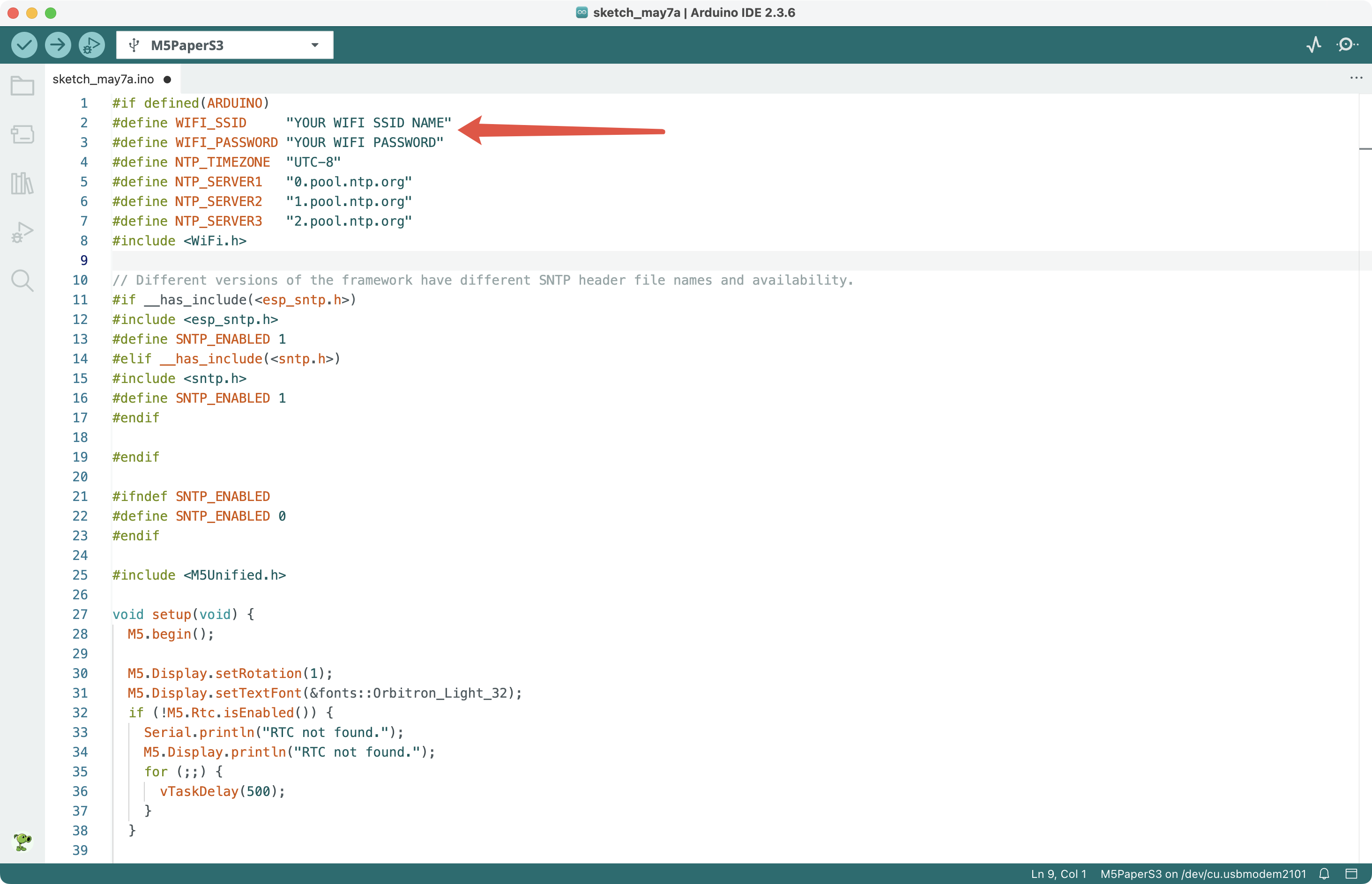

#if defined(ARDUINO)
#define WIFI_SSID "YOUR WIFI SSID NAME"
#define WIFI_PASSWORD "YOUR WIFI PASSWORD"
#define NTP_TIMEZONE "UTC-8"
#define NTP_SERVER1 "0.pool.ntp.org"
#define NTP_SERVER2 "1.pool.ntp.org"
#define NTP_SERVER3 "2.pool.ntp.org"

Fill in the Wi-Fi name and password to connect in the program, then click the Upload button to display the real-time clock.
