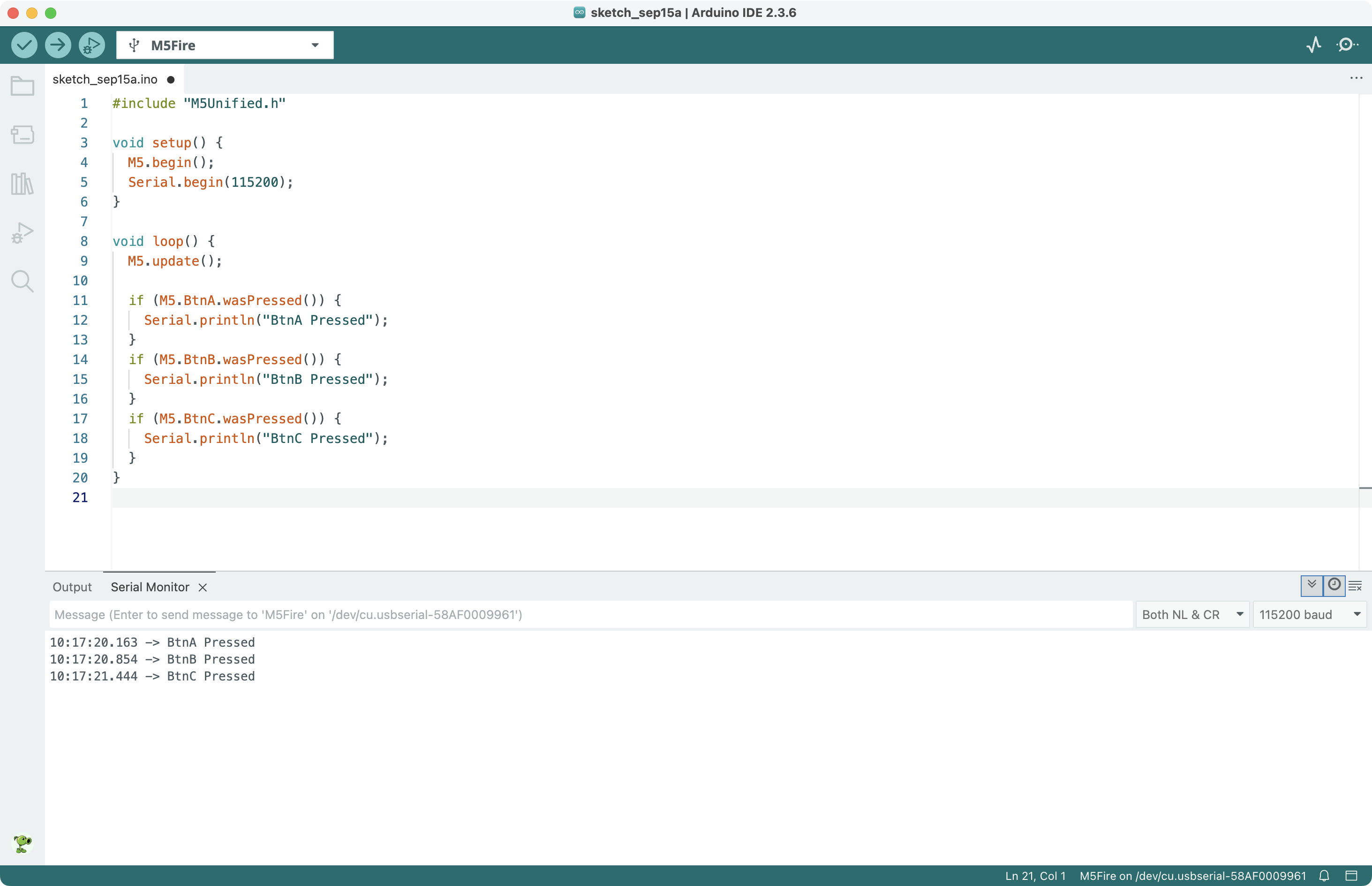

1 2 3 4 5 6 7 8 9 10 11 12 13 14 15 16 17 18 19 20
#include "M5Unified.h"
void setup() {
  M5.begin();
  Serial.begin(115200);
void loop() {
  M5.update();
  if (M5.BtnA.wasPressed()) {
    Serial.println("BtnA Pressed");
  if (M5.BtnB.wasPressed()) {
    Serial.println("BtnB Pressed");
  if (M5.BtnC.wasPressed()) {
    Serial.println("BtnC Pressed");
The program will detect whether the three buttons are pressed and print messages in the Serial Monitor:
