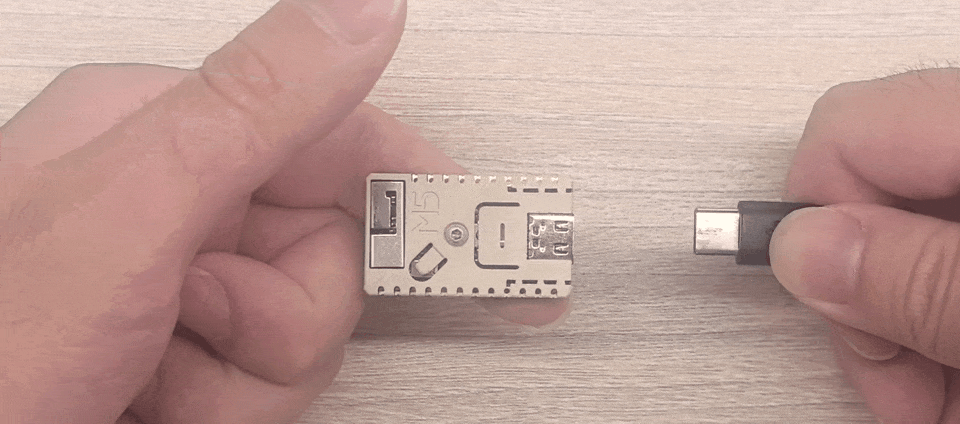

2.Download Mode
Press and hold the IO button on the Stamp-C3U, and connect the device to the computer via a USB cable. At this time, the port can be recognized on the computer, indicating that the device has entered the download mode.

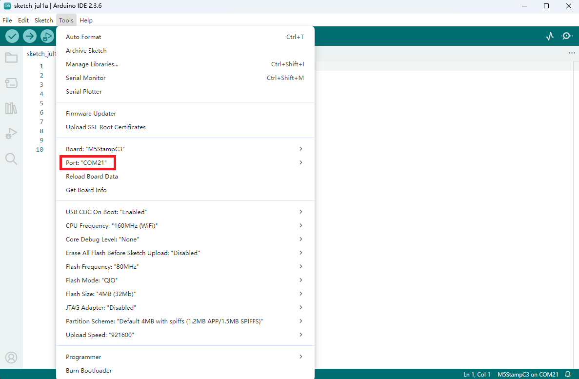

3.Port Selection
Wait for the device to successfully recognize the port, and select the corresponding device's port in Arduino IDE.

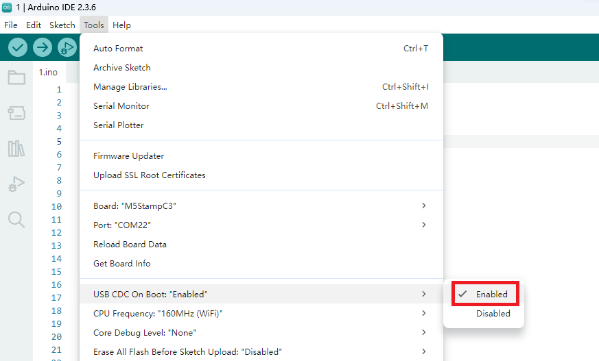

Note:
Please set the Tools -> USB-CDC On Boot option in Arduino IDE to Enabled; otherwise, the serial port cannot be used. The location of this option is as shown in the following picture.

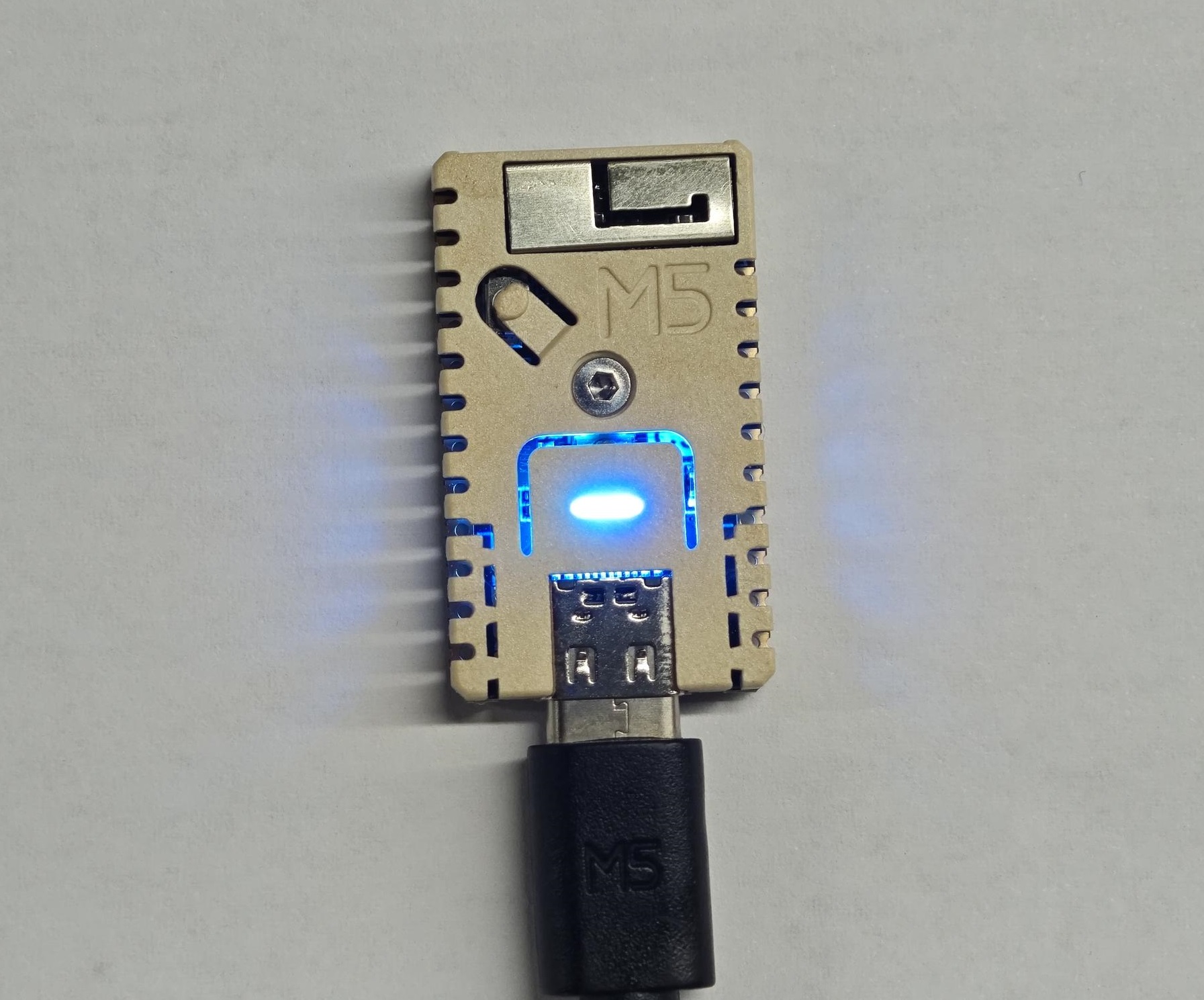

After uploading the code, the RGB LED on the Stamp-C3U device will light up automatically. Pressing the button allows you to cycle through the display colors of the LED. At the same time, the device will output the current light status information (such as color values or modes) through the serial port, facilitating debugging and interactive feedback.
