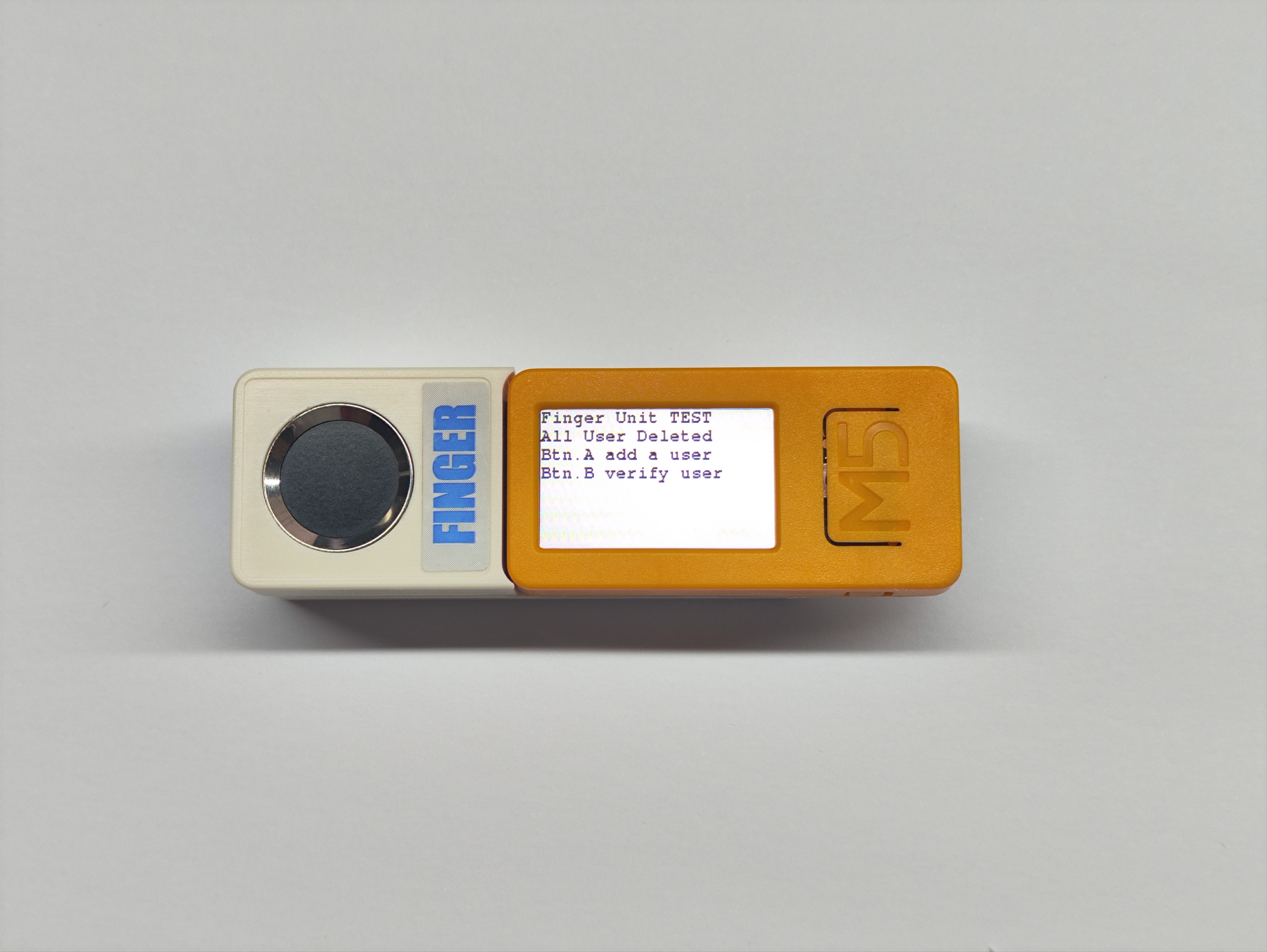

    finger.delAllFinger();
    M5.Display.println("All User Deleted");
    M5.Display.println("Btn.A add a user");
    M5.Display.println("Btn.B verify user");

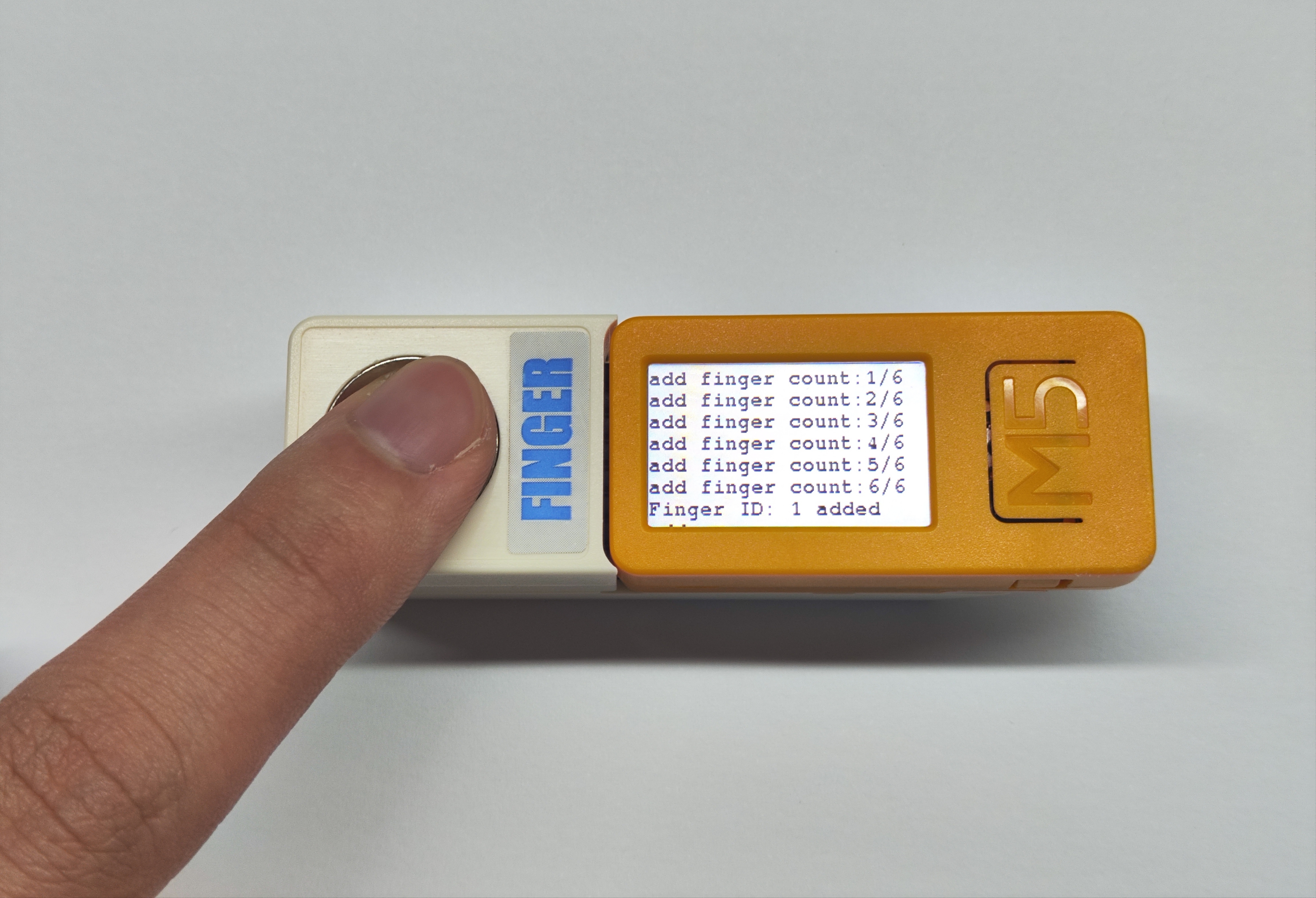

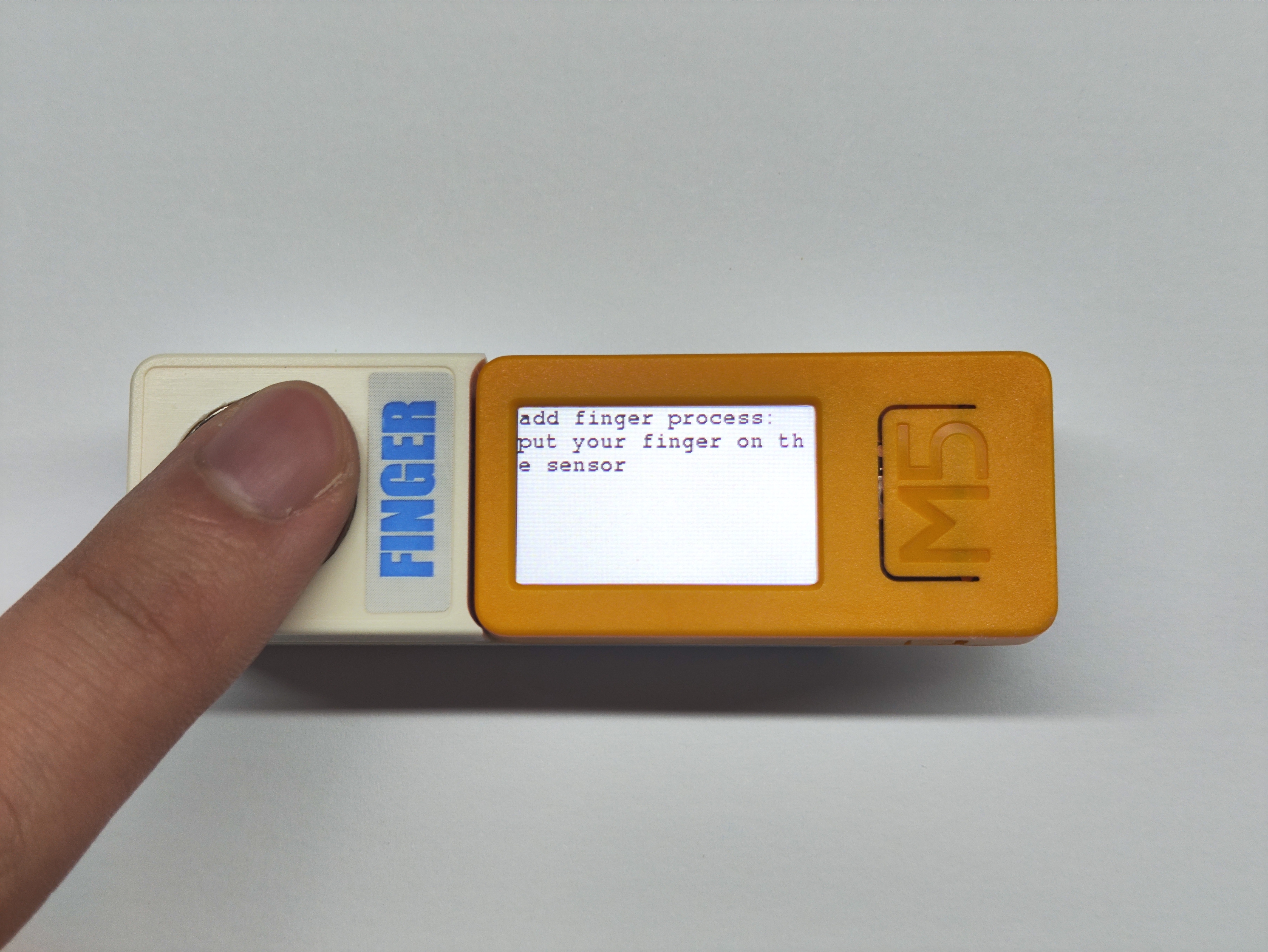

    M5.Display.println("add finger process:");
    M5.Display.println("put your finger on the sensor");
    for (uint8_t i = 0; i < 6; i++) {
        while (!finger.addFinger(id, permission, i)) {
            Serial.printf("Finger ID: %d Finger Record:%d error\r\n", id, i);
            Serial.println("Retry...");
            delay(1000);
        a += 9;
        M5.Display.scroll(0, -9);
        M5.Display.fillRect(0, a, 240, 135, WHITE);
        M5.Display.setCursor(0, a);
        M5.Display.printf("add finger count:%d/6\r\n", i + 1);
        Serial.printf("Finger ID: %d Finger Record:%d ok\r\n", id, i);
    M5.Display.printf("Finger ID: %d added\r\n", id);

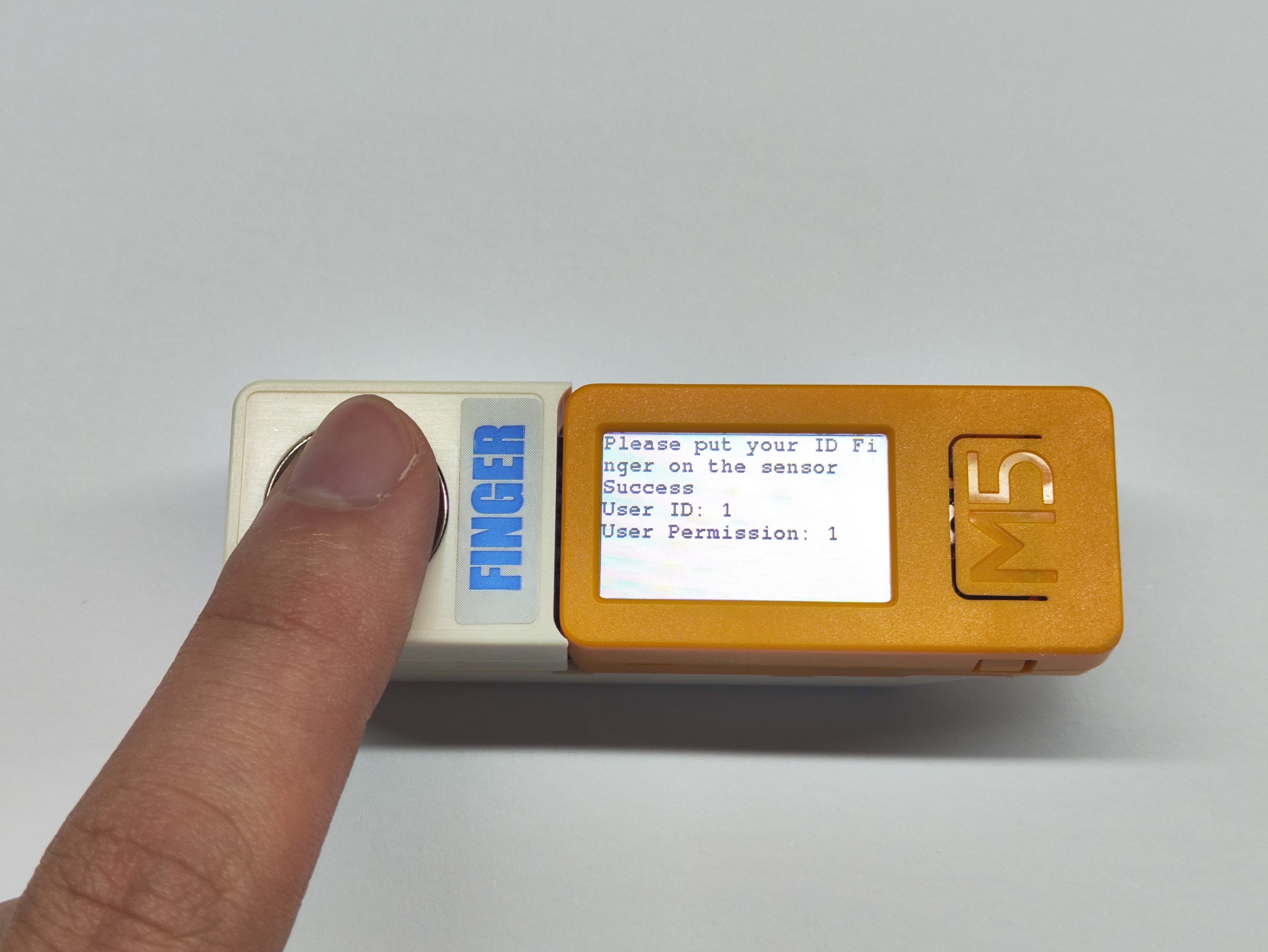

        if (res == ACK_SUCCESS) {
            M5.Display.println("Success");
            Serial.println("Success");
            M5.Display.print("User ID: ");
            Serial.print("User ID: ");
            M5.Display.println(finger.getFingerID());
            Serial.println(finger.getFingerID());
            M5.Display.print("User Permission: ");
            Serial.print("User Permission: ");
            M5.Display.println(finger.getFingerPermission());
            Serial.println(finger.getFingerPermission());

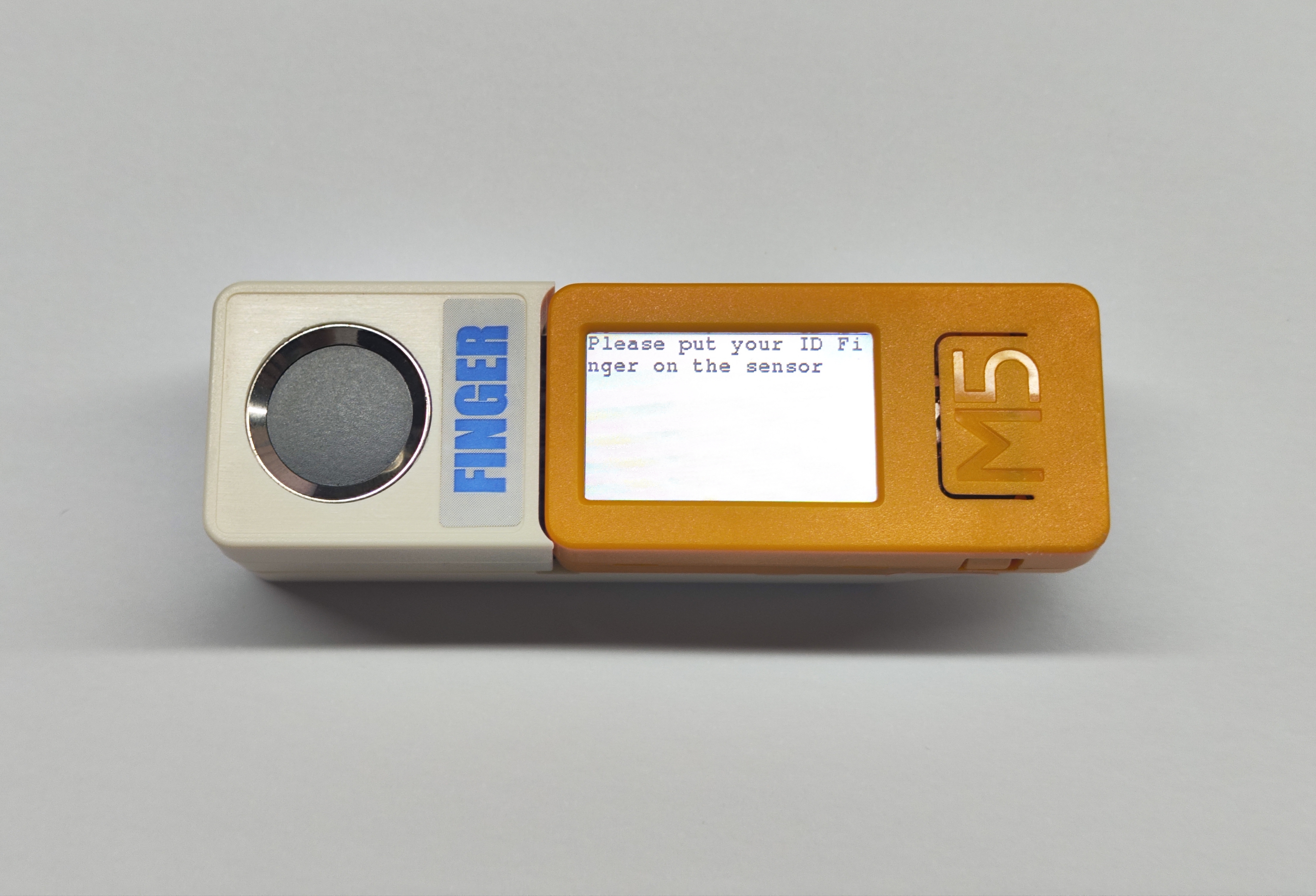

            Serial.println("Please put your ID Finger on the sensor");
            M5.Display.println("Please put your ID Finger on the sensor");

  • The initial page displays the function of this routine. Press the Btn.A button to enter the fingerprint enrollment page, and press the Btn.B button to enter the fingerprint recognition page.
  • After entering the fingerprint enrollment page, place the finger to be enrolled on the sensor and wait for the enrollment to complete.
  • You can then perform fingerprint recognition testing. Press the Btn.B button, place your finger on the sensor, and wait for the recognition to complete. When the word Success appears, it indicates successful recognition (this interface will only switch upon successful recognition).
