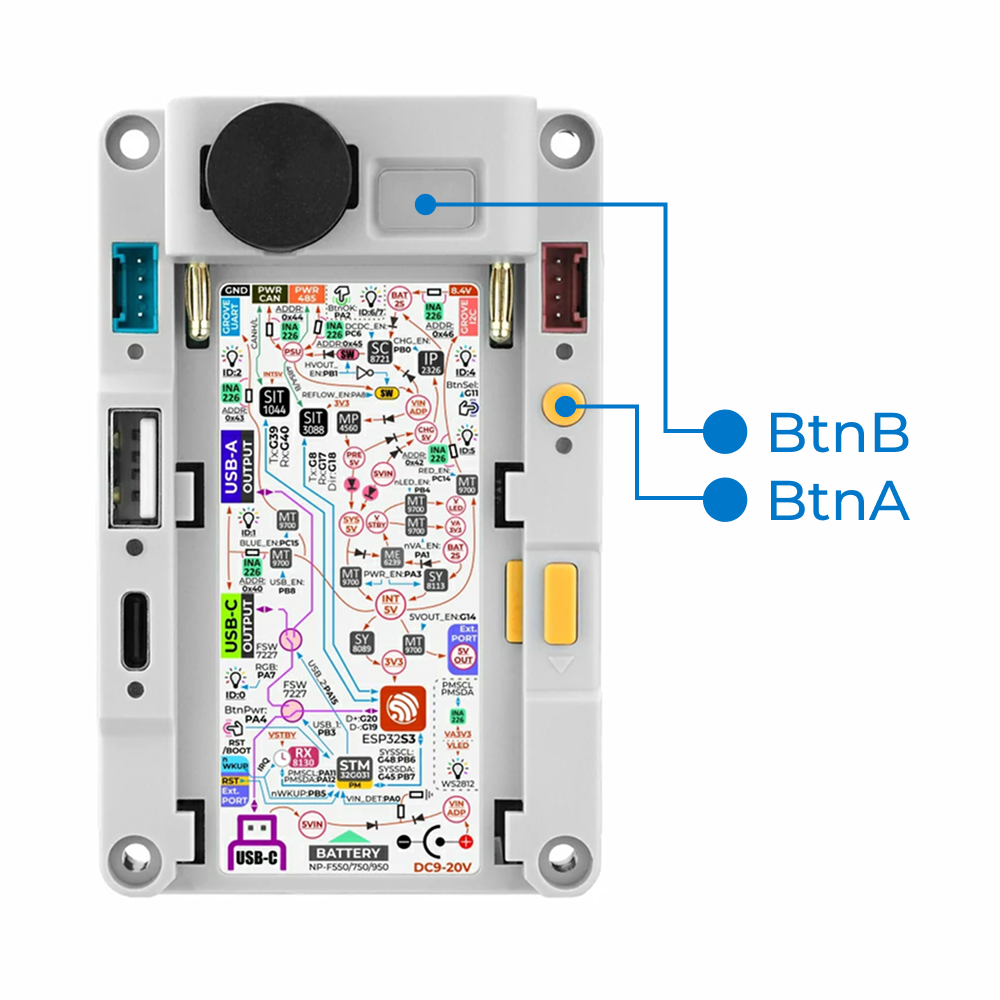

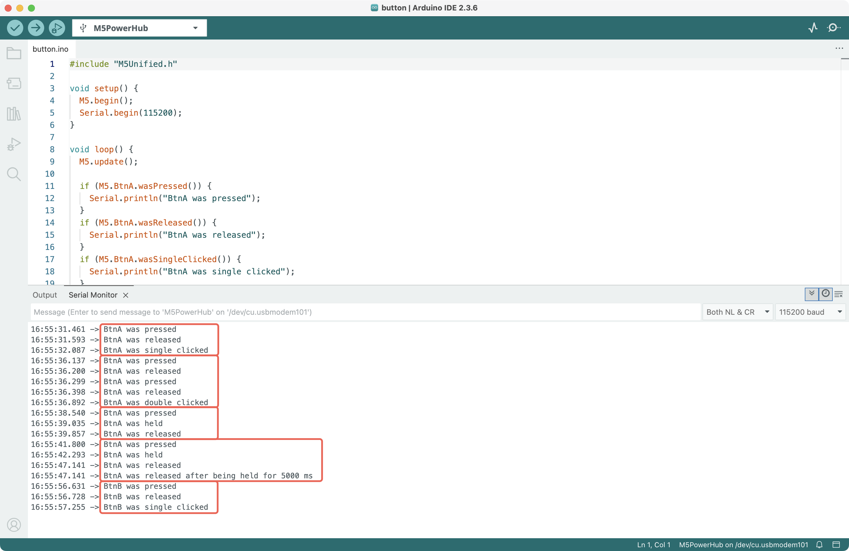

This program detects the status of two buttons on the device (the yellow round button as BtnA and the rectangular translucent button as BtnB), including states such as pressed, released, single short press, double short press, long press, and release after holding for 5000 milliseconds. The messages are printed in the Serial Monitor:
