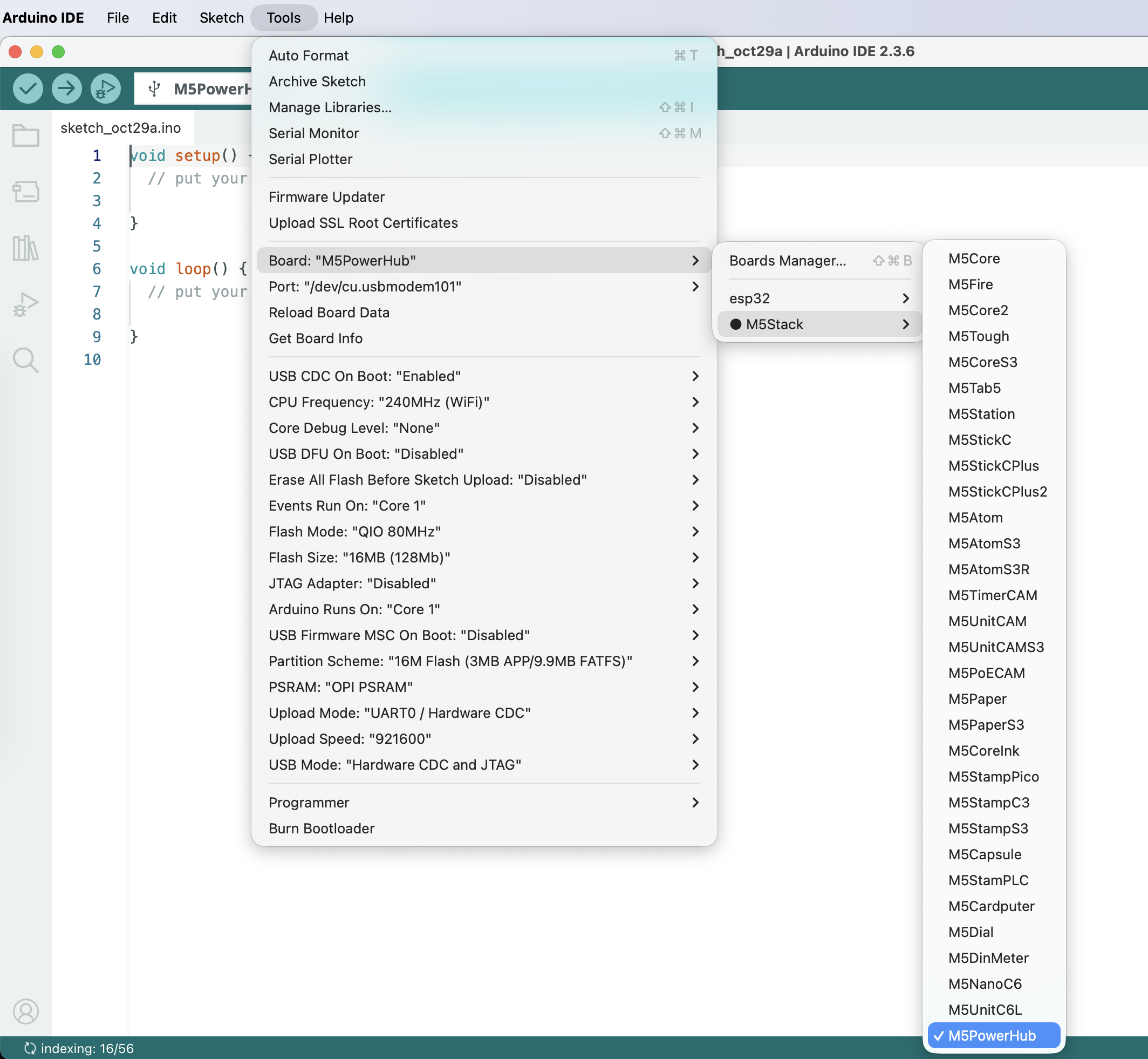

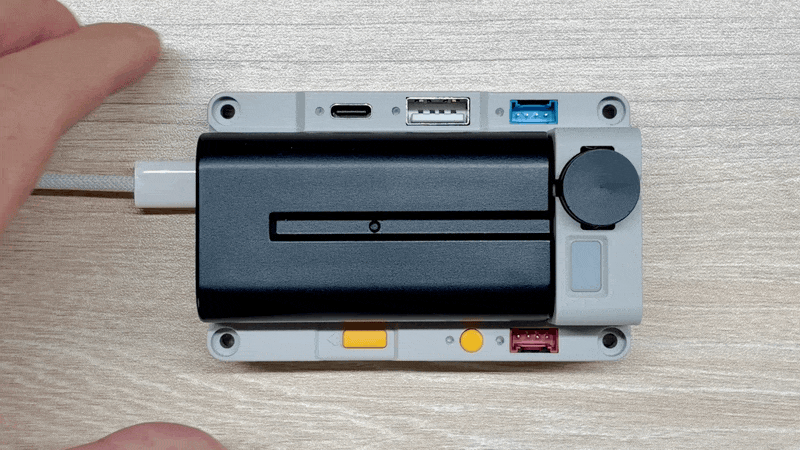

2.Port Selection
Connect the device to your computer via a USB-C data cable. Press and hold the side BtnPWR button for 3 seconds until the indicator light next to the black antenna flashes blue several times. The device will then enter download mode, and you can select the corresponding controller and device port in Arduino IDE.
