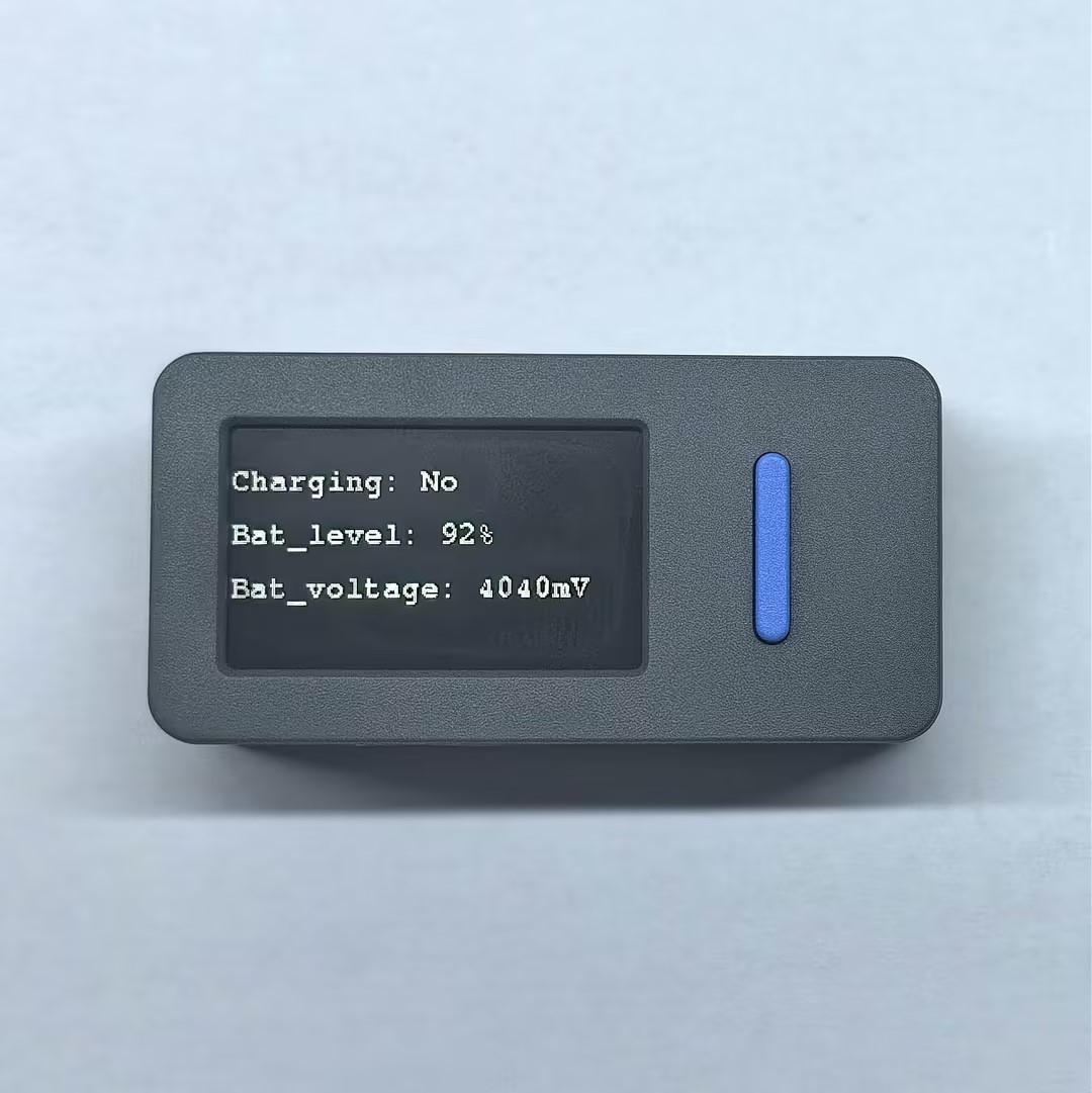

    bool isCharging = M5.Power.isCharging();
    int vol_per = M5.Power.getBatteryLevel();
    int vol = M5.Power.getBatteryVoltage();
    M5.Lcd.setCursor(0, 30);
    M5.Lcd.printf("Charging: %s \n\n", isCharging ? "Yes" : "No");
    M5.Lcd.setCursor(0, 60);
    M5.Lcd.printf("Bat_level: %d%%", vol_per);
    M5.Lcd.setCursor(0, 90);
    M5.Lcd.printf("Bat_voltage: %d%mV", vol);
    delay(2000);
This program will display whether the battery is charging, the battery percentage, and the battery voltage on the screen, refreshing every 2 seconds.
