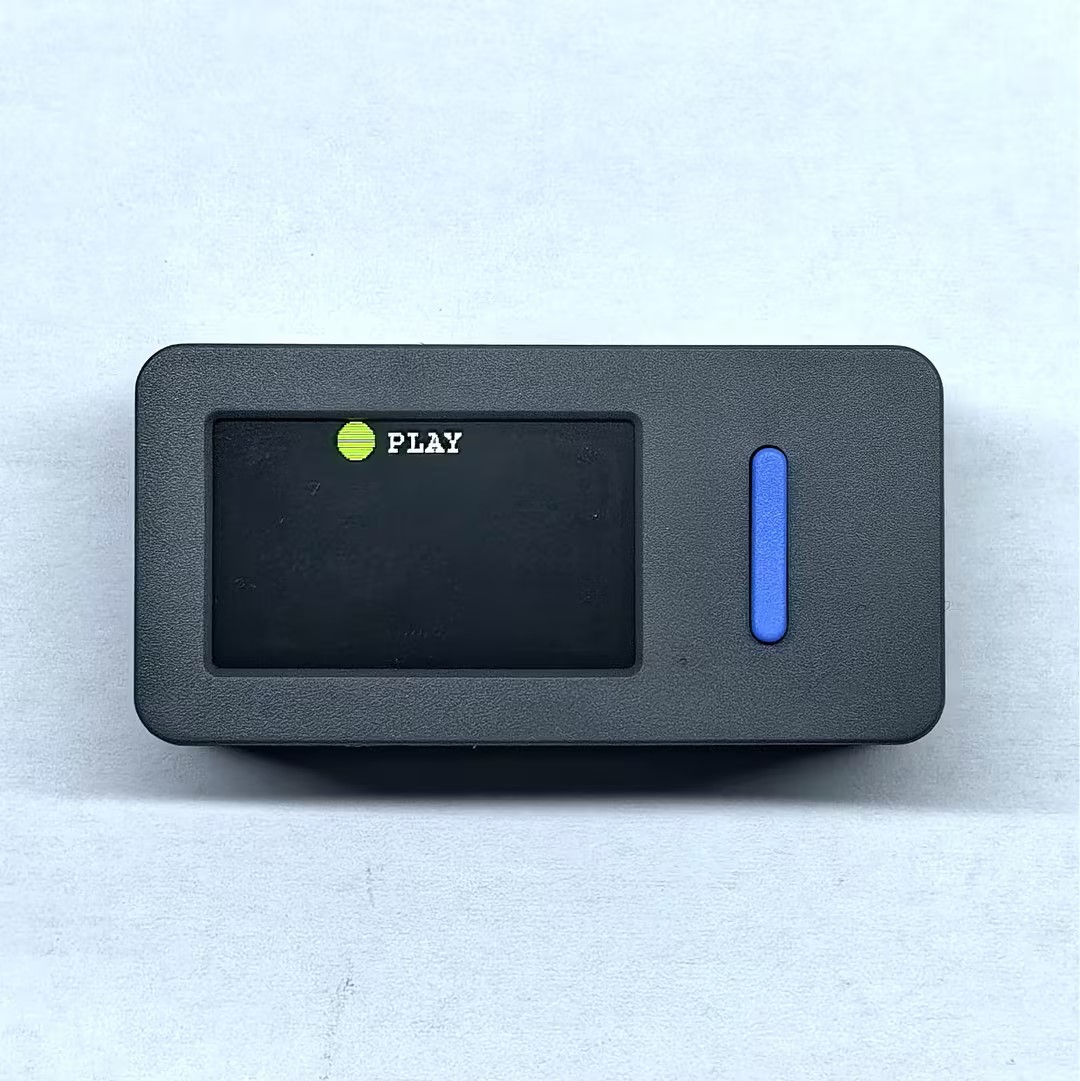

This program displays the microphone recording status on the screen and plays the recording when button A is pressed. After the recording finishes playing, it automatically returns to recording mode.
