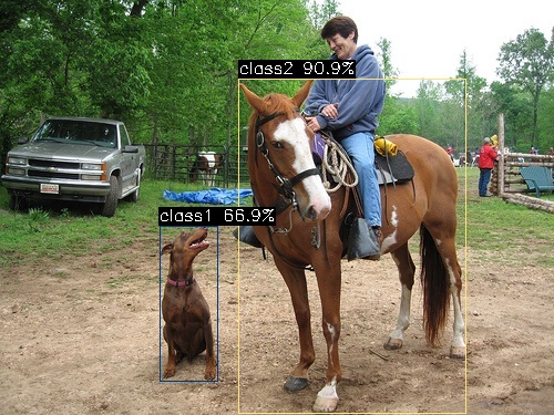

./axcl_demo/axcl_yolo_world_open_vocabulary -m axcl_demo/yoloworldv2_4cls_50_npu3.axmodel -t axcl_demo/dog.bin -i axcl_demo/ssd_horse.jpg
The running result is as follows:
m5stack@raspberrypi:~/rsp $ ./axcl_demo/axcl_yolo_world_open_vocabulary -m axcl_demo/yoloworldv2_4cls_50_npu3.axmodel -t axcl_demo/dog.bin -i axcl_demo/ssd_horse.jpg
model file : axcl_demo/yoloworldv2_4cls_50_npu3.axmodel
image file : axcl_demo/ssd_horse.jpg
text_feature file : axcl_demo/dog.bin
img_h, img_w : 640 640
axclrtEngineCreateContextt is done.
axclrtEngineGetIOInfo is done.
grpid: 0
input size: 2
        1 x 640 x 640 x 3
        1 x 4 x 512
output size: 3
        1 x 80 x 80 x 68
        1 x 40 x 40 x 68
        1 x 20 x 20 x 68
Engine push input is done.
post process cost time:0.25 ms
Repeat 1 times, avg time 4.52 ms, max_time 4.52 ms, min_time 4.52 ms
detection num: 2
 1:  91%, [ 215,   71,  421,  374], class2
 0:  67%, [ 144,  204,  197,  346], class1
