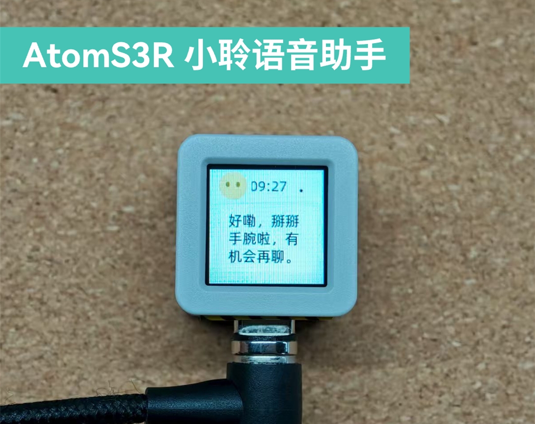

This tutorial will use the AtomS3R device together with the Atomic Voice Base hardware combination. By using M5Burner to burn the Xiaoling Voice Assistant firmware, you can build a personal voice assistant application.

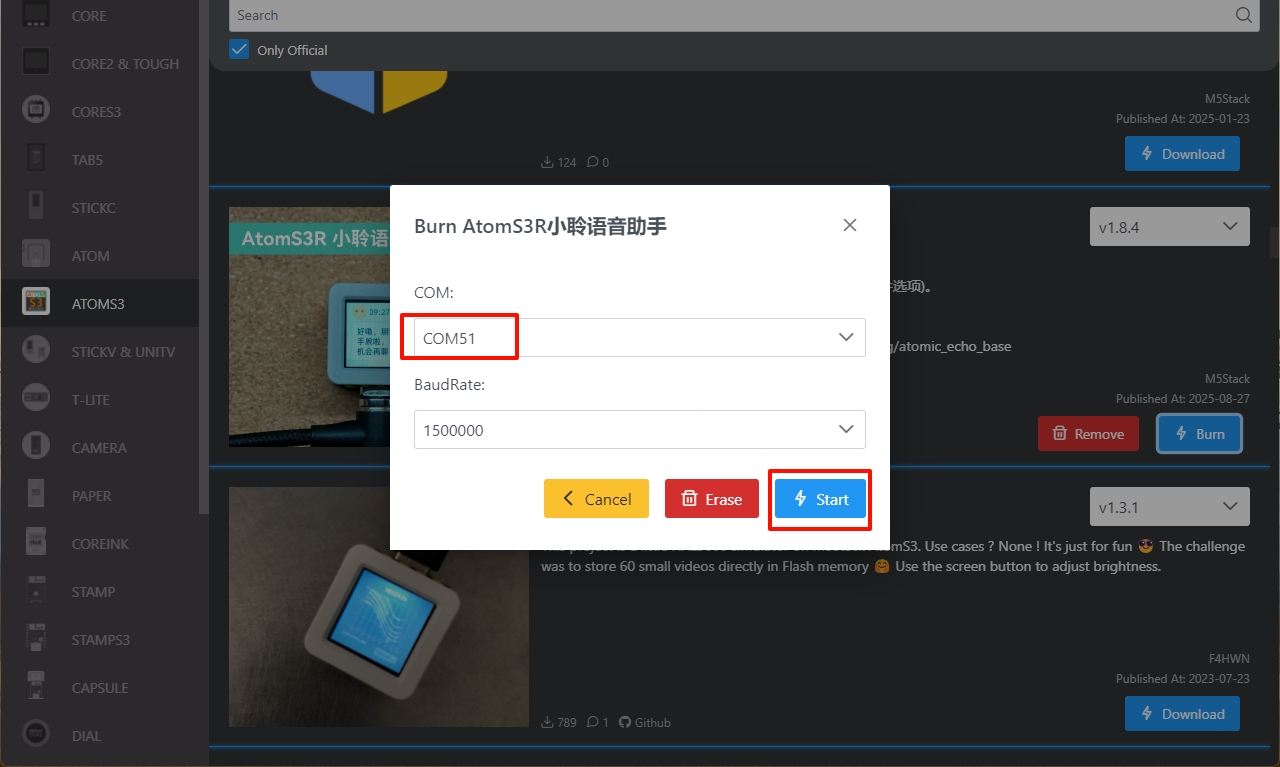

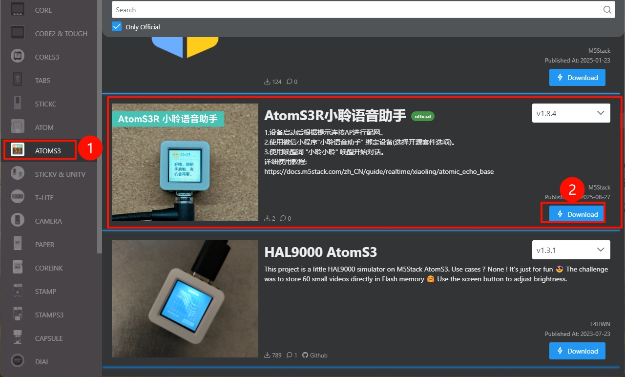

  1. Double-click to open the Burner tool, select the corresponding device type ATOMS3 from the menu on the left, and click Download to download the AtomS3R Xiaoling Voice Assistant firmware.
  1. After the device is connected via USB, press and hold the reset button (about 2 seconds) until the internal green LED lights up, then release it. The device is now in download mode, waiting for burning. The green LED turns off after the button is released, confirming that the device is in download mode.

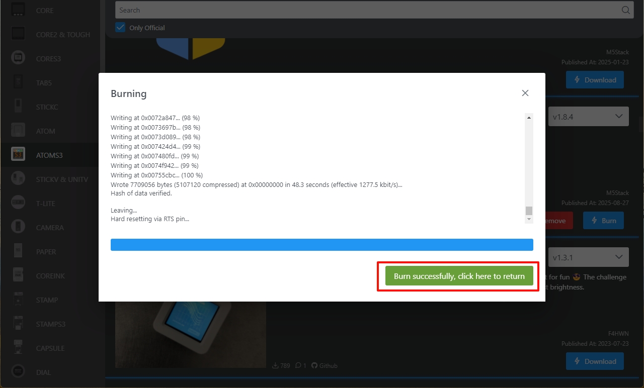

  1. Click Burn, select the port corresponding to your device, then click Start and wait for the burning process to complete.

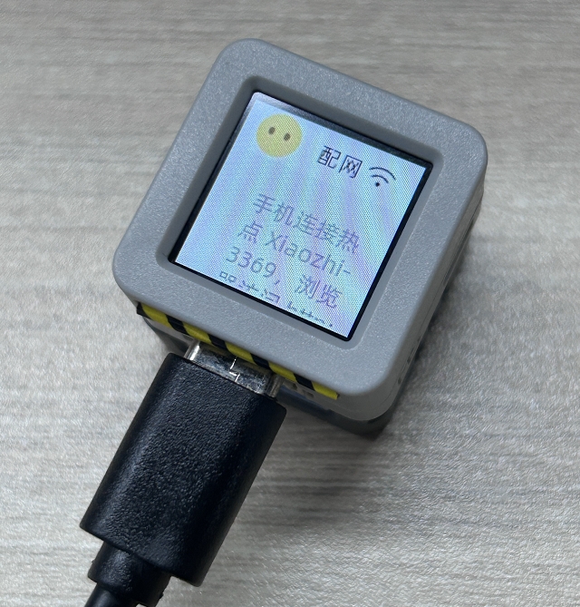

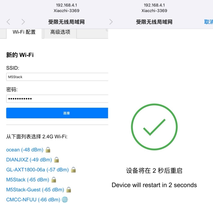

  1. After the device starts, it will prompt you to connect to the AP hotspot. You can connect your phone to the hotspot Xiaozhi-xxx, or visit 192.168.4.1 to enter the network configuration page.
  1. Follow the instructions on the page to complete the Wi-Fi configuration.

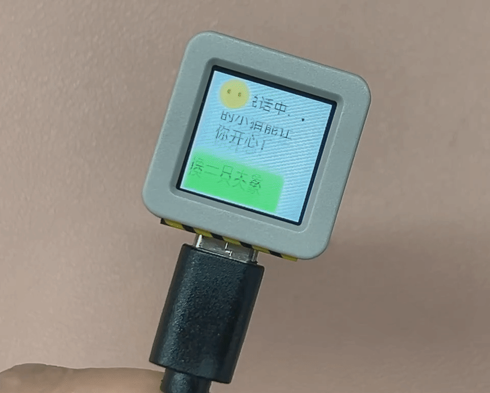

Once the Wi-Fi configuration is successful, the Xiaoling Voice Assistant will enter listening mode, and you can start a conversation.
