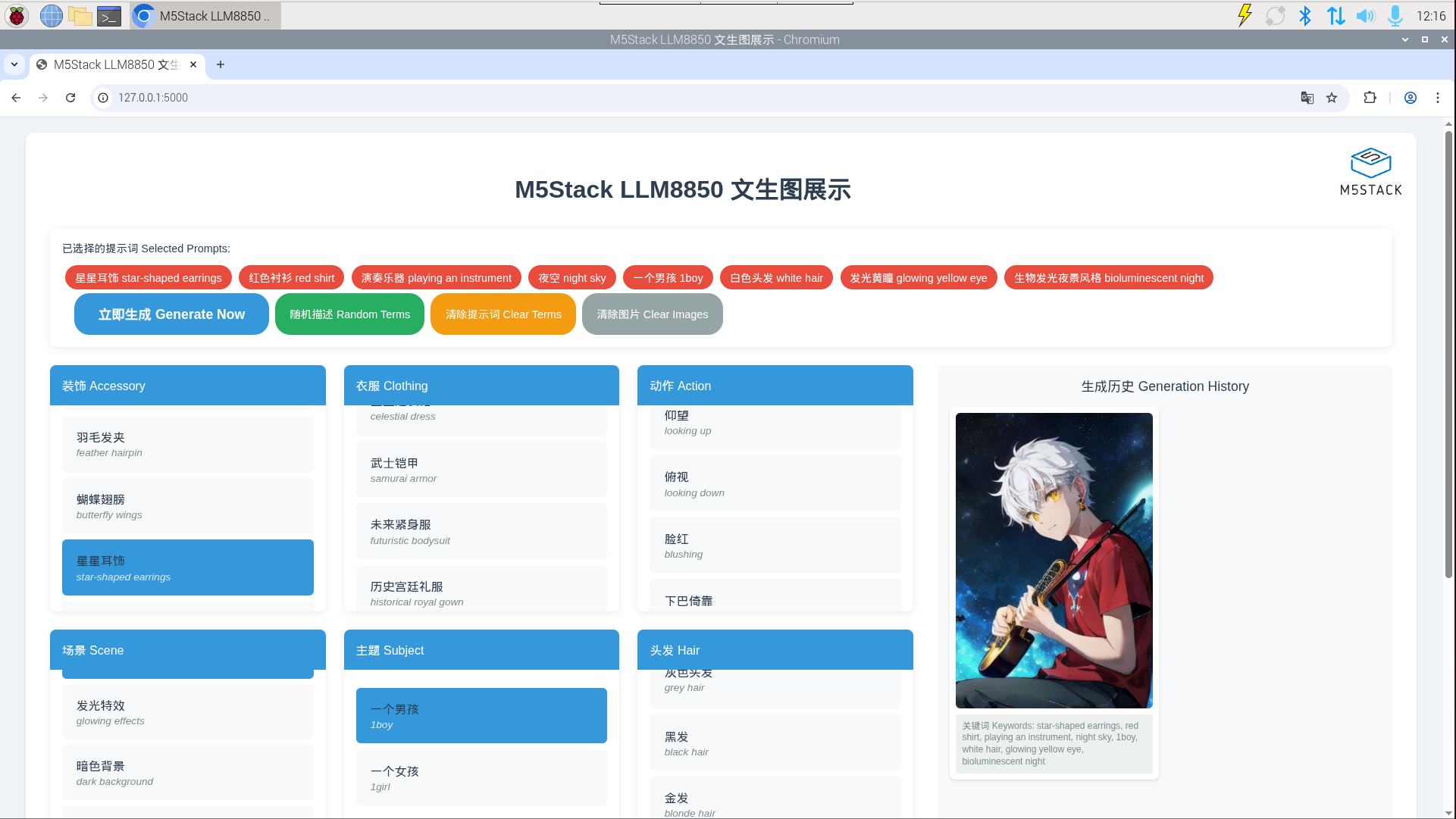

uvicorn api_10steps:app --host 0.0.0.0 --port 7888
Open a new terminal and start the Web UI
source sd/bin/activate

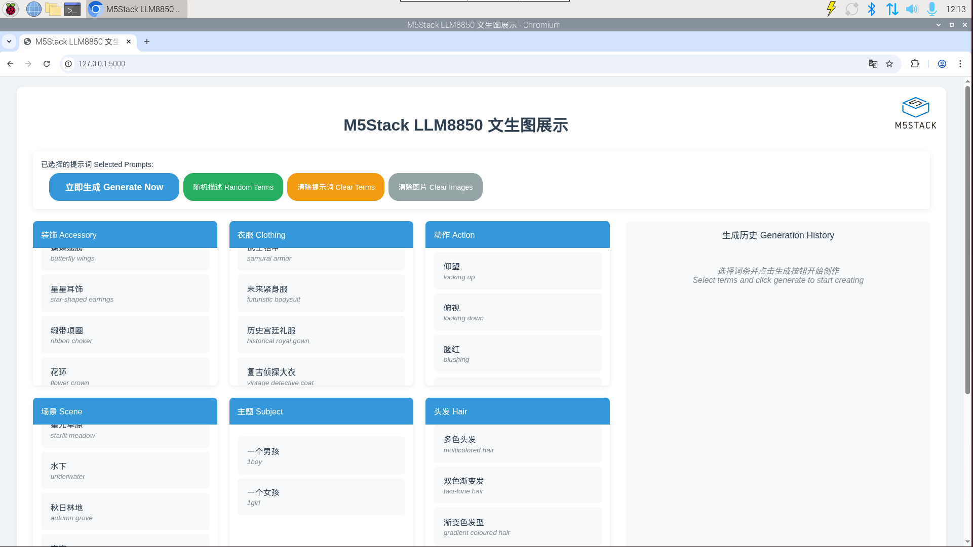

cd client && python app.py
Visit in browser: http://127.0.0.1:5000
Select the parameters you want to generate or choose a random description, and click "Generate Now".
