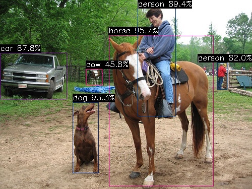

YOLO11x
Run:
./axcl_demo/axcl_yolo11 -i axcl_demo/ssd_horse.jpg -m axcl_demo/yolo11x.axmodel
The running result is as follows:
m5stack@raspberrypi:~/rsp $ ./axcl_demo/axcl_yolo11 -i axcl_demo/ssd_horse.jpg -m axcl_demo/yolo11x.axmodel
model file : axcl_demo/yolo11x.axmodel
image file : axcl_demo/ssd_horse.jpg
img_h, img_w : 640 640
axclrtEngineCreateContextt is done.
axclrtEngineGetIOInfo is done.
grpid: 0
input size: 1
        1 x 640 x 640 x 3
output size: 3
        1 x 80 x 80 x 144
        1 x 40 x 40 x 144
        1 x 20 x 20 x 144
Engine push input is done.
post process cost time:0.88 ms
Repeat 1 times, avg time 24.69 ms, max_time 24.69 ms, min_time 24.69 ms
detection num: 6
17:  96%, [ 216,   71,  423,  370], horse
16:  93%, [ 144,  203,  196,  345], dog
 0:  89%, [ 273,   14,  349,  231], person
 2:  88%, [   1,  105,  132,  197], car
 0:  82%, [ 431,  124,  451,  178], person
19:  46%, [ 171,  137,  202,  169], cow
