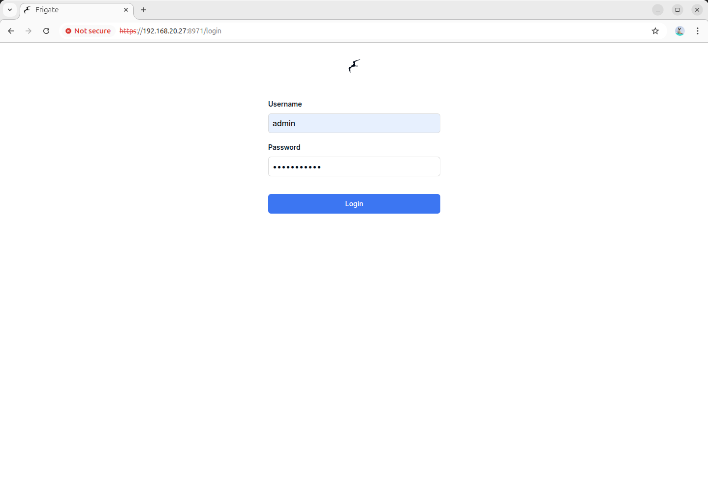

  1. Access Frigate management Web via https://server_ip:8971
Tip
Default username admin Default password axera123456

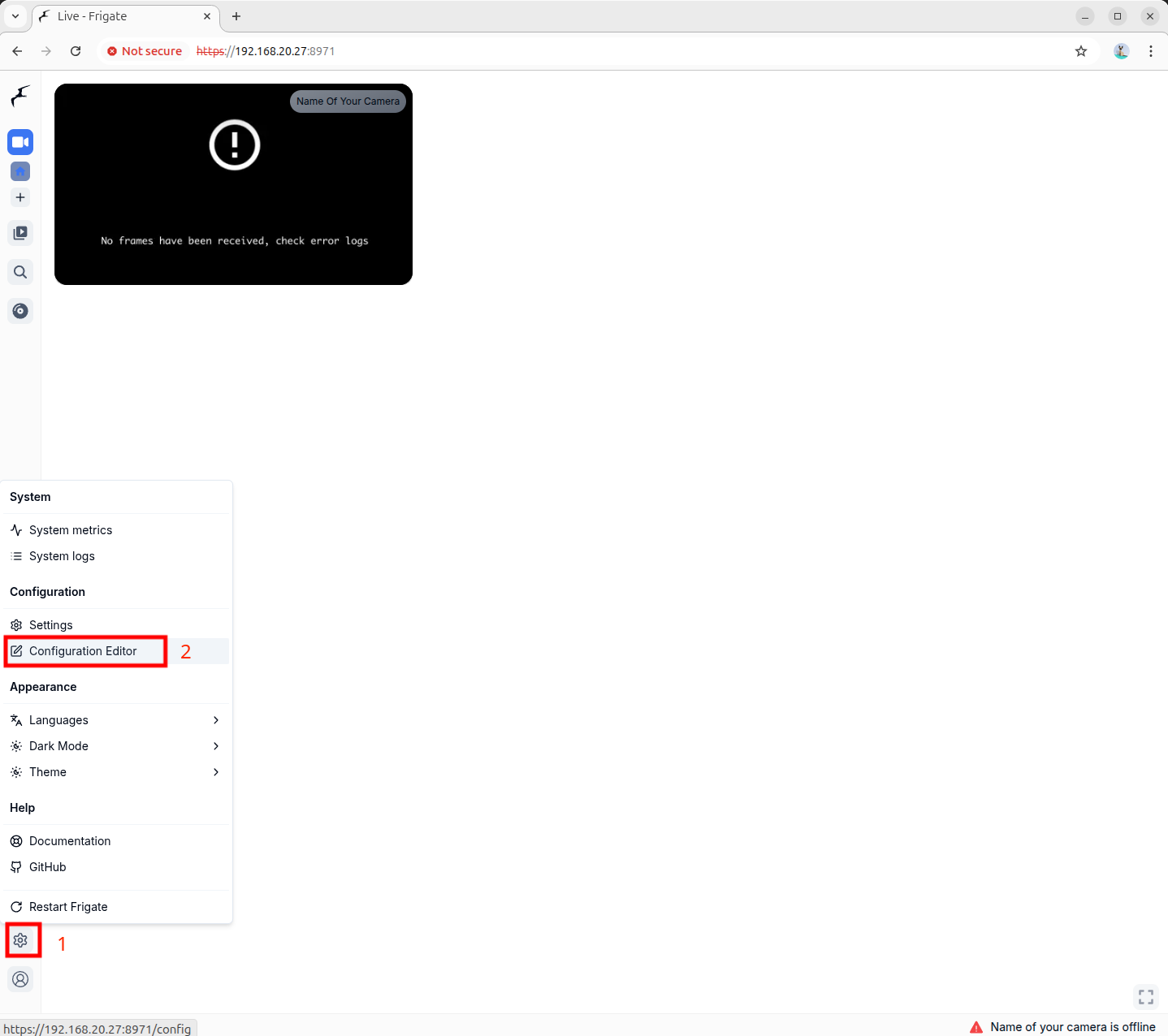

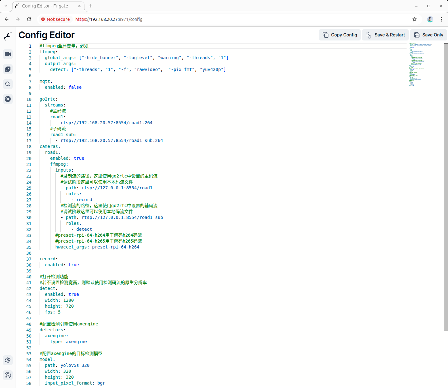

  1. Click settings, configure parameters, enter the following content. Modify the go2rtc part to your own IP Camera address, save and restart.
Configuration example:
#ffmpeg global variables, required
ffmpeg:
  global_args: ["-hide_banner", "-loglevel", "warning", "-threads", "1"]
  output_args:
    detect: ["-threads", "1", "-f", "rawvideo",  "-pix_fmt", "yuv420p"]
mqtt:
  enabled: false
go2rtc:
  streams:
    #main stream
    road1:
      - rtsp://192.168.20.57:8554/road1.264
    #sub stream
    road1_sub:
      - rtsp://192.168.20.57:8554/road1_sub.264
cameras:
  road1:
    enabled: true
    ffmpeg:
      inputs:
        #path to the recording stream, here using the main stream set in go2rtc
        #during debugging, you can use local stream files here
        - path: rtsp://127.0.0.1:8554/road1
          roles:
            - record
        #path to the detection stream, here using the sub stream set in go2rtc
        - path: rtsp://127.0.0.1:8554/road1_sub
          roles:
            - detect
      #preset-rpi-64-h264 for decoding h264 stream
      #preset-rpi-64-h265 for decoding h265 stream
      hwaccel_args: preset-rpi-64-h264
record:
  enabled: true
#Enable detection function
#If detection width/height is not set, it will default to the native resolution of the detection stream
detect:
  enabled: true
  width: 1280
  height: 720
  fps: 5
#Configure detection engine to use axengine
detectors:
  axengine:
    type: axengine
#Configure object detection model for axengine
model:
  path: yolov5s_320
  width: 320
  height: 320
  input_pixel_format: bgr
  labelmap_path: /labelmap/coco-80.txt
#Object types to track
objects:
  track:
    - person
    - car
    - bicycle
    - motorcycle
version: 0.16-0

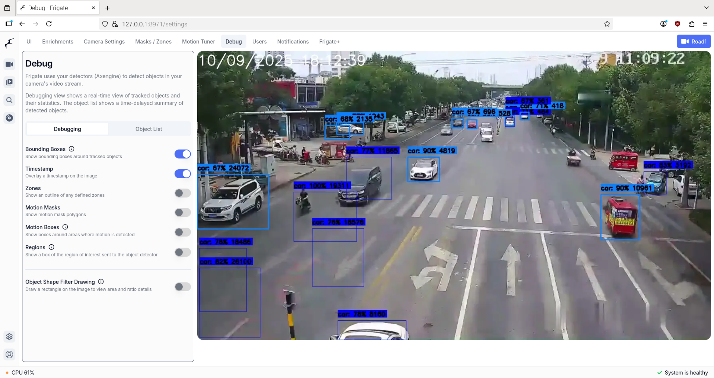

You can preview the configuration in settings
