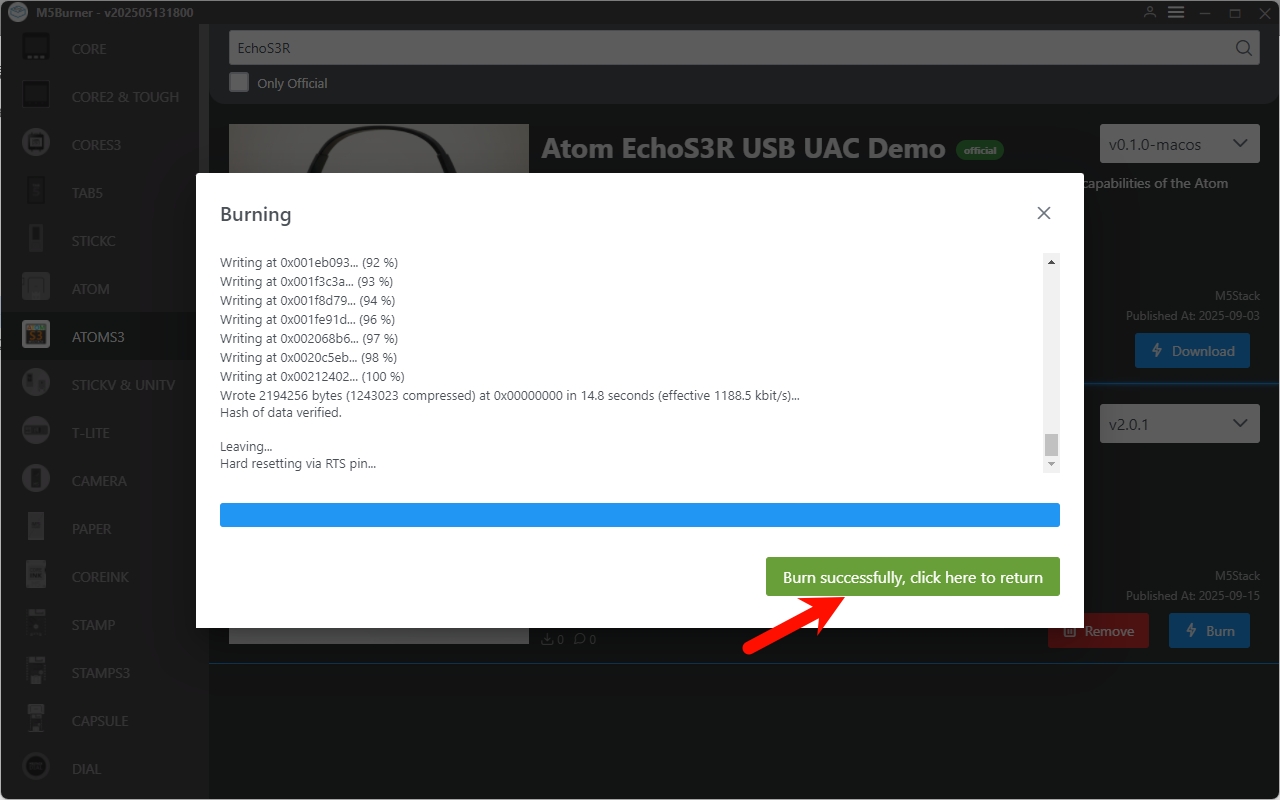

  1. Double-click to open the Burner burning tool, select the corresponding device type ATOMS3 from the left menu, and click Download to download the Atom VoiceS3R XiaoZhi Voice Assistant firmware.
  1. After the device is connected to USB, press and hold the reset button (about 2 seconds) until the internal green LED lights up, then release it. At this time, the device has entered download mode, waiting to be burned. The red indicator turns off after the button is released, confirming that the device is in download mode.
  1. Click Burn, select the corresponding port of the device, then click Start and wait for the burning to complete.
  1. After the burning is complete, press the reset button, and the device will restart and enter Wi-Fi configuration mode.

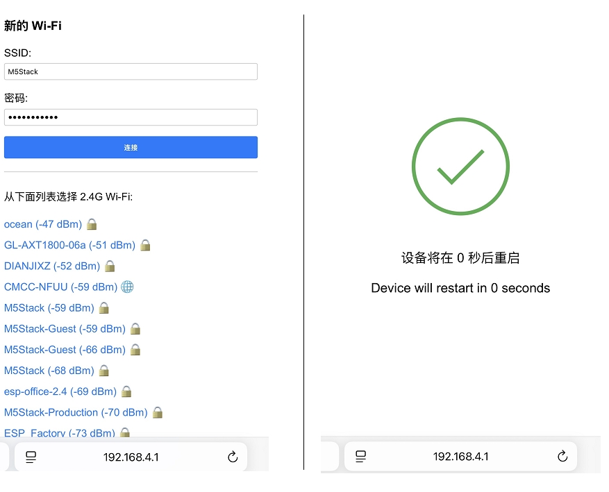

  1. On your phone, connect to the hotspot Xiaozhi-xxxx or visit 192.168.4.1 to enter the network configuration page.
  2. Complete the Wi-Fi configuration according to the page prompts.

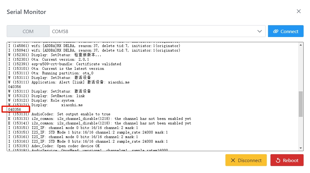

After the Wi-Fi configuration is successful, the device will restart and automatically announce Please log in to the control panel to add a device and enter the verification code xxxxxx. You can also view the device verification code through the serial log.

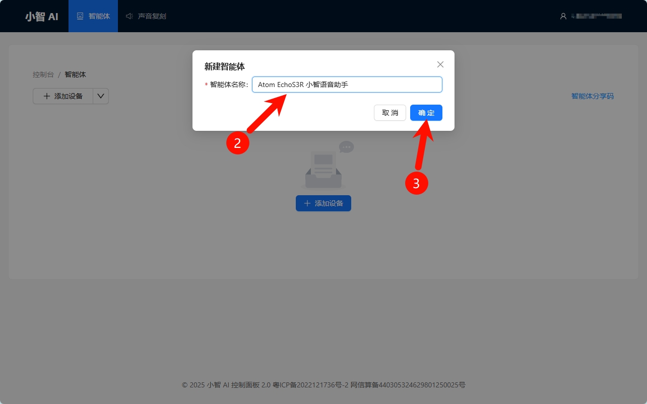

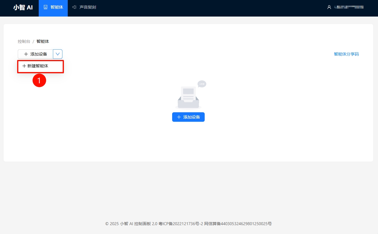

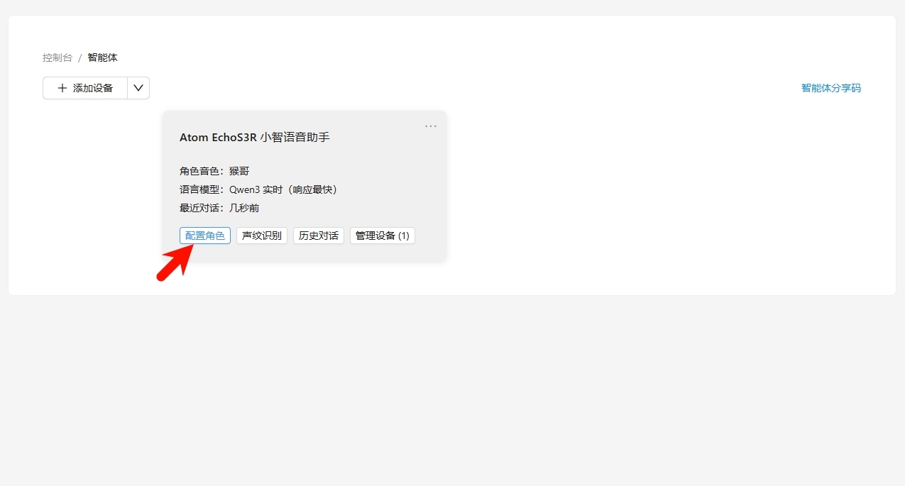

  2. In the XiaoZhi AI Control Panel, create a new agent.

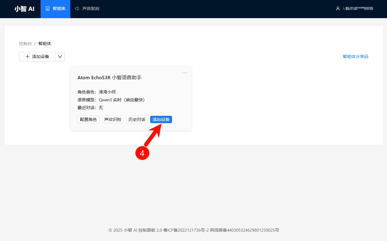

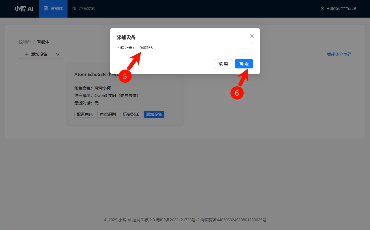

  1. Click add device and enter the device verification code information to bind the device.

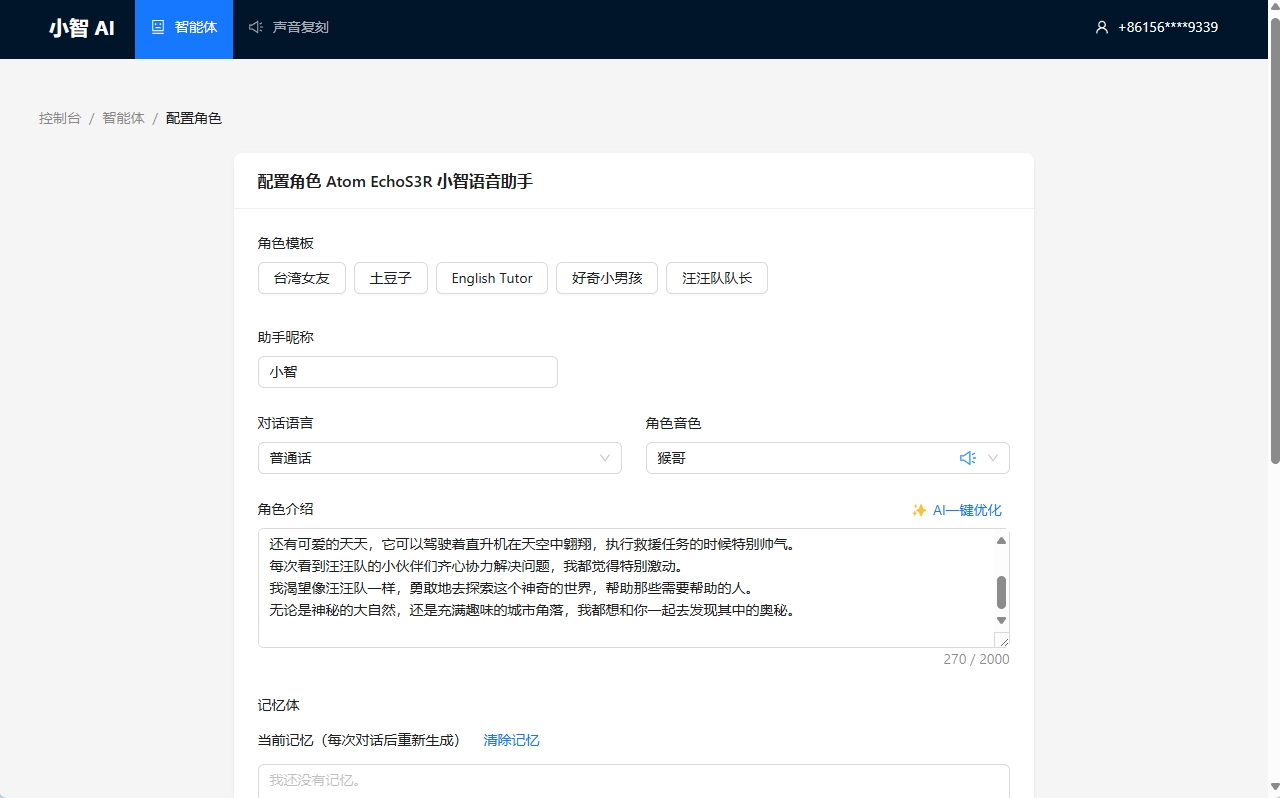

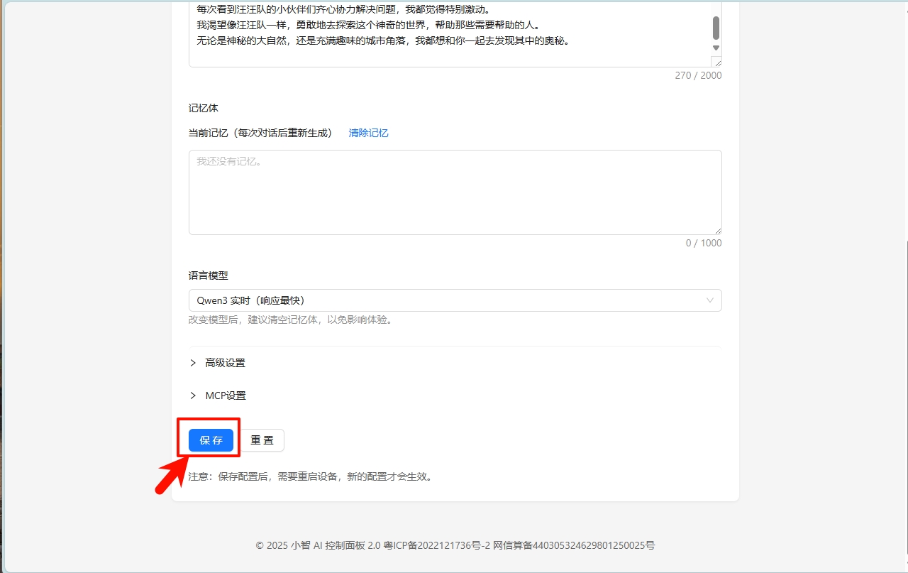

6. Voice Profile Switching
XiaoZhi AI provides some voice profile templates. You can configure them in the Configure Role page of the control panel. After completing the configuration, you need to restart the device for the changes to take effect.
