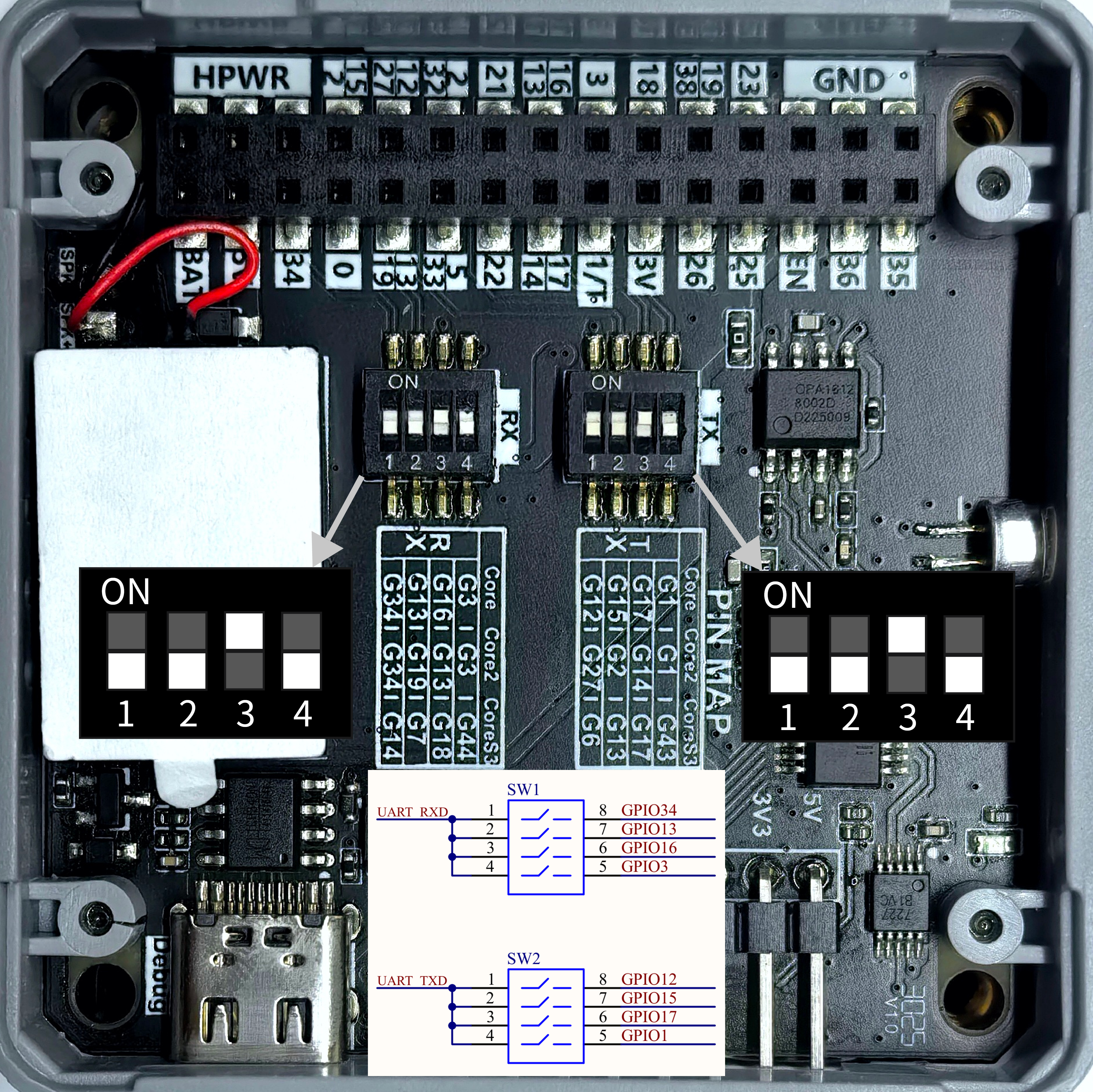

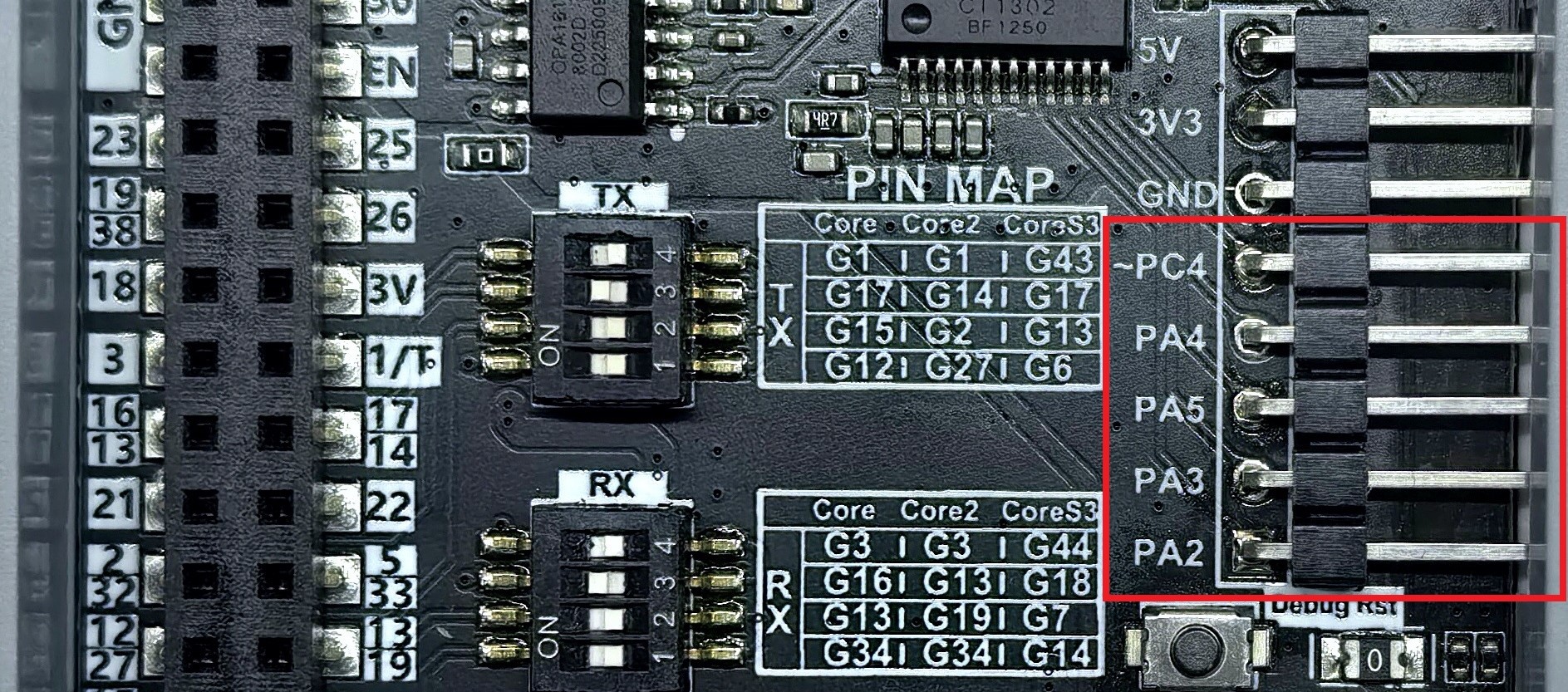

  • The main controller used in this tutorial is CoreS3-SE, paired with Module ASR for voice interaction. Before use, please refer to the figure below and set the DIP switches to the specified positions.
3.1 DIP Switches
Module ASR communicates via UART. Modify the pin definitions in the program according to your actual wiring. After connection, the corresponding UART IOs are G18 (RX) and G17 (TX). The DIP switch positions are shown below:
3.2 IO Ports

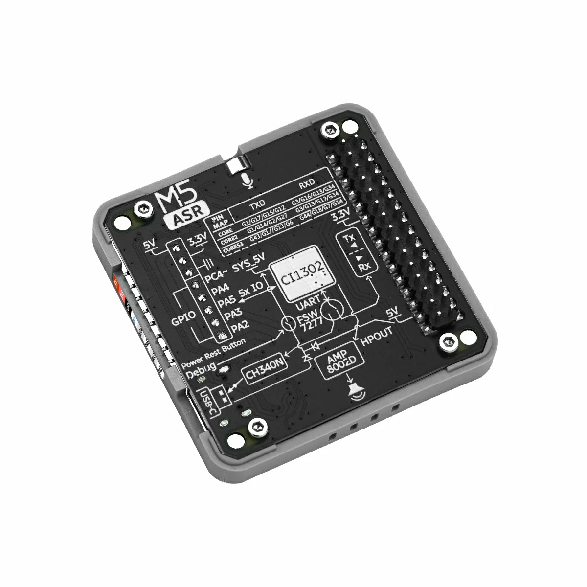

  • Module ASR features 5 IO ports. You can control the output level of each IO via voice commands, or trigger specific voice responses via IO input. The IO ports are shown below:

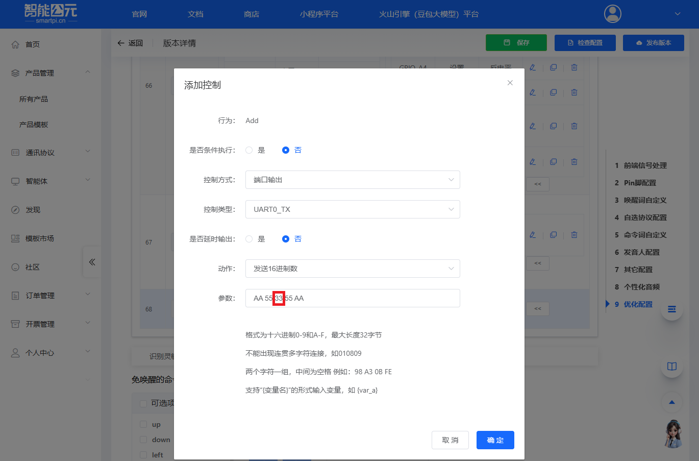

  • In the above example, the custom voice command Add uses the frame AA 55 33 55 AA, where the command code is 0x33. The firmware configuration is shown below. The example uses the addCommandWord function to add the command to the table and register the callback.

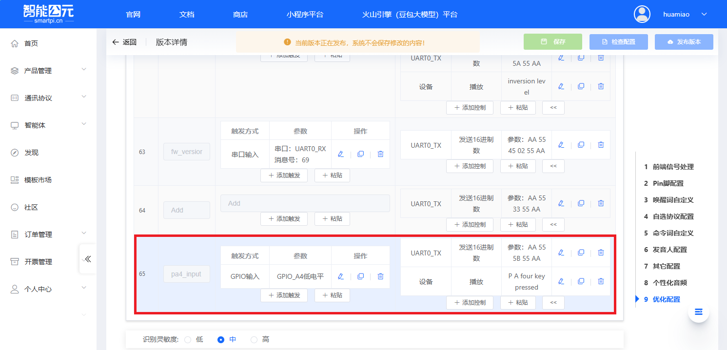

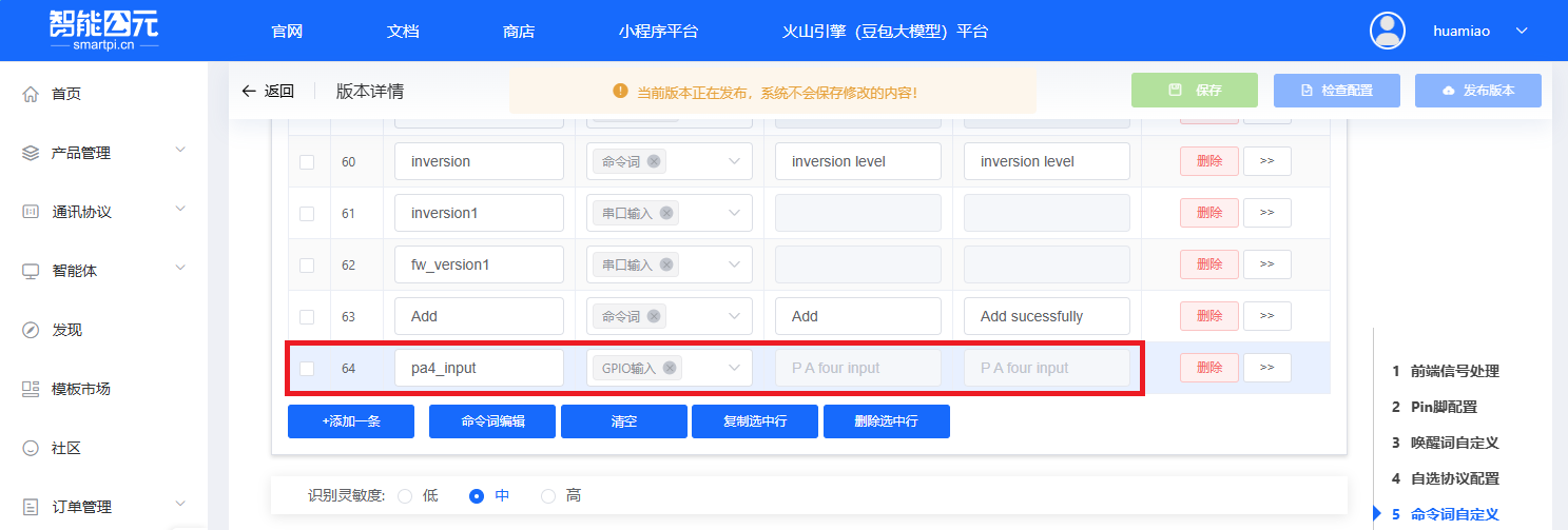

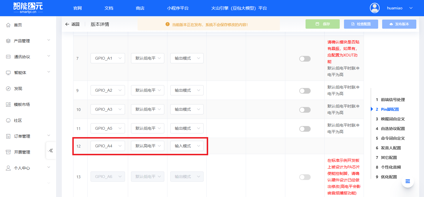

  • In the above example, PA4 input is a custom command, with frame AA 55 5B 55 AA and command code 0x5B. The firmware configuration requires setting GPIO_A4 to input mode in the pin configuration. Details are shown below. The example uses the addCommandWord function to add the command to the table and register the callback.

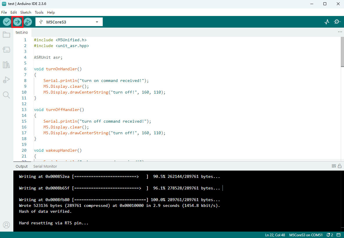

4. Compile & Upload
    1. Enter download mode: On CoreS3-SE, press and hold the reset button (about 2 seconds) until the internal green LED lights up, then release. The device is now in download mode and ready for flashing.
Note
Different devices may require different steps to enter download mode before flashing. For details, refer to the device flashing guide list at the bottom of the Arduino IDE Getting Started Guide page.
    1. Select the device port, click the compile/upload button in the upper left of the Arduino IDE, and wait for the program to finish compiling and uploading.

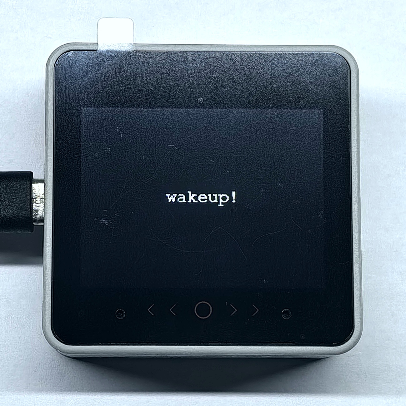

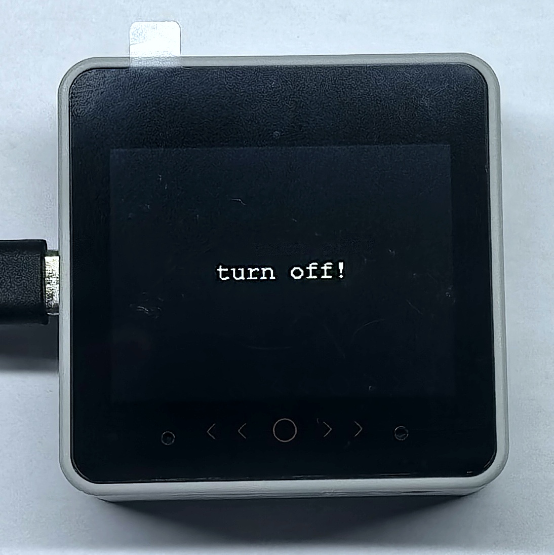

  • Wake-up operation

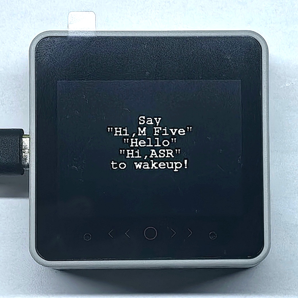

    After power-on, the host display shows as in the left image below. Use the voice command Hi M Five to wake up the module, which responds with I'm here, and the host display shows as in the right image below.
Serial monitor output:
wakeup command received!
Hi,M Five
0xFF
0xAA 0x55 0xFF 0x55 0xAA
  • Preset command interaction

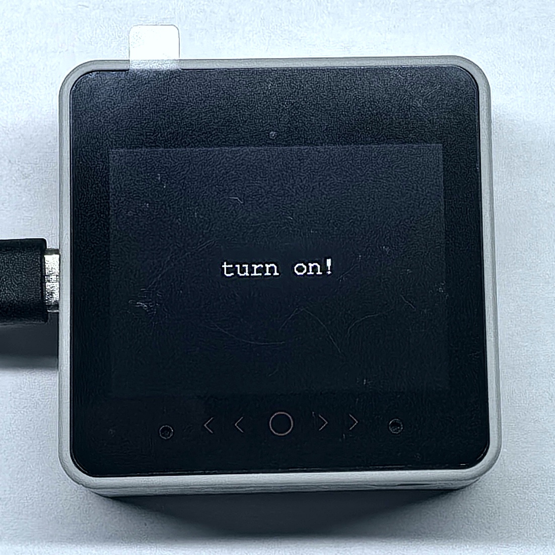

    1. Use the voice command Turn on, the module replies OK, and the host display shows turn on!.
    2. Use the voice command Turn off, the module replies OK, and the host display shows turn off!.
turn on command received!
turn on
0x46
0xAA 0x55 0x14 0x55 0xAA
turn on
0x46
0xAA 0x55 0x15 0x55 0xAA

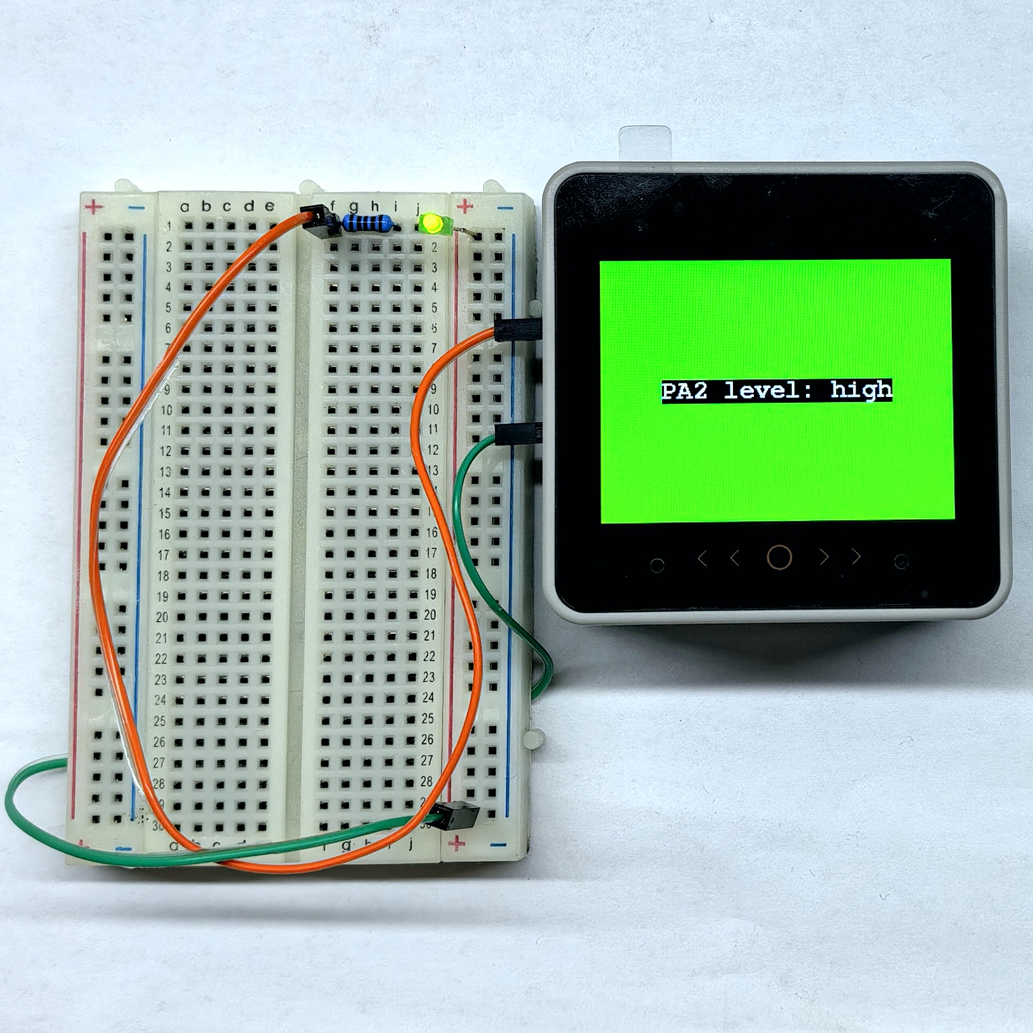

    1. Use the voice command PA2 high level, the module replies PA2 high level, the host display shows PA2 level: high and the background turns green, PA2 outputs high.

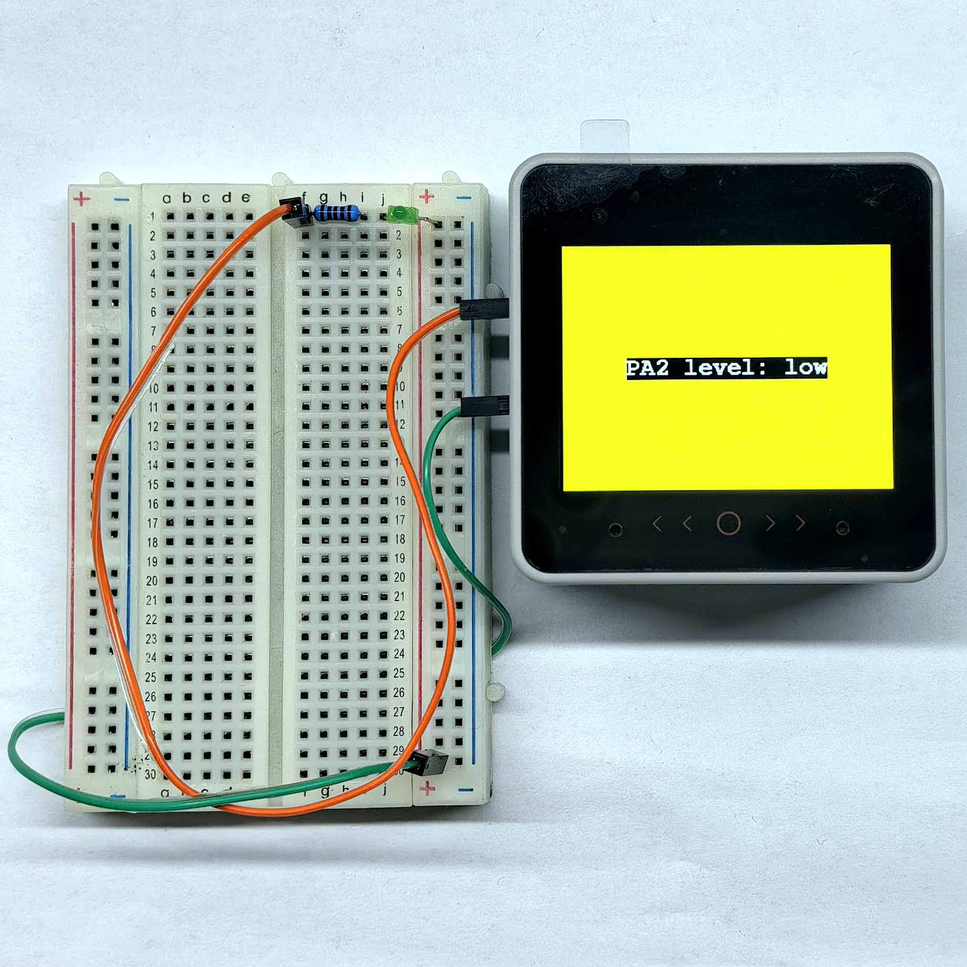

    2. Use the voice command PA2 low level, the module replies PA2 low level, the host display shows PA2 level: low and the background turns yellow, PA2 outputs low.
set PA2 level to high
PA2 high level
0x50
0xAA 0x55 0x50 0x55 0xAA
set PA2 level to low
PA2 low level
0x51
0xAA 0x55 0x51 0x55 0xAA

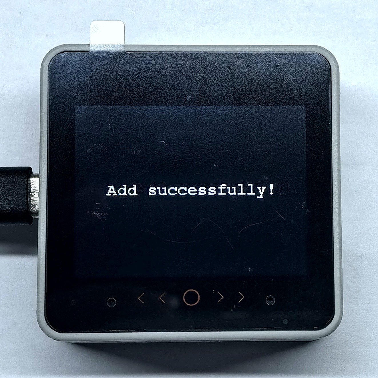

  • Custom command interaction
    Use the voice command Add, the module replies Add successfully, and the host display shows Add successfully!.
Add command received!
Add
0x33
0xAA 0x55 0x33 0x55 0xAA
