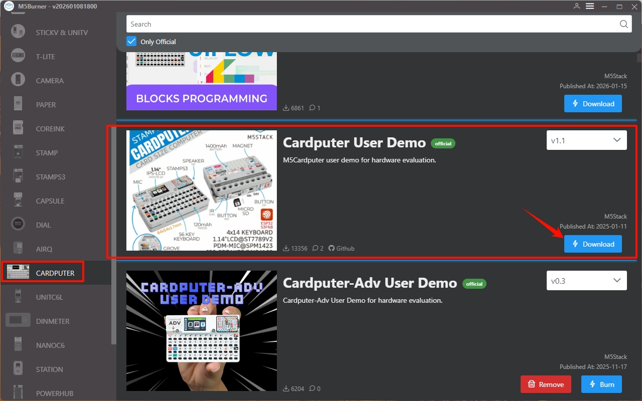

  • Refer to the M5Burner Tutorial to complete the download of the flashing tool, and follow the image below to download the corresponding firmware.

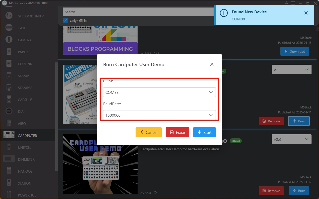

3. Port Selection
Connect the device to the computer via a USB cable. After the device enters Download Mode, select the corresponding device port in M5Burner.

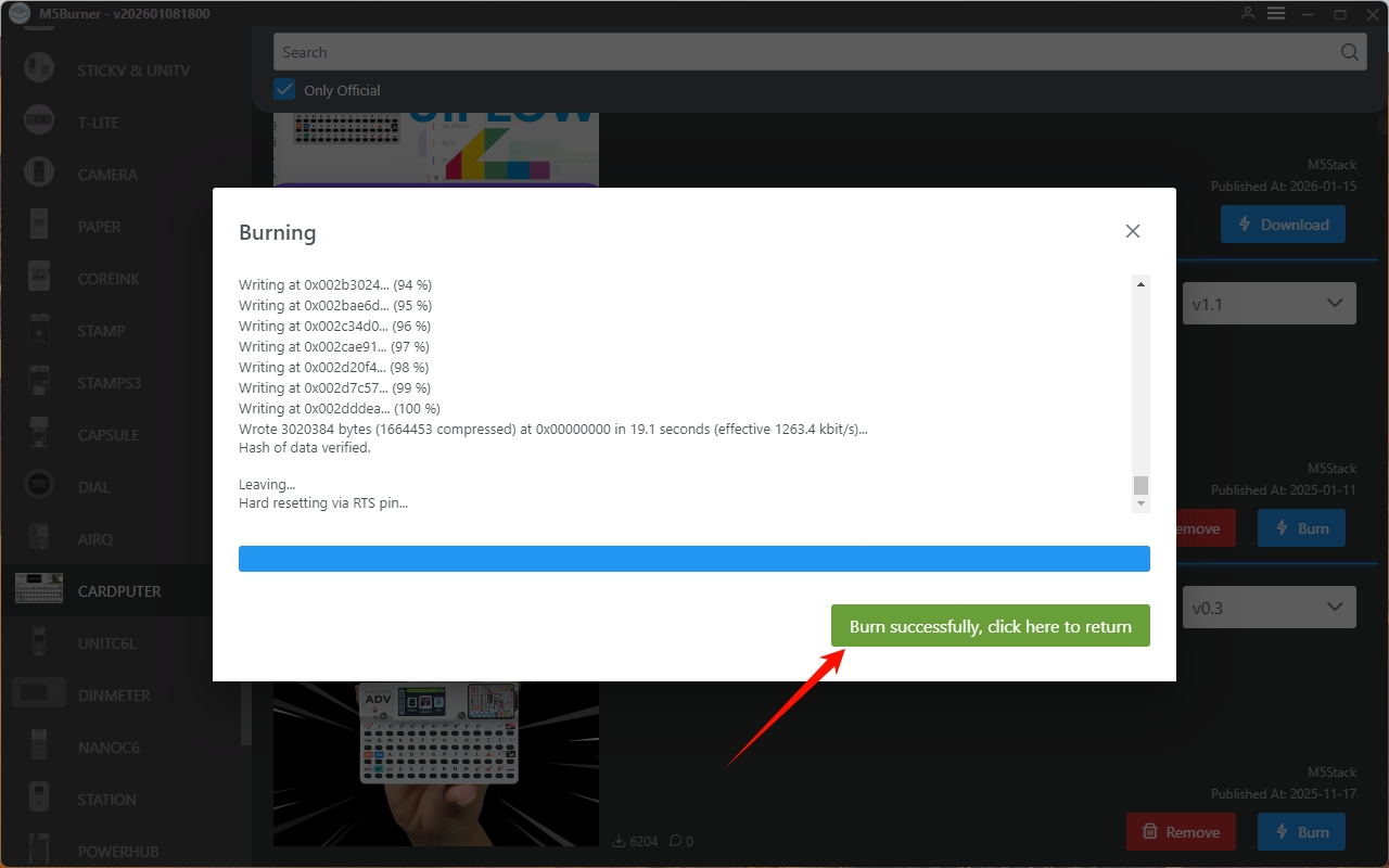

4. Firmware Flashing
Click Start to begin flashing. After the flashing is complete, the interface will display Burn successfully, click here to return.

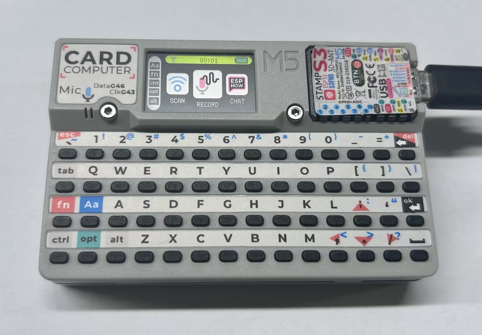

The result is shown below:
