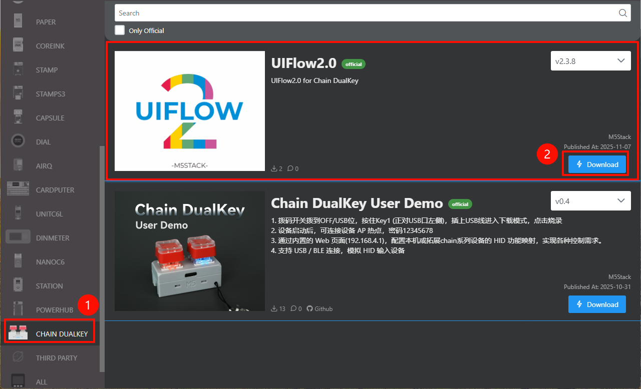

  2. Download the firmware for Chain DualKey in M5Burner, as shown below.

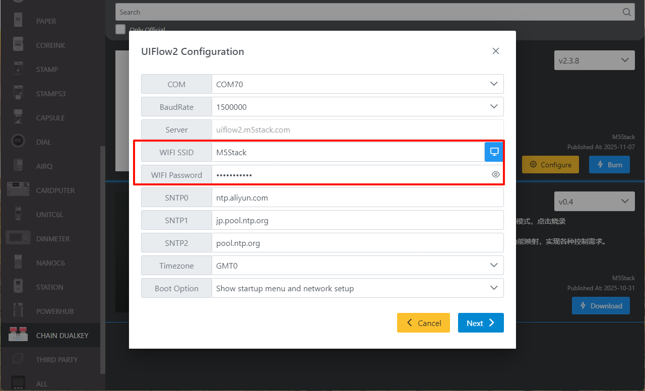

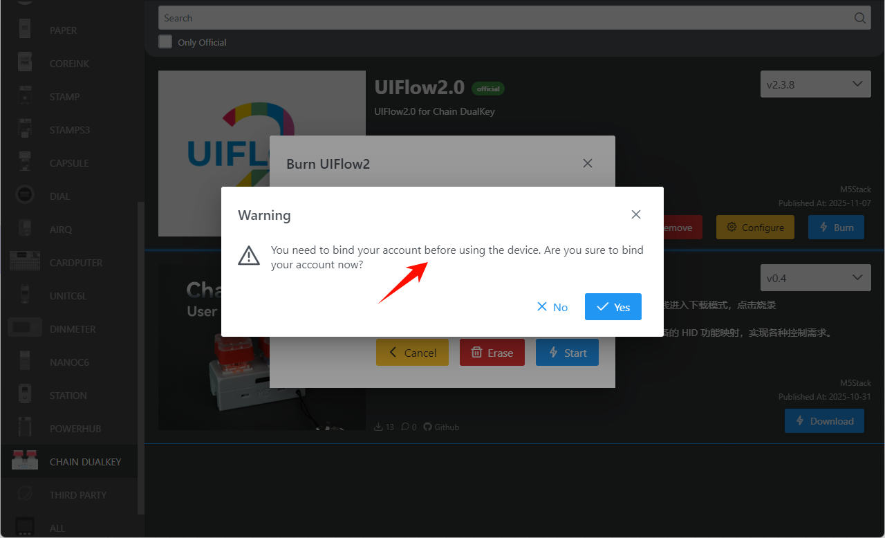

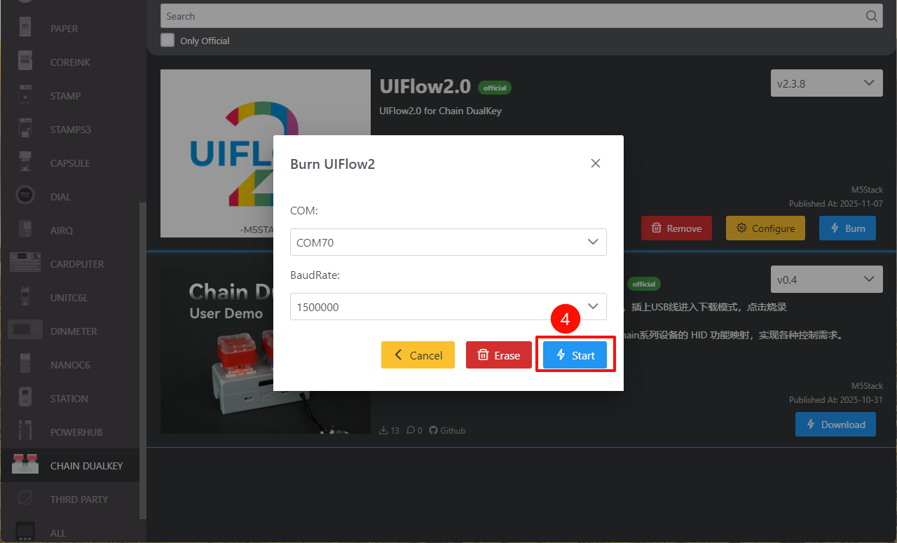

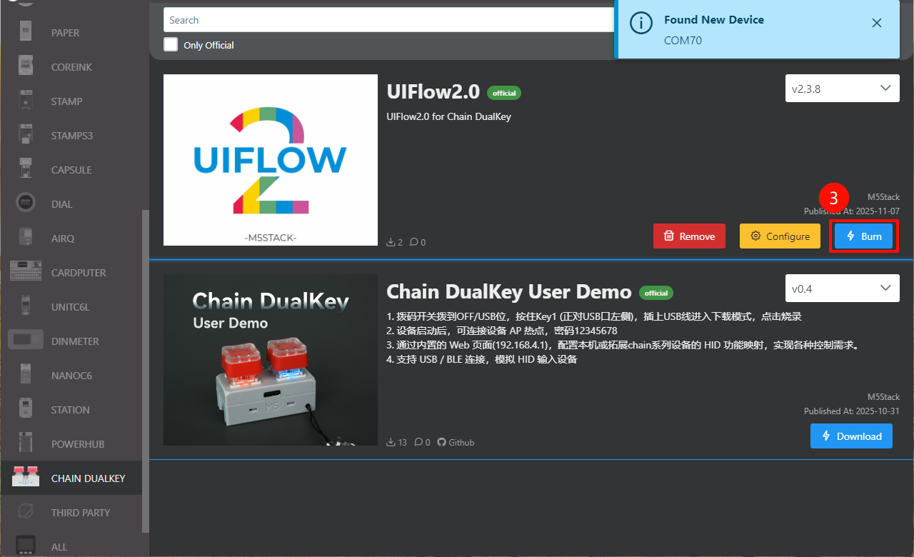

  1. In M5Burner, click the Burn button for the corresponding firmware, select the device port, and click Start.

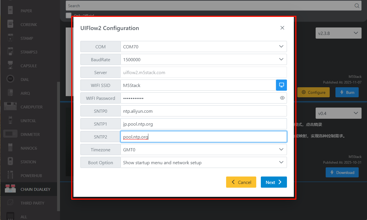

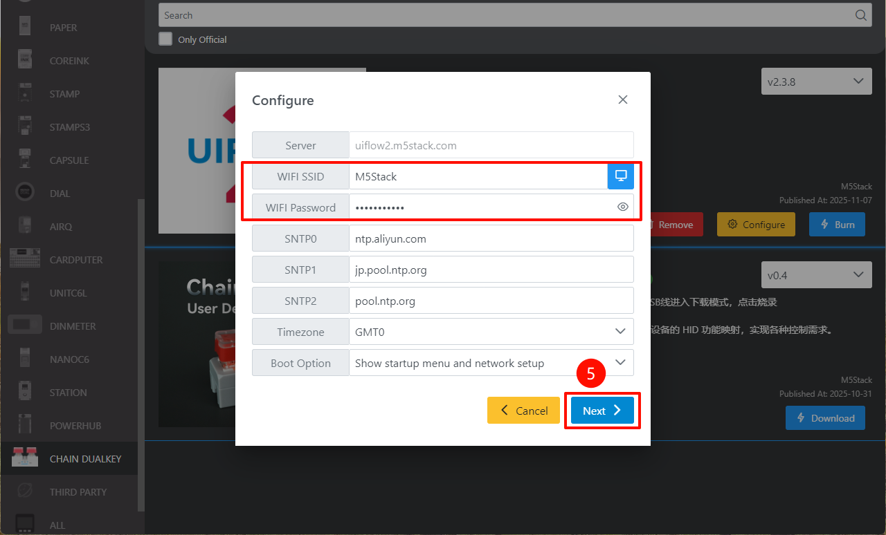

  1. Enter the Wi-Fi configuration required by the device, including Wi-Fi SSID and Wi-Fi Password, as well as any other device configuration that needs to be added or modified, then click Next to start flashing.
Configuration information:
  • WIFI SSID/WIFI Password: Wi-Fi name and password used by the device
  • SNTP Server
  • Timezone: Time zone setting
  • Boot Option: Set the device boot mode after firmware flashing is complete
    • Run main.py directly: After flashing is complete, run the program in main.py directly without connecting to the network or displaying the UiFlow2 startup screen
    • Only network setup: The device only performs network setup and does not display the UiFlow2 startup screen

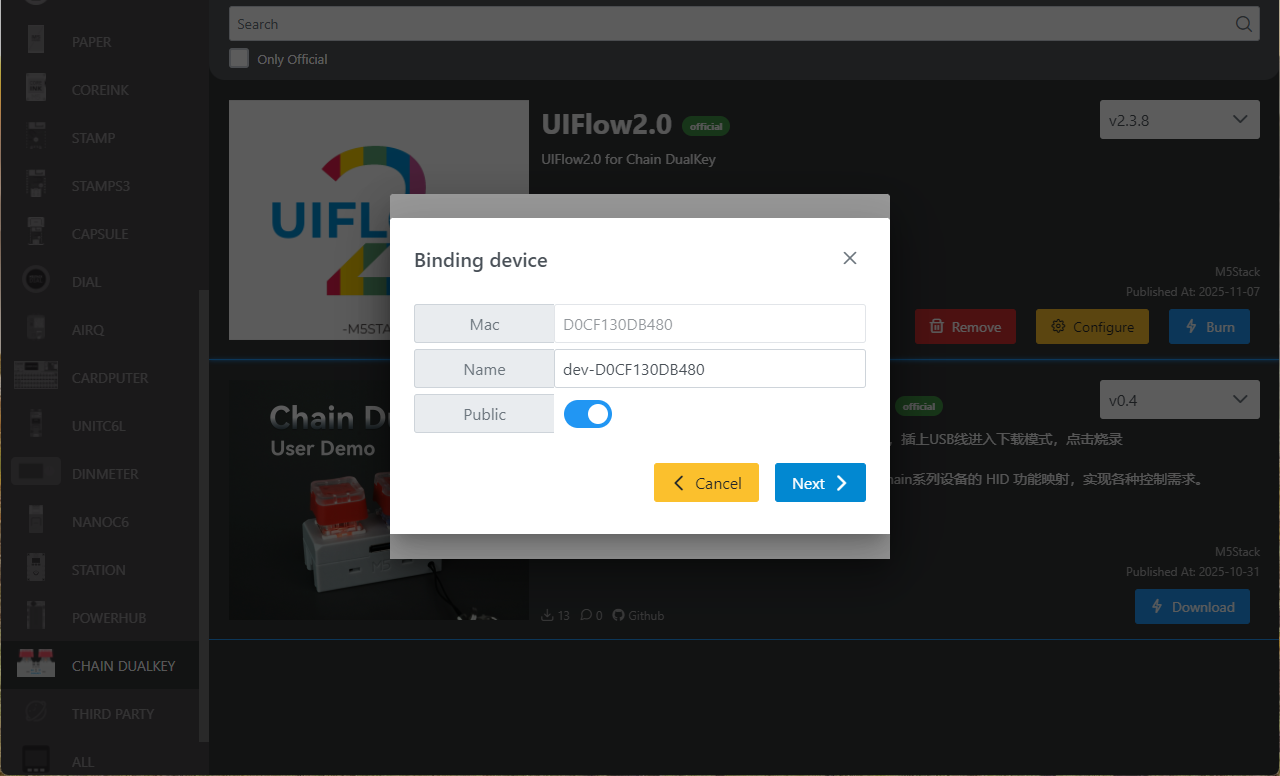

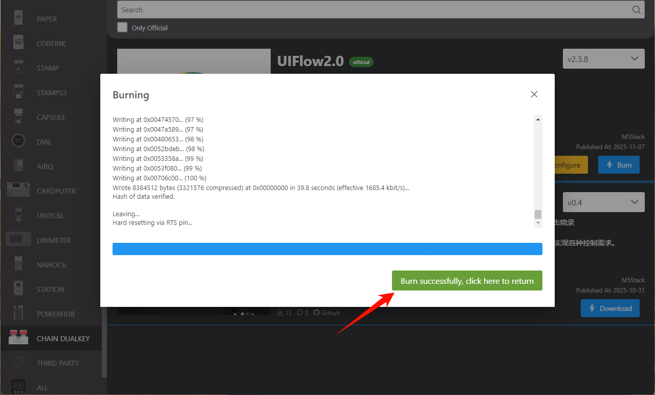

  1. When Burn successfully, click here to return is displayed, flashing is successful.

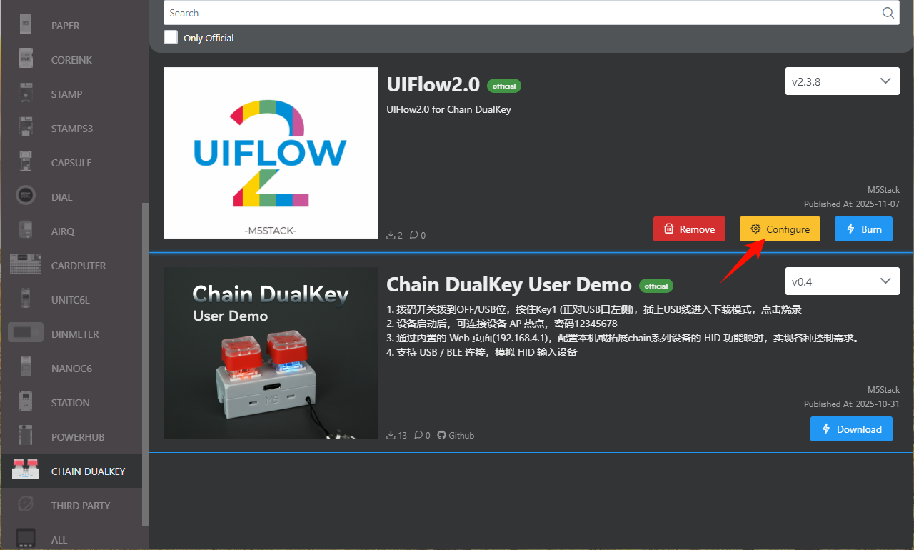

  1. After firmware flashing is complete, if you need to modify the device configuration, keep the USB connection, restart the device, click Configure, and modify the settings according to the prompts.

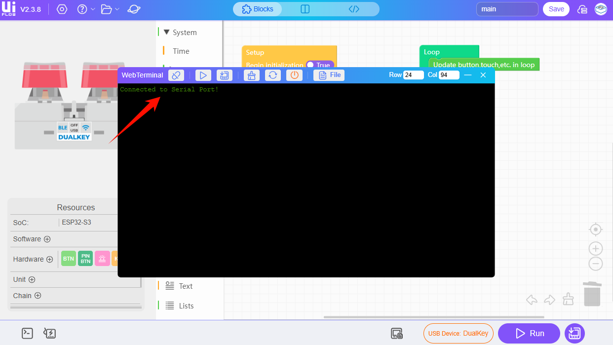

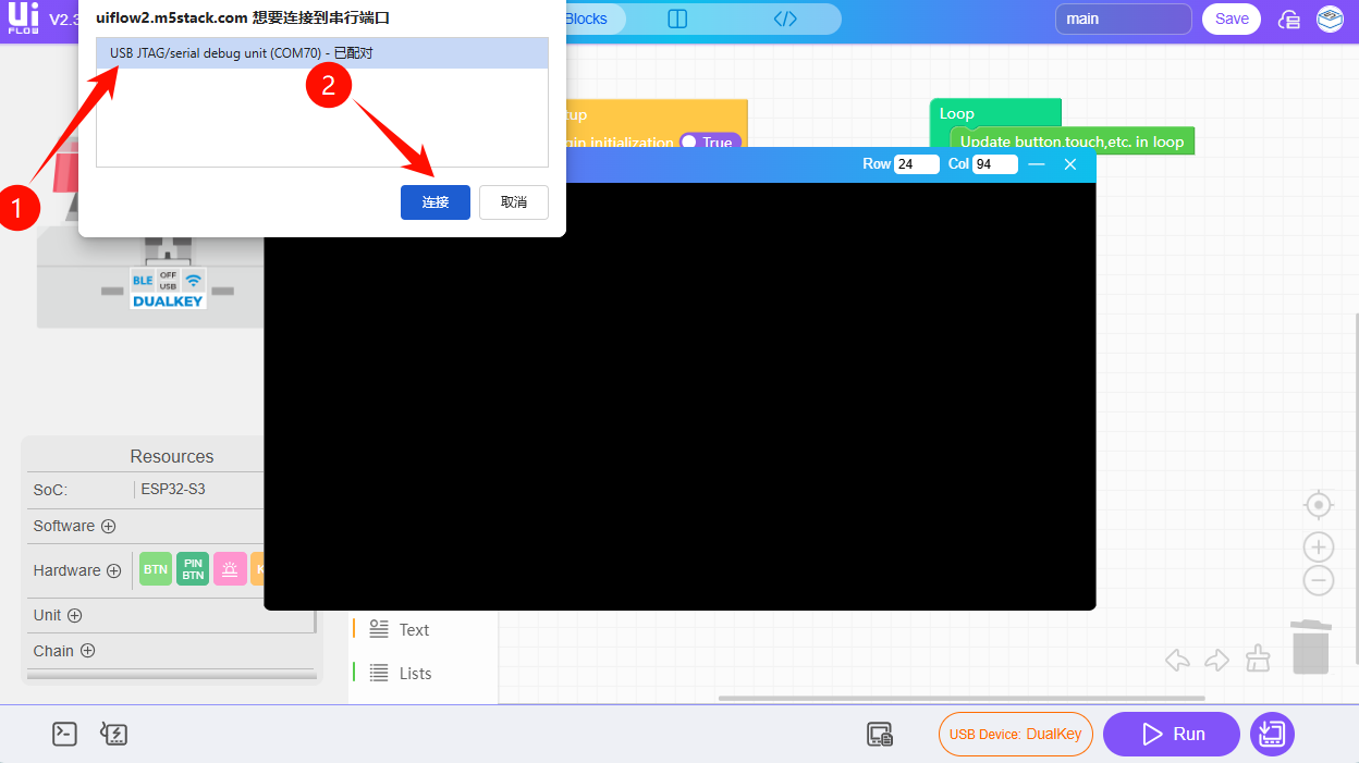

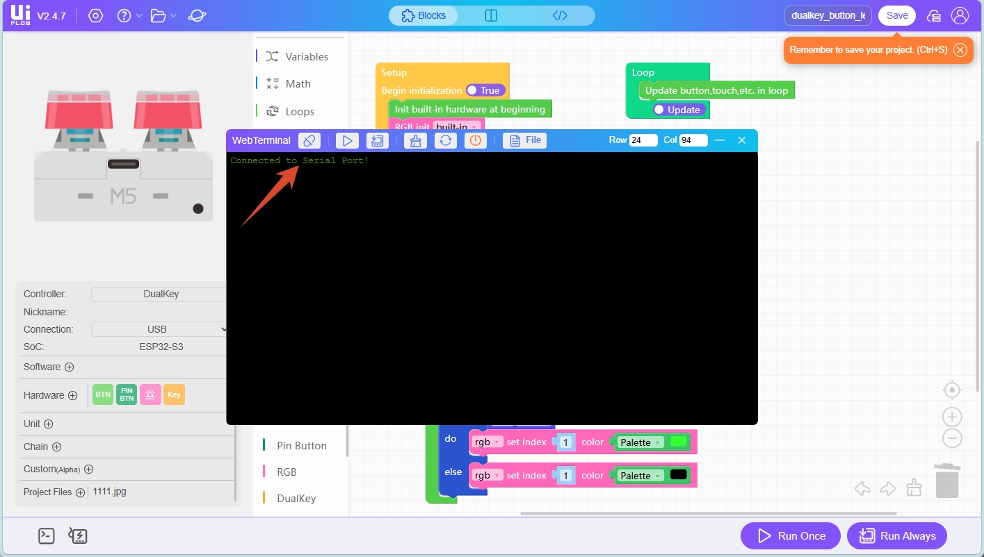

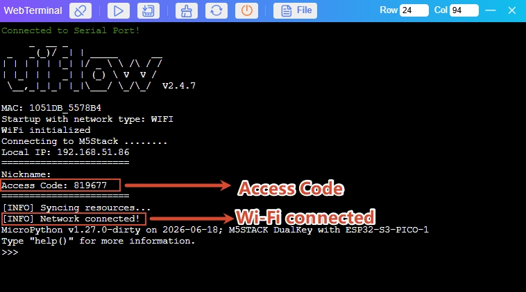

  2. Make sure the device is connected to the network and obtain the Access Code: click WebTerminal in the lower-left corner of the interface, select the serial port for Chain DualKey in the dialog, then click Connect to open the serial monitor. You can view the current valid Access Code and Wi-Fi connection status. (Note: If the corresponding information is not displayed, click Soft Reset to perform a soft reboot.)

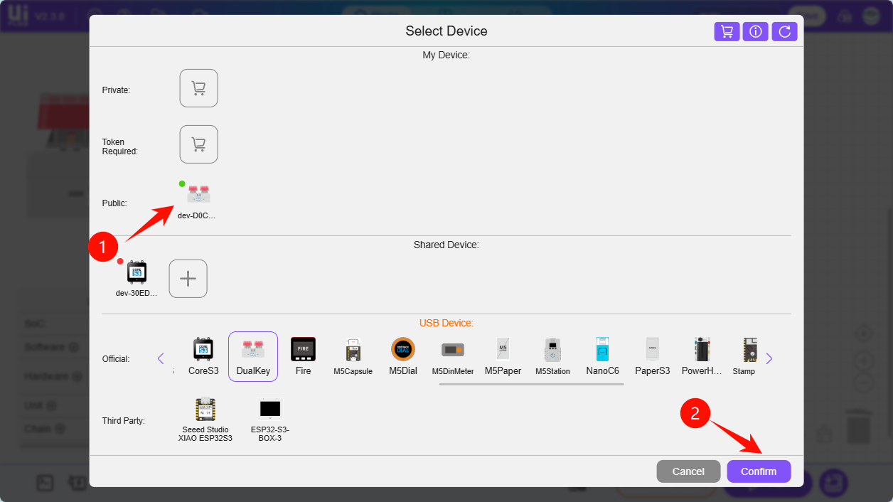

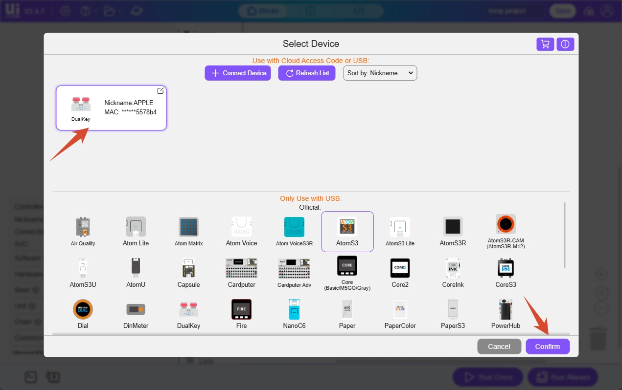

  1. Click Select Your Controller on the page (shown on first entry) or the Controller button to enter the Select Device page.
  1. Click Connect Device, enter the access code and a custom device name, then click Confirm to connect Chain DualKey to UiFlow2.

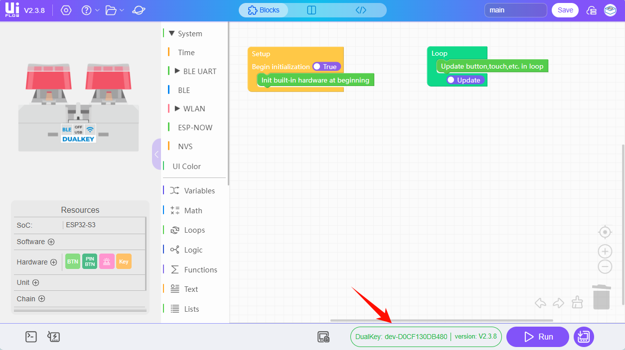

  1. Select the connected Chain DualKey device on the Select Device page, then click Confirm to enter the UiFlow2 programming interface.

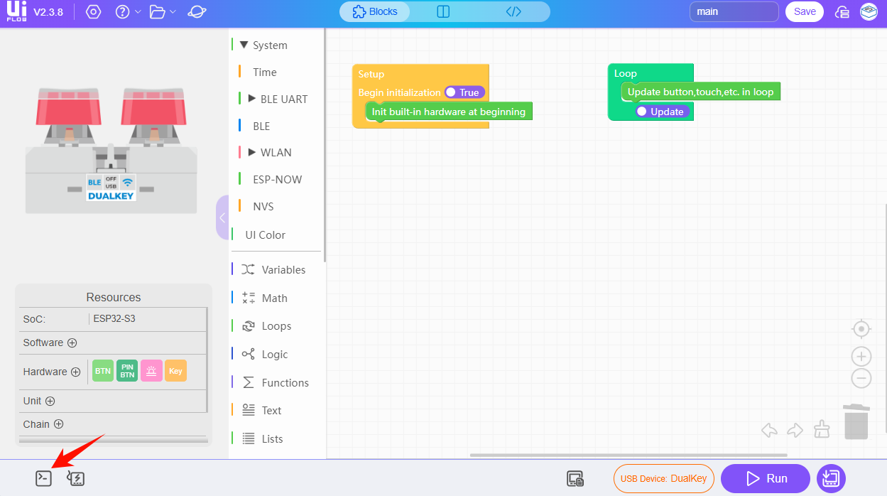

USB Wired Connection

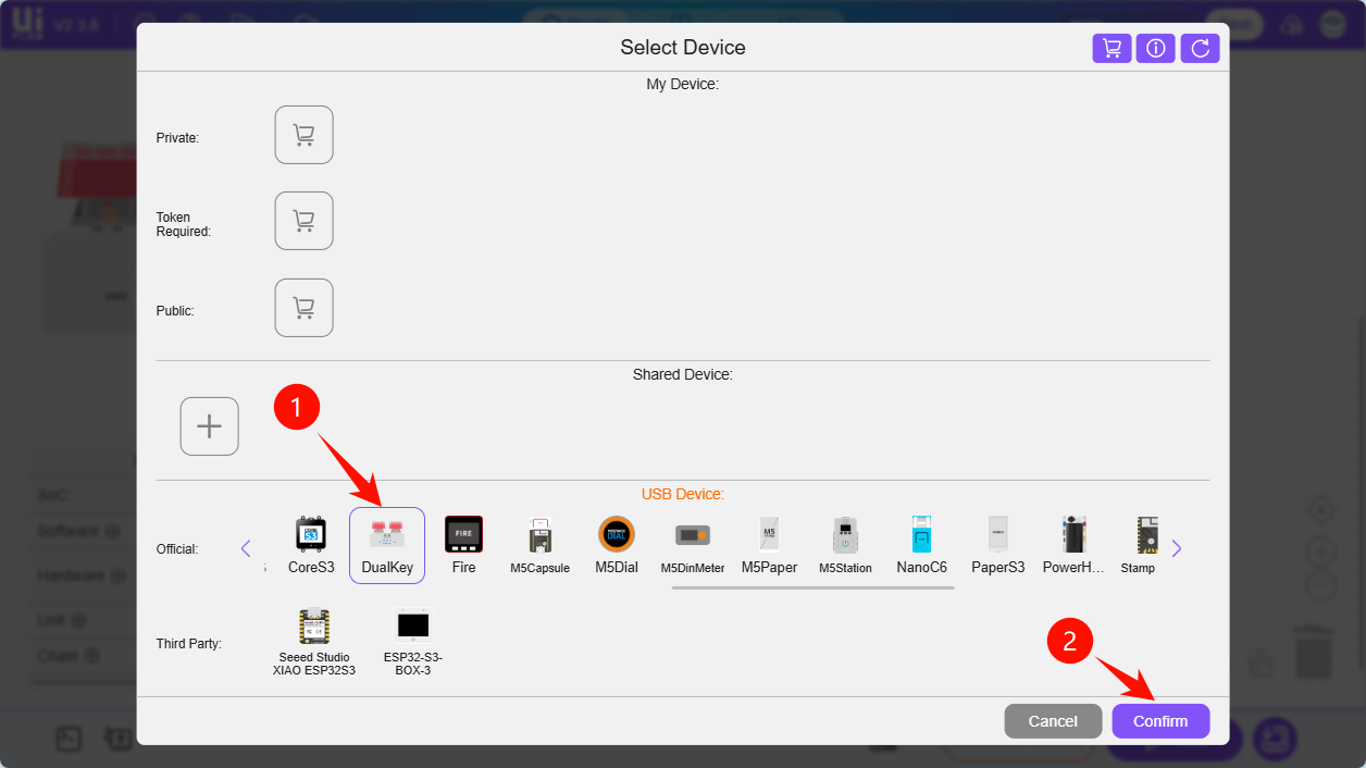

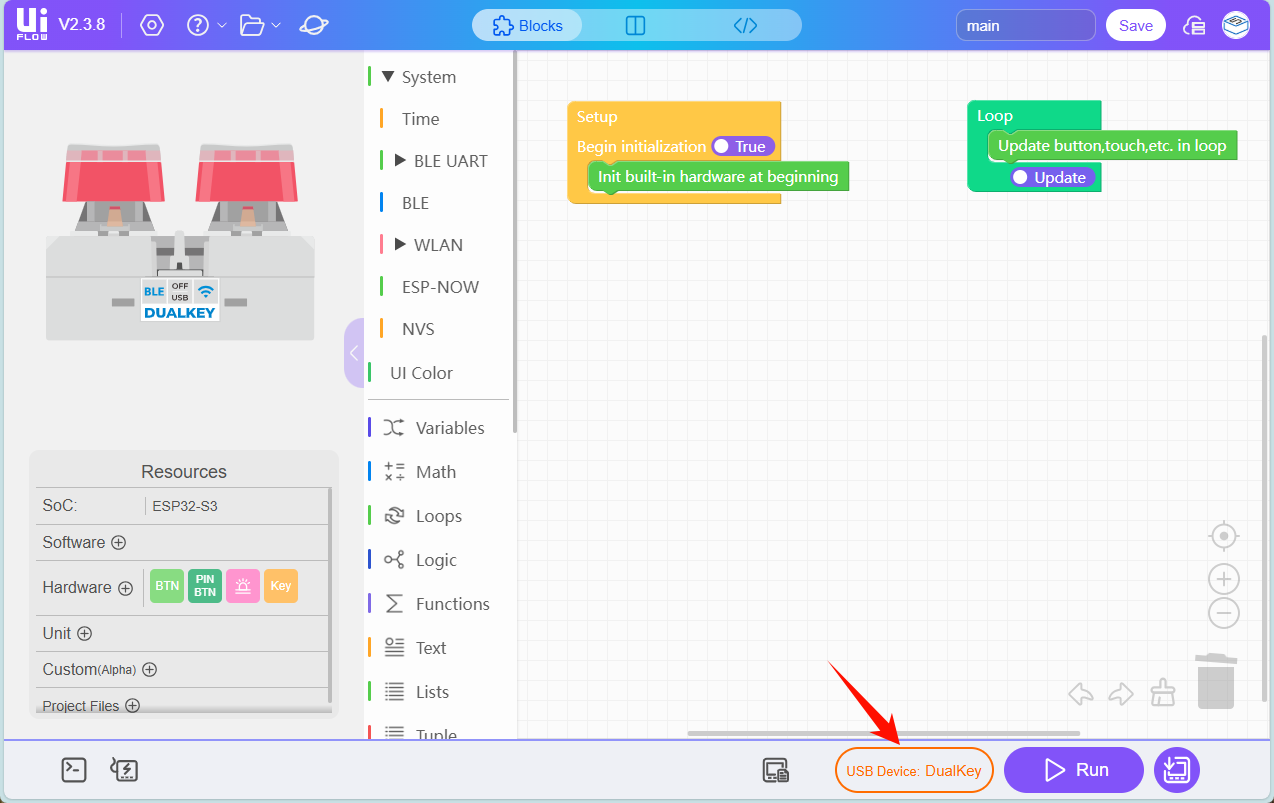

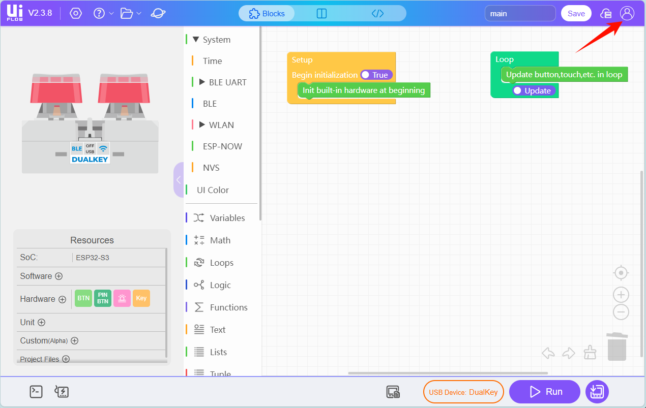

  1. Visit uiflow2.m5stack.com to open the UiFlow2 Web IDE, and connect Chain DualKey to the computer with a USB cable.

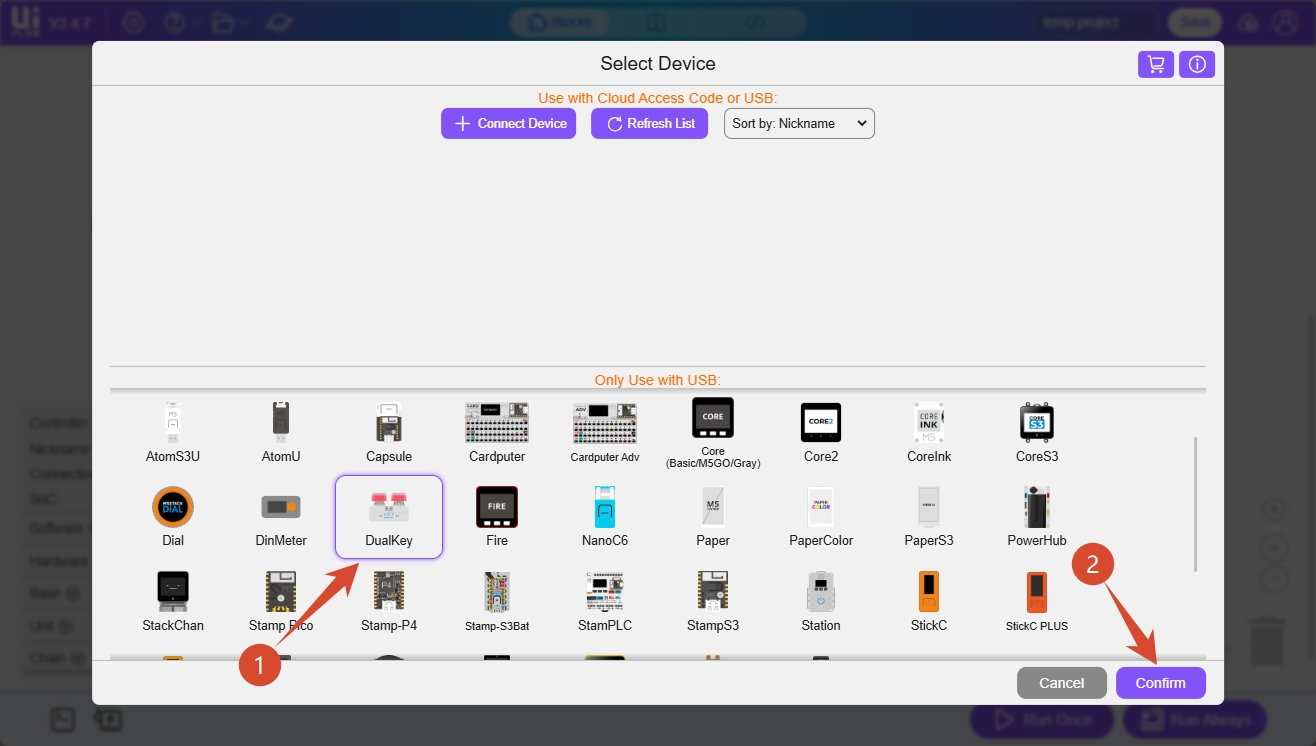

  2. Click Select Your Controller on the page (shown on first entry) or the Controller button to enter the Select Device page.
  1. Select Chain DualKey from the device list, then click Confirm.

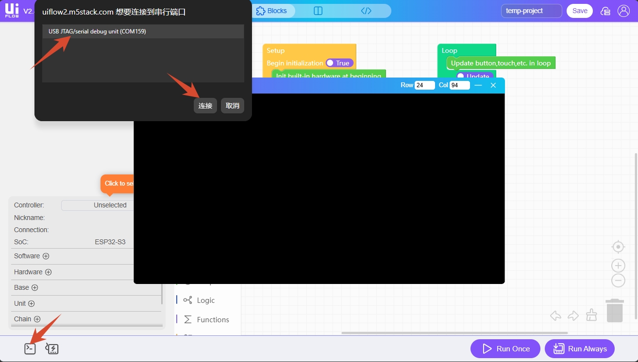

  1. Click the WebTerminal button, select the serial port for Chain DualKey in the dialog, and click Connect.

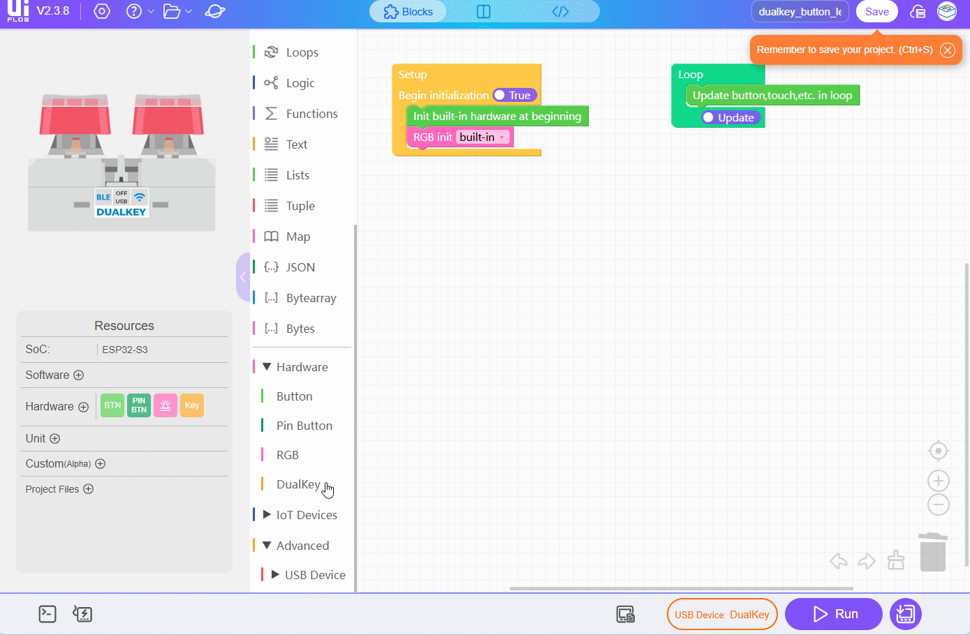

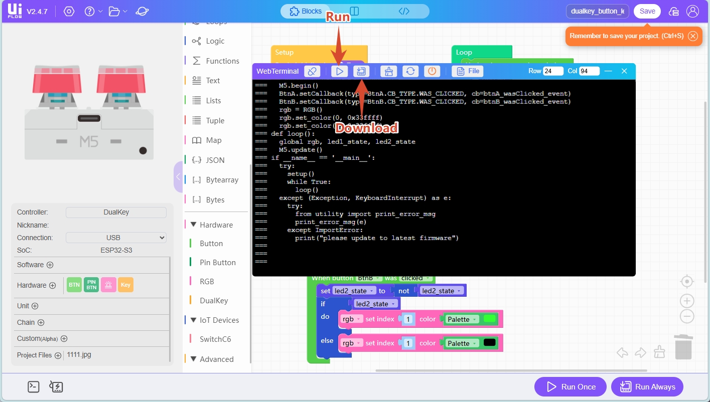

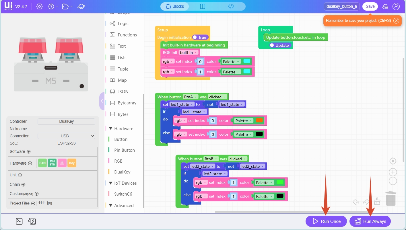

After editing the program, click the Run Once button in the lower-right corner to run the program once for testing. Click Run Always to download the program to the device.
