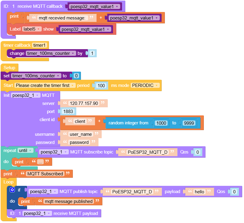

Example
from m5stack import *
from m5ui import *
from uiflow import *
import unit
setScreenColor(0x222222)
poesp32_1 = unit.get(unit.TCP_ETH, 1, unit.PORTA)
poesp32_mqtt_value1 = None
timer_100ms_counter = None
title0 = M5Title(title="Unit POESP32", x=100, fgcolor=0xFFFFFF, bgcolor=0x0000FF)
label0 = M5TextBox(11, 58, "MQTT subscribe topic:", lcd.FONT_Default, 0xFFFFFF, rotate=0)
label1 = M5TextBox(187, 58, "PoESP32_MQTT_D", lcd.FONT_Default, 0x0af60b, rotate=0)
label2 = M5TextBox(11, 87, "publish message:", lcd.FONT_Default, 0xFFFFFF, rotate=0)
label3 = M5TextBox(157, 87, "hello", lcd.FONT_Default, 0x0af60b, rotate=0)
label4 = M5TextBox(11, 119, "received message:", lcd.FONT_Default, 0xFFFFFF, rotate=0)
label5 = M5TextBox(157, 119, "message", lcd.FONT_Default, 0x0af60b, rotate=0)
from numbers import Number
import random
def poesp32_blKNXcb(value):
  global poesp32_mqtt_value1, timer_100ms_counter
  poesp32_mqtt_value1 = value
  print((str('mqtt received message: ') + str(poesp32_mqtt_value1)))
  label5.setText(str(poesp32_mqtt_value1))
  pass
@timerSch.event('timer1')
def ttimer1():
  timer_100ms_counter = (timer_100ms_counter if isinstance(timer_100ms_counter, Number) else 0) + 1
  pass
timer_100ms_counter = 0
timerSch.run('timer1', 100, 0x00)
poesp32_1.create_mqtt_client('120.77.157.90', 1883, ((str('client') + str(random.randint(1000, 9999)))), 'user_name', 'password')
while not (poesp32_1.subscribe_mqtt('PoESP32_MQTT_D', 0)):
  print('...')
print('MQTT Subscribed')
while True:
  if poesp32_1.publish_mqtt_msg('PoESP32_MQTT_D', 'hello', 0):
    print('mqtt message published')
  poesp32_1.receive_mqtt_msg(poesp32_blKNXcb)
  wait_ms(2)
