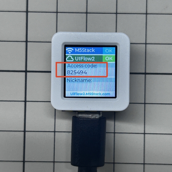

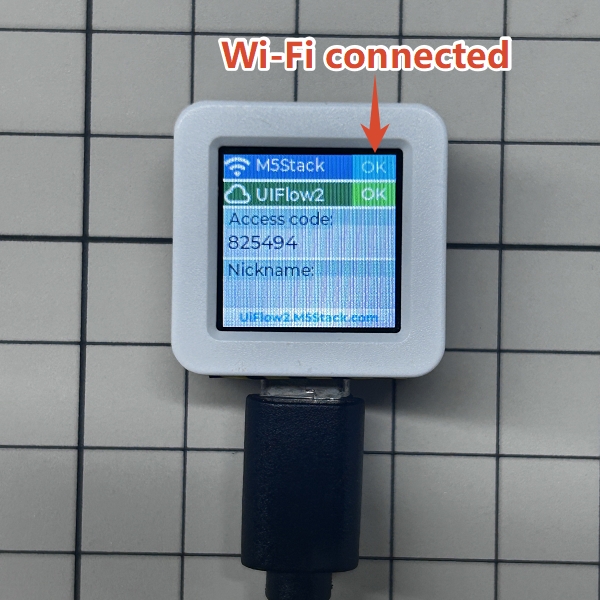

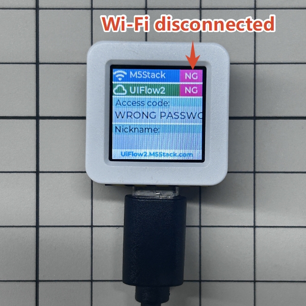

  1. Before connecting, check the Wi-Fi icon on the screen to make sure the device is connected to the network. If the network connection fails, check whether the Wi-Fi name and password entered during firmware flashing are correct, then modify them through the Configure option in M5Burner and flash again.
  1. Check the current valid Access Code on the device's UiFlow2 startup screen.

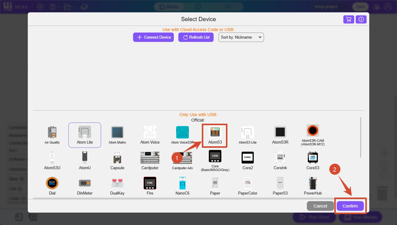

  1. Visit uiflow2.m5stack.com to open the UiFlow2 Web IDE.
  2. Click Select Your Controller on the page (shown on first entry) or the Controller button to enter the Select Device page.
  1. Click Connect Device, enter the access code and a custom device name, then click Confirm to connect AtomS3 to UiFlow2.
  1. Select the connected AtomS3 device on the Select Device page, then click Confirm to enter the UiFlow2 programming interface.

  1. Visit uiflow2.m5stack.com to open the UiFlow2 Web IDE, and connect AtomS3 to the computer with a USB cable.
  1. Select AtomS3 from the device list, then click Confirm.

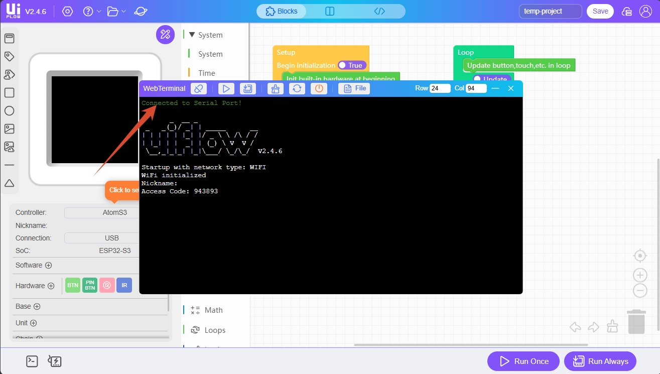

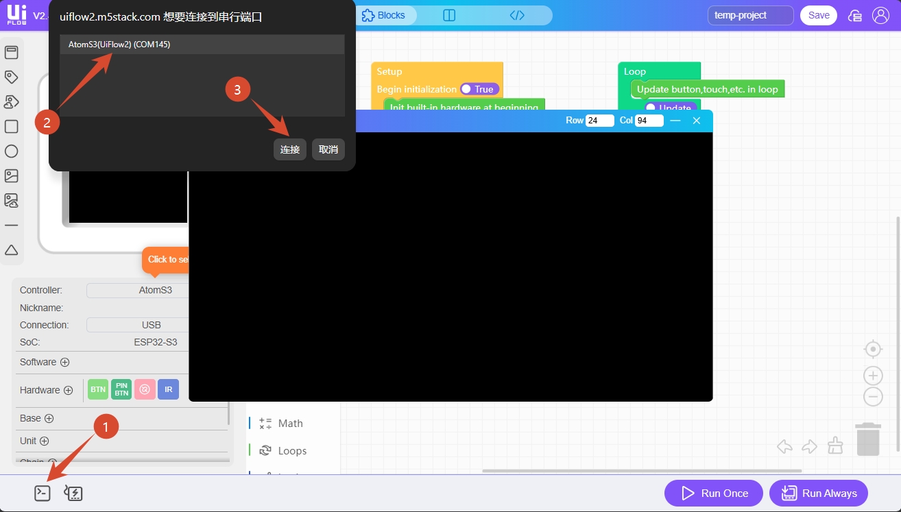

  1. Click the WebTerminal button, select the serial port for AtomS3 in the dialog, and click Connect.
When the WebTerminal screen displays Connected to Serial Port!, the USB connection is successful.

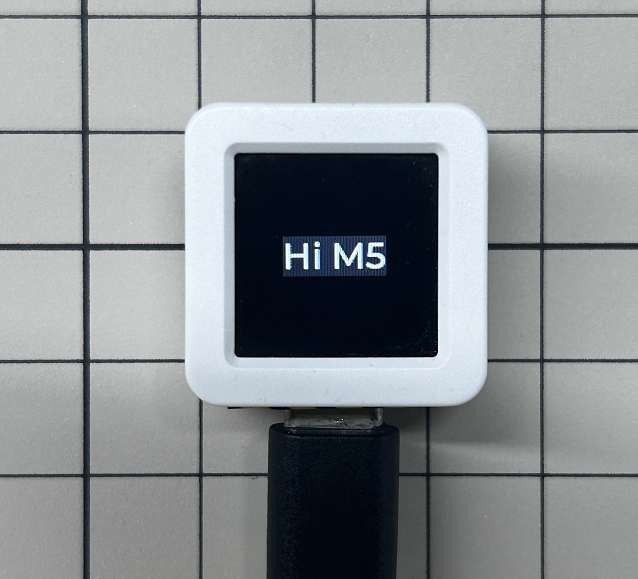

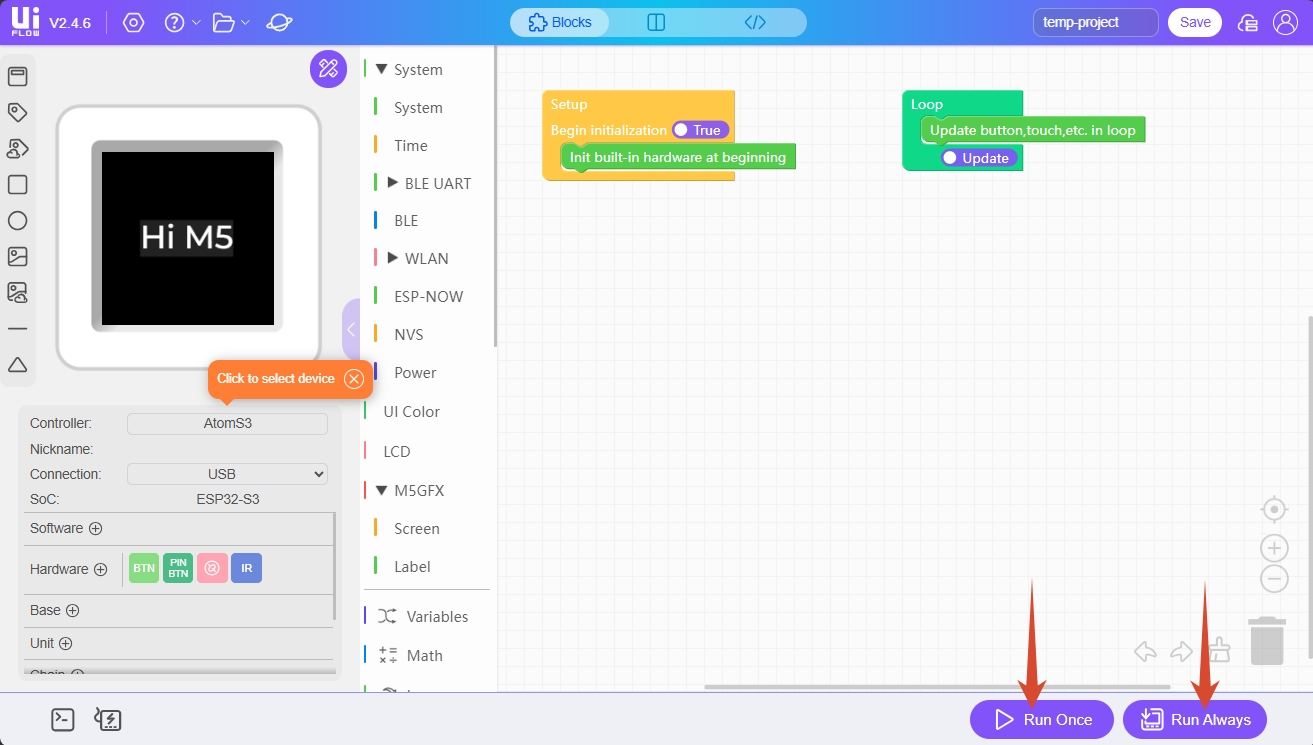

After the device is connected to UiFlow2, you can drag Blockly blocks to edit programs.
After editing the program, click the Run Once button in the lower-right corner to run the program once for testing. Click Run Always to download the program to the device.
You can also run once or download the program in the WebTerminal window.
